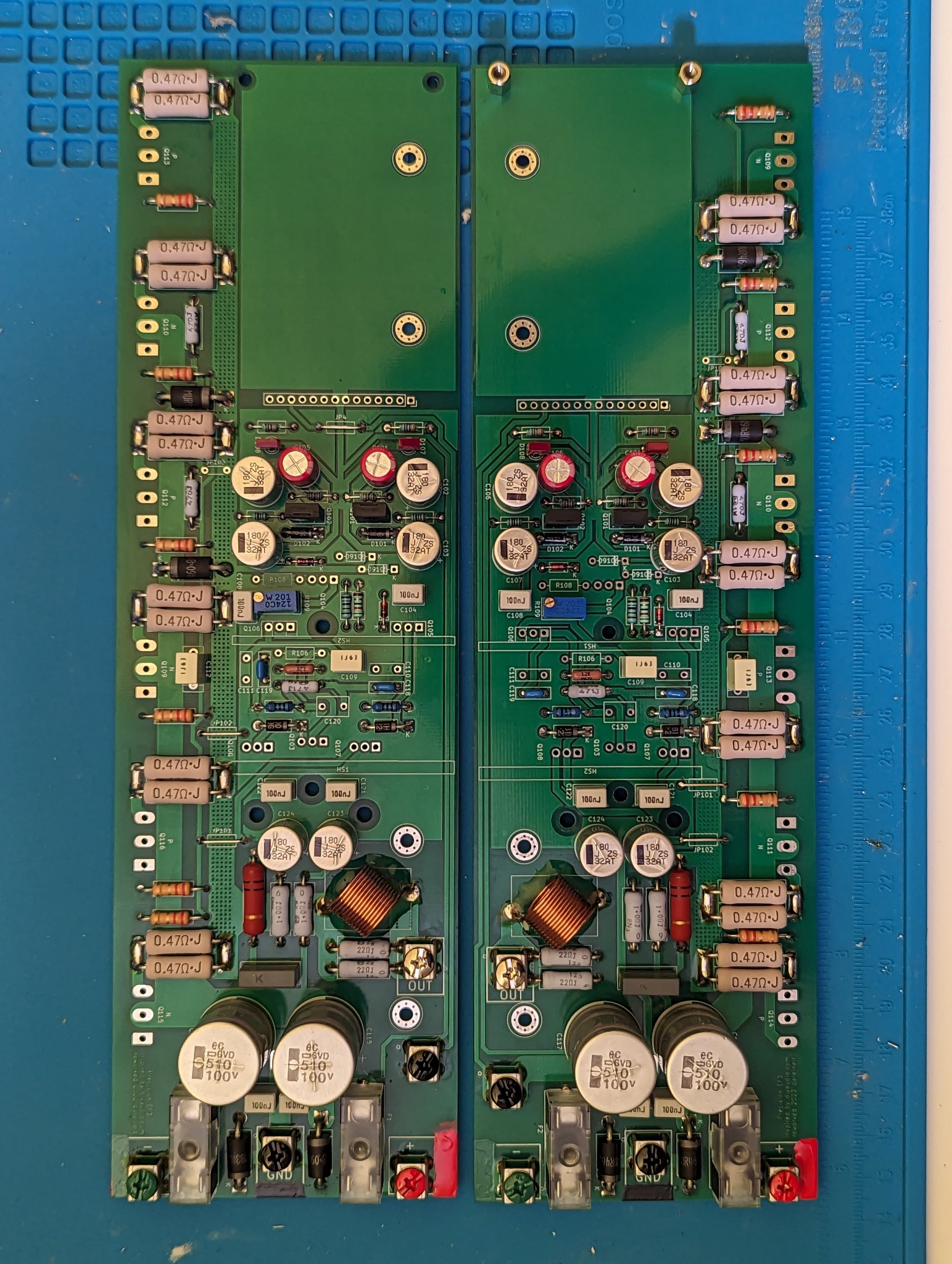

Unfortunately, the boards don't have mirror symmetry anywhere. That's because the output transistors have a particular mechanical relationship to the heatsinks. Everything but the output transistors can be handled without changing the layout, although that would break the thermal coupling of the 6 IPS transistors. Just mount everything on the bottom instead of the top, being careful to turn the transistors and heat sinks appropriately. You'd end up with the CCS transistors tops on the heat sink rather than the proper bottom, but that would not matter much as there is little need for that heatsink anyway.
Then the only mandatory layout change is to swap the emitter and base of the output transistors. That does not look like it would be too difficult. Rotate the emitter and base resistors on the axis in the board plane located at the collector and parallel to the short board dimension. That should result in a layout that is nearly topologically equivalent to the current layout.
I should have mentioned it doesn't bother me - I could just rotate one board on the heatsink to get both IPS at the back of the chassis, like most builders here have done, but I liked the look of the outputs on top. Thats the penalty, about 5db more 50hz noise - I still can't hear it and don't care. To be fair its inside a chassis with the lid on so what does it matter how it looks inside lol
