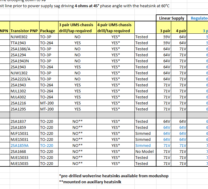

Check the BOM it states the TO264 (NOT FOR UMS).
I think BOM sheet 2 could have something like this added;
Agreed. I just bought transistors that work with the ums, so I got most of it taken care of. I still need to tap holes for the other 3 transistors. Does anyone have a link to buy threaded inserts or a part number? All the ones that come up when I search look a lot different than the ones that came from modshop.

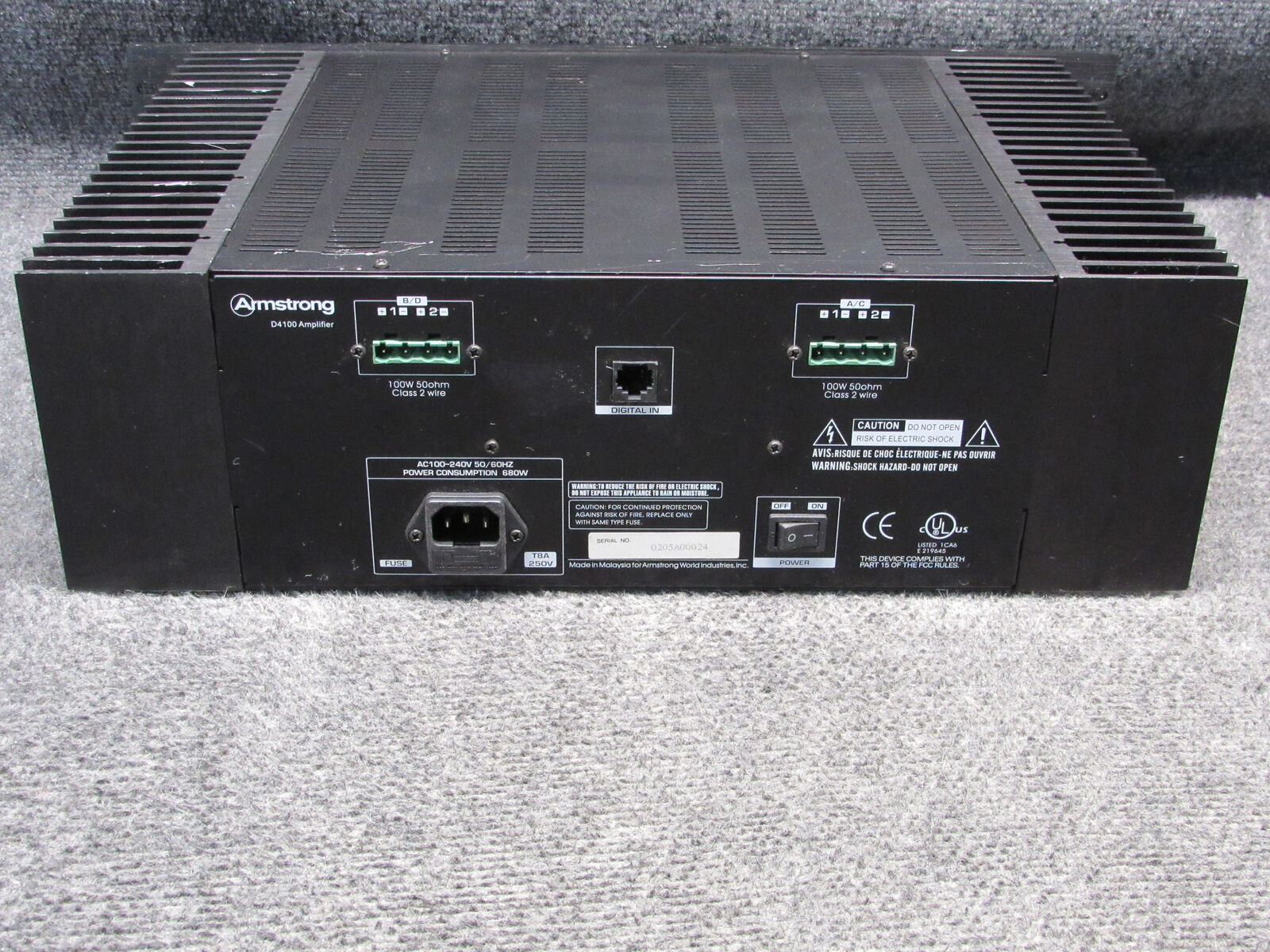

If you are poor/cheap (me). I have 2 cases like the "dissipante" 5U X 300mm for 80$ (broken EBAY amps). They came with 2 working 400W SMPS !!
