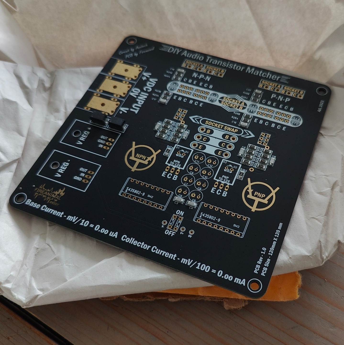

Mailman came by today!
Thanks to @fireanimal once again, this time for providing me with the much needed Transistor Matcher! All SMD's presoldered at my request... Absolutely amazing 🙂

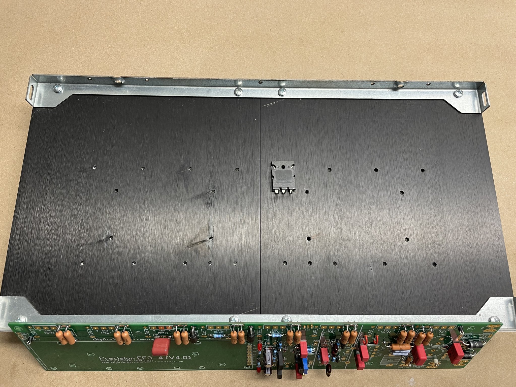

Did Modushop do the drilling on these heatsinks?
I only aske as this might do my future order of a 400mm/4U chassis much easier if they already have the drillfile.

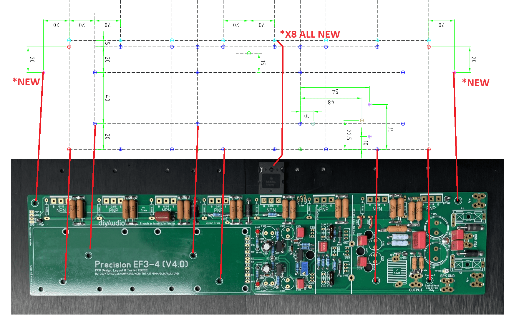

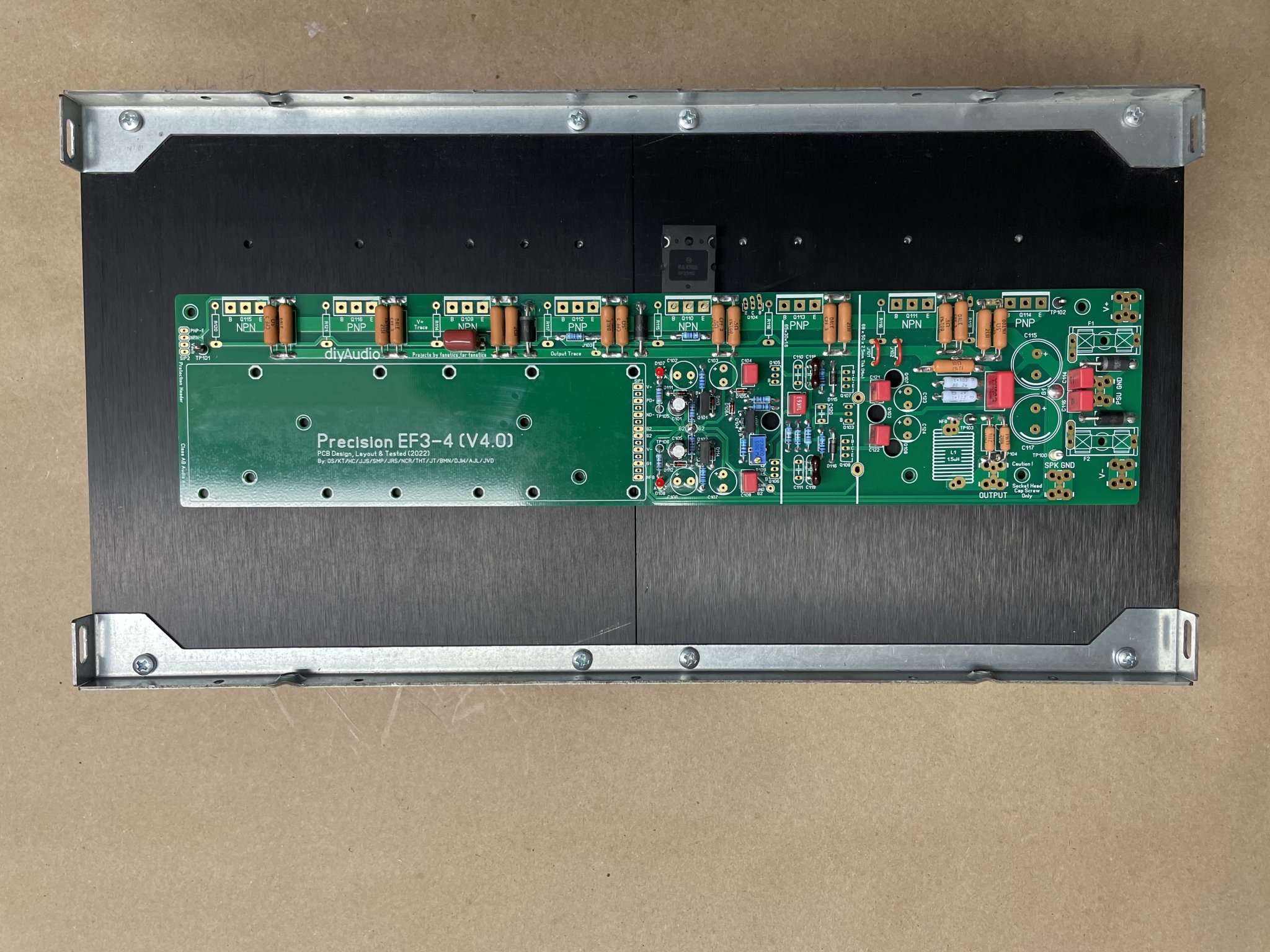

I’m a bit confused by the build guide and chapter 21.3. Heatsink hole location.
I have a 5U, 400mm and TO-264.
In the build guide it looks like I’m off by 5mm to use the UMS standard hole.
Why would I not use those 8 pre-drilled holes?
You could if desperate, but the transistor legs would be bent past 90 degrees/excessively/awkwardly, especially if you use 8mm heatsink standoffs. The TO-264 package is taller than TO-3 making the bend point for the legs lower down, and the holes on the UMS heatsink are designed for TO-3 transistors. If using TO-264 it is strongly recommended to tap new holes higher up so the TO-264 legs are bent at 90 degrees into the EF3 PCB.
have you got any TO-3's to do a sanity check? find the holes that work for the PCB, then go from there. I believe the UMS was meant for TO-3's and not TO-264s. So the holes should all line up with the PCB and TO-3's, however for the EF3-4 an additional 2x PCB mounting holes need to be drilled anyway, and you will need to drill and tap driver and Q103 holes also, unless you opt for drivers on standalone heatsink.
Or yes as you say, your heatsink hole pattern is for something different entirely, may take more experience members to chime in here.
Someone correct me if I'm wrong but this is my understanding of it for @deerhunt 's case (AS opted for TO-264 outputs), I don't have a 'UMS' heatsink here though.
Should be no need to drill/tap anything if you opt for TO-3 outputs and ignore the two outer-most PCB support holes, AND use separate driver heatsinks, although your PCB will be flimsy until the outputs are soldered in place.
