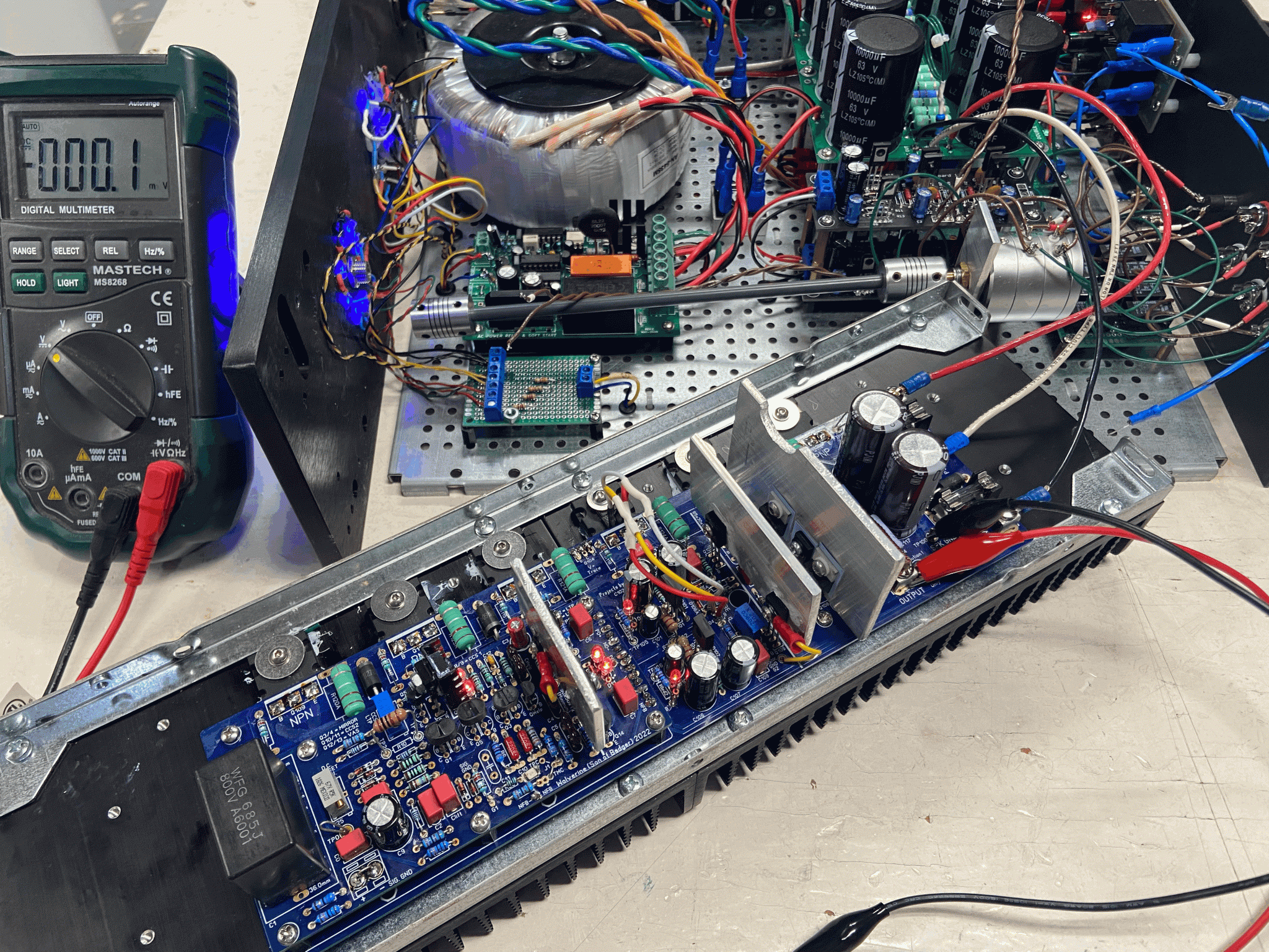

Sorry for the belated response; we were inundated with family over the past few days which made diving into the amplifier impossible. Now that our family has left, I have time to spend on my amplifier problem.
Here are the basics, with the input shorted and nothing on the output:
Rail voltages: +/- 48 VDC
TP101-TP102: 0.0 mV
TP1-TP2: 5.02 VDC
TP100-TP104: 0.1 mV DC
TP100-TP104: 0.0 mV AC
R109 is a 200R pot and is working perfectly, contrary to my earlier assumption. However, the reading across TP101 and TP102 stays at 0.0 mVDC regardless of how R109 is adjusted.
I took a few readings (and would be happy to take far more) with DMM- at PSU Gnd:
D105A (cathode side): 0.383 VDC
D106A (anode side): 0.427 VDC
R110: 0.153 VDC (same reading on both ends)
C110: 48 VDC (on the rail side)
C110: 0.382 VDC (on the other side)
C111: -48 VDC (on the rail side)
C111: -0.423 VDC (on the other side)
I don't know which other readings would be relevant in diagnosing the issue with this amplifier.
All advice / questions are appreciated!

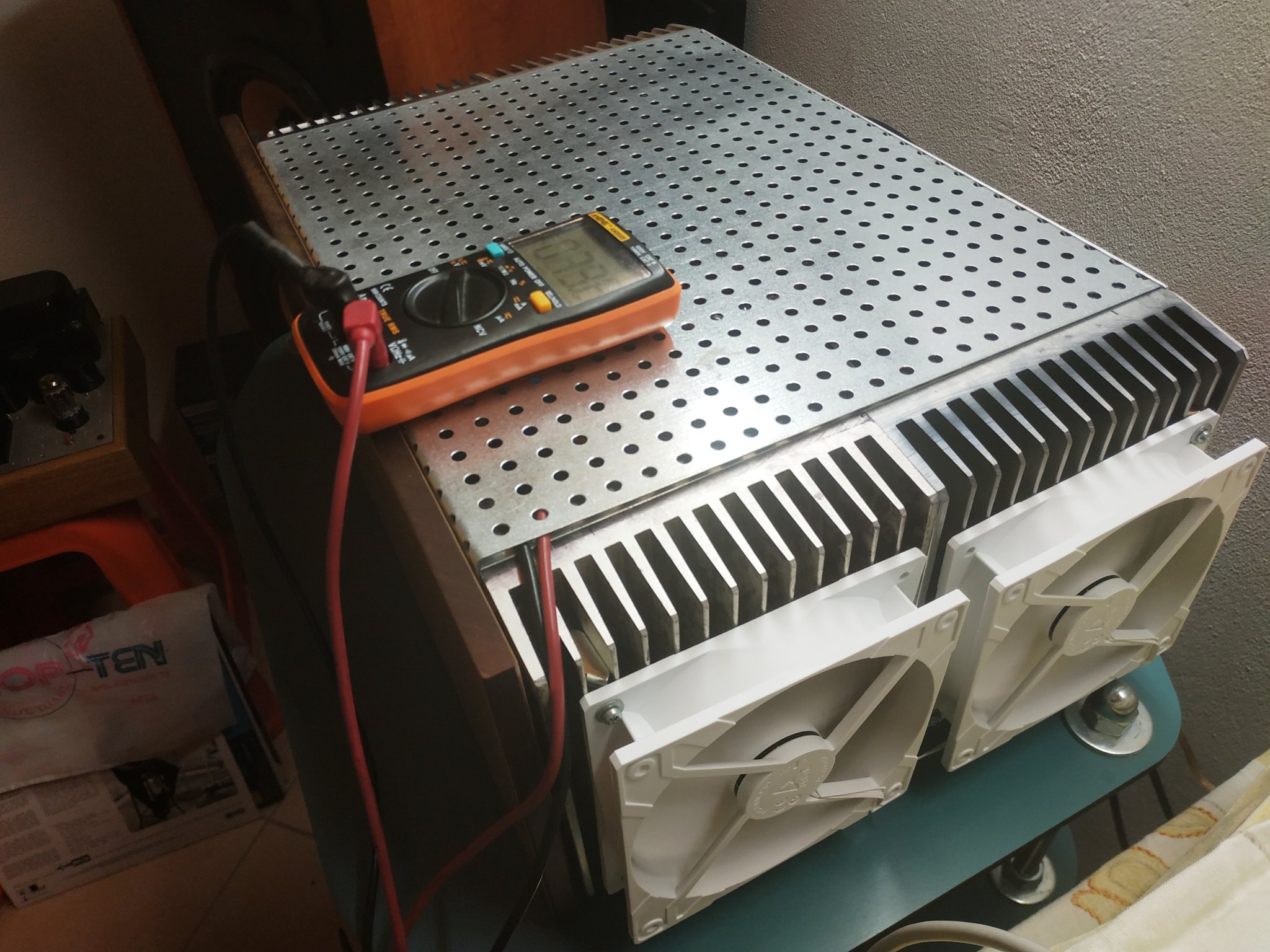

With all due respect to your construction, I would like to draw your attention to the size of the heatsink, which I see is small if I judge from my own heatsink. you will have quiescent current stabilization issues at 44mv it will try lower and lower to stabilize it . You must put fan coolers.

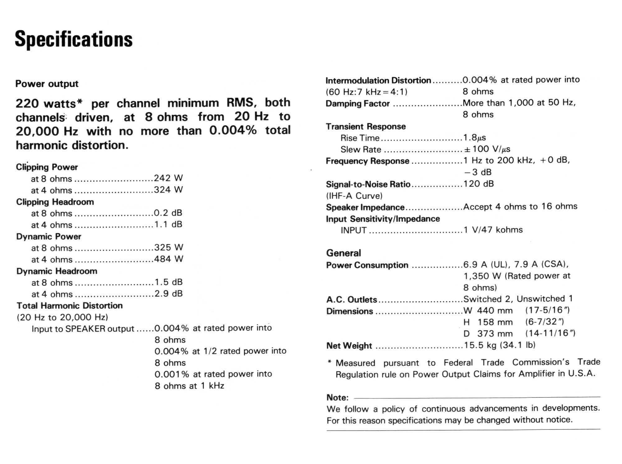

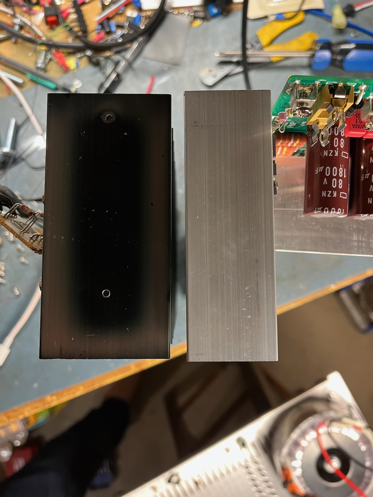

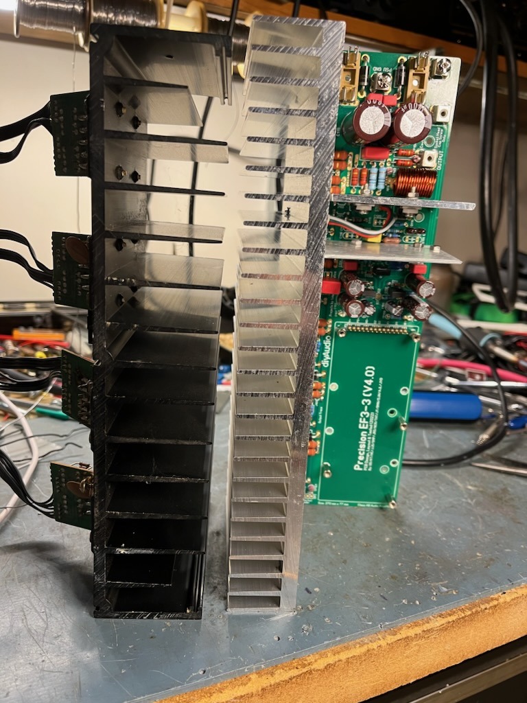

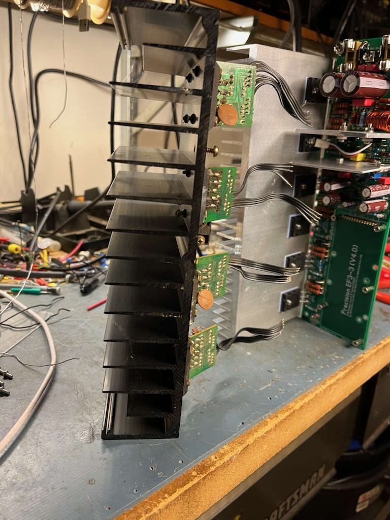

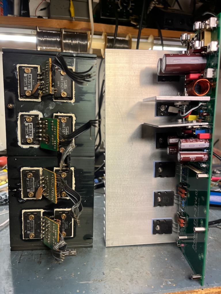

OK, Question....
I'm going to compare a heatsink from an amp that was built in the early 80's and I've had it since 84.
Here are the spec's...
Here is the heatsink as a comparison to what I'm going to use for the Wolverine,
Notice the M2 put the equivalent of 16 semi's, (8 per channel)
The rail's are at 90v's.
Yes, it does have a fan but it's never turned on... Curious, I checked it with my hot are gun and indeed it does work.
So can someone explain to me why the heatsinks I'm using, BTW, one of the new Heatsinks is heavier than the M2 heatsink and It's only cooling halve the semi's, so why am I being told they are too small???

My dimensions heatsink 40x 155 x 280 mm ~ 57V with an ambient temperature of about 30-32 in the summer the temperature on my heatsink reaches about 42-45 C without continuous loud music, with the quiescent current down at 30 mv.....now with the coolers fan ready steady always 38 C and quiescent current between 42-45mv with continuous loud music. And the flow of the fans should work at about 20% and keep this temperature constant at 38 C in a calm state the amplifier.🙂🙂🙂🙂🙂
