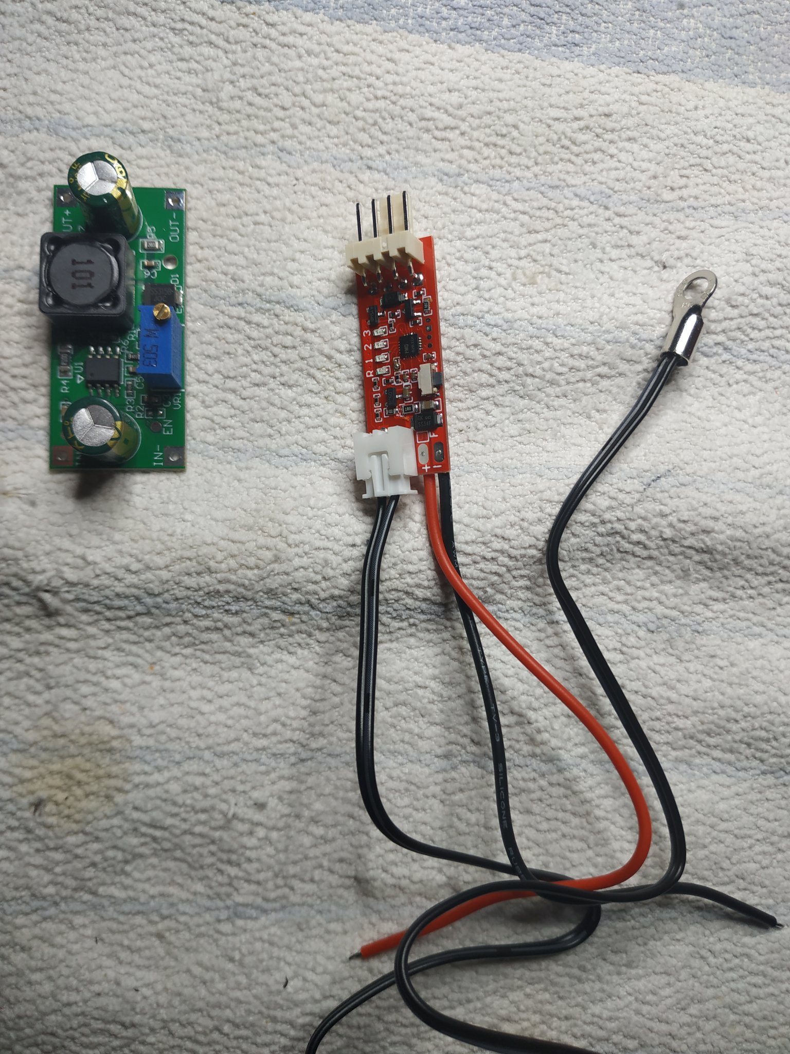

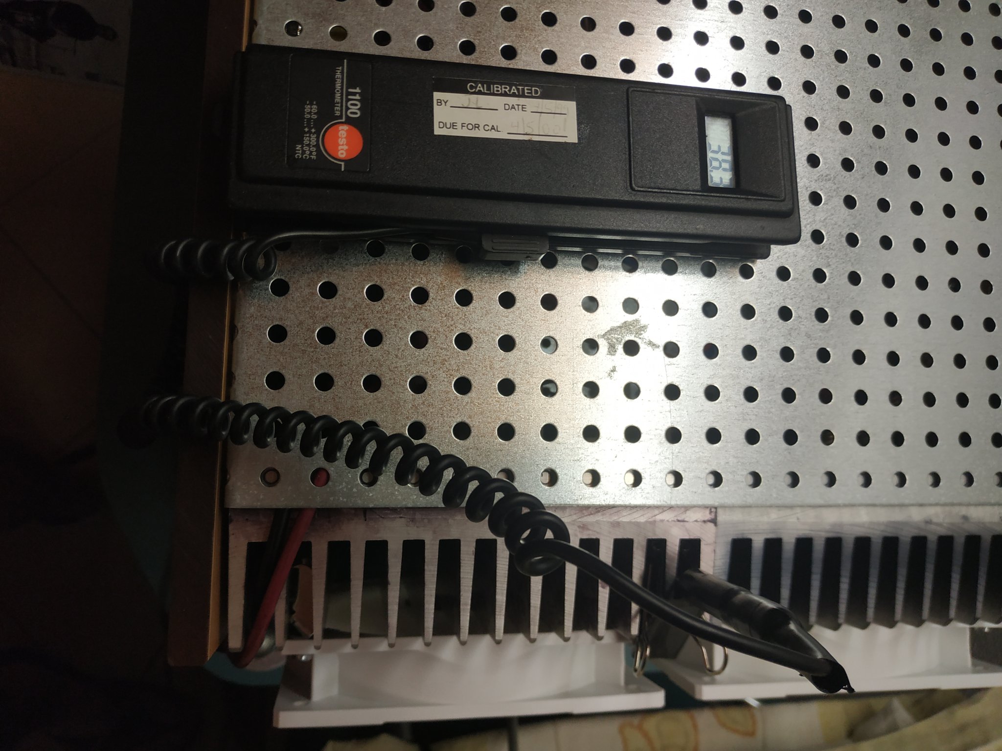

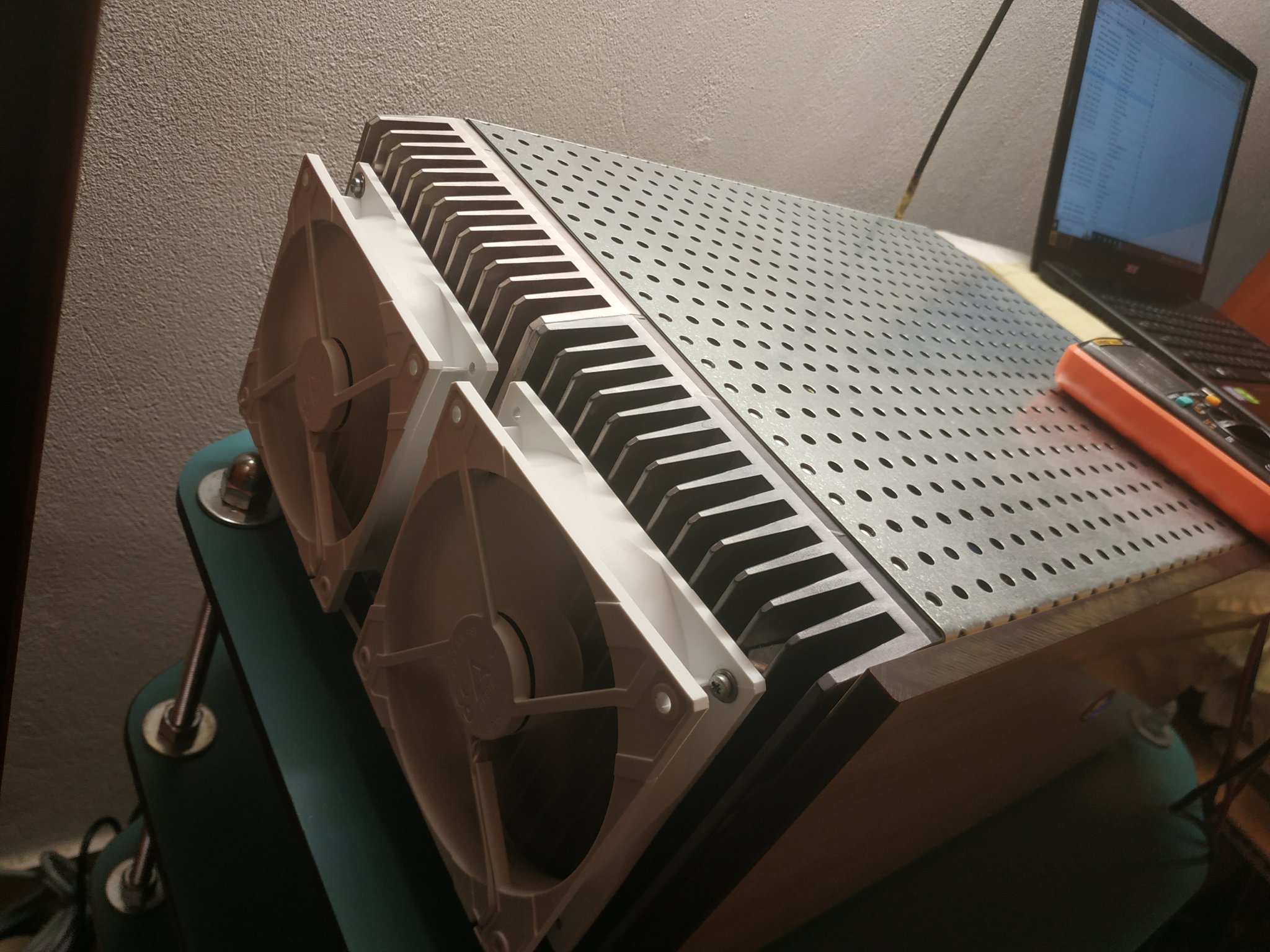

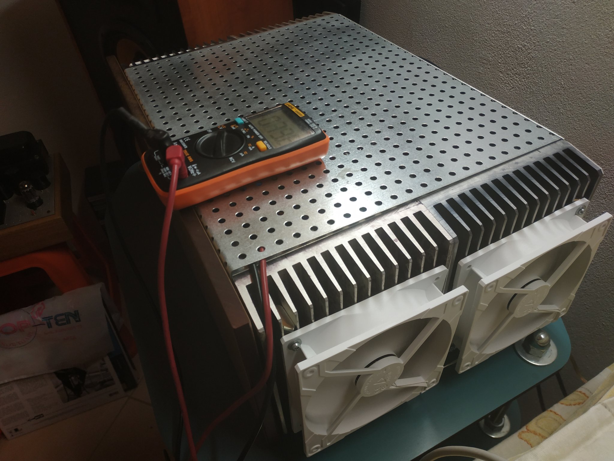

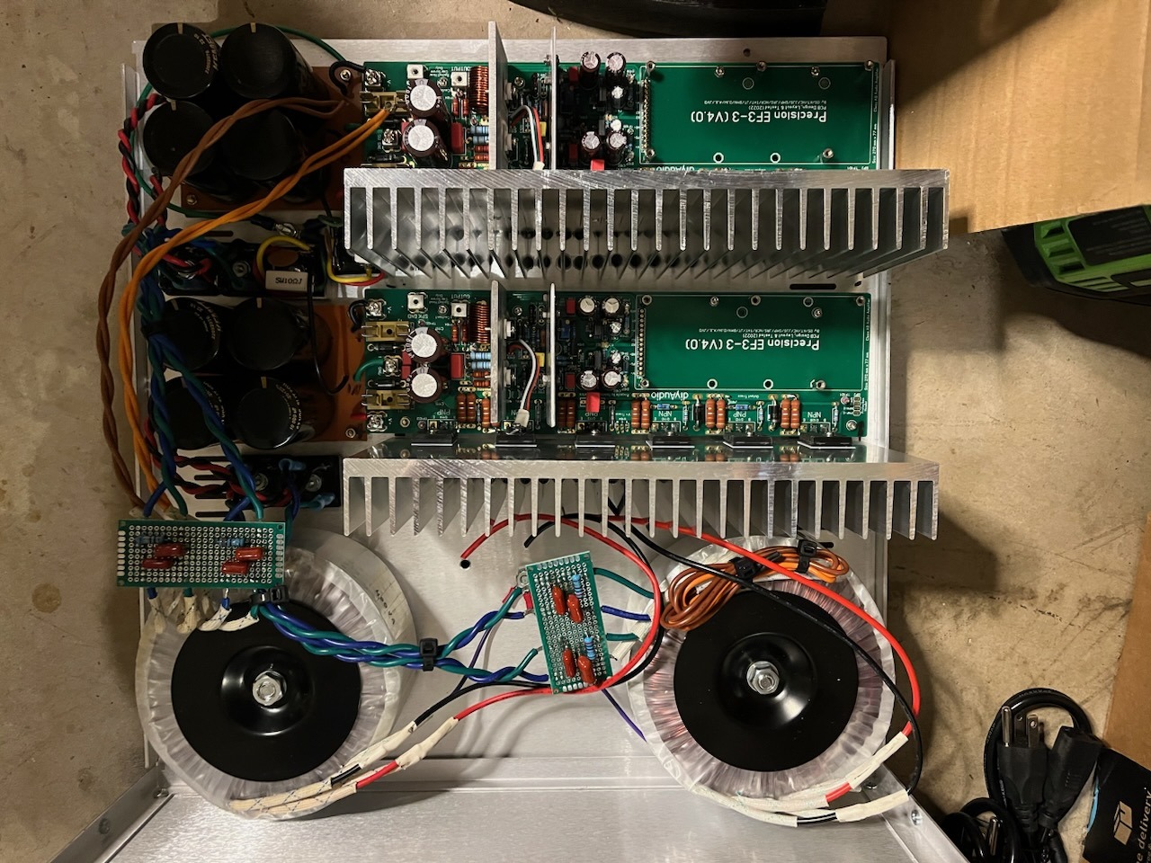

I put these pwm fans controlled by a processor over the heatsinks and reduce the temp so I can get a constant 38C over the heatsinks. However, the quiescent current after an hour drops from 44mv to 38 to 40mv and the heatsink temperature remains constant at 38 degrees. I play music at high volume. Is the temperature trapped inside the box to blame? Can someone explain the quiescent current mechanism and the role of transistor Q103 and Q104.

The bias is responding normally to the increase in ambient temperature inside the amp chassis. A decrease of 4mV is nothing to worry about. It takes well over an hour almost 2 hours for the amp to stabilize temperature. The build guide recommends adjusting the bias after its warmed up for this reason. Put the lid on and turn it on for a couple hours, and adjust it from there.
Hi Nikos,
You don't need the fans or the temperature controller the temperature will increase and decrease with signal level.
The Vbe multiplier circuit controls the bias for you.
During burn in take some more time to allow the amplifier to be at a stable temperature before setting 44 mV
I hope this helps - Andy's post above is right about the time required being a couple of hours
- Dan
Thank you for your replies.
Μy heatsinks 28 Χ 15.5 Χ 4 cm are kind of small, that's why I added the fans for uninterrupted hard operation of the amplifier.
I didn't think it would take two whole hours for the temperature to stabilize... I have adjusted the quiescent current after half an hour... so it is correct to adjust the quiescent current after two hours of operation of the amplifier in a quiescent state?
