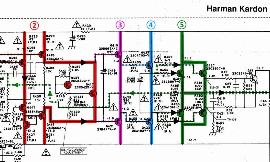

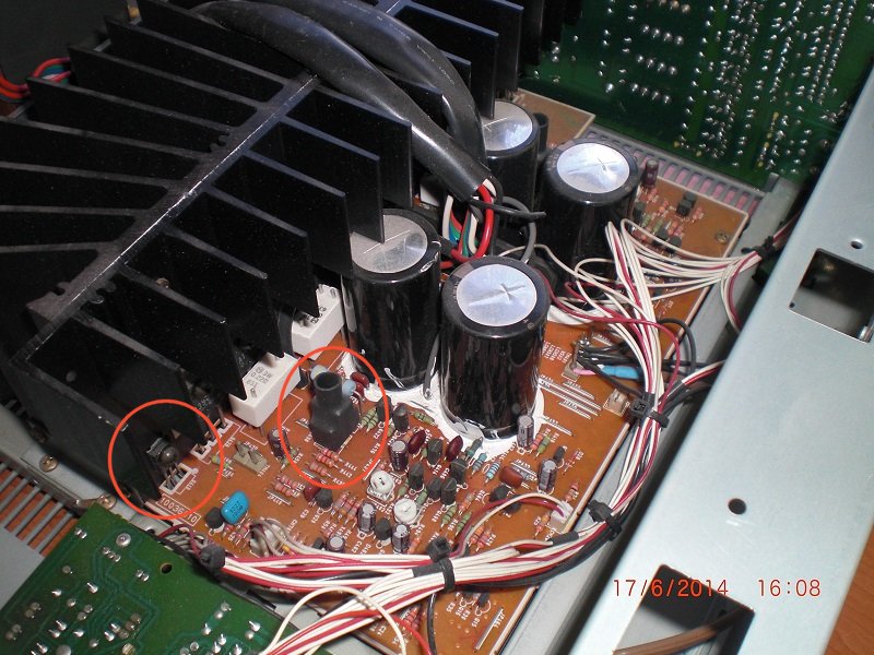

I have a picture of the very original Wolverine EF3 (HK680- below).
I just copied the Vbe , as I never built any previous EF3's.
Left circle is HK's (Q104) , and the right circle is Q103 + 2SC4793/A1837.
They use 2SC3423-Y as Vbe (2X). I own the HK , it is rock solid , thermally.
I have not personally ordered my new EF3's , might redesign the whole circuit.
Might go with a ambient Vbe using the "leach" 4 diode method to establish the ratio.
Diodes don't have Hfe AND Vf , just Vf vs. temperature.
I'll use my other Wolverine board as a "guinea pig" for this new Vbe.

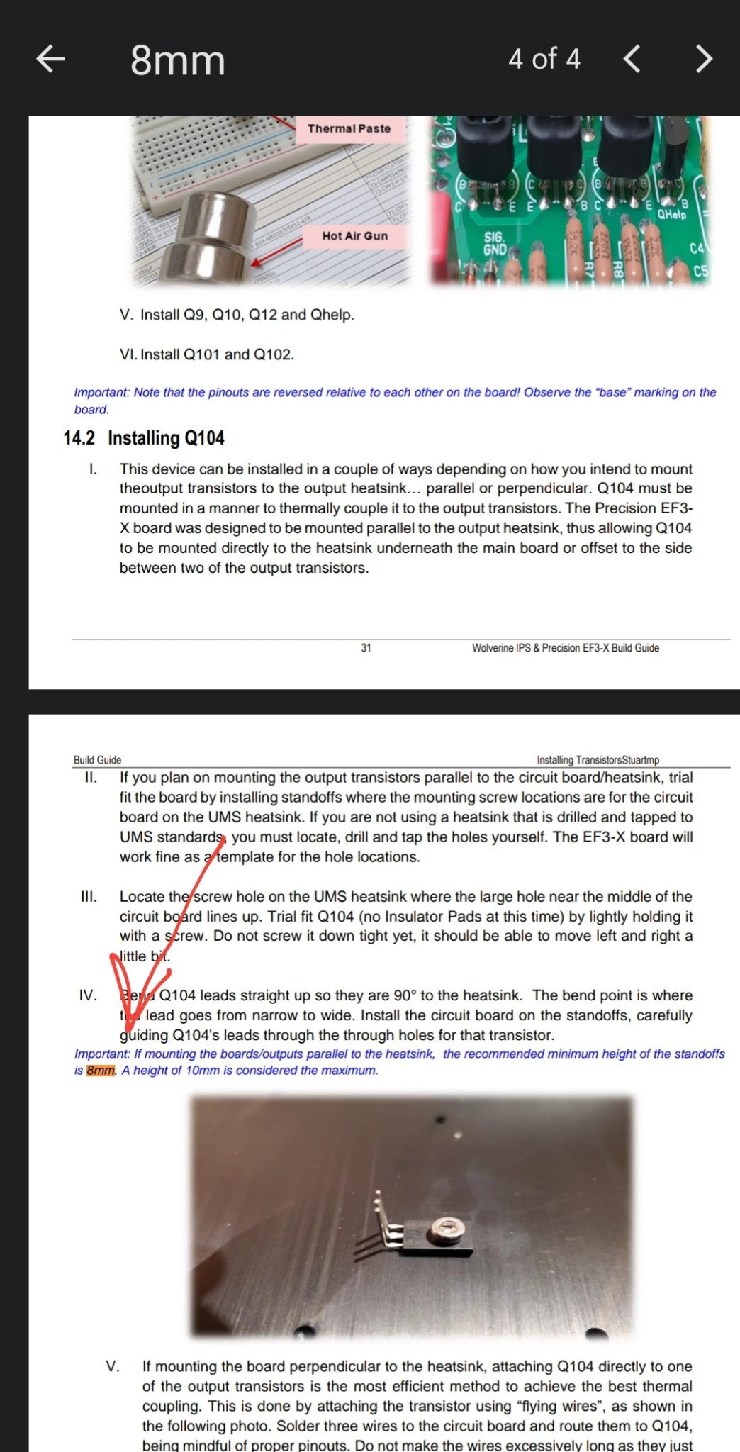

A quick question, maby it has been answered in this thread -but can't seem to find info in the BOM or build guide??
How many spacers do I need for the main EF3-4 board to heatsink.
I buying a chassis from modushop that hasn't been precut due to MT200 outputs.
I found these male/female (M3)10mm length on mouser, but how many should I add to the basket? 🙂 and is 10mm ok?
https://www.mouser.dk/ProductDetail/Keystone-Electronics/24337?qs=UWqYQ/2cZWuMPEm0DiFF0w==
Regards

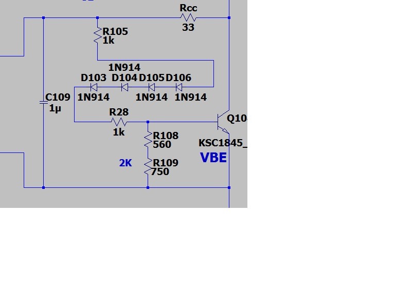

Just a wild guess, but maybe the presence of Rcc in the Wolverine circuit forced an over-compensation that was too much. I see there is none in the HK680.
Since Rcc subtracts Vbias current changes ... "it is added to give first-order cancelation of Vbias variations caused by VAS current changes" (SELF ch.15) ,
it would increase compensation.
It is surprising HK does not use it , since the 680 is not a current source based VAS ??
The Wolverine is - it's topology has the most stable VAS Ic.
Vbias calculations can be modeled , but rarely exactly reflect the real world.
Ideal is a temp-co sensor with 4 junctions that would be the exact inverse of the driver/output junctions. Like the ON "thermaltrack" (NJL3281).
Here we have MUR120 integrated with a NJW0281 . I've seen a few modern "leach amp" EF3's that tested spectacular with this arrangement. (below).
Also , I have no base-stoppers (jumpered) on my drivers ? Why , did it oscillate ?
I am running TTC004/2SC4793/2SC3519 (sanken) as EF3. Close to the HK.
Devices will determine the tempco. You would nearly have to offer multiple values(BOM) to compensate for different devices.
PS - I ordered 10 MUR120 SMD's , I like "tinkering"....

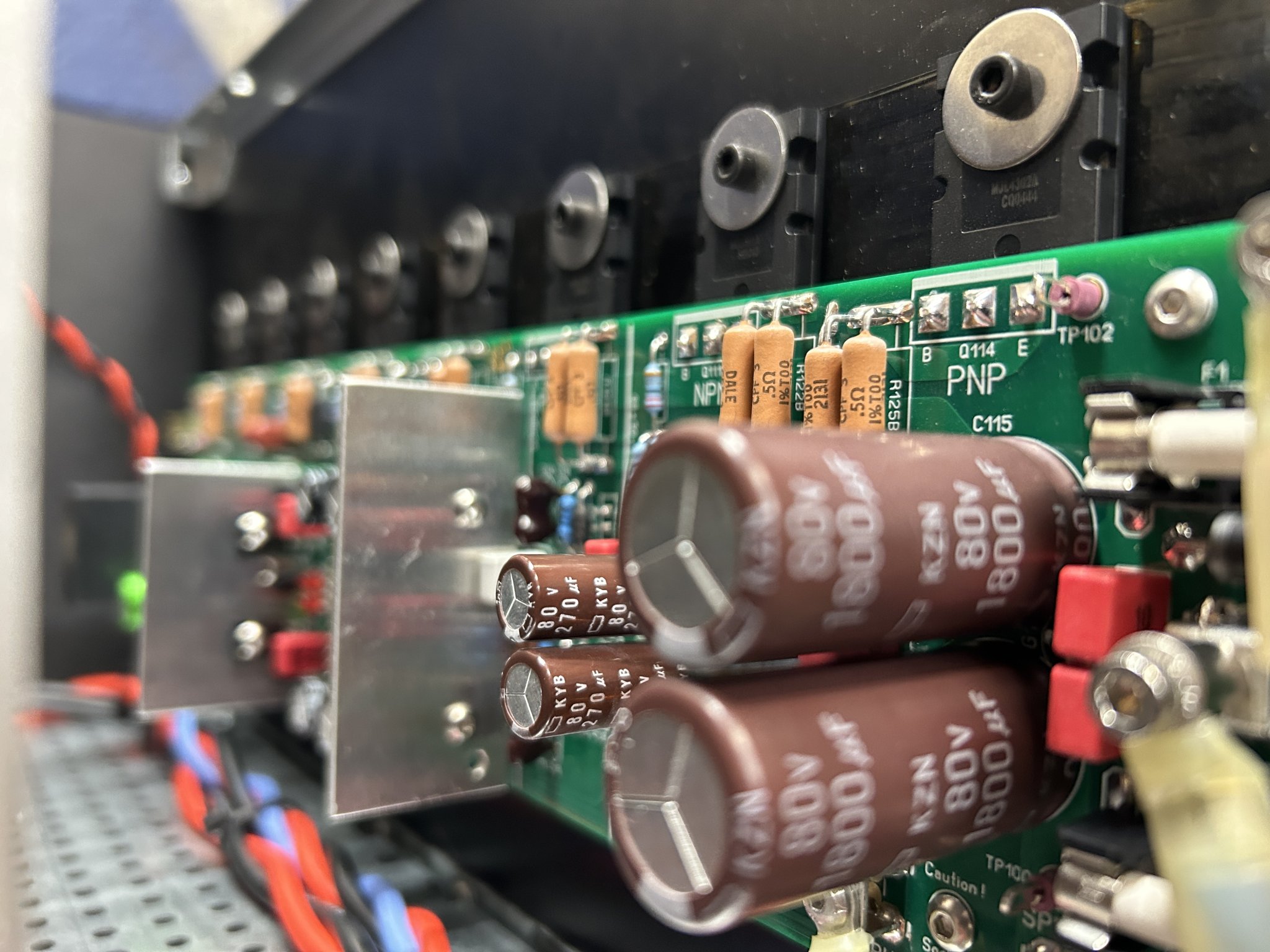

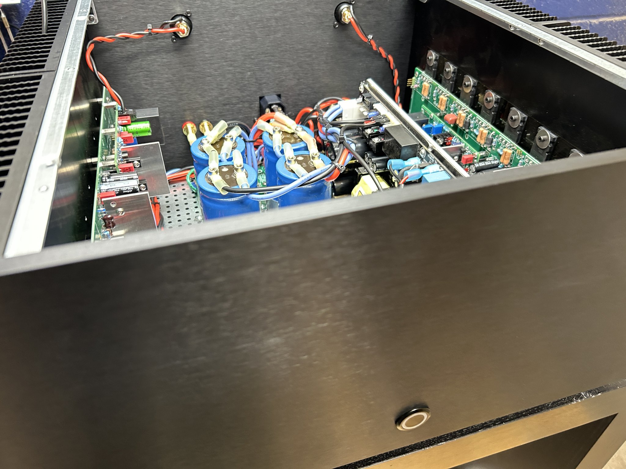

Hey all.. I have lurked for quite a while but throwing myself into the pack. Lol. fireanimal was super kind enough to set me up with a head start on this amplifier and while my experience in electronics is pretty extensive, it’s more in the digital domain, microcontrollers and digital circuits and my RF experience is all 1ghz and above, but I do love my music to sound great!
So sort of an intro post and was curious if anyone knew how many members are active or have completed their builds?
Reactions: fireanimal

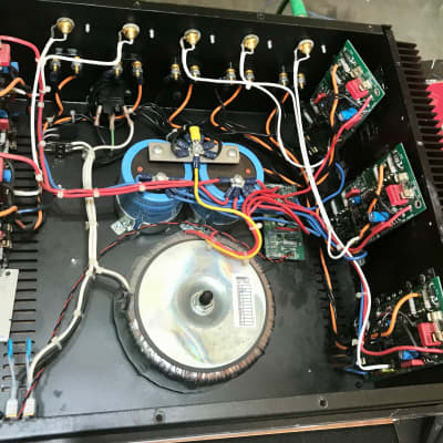

Fire , what SMPS ? I'm at the trafo purchase point , debating whether to buy into all that poundage...
I see you have large caps powered by the SMPS .. no issue ??
OS
https://micro-audio.com/store/product/cobra-s1/
It is a cobra S1/S2, I also used these to power my EF3-3 builds I did, and they have been running now for almost 15 months without issue.
The 20k per rail is sufficient, I never added any additional caps on my EF3-3 builds.

Wow , pricey !! $330 - wow ! MUST be nice...
For $99 + 50 shipping , I might get the whole case/trafo ... everything (below).
I'd use modern PS PCB's instead of those old electro's.
