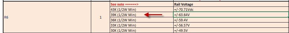

question on R6 (43k) resistor - no mention like other resistors in THE BOM it needs to be 1/2w, but the parts listed are 1/2w. I have 1/4w on hand, so I want to make sure I'm not setting myself up for a failure using a lower wattage part?
Can I use 1/4w or do these need to be 1/2w? Also in the process of a c4793/a1837 conversion to MJE drivers.
Ohms law calculator is giving me 110mW, assuming 68V across 43k at ~1.6mA - so I think I'm good with 1/4w resistor, but can anyone confirm for me?
Your calculations are correct however for 68V rails I would probably use the values shown for 64V rails rather than the 70.71V values as slightly more current there will ensure the forward current for the LED is past the Knee point. They are marked in the BOM as 1/2W. There are other reasons to use a 1/2w package. In that location 1/2W is preferable over 1/4W

I'm using the GB 1 BOM from May 29th and it doesn't have 1/2w - but I do see it is notated in the GB 2 BOM from the same date (note to self - check GB2 docs for most accurate). Thanks for the answer and I will change this back to a 39k 1/2w to ensure safety and accurate current flow.
Brings up another question: I just changed both input boards for +/-70Vdc (since my PSU varies from mid-68 - low-69Vdc) and updated R6, R15, R17, R23 and R24 along with updates to change the drivers to MJEs last night. Was able to get Channel 1 updated, burned in and playing great, and the updates done to Channel 2, but not enough time last night to set-up and burn in, so I was planning to do that this evening.
Before I do - I will change R6 back to 39k 1/2w from the 43k 1/4w currently installed - as Stuart provided earlier.
Does this mean I need to go back for R15, R17, R23, R24 to the original values for 64Vdc rails, instead of the updated 70V rail values I changed to? I want the amp to be reliable once I get all these updates/fixes completed.
Yes, I would encourage you to use the values for 64v rails.
Please ensure R17 is mounted adequately above the pcb as recommended in the build guide.
Thanks Stuart - I have made the 64V rail updates to both boards and they are currently "burning in". I will be listening to some music again very shortly. Thanks, as always, for the support and being a phenomenal resource.

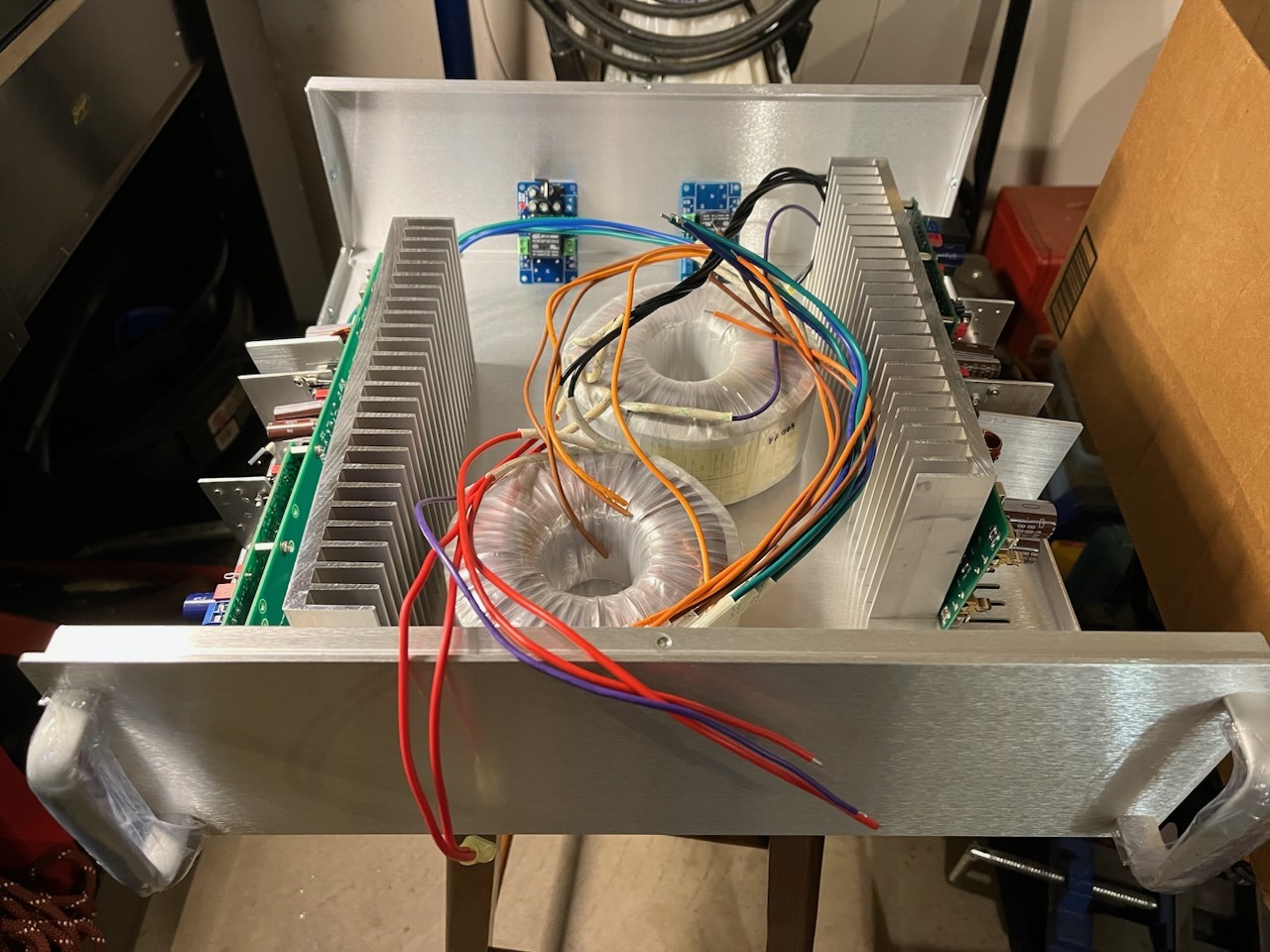

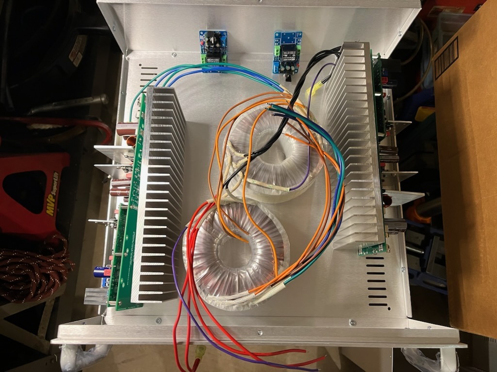

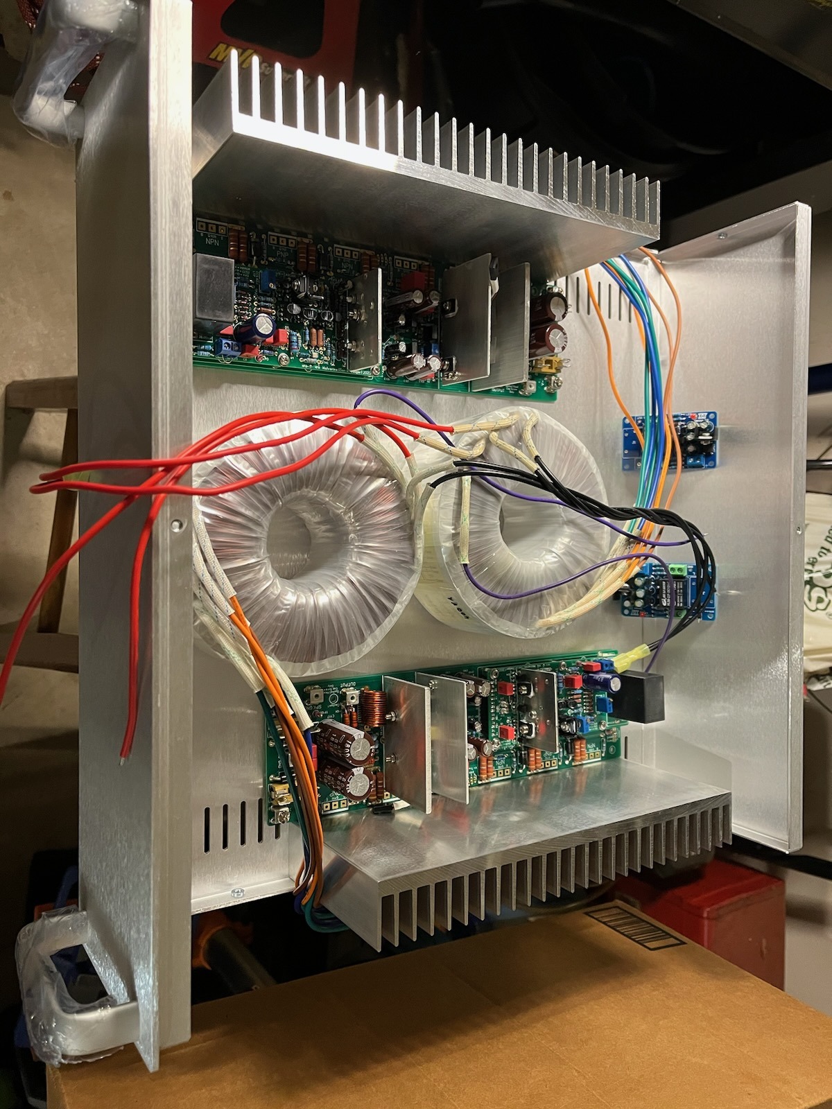

Purchased a 16 x 16 x 5 inch with handles for about $115 with shipping from Par metals. Nice chassis.
The Toroids I purchased have a shield that has a purple wire that gets chassis grounded.
Question for installing all this for the least amount of possible noise or should I not worry about it to much?
See Pics.

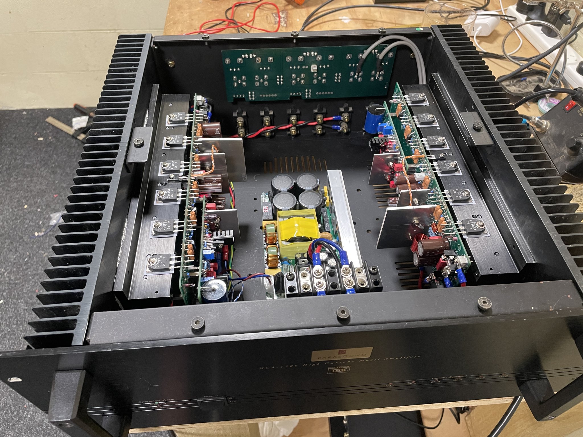

Heres mine - cannot hear a mouse fart with my ear on the tweeters or woofers. DC offset bang on 0mV stable both channels, 44mV bias stable, AC on the speaker outputs is 0.000V on all the meters I have here.
Predrivers TTC/TTA
Drivers 2SC4883A/2SA1859A
Outputs 2SA1386A/2SC3219A
63V rails.

You need to think about proper ventilation also, otherwise those nice heatsinks are not going to be very efficient and temperature will rise inside the case. See if you can arrange heat sink and openings in bottom and top plates such that air can flow easily in vertical direction.
Please consider if room allows stacking your transformers at the front of your chassis.
If you plan to mount your amplifier boards perpendicular to the heatsinks don't be afraid to mount one of the amplifier channels upside down so both of the input stages are at the rear of the chassis close to the rca input.
Check the how to wire an amplifier pdf in the Dropbox folder or review Daniel's youtube video on layouts for further tips
Reactions: nocturnal1974
Can't stack trans, too thick! In the last two pics, wouldn't the heatsinks create more of a isolation shield? Yes, I've read the pdf and reviewed Daniel's vid. I'm also going to make Stubbers using the Quasimodo v4 kit.
