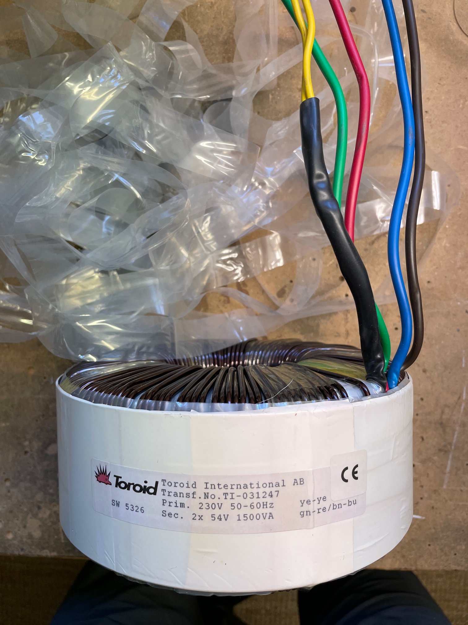

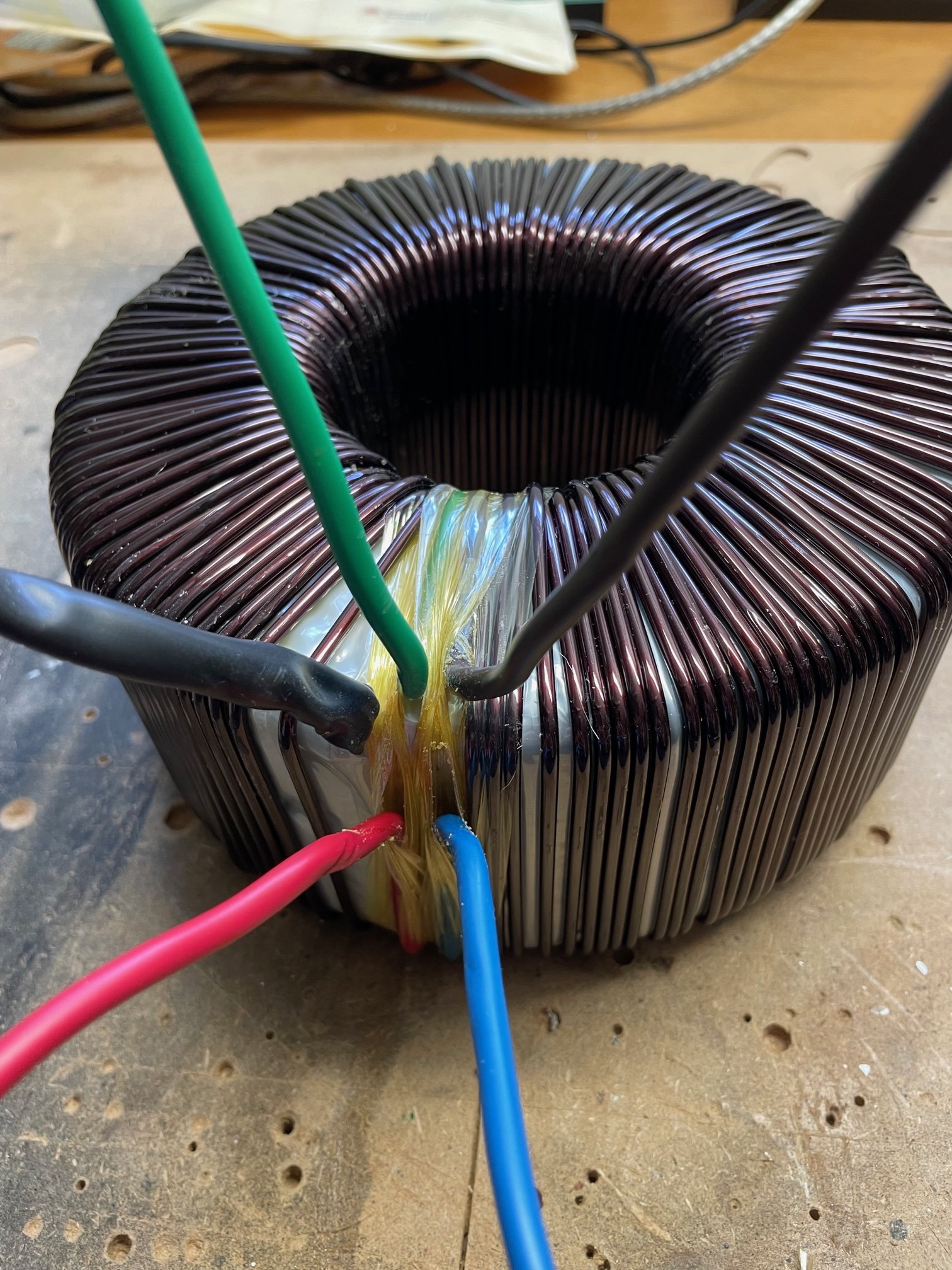

Yes it will be, without modification, but in the end its not worth it with that low of voltage. Search up transformer unwinding that will be your best option if you plan on reusing.
Counter-winding cost practically nothing to try, all you add is li'l extra series resistance (if you have open center toroid) If it becomes a mind sore you can address it later. You probably can't pull more current in exchange for the lower output voltage because the wires/core inside are dimensioned for higher voltage VA's. I'll agree it might potentially be a future extra cost if you can't stand it.... and even add some winding in the transformer in "opposite" direction. ...
I have done counter winding with no noticeable side effect, though not for audio applications.
A stereo pair of EF3-3 will draw a bit over 0.6A quiescent current, the output voltage at that current is of more use when deciding if it's possible to reuse the old transformer.55VAC is no load.
I'll see if I can lower the voltage on the tranformers.
Having said that, considering the total cost of the project, I would buy a new one, certainly no counter winding.

Why ? I had one builder with 87V rails (slewmaster) , he used an old 1KVA isolation trafo (60-0-60)... Worse case you would lose a little SOA but have lots of headroom ! 100V caps all around.I would not recommend a 55V secondary transformer.
You could also change the resistor ratio on the cap multipliers to drop the IPS voltages.
I personally ran my Slewmaster with 52-0-52 and 75V rails ... no issue whatsoever.
Be careful - those are deadly voltages !
OS
Personally I would play it safe, I wouldn't compromise the SOA. A transformer with 50-0-50 would be my max. for this amp, especially when using 4 ohm, 60 degree speakers. Jeremy created a spread sheet that clearly shows the SOA limits for various output transistors.
