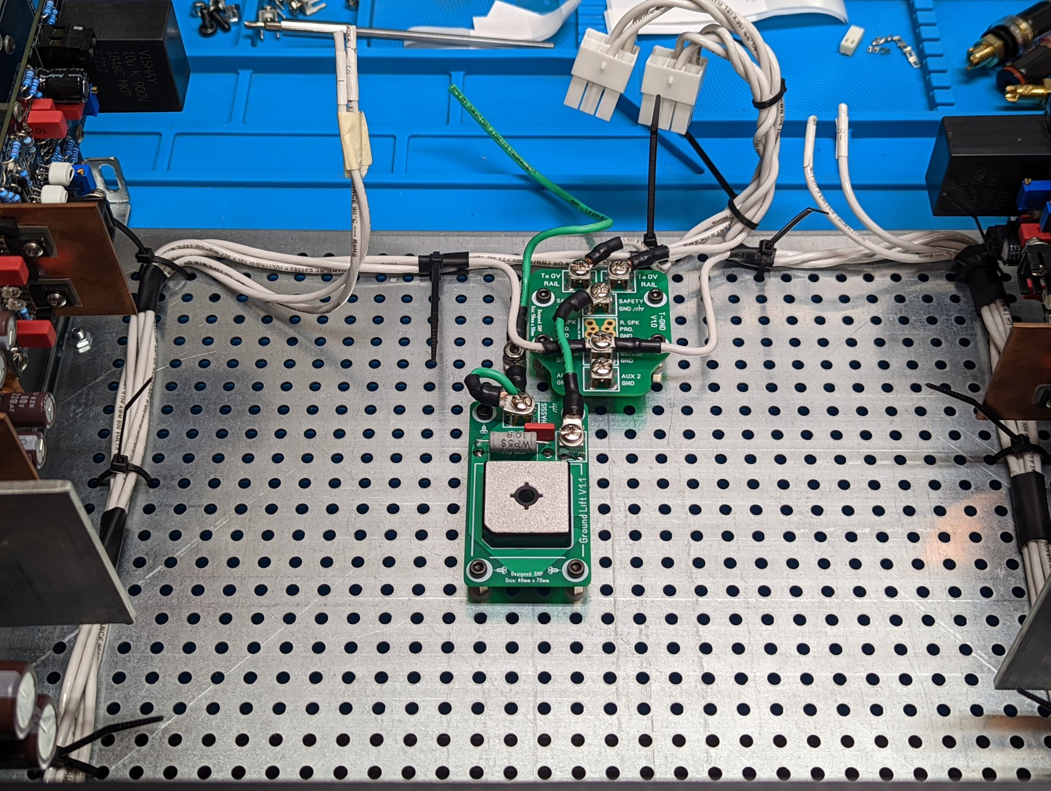

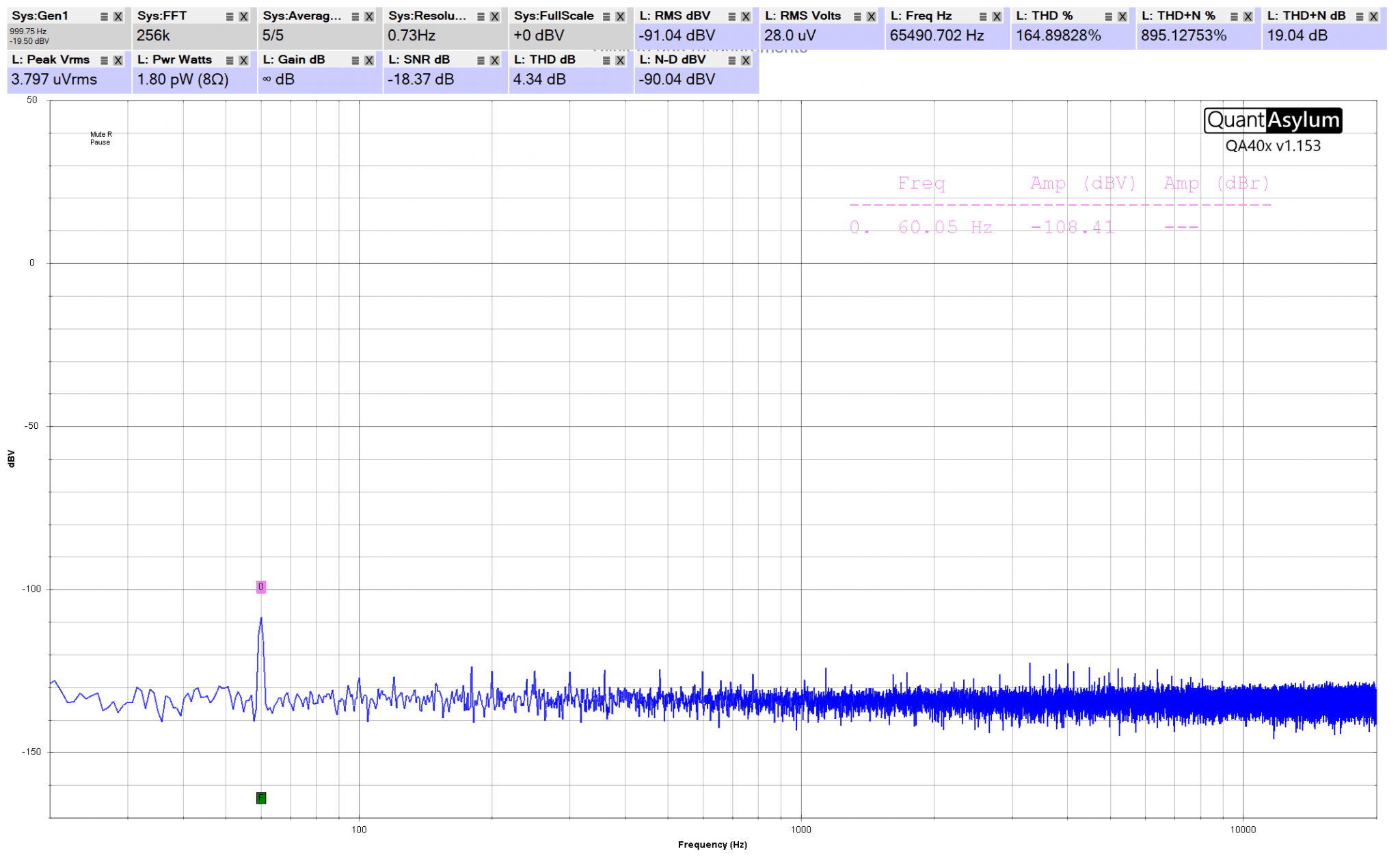

Thats pretty clean! Hope I can get the same. I will make the ground lift circuit I have a 35A BR spare here. Couple things - Did you have the cobra's heatsink/frame isolated from the chassis i.e mounted via nylon standoffs? (I ask because on the cobra the 0V is tied to its heatsink, whereas the hypex the heatsink is isolated from its 0V). And did you end up keeping/using the micro ripple eaters?This measurement is in Chassis with a Cobra S2 +-63v. This is with th 0v tied to the T-Ground PCB.

Are you sure about that? All the cobra SMPS I have tested the 0V is isolated from the heatsink. I didnt end up using the MRE's in my final builds but I do on my bench test setup. Just the ground lift and T-Ground.
OK good, because you want the heatsink tied to chassis ground for safety. If you have space for the MRE I would recommend installing, and then even a couple of 20,000uF caps per rail after it.

Yes there is a slight voltage loss, to be honest you wont notice a difference with the cobra straight to the Wolverine. Just be sure to use a T-Ground and tie the 0V output to ground there.
I plan on going straight from Cobra to Wolverine, myself (including Stuart's T-ground/lift).
From @fireanimal observations and testing, I can't imagine I'd be able to notice the extremely low levels of ripple currents present on the outputs of the Cobra... on top of the relatively high amount of the amp's PSRR.
Just my assumption anyhow... I wish I had time to build right now. Can't wait to tackle this project.

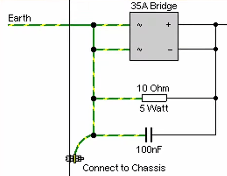

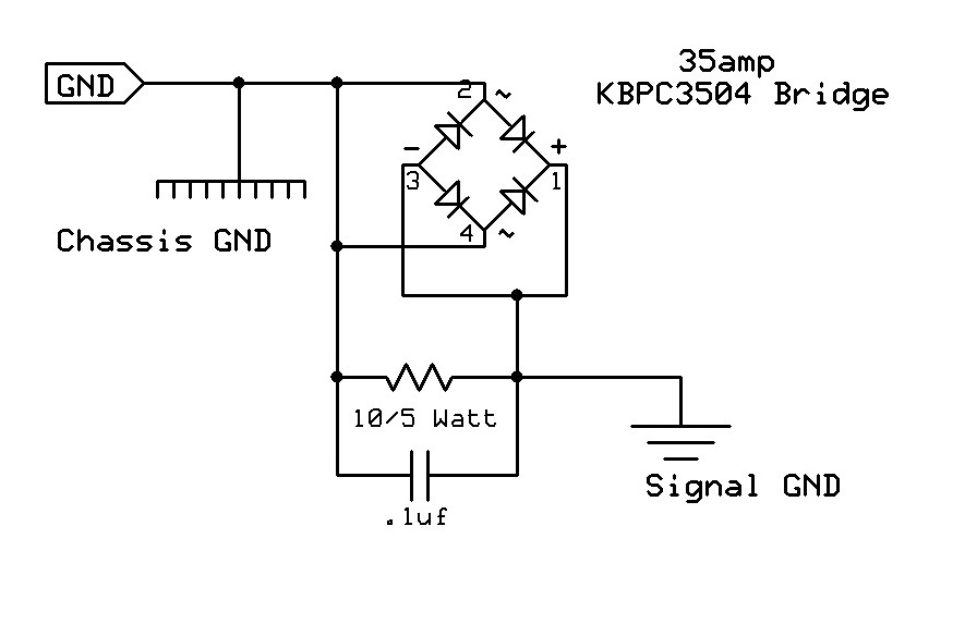

Re the ground lift, which diagram is correct or better, or are they just the same?
from @danieljw 's video here (thank you Daniel by the way, these videos have been so helpful, and I subscribed when you dropped the first one)
or from the wolverine documents how to wire here
I understand the top circuit has an additional RF filter installed parallel across the chassis ground and psu 0V line, however the top one has two sides of the bridge shorted and the other has only one side. Is one more "correct" or does it not matter due to the diodes in the bridge?

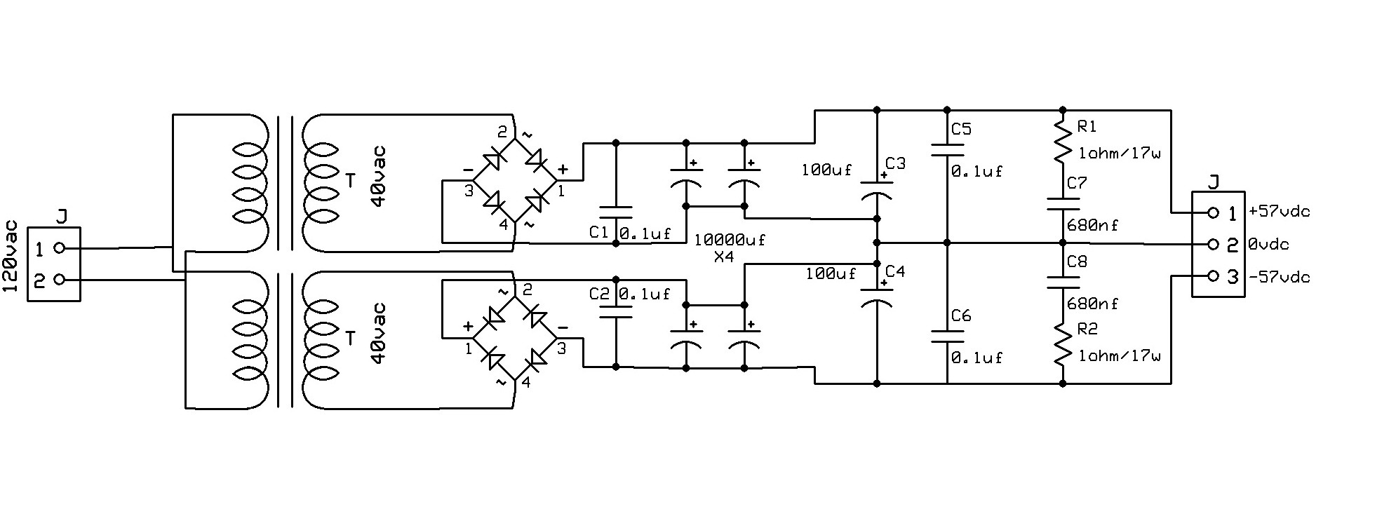

I read an article from https://www.tnt-audio.com/clinica/ssps1_e.html
Is it worth adding C1,2,3,4,5,6,7,8 and R1,2?
Any thoughts before I start...
