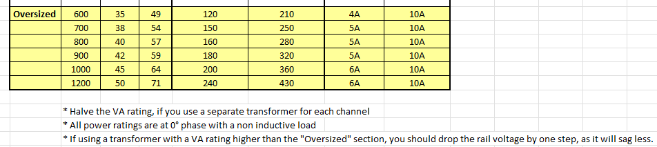

Hi. I am buying my transformers for a dual mono configuration and want to make sure i get the right ones. Is two of the 600va 71dc the correct transformer for oversized on the 3-4 board? Do I need a secondary winding to power anything? Thanks.

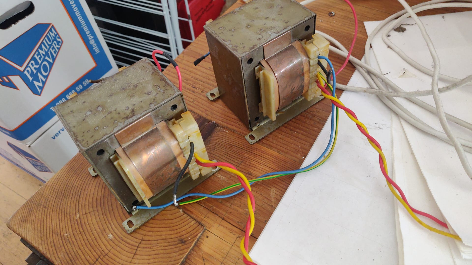

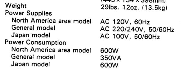

I'm thinking about building a second Wolverine.....the EF3-4...not sure yet. I've got these old EI Transformers from a Harman Kardon 665VXi. They both work...that I know but I don't know the VA rating. The service manual says this but the question is...is that for both or just one of them. I tend to think both so 175 VA per transformer which might be a little bit lowish....
Does anyone know these?
thx in advance

With a total of 350VA you shouldn't expect to much output from the amplifier.
I wouldn't build this one below 600VA, but that's just my opinion🙂

Are two 600va 71v the correct transformers for doing oversized dual mono on the 3-4 boards to get the max power? If not, what is the correct size transformers to get? Please help 🙂
600VA 50-0-50VAC per channel if you are doing a dual mono transformer LPS with 71VDC rails. 71VAC transformers would make 100VDC rails, far too high.
Mod edit: Please note the 50-0-50VAC is erroneous. Post a new question in the thread if you want correct information, or look at #3108 or #3113.
