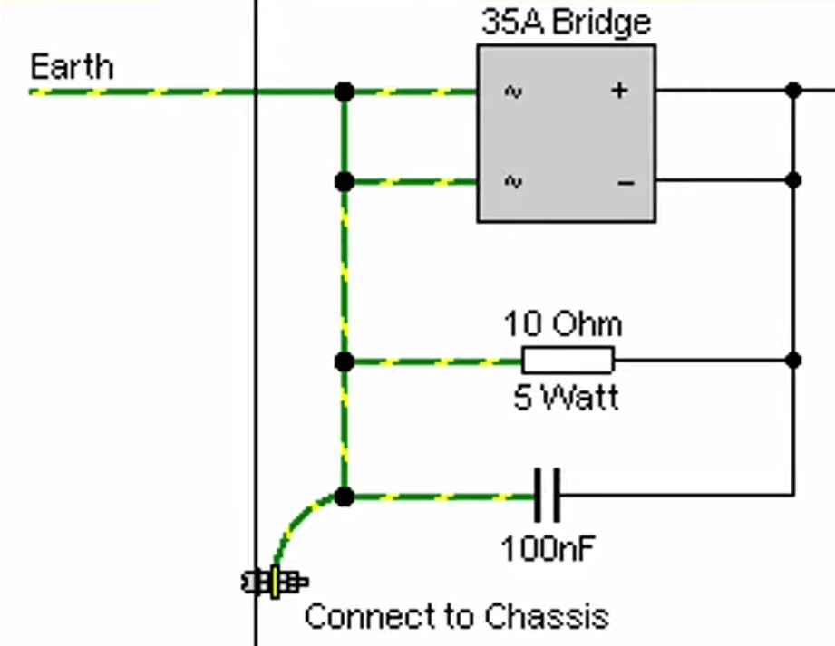

I have used both of these styles myself and both work. I prefer to include the 10 Ohm and 100 nF capacitor.Re the ground lift, which diagram is correct or better, or are they just the same?
from @danieljw 's video here (thank you Daniel by the way, these videos have been so helpful, and I subscribed when you dropped the first one)
or from the wolverine documents how to wire here
I understand the top circuit has an additional RF filter installed parallel across the chassis ground and psu 0V line, however the top one has two sides of the bridge shorted and the other has only one side. Is one more "correct" or does it not matter due to the diodes in the bridge?

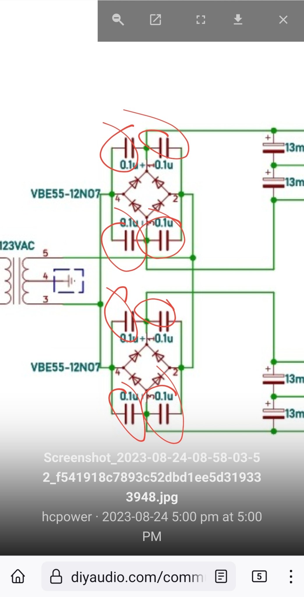

Is it worth adding C1,2,3,4,5,6,7,8 and R1,2?
Any thoughts before I start...

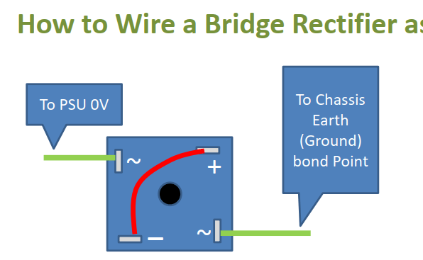

Try to draw the diodes in the bridge and you will see that the difference is in the voltage when the bridge opens and in the current load of the diodes

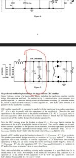

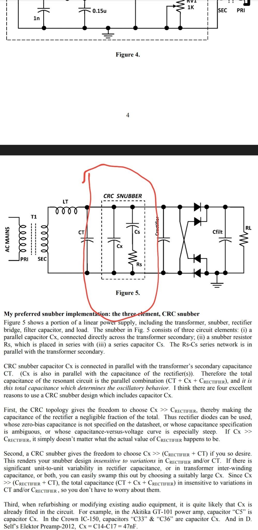

From what I understand the caps across the diode bridge is sort of an old practice. The caps were added to help a dampen the ringing from the primary winding as the diodes in the bridge suddenly switch off.
I believe this practice has been replaced by a cap in parallel and a zobel network across secondary winding.
(CRC Snubber)
Please refer to this thread for more details.

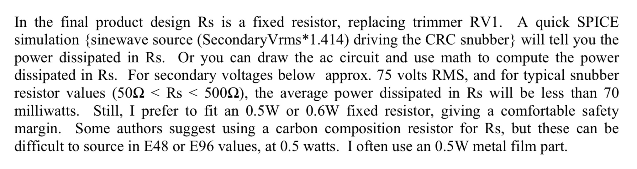

I understand how to measure with the Quasimodo V4 board but how would I determine the voltage rating of CT, CX, CS and the wattage rating rating for RS to use across say a 40-0-40 400VA toroid?

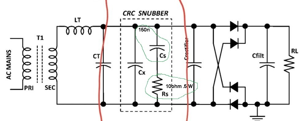

So to be clear... the snubber components need to be located as close to the transformer as possible, got it...
RS lets say I have to use a 10ohm resistor along with CS = 150n @ 160vac rating. The 10 ohm resistor can be a 1/2 watt? or does RS have to be around 5 0r 10 watts?
The answer(s) are in the excellent treatise that MJ has written about the construction of the Quasimodo in the link Stuart referred to above (page 7):
Of course, you can use a 5W part, nothing bad will happen, but it will be a pretty big resistor and the leads may not fit the pcb itself. The amount of power dissipated is small, even with 10 ohms. 1 watt is fine as well.

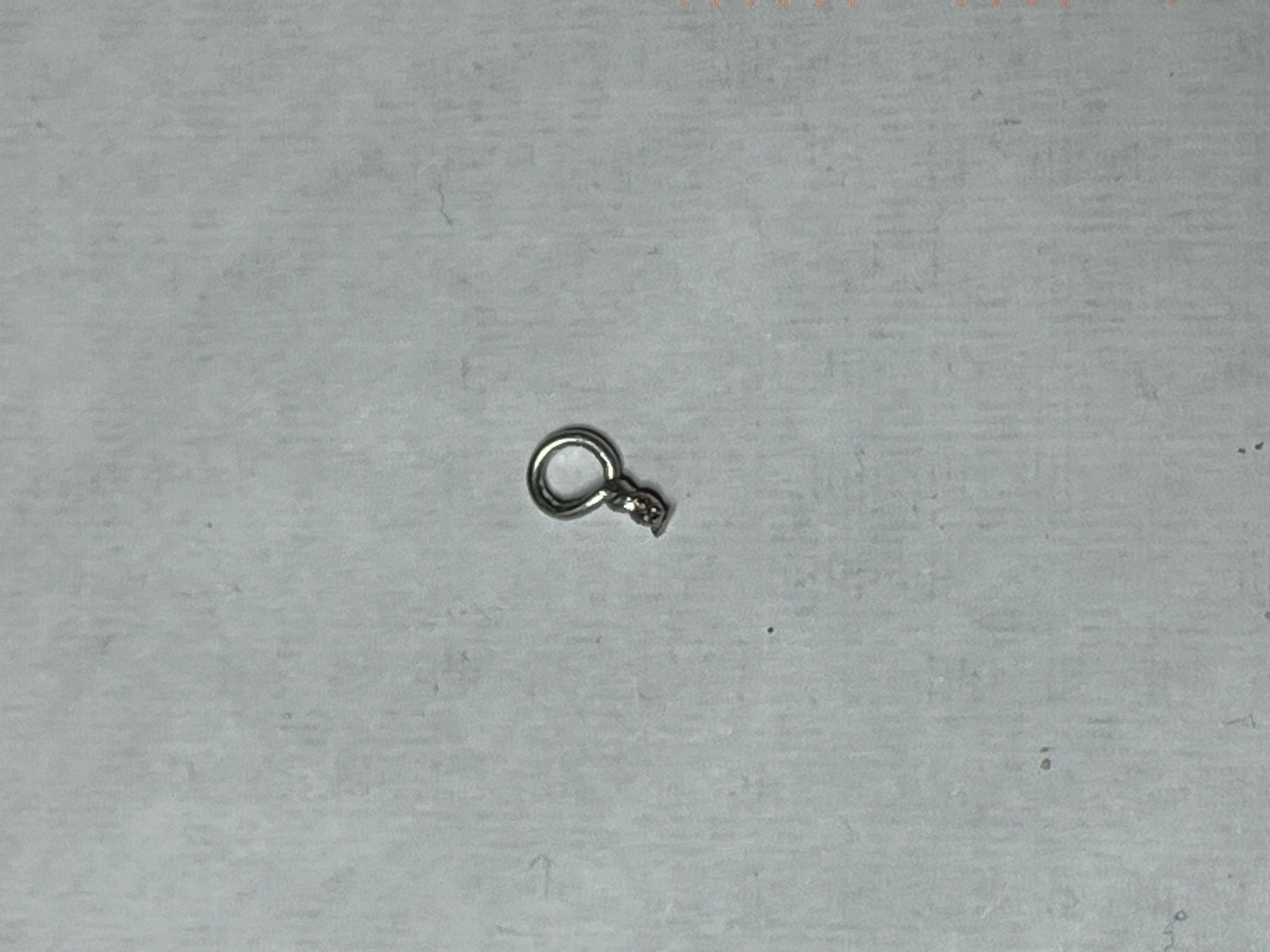

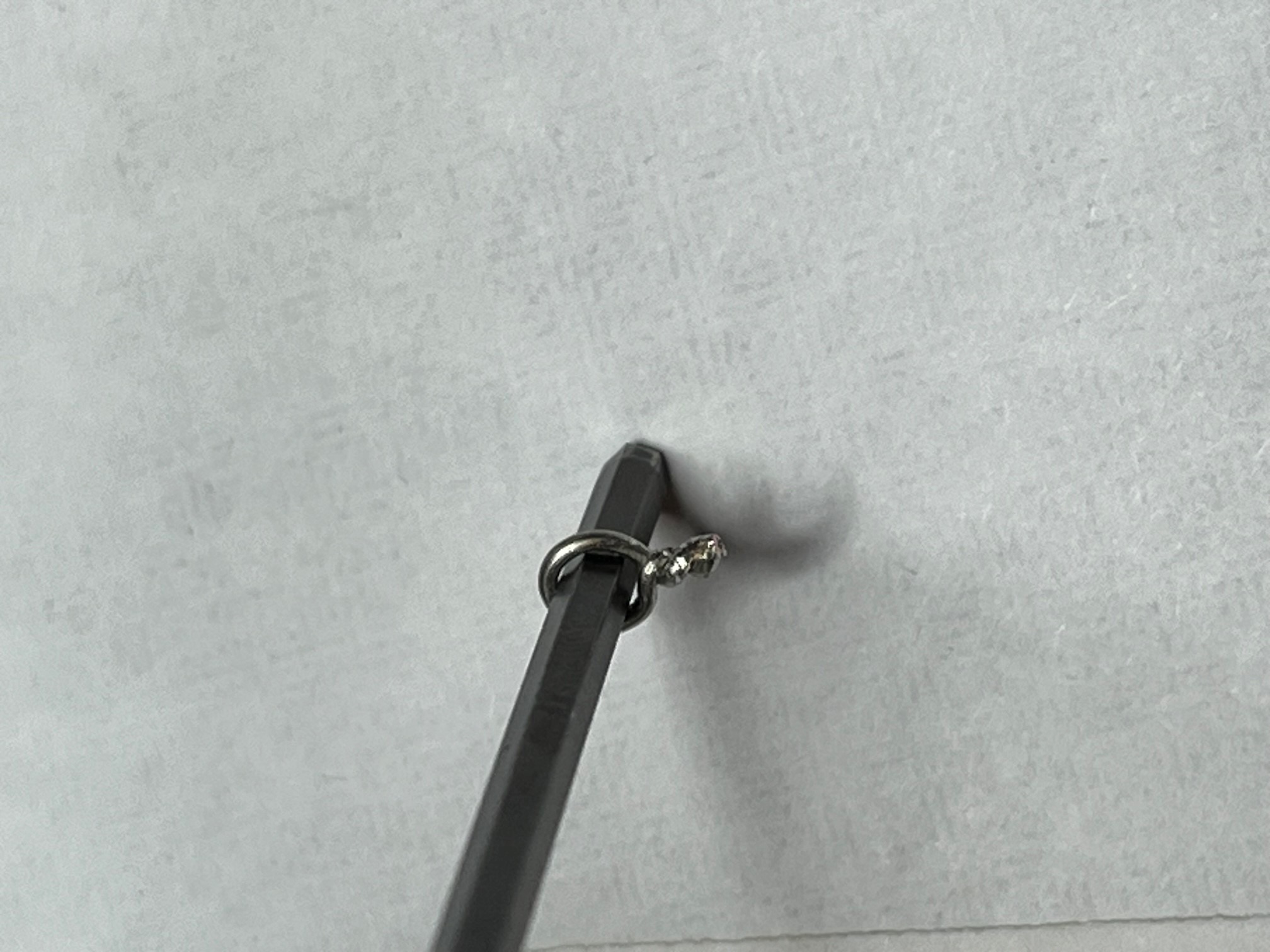

Offer/show my DIY solution $0.00 for test lead connection points (forgot to order and didn't want to pay $8 shipping for $3 in parts). I took the clipped emitter resistor leads (3w) and wrapped around a 2.5mm hex key, and twisted leads together with needle-nose pliers and soldered in position. Works great, and ended up only needing them for TP101 and TP102 (Bias), all other test points were easy to access during the build and testing process.
