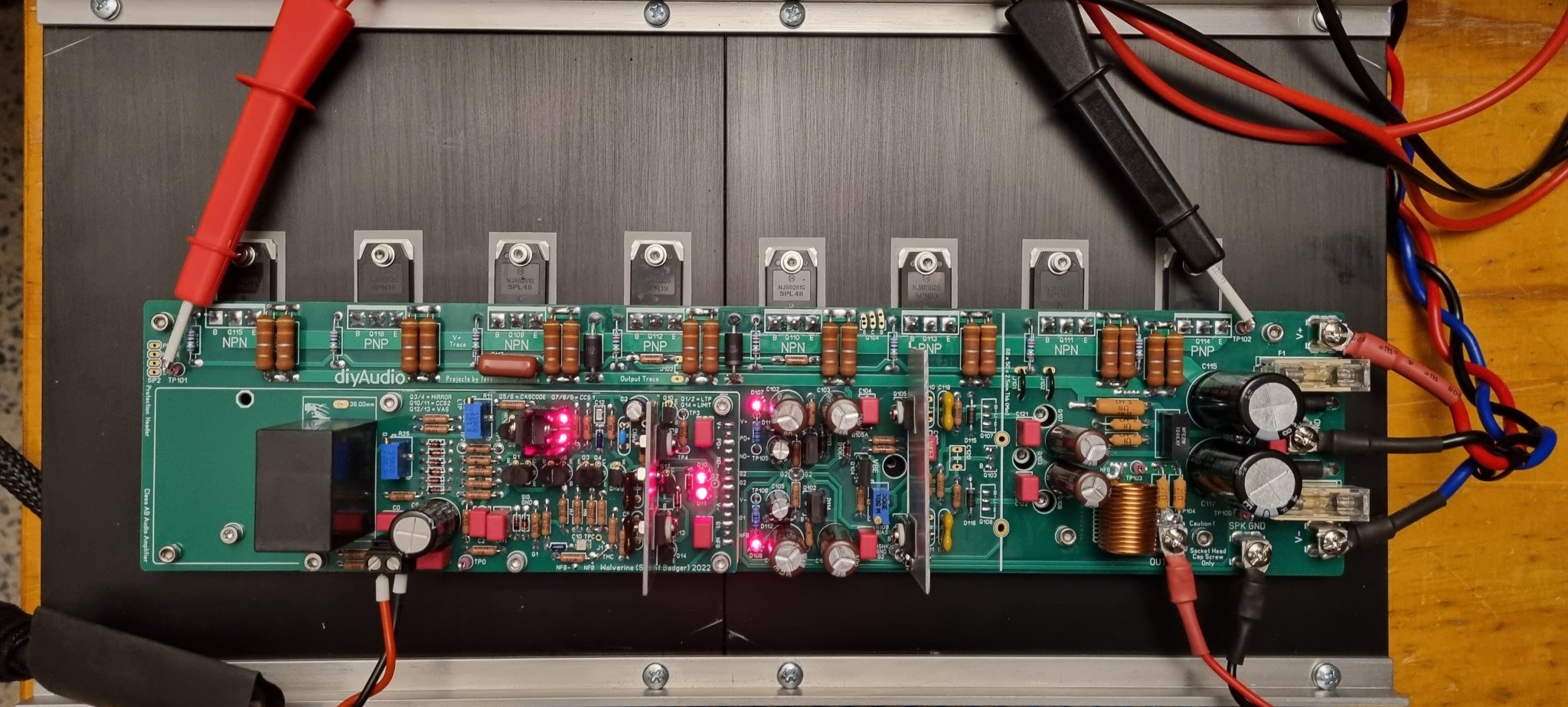

Thank you Stuart I did install the updated condiguration and associated parts.I did try a few different gain level parts on q103 and it seems to fovor the higher HFE parts the bd136-16 were showing HFE of 155 and when i ran it with that part it tracked temp very nicely never got over 90 farenheight just barely warm to touch after 3 hours running at about 50 percent. I am happy with that

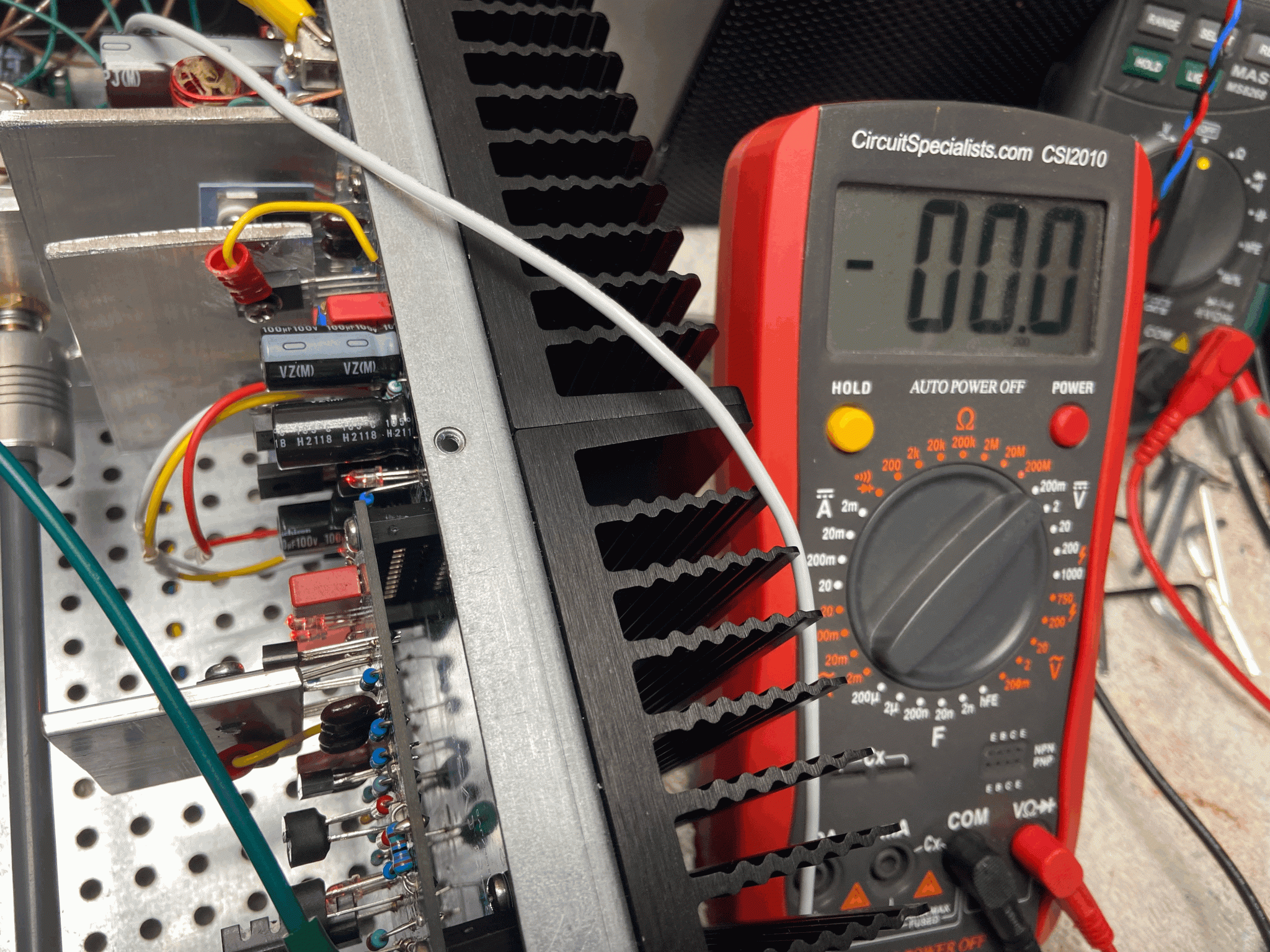

Just checking that you re set your meter to DC as the previous measurement was AC.
If it was dc was it in the mV range?

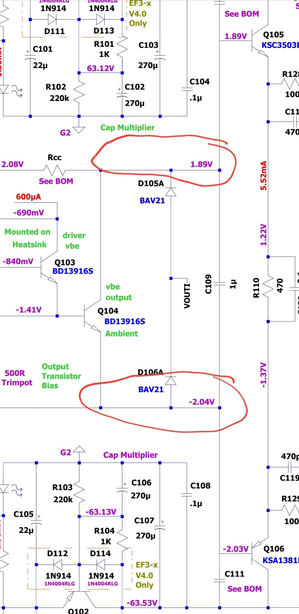

Depending on which way you installed R109 you need to turn the trimpot so that the resistance reduces to increase the bias.
If you turn the board over you'll see the pin numbers. You want to reduce the resistance between pins 1 & 2 please confirm that what you we're doing. Maybe send a photo and indicate what direction you're turning to confirm.
Stuart:
Yes, the meter has been set for DC mV (200 mV range). I suspect R109 is broken -- it's a 25-turn pot but, whichever way it is adjusted, I never reach a stop. It may take me a day or two but after double-checking it's broken I'll replace it and start the testing procedures in Section 20 (rev 37 has now been downloaded) again. Is it possible that R109 is my only problem?
Its hard to say at this point.
It might be a good idea to try and validate a few of the other DC voltages shown on the schematic. The voltages shown are what you should measure approximately when the amplifier has the input shorted. If your not getting anything at those test points you tried, try at the nets I selected.
You can also print out the schematic and measure voltages and then write the voltage you measure on the schematic. You can then post your values to help with the diagnosis.

I know that ! Q103 is just my discussed 4 diode string with gain , affects ambient Q104 same as the diodes.
I was curious what effect of having the drivers on the main HS would be. That would be the ultimate inverse
of 4 X MURS120's. Response would be slower than a (discontinued) thermaltrak NJL ... (MURS120+NJW0281).
Also , consider - driver SOA is reduced at higher Tc. There is the good and the bad.
OS
There are also different resistor values to accommodate for the different temperature coefficients between the EF3-3 and the EF3-4 due to the drivers being mounted on the main heatsink (EF3-4) or the separate driver heatsink (EF-3).
The EF3-3 values from the BOM would be used if EF3-4 for amplifier boards are mounted perpendicular to the main heatsink.

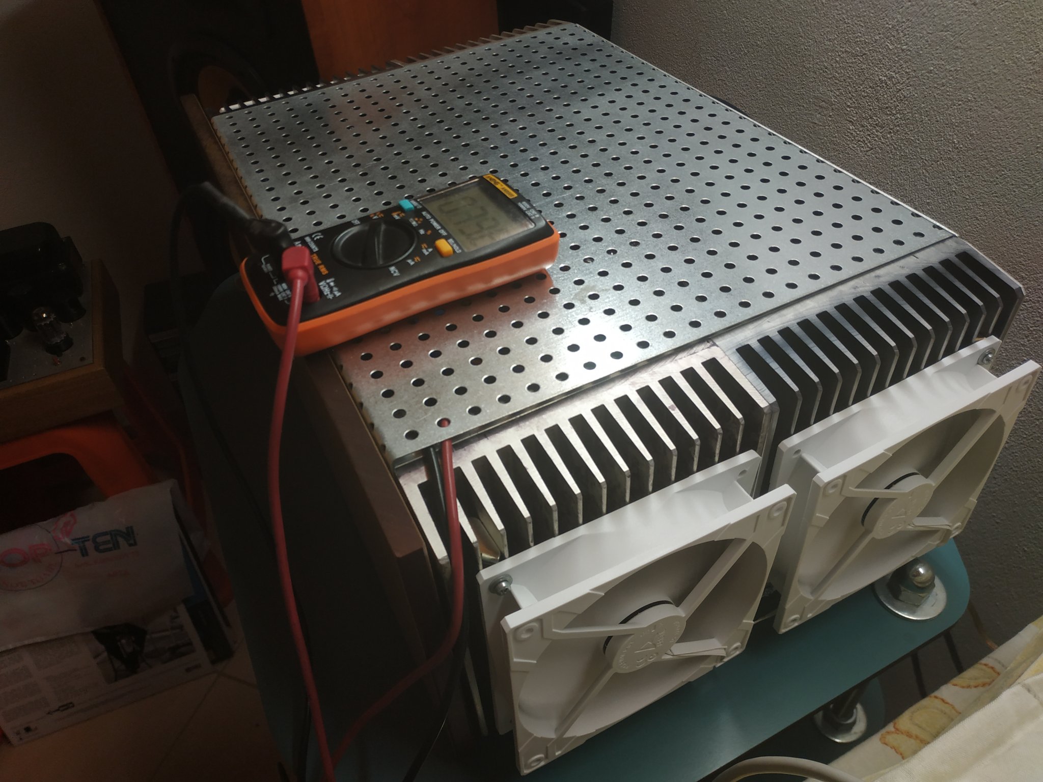

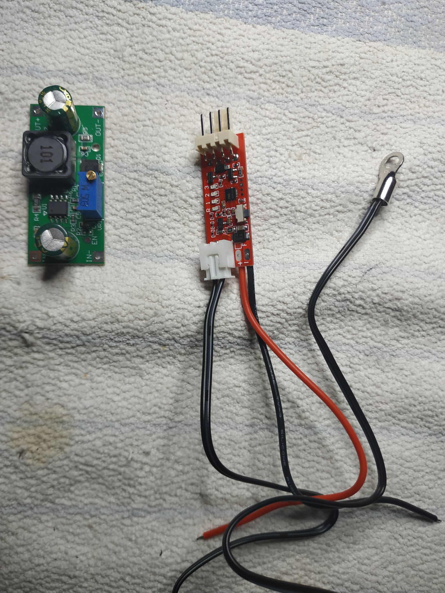

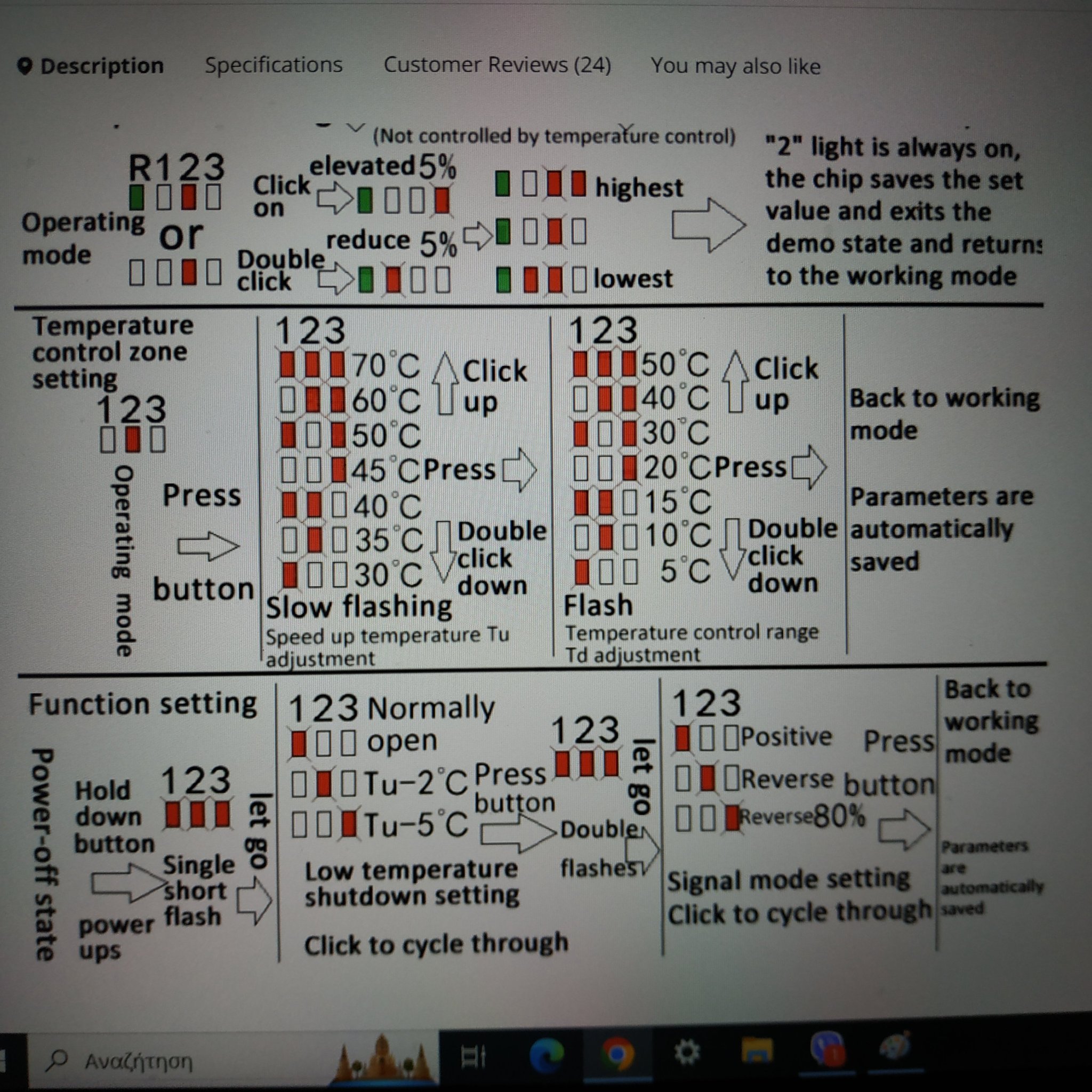

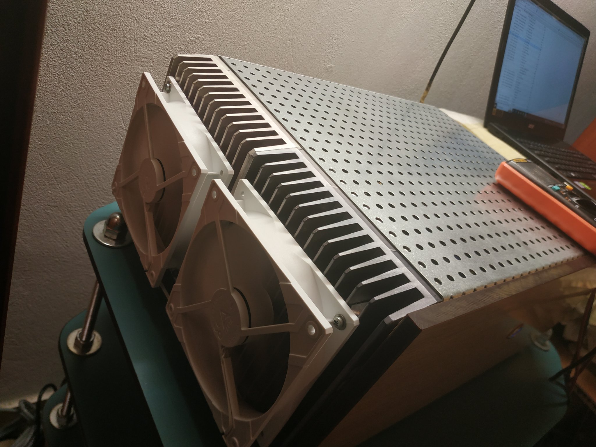

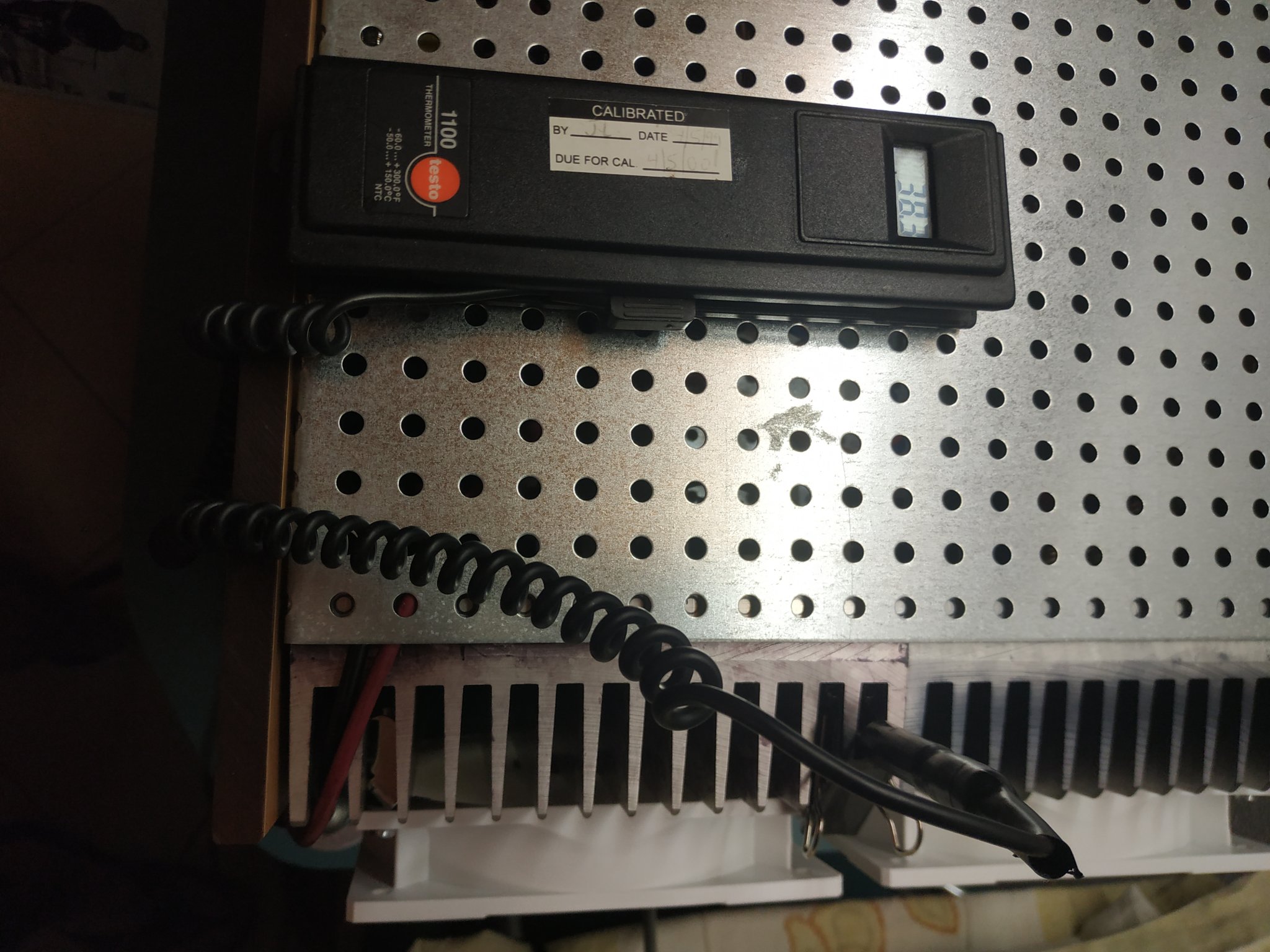

Τοποθέτησα αυτούς τους ανεμιστήρες pwm που ελέγχονται από έναν επεξεργαστή πάνω από τις ψύκτρες και μειώνω τη θερμοκρασία ώστε να μπορώ να έχω σταθερούς 38 βαθμούς Κελσίου πάνω από τις ψύκτρες. Παρόλα αυτά, το ρεύμα ηρεμίας μετά από μια ώρα πέφτει από 44mv σε 38 με 40mv η θερμοκρασία παραμένει στις ψύκτρες σταθερή στους 38 βαθμούς. Παίζω μουσική σε υψηλή ένταση. Φταίει η παγιδευμένη θερμοκρασία μέσα στο κουτί; Μπορεί κάποιος να εξηγήσει τον μηχανισμό του ρεύματος ηρεμίας και τον ρόλο του τρανζίστορ Q103 και Q104.
μήπως χρειάζονται μικρές αλλαγές στις αντιστάσεις ανάλογα με την κατάσταση??
