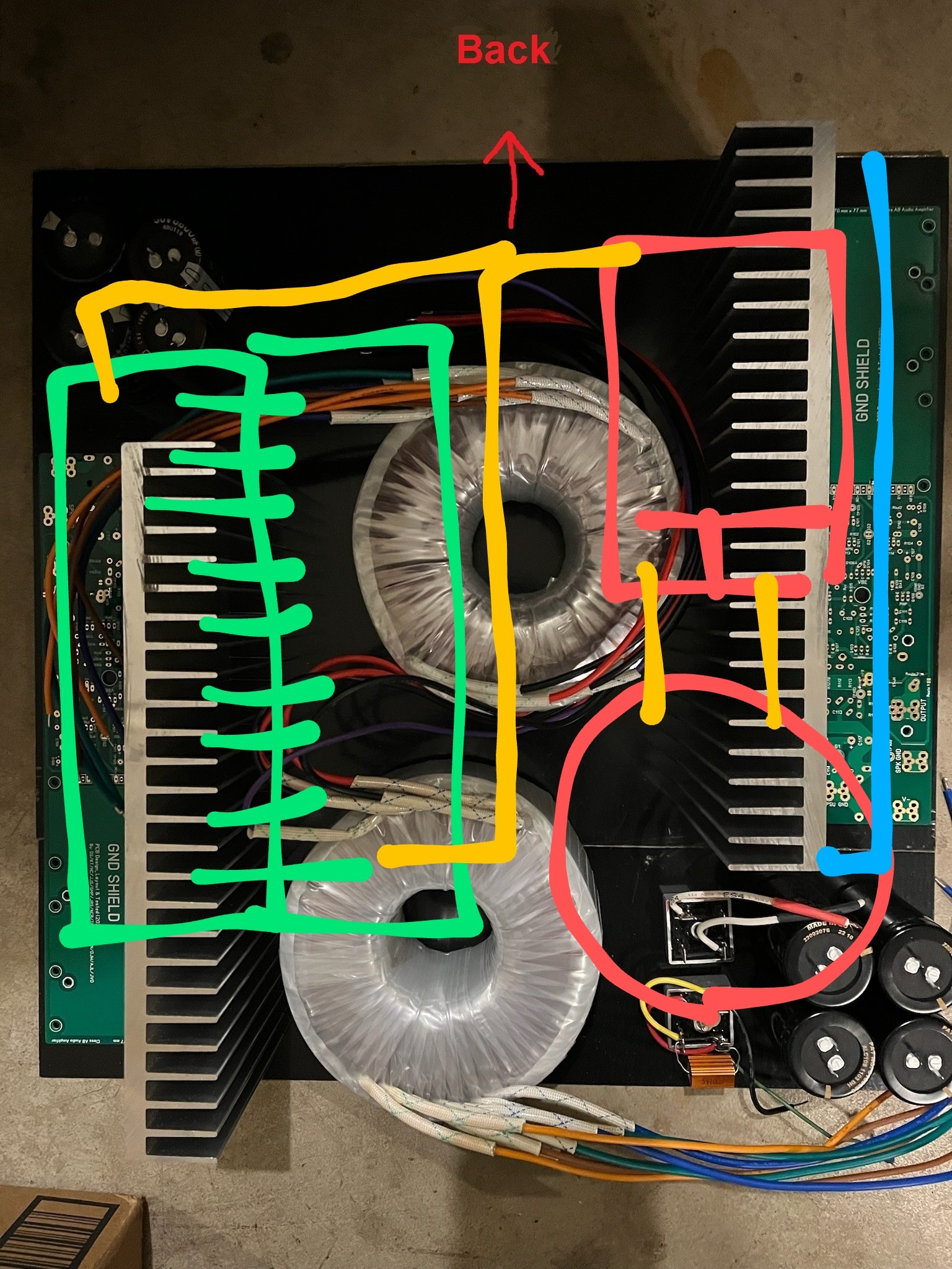

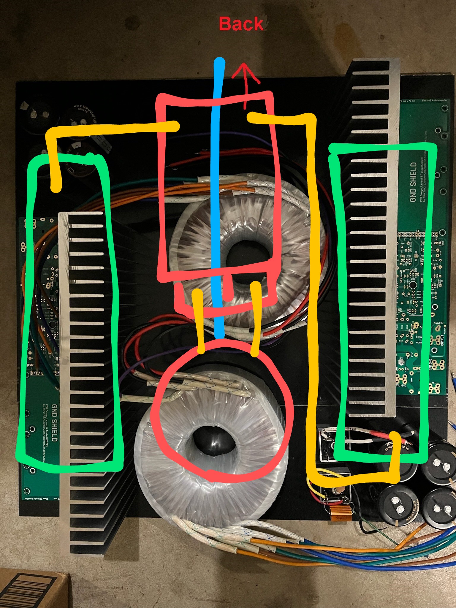

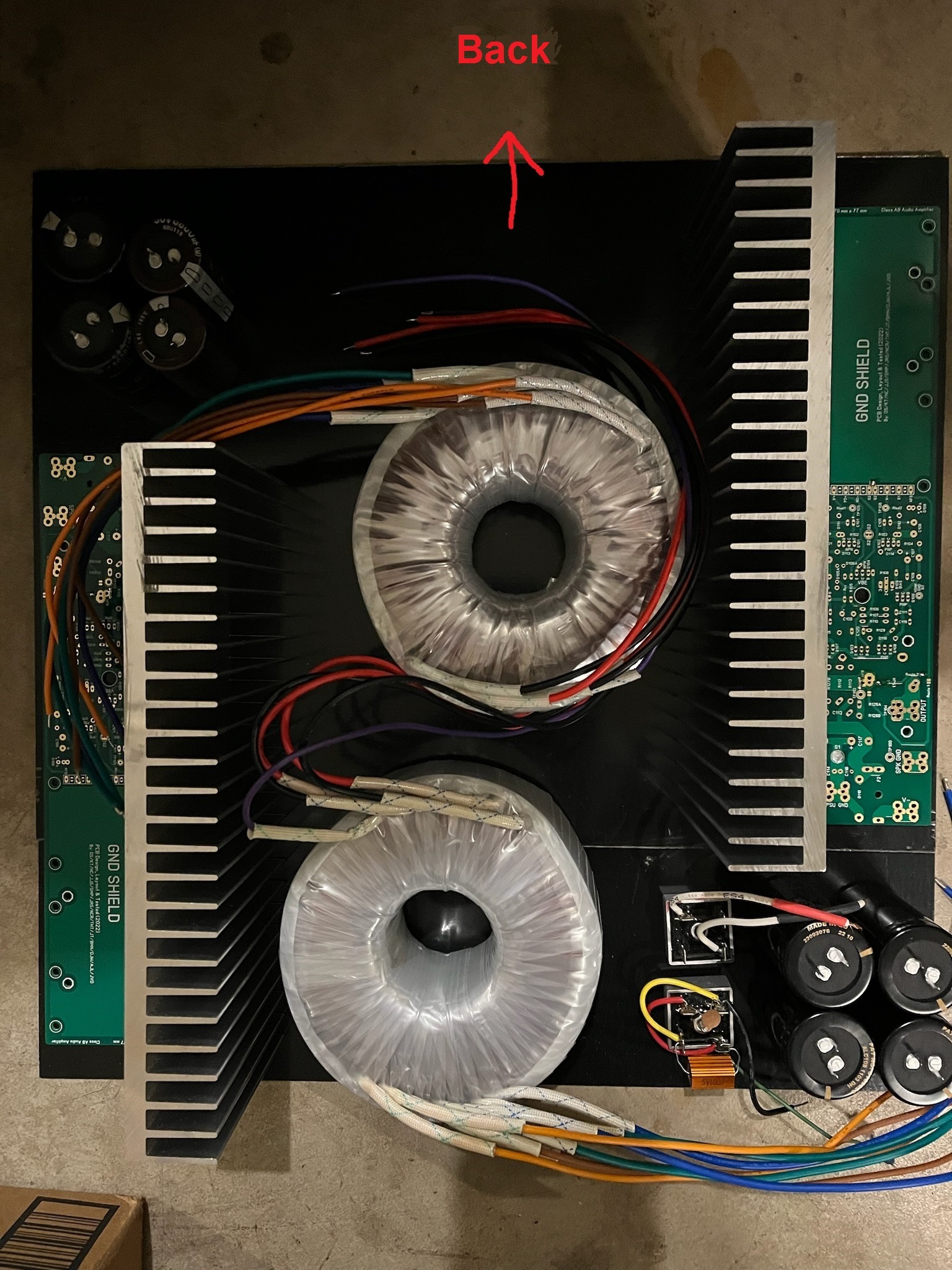

With two transformers I would still try to stag them if possible with the ability to refuse some noise and keed the e.caps and bridges as one unit in one end og the amp.
If you wanna proceed with the internal mounted heatsink, good wiring needs quite some attention, as it's quite easy to make messy and big loops as previous mentioned in this thread..

@90scaraudio Could this be an option for further improvement in your layout? 🙂
Haven't drawn the signal/speaker-out wirring.
Blue is AC, yellow is wire from transformers and PSU. Green is the boards
The one where the heatsinks are close together, seems to be good at conducting heat, Chimney effect sort of.. But the transformers would be closer to one PCB then the other as a sideeffekt, but with some distance to the IPS...

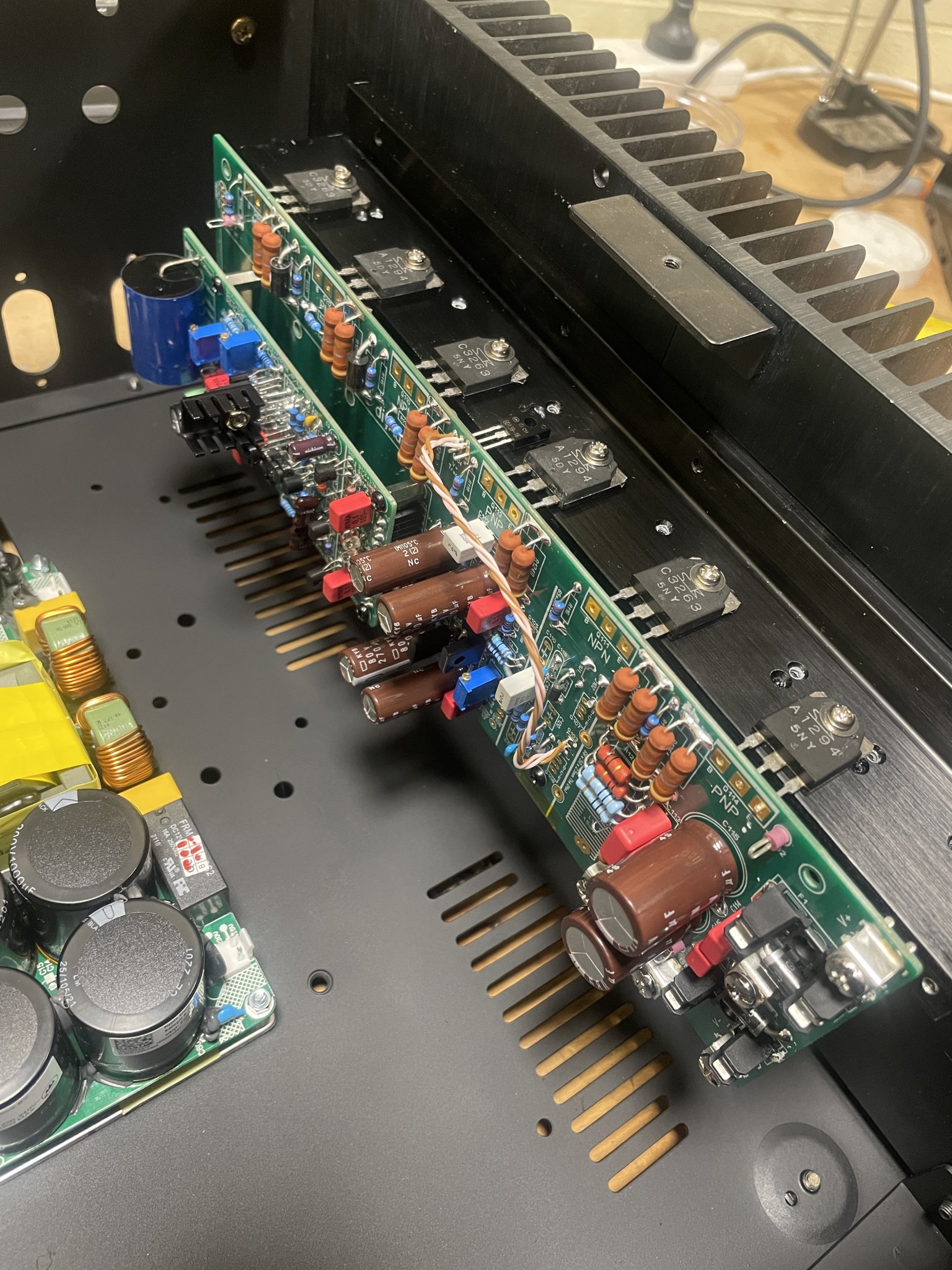

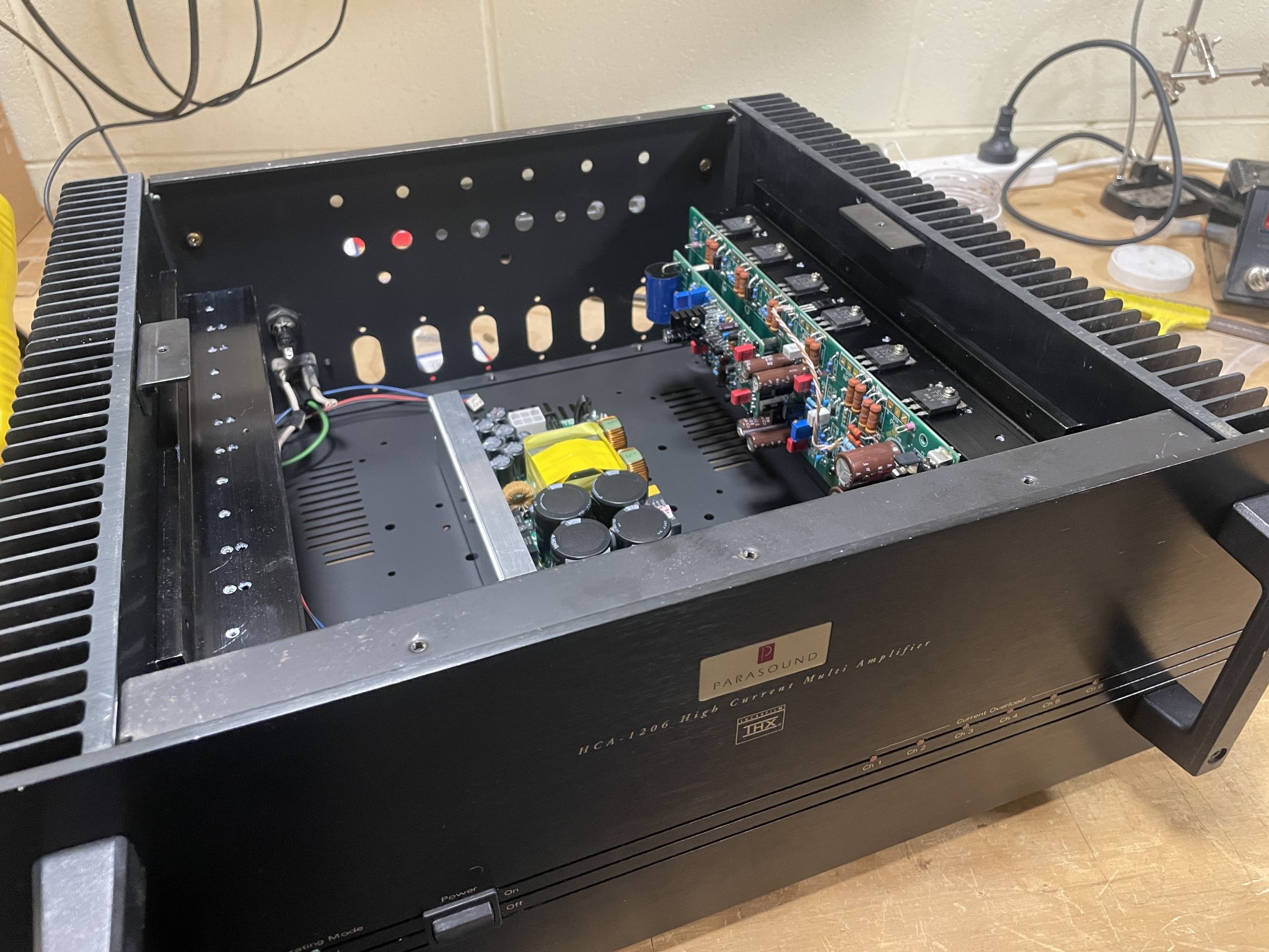

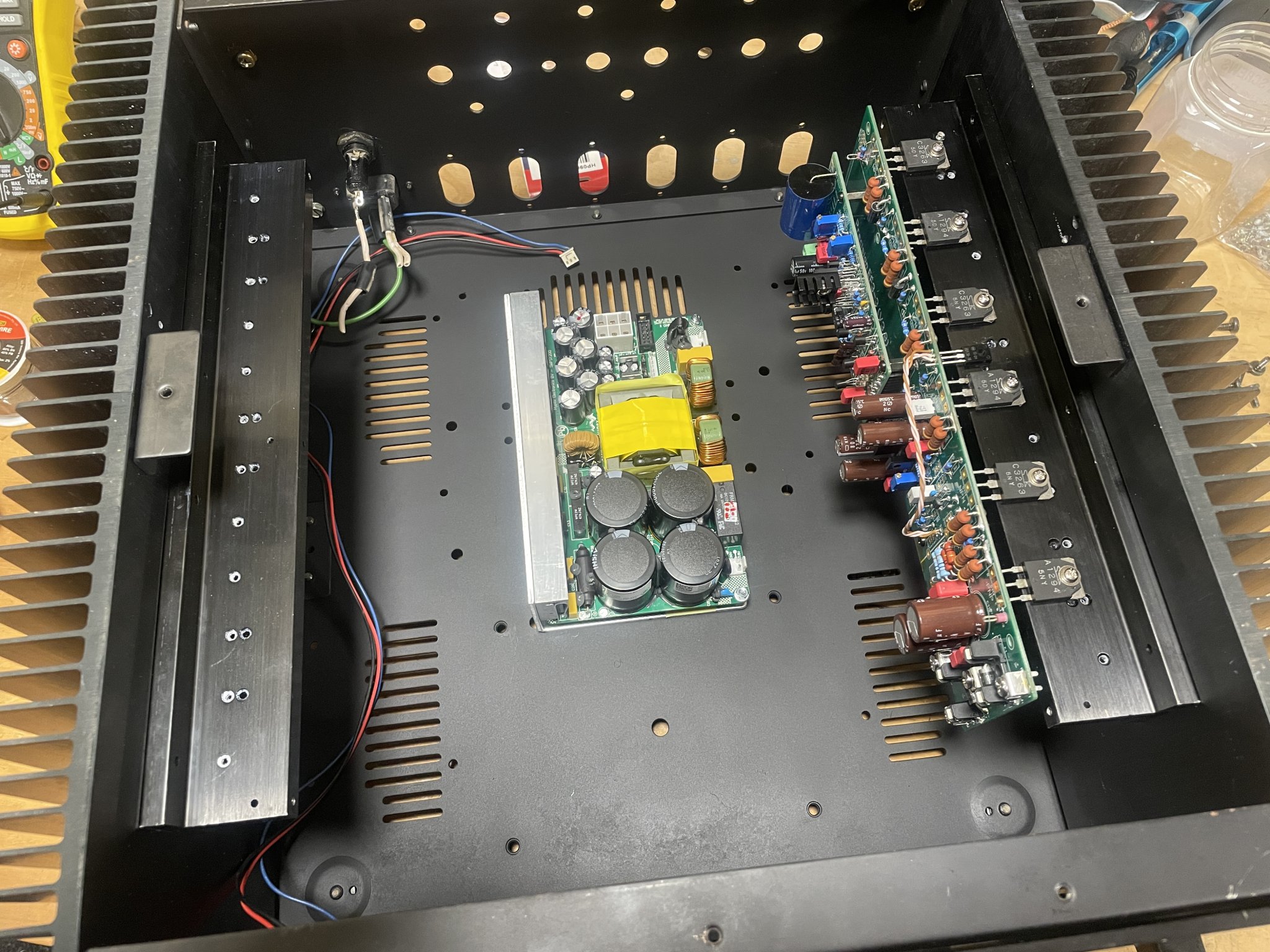

Dummying up how its going to sit, sure looks lost in the old parasound 6 channel chassis. Nearly ready for testing. Boards also still need final clean.
