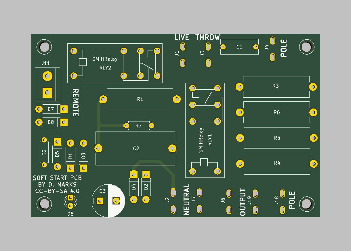

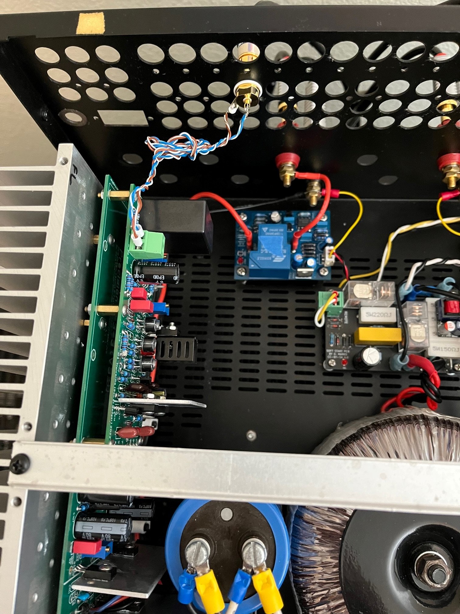

Is there a way to modify this soft-start schematic and offer a "slower" ramp-up soft-start? I have it hooked up to my Wolverine, running +/-70Vdc, with an 800VA toroidal and running (4) 33,000uF 80V "can" caps.
It appears to be working and worked in 2 other amplifiers without the lights dimming. Testing with a DBT, the 150W bulb lights then dims and lights more brightly before going out over a 0.5 sec timeframe. The breaker doesn't trip or blow the mains fuse (I currently have 8A s/b mains fuse and 6.3A s/b rail fuses), however my lights dim considerably when I power it on. Looking at the schematic, would it help to replace the (4) 150r resistors with CL-60s in either parallel or series-parallel (since I have these on hand)? Or change the value of those 150r resistors, or a totally different modification?
I chose this design (not mine, it's from D. Marks from Ampslab forum - see board pic) because it was part of a whole ecosystem power conditioner, soft-start, speaker protection and amp project. So I built the amp and soft-start, but didn't need in the previous amp when I changed it to an SMPS PSU, that amp previously used a +/-65Vdc 700VA with (4) 12,000uF 80V caps.
I'm open to another soft-start board BUT it has to offer 12V remote turn-on (I have a board for Mark Johnson's design, but don't believe it has remote turn-on), I am spoiled using a remote for my preamp and not turning on my amplifiers by hand.

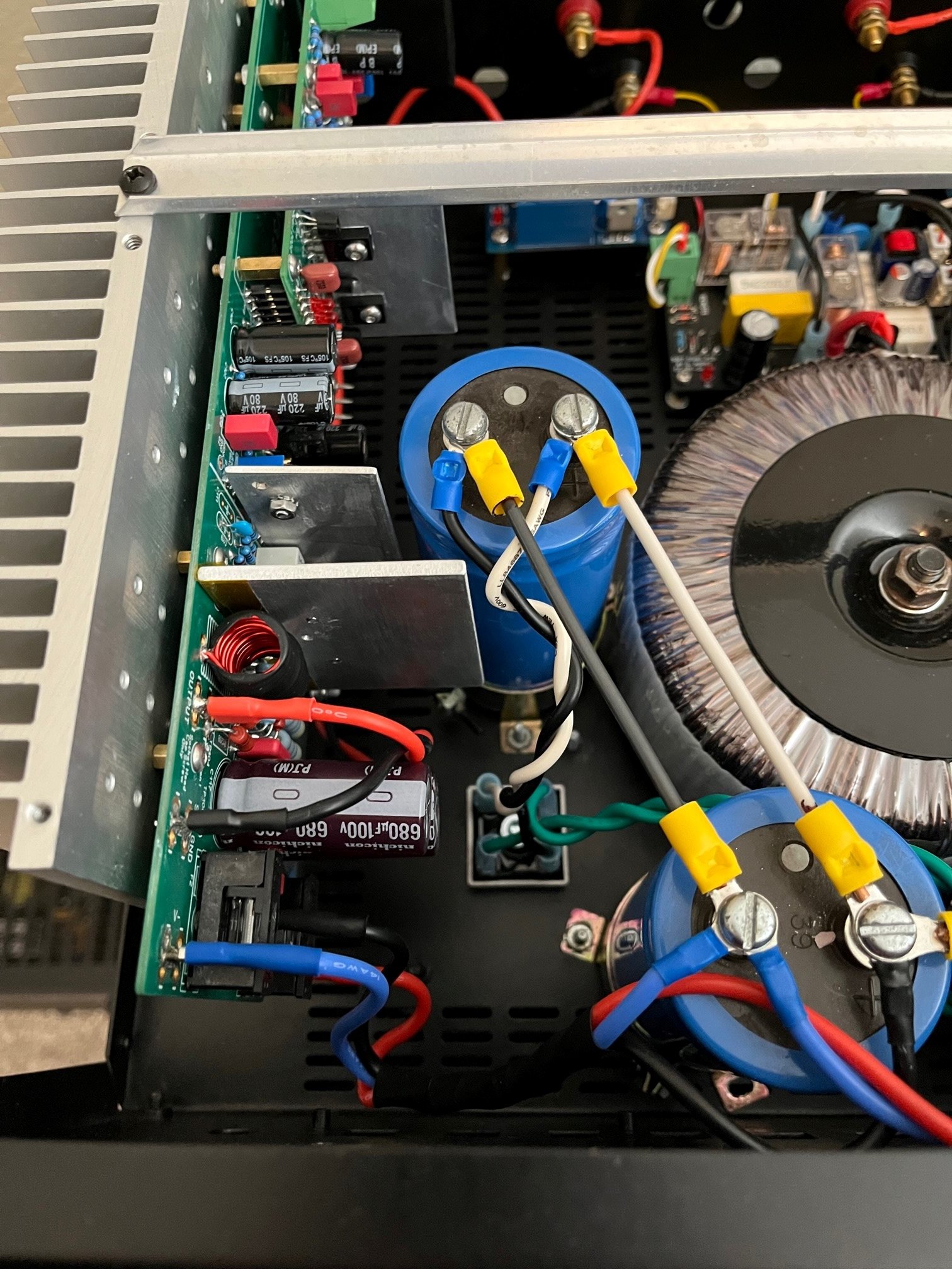

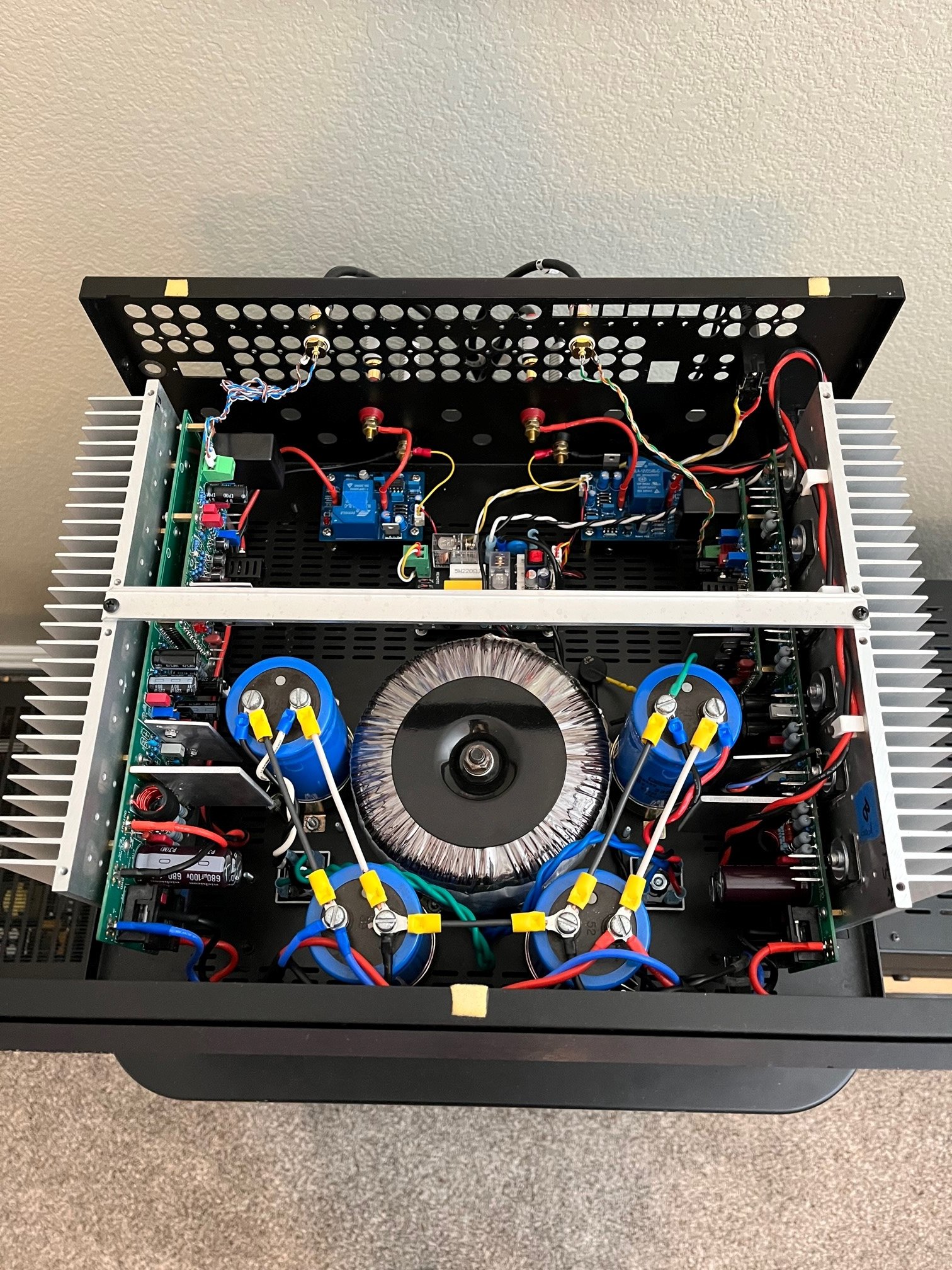

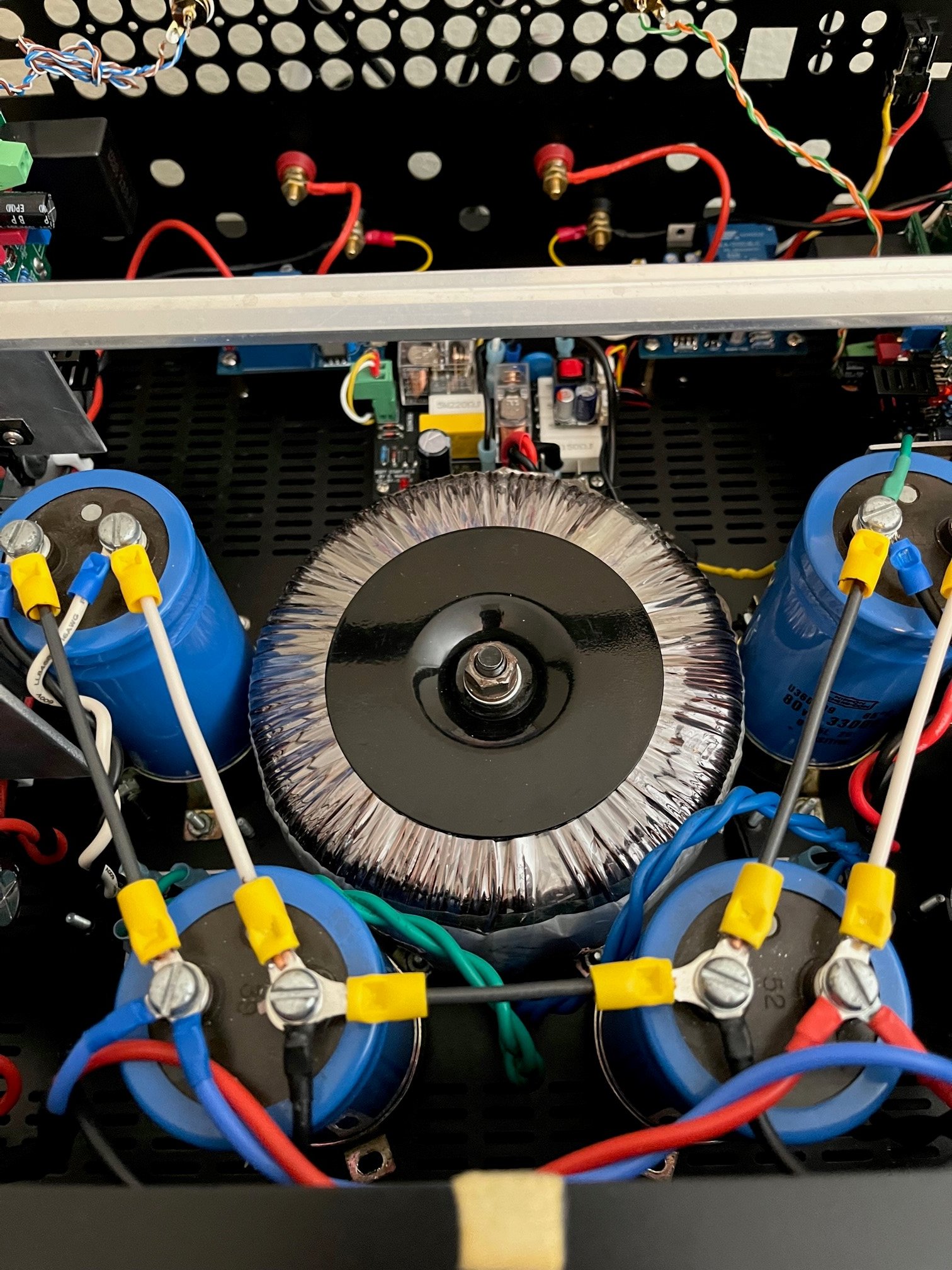

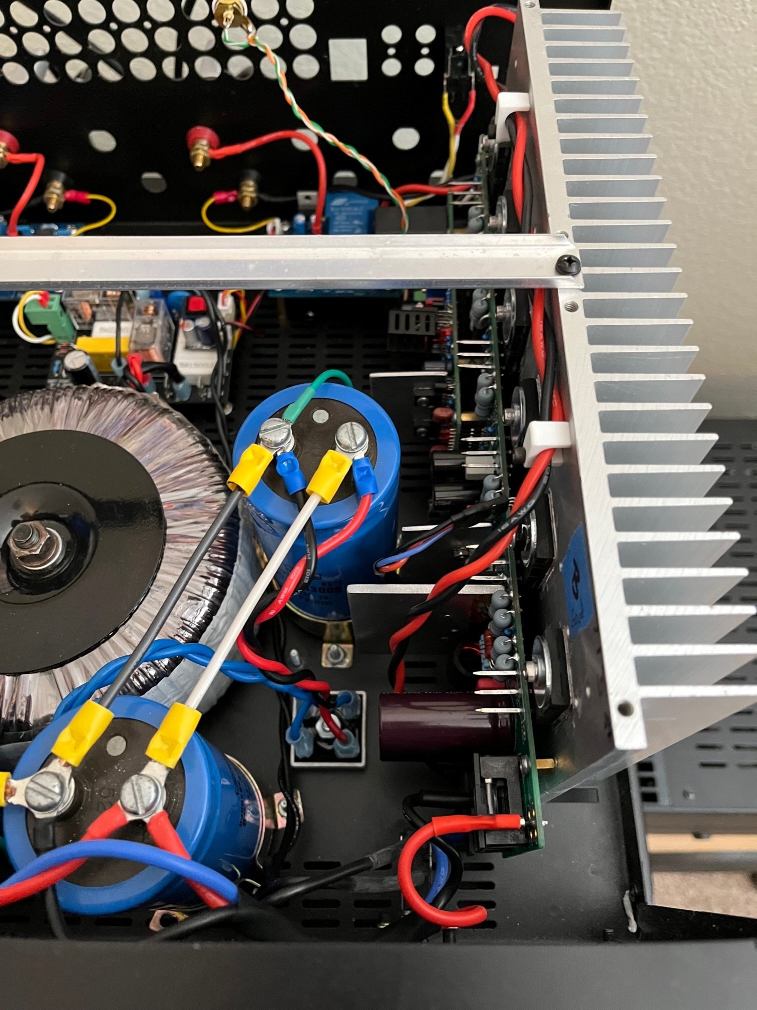

Included pics of my build, very modest compared to others on this thread, "might not look like much, but she sounds good and is dead quiet!" You can see the soft-start board, with a small 12V SMPS glued to the resistors for speaker protection.
Great job Bullittstang.
You can increase the RC time constant on the soft start but resistors which take the turn on thump often don't survive.
Might be worth exploring the CL60 option

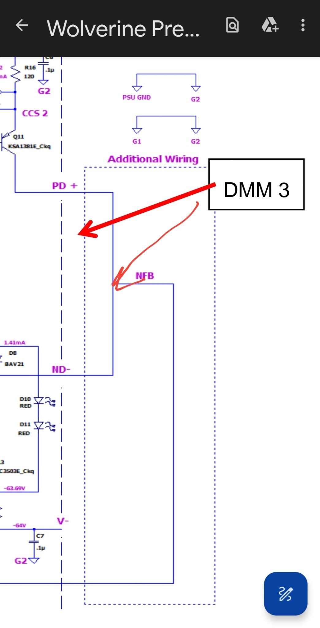

One IPS module seems to work OK. Can get up to 30-0-30V drawing only ~20 mA. The other module seems OK until I get up to ~10V per side then one leg of the PS snaps into constant current mode and reduces the voltage. Checked shorts, bridges, cold joints, misplaced caps, etc. Wondering if it is a semiconductor issue - perhaps one of the transistor pairs?
Tried tracing the voltages as shown on P 50 of the newest build guide. The exact location of the DMM3 test point is a little unclear (at least to me). Is it supposed to be the NFB<>PB+<>ND- shunt?
Jon
Hi Jon, it looks like that arrow moved for some reason. In this isolation test it is just emulating the output trace. Please see the correct location below.
You shouldn't have any issues with this test if everything is ok.
I suggest that you make a very close visual comparison between both boards checking all resistor values, component orientation etc.
If it checks out you may need to do a voltage comparison between the two boards. If you can you can connect them both at the same time. Then dial the voltage up to just below the point were your having the issue. Then take some comparison measurements using a common ground. This will help you quickly identify what voltages are correct and when are not. This will also help you identify the location were the problem exists. Please note there maybe more that one section were the voltages differs.
Good luck

Update from post #2462 regarding the soft-start allowing too much current and dimming my lights.
Pulled the (4) 150r 5w resistors and replaced with two CL-60 thermistors in series to get ~20r cold resistance.
Worked like a charm, no more dimming lights and really not much heat either. Start out at ~80F and only maxed out at 100F, and cools down to 85F within a few seconds of the relay latching.

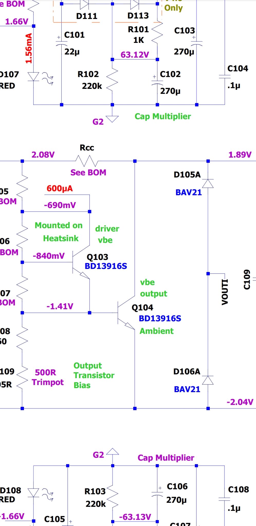

I have reached the soldering stage so a few questions have appeared. The most important one relates to EF3-4 positioning of driver transistors Q107 and Q108. Originally these transistors have been placed on separate 3mm heatsinks but the latest recommendation is to mount these drivers on the main heatsink. As I prefer to keep pcbs at the right angle to the main heatsink (easy access to pcb trimpots, test points etc) a problem has appeared. If I place drivers Q107 and Q108 on the main heatsink then I have to wire them to the pcb. Can I do this as wires will not be very short? It's not a problem to wire a temperature sensing transistor but in this case length of wires may become sensitive. Or with the right angle pcb to heatsink configuration should I keep these drivers (Q107 & Q108) on their original separate 3mm heatsinks?
I understand that in EF3-3 these driver transistors (Q107 & Q108) remain on their separate 3mm heatsinks, am I right?
The other questions concern less sensitive issues, namely why high voltage transistors ksa992 were used for Q9 and Q10, which collector-emitter voltage is below 1.5V? I'd prefer to use here my 2sa1015 or ksa1015 transistors. By the way 2sa1015L or ksa1015 are also low noise (typ 0.2db at 1kHz, max 3dB) and have much better linearity than BC transistors used in LTP here.
I also have awg15 (1.5mm) wire and awg13 (1.8mm) wire. AWG13 is too thick but if I was to use awg15 wire how many turns on 12mm (or different diameter former) I need?
Instead of ksa1381/sc3503 I'll probably use 2sa1209s/sc2911s
I'll be grateful for all comments. Thank you.

If you are going perpendicular install with an EF3-4, you would need to use the Q107 and Q108 drivers on their own 75x50x3mm heatsink as long as your outputs aren't MT200's. You would no longer need the hole in said heatsink for Q103, as that has been reallocated to ambient duty and would require flywires to the main heatsink, as per post 2057, or flywires to the spare Q104 labelled position for main heatsink monitoring.
You might want to have a closer look at that
