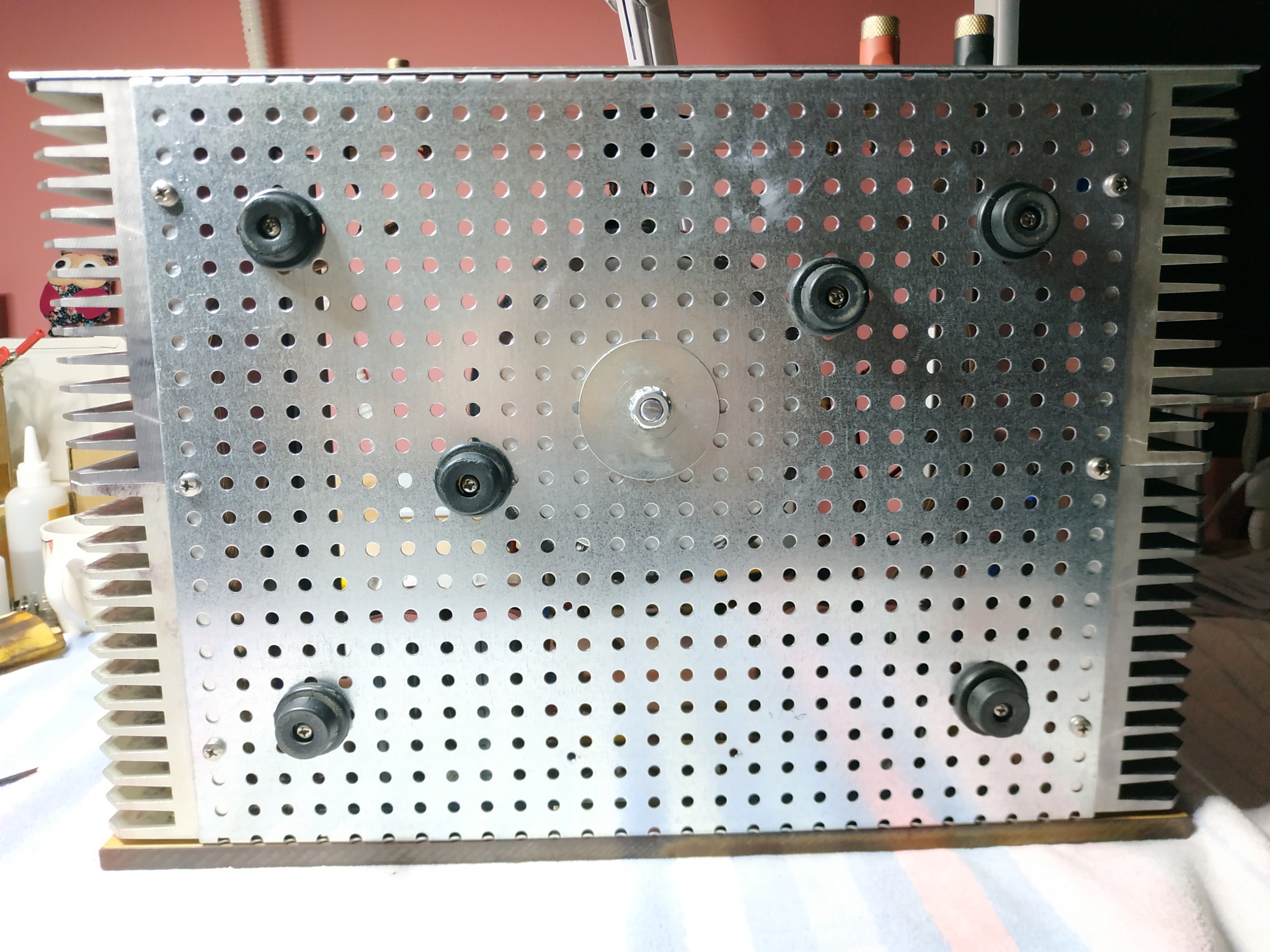

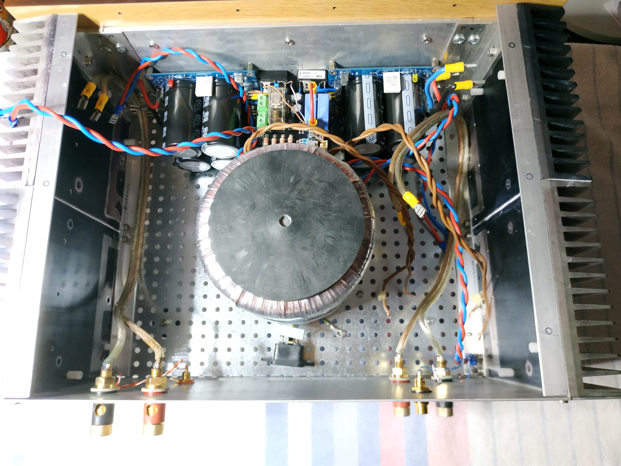

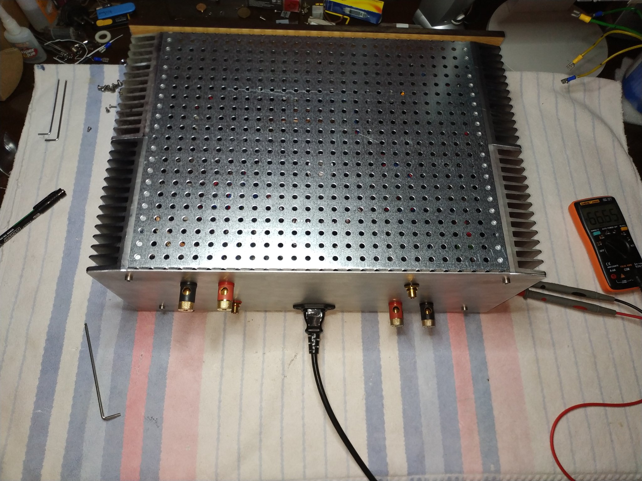

Heatsinks are in the chassis, upright and screwed to the chassis on the bottom, with about 1/2-3/4” of clearance.
My mains is a little high at 123-125VAC, but three other Antek transformers were all within 1-2 Vac on the secondaries, so 6V seemed excessive to me.
I also run 4 large 80V (100V peak) 33,000uF caps, no L or R or bleeders in the path, with a CL-60 from PSU 0 to chassis.
A tiny hiss from my tweeter with ear on top of tweeter, my DMM measures 0 AC, below it’s capabilities - so it’s silent.
My speakers are DIY 5-1/2” two-way with nominal impedance of 6.8r, so a very easy load for any amp.
Really enjoying the amp, worth all the time, troubleshooting my oversights and mistakes to finally have it playing some music.
I will play it for a few weeks before I change the bias. My heatsinks are inside the case, so not ideal but does allow for more heat without risk of burns.

Congratulations on getting your wolverine playing music Bullittstang!
People often get a bit concerned with heat when an amplifier is optimally biased since comparatively, commercial
amplifiers tend to be underbiased to save money on heatsinking.
If you are concerned you could change the resistor values per the build guide to suit the higher rail voltages
but you are still going to have the same sort of heat generated in the output stage unless you reduce rail voltage with a lower secondary voltage transformer
or reduce the bias.
I would resist the urge to reduce the bias too much.
Only issue is transformers are always going to be costly......
Maybe your wolverine is destined to be a bit of a hot-rod ?

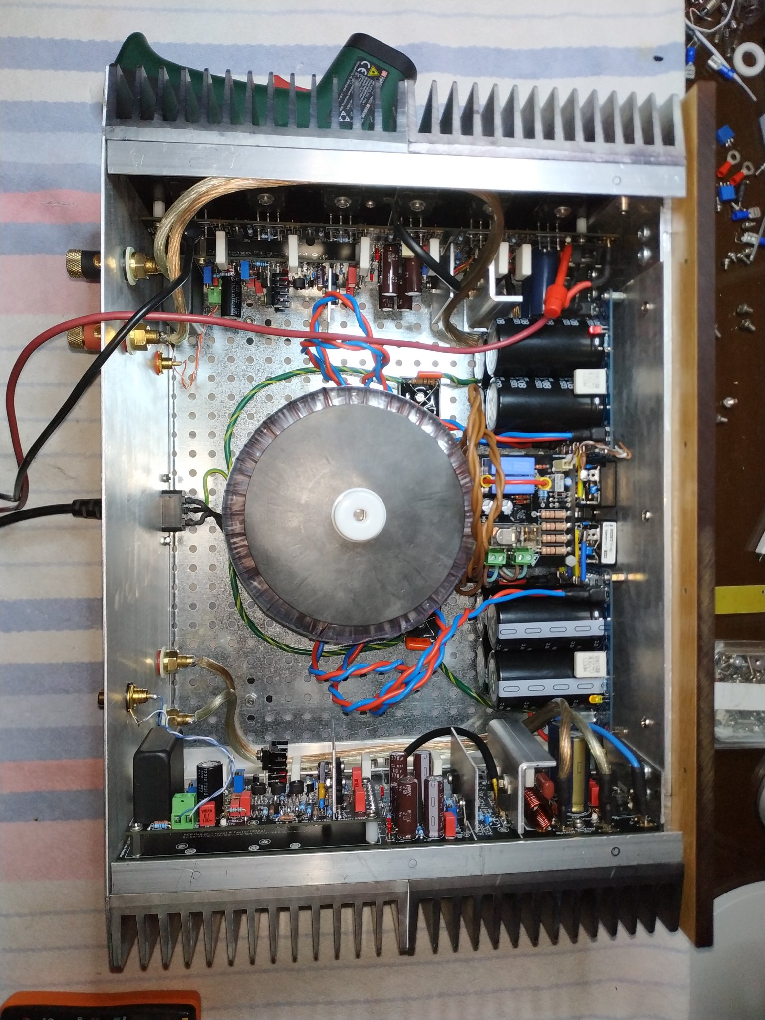

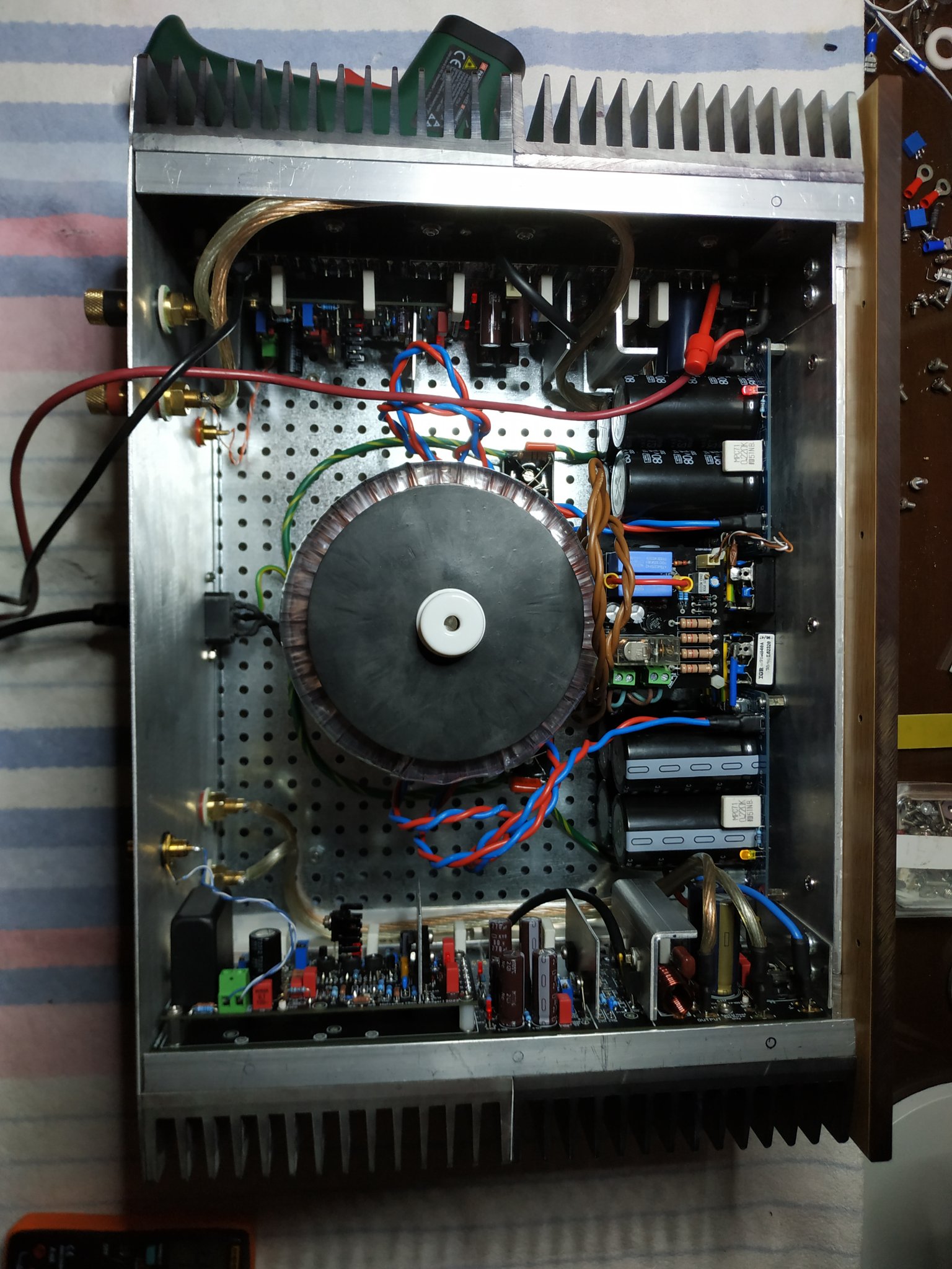

Alright I'm making waves on this amplifier project now, let the Frankenstein build begin. Just dummying up how everything is going to fit in the parasound chassis and there's a solid intermediate bar the existing output channels were "hanging" off, any objections to me mounting in a similar manner like pictured but I will add my own standoffs for the lower part of the PCBs to the heatsink? The PCB will not be contacting the intermediate there would be 4mm gap. The EF3-3 length works out real nice too. Apologies for the novice questions this is my first DIY amp (I have repaired many, don't worry I won't be asking how to solder)

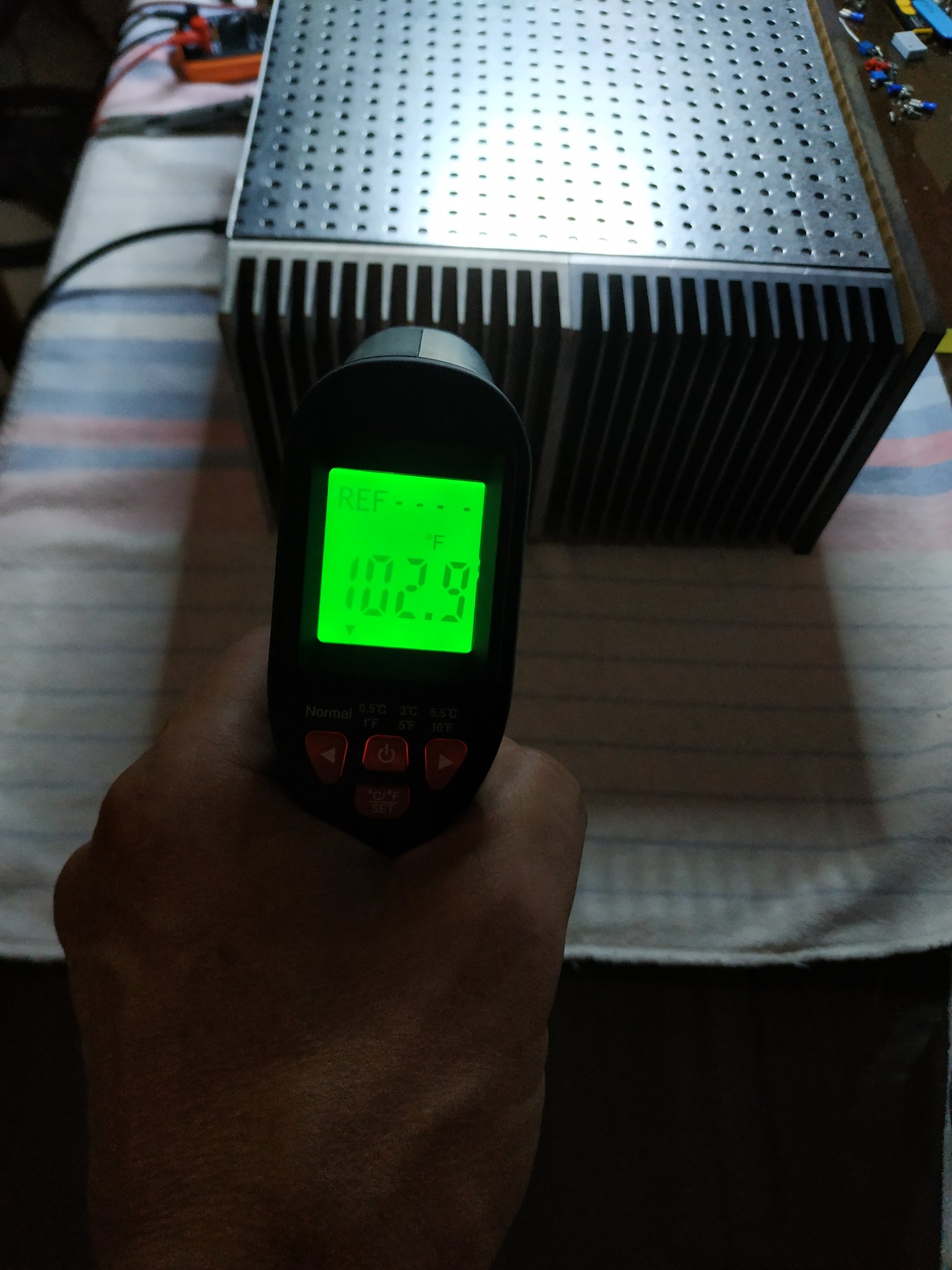

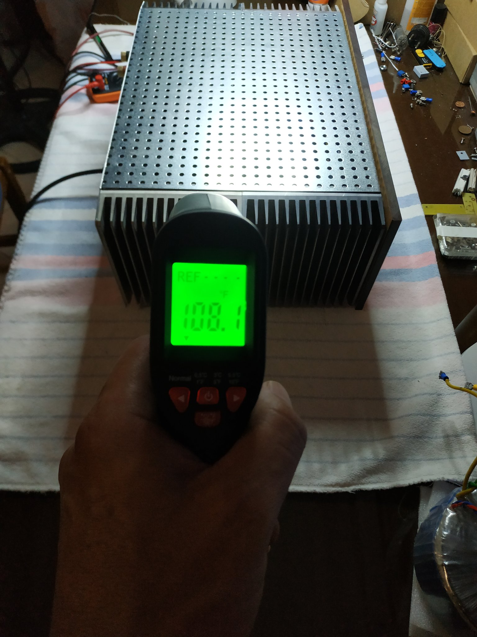

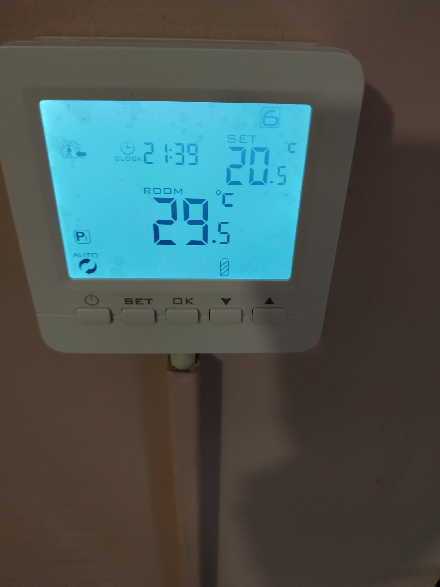

About temp......110-120 F. Ambient temp 29.5 C .The bias rich cold about 47-48 mv and settle down to 38-40mv at this moment the temp of the heatsinks are going down to 103 F.

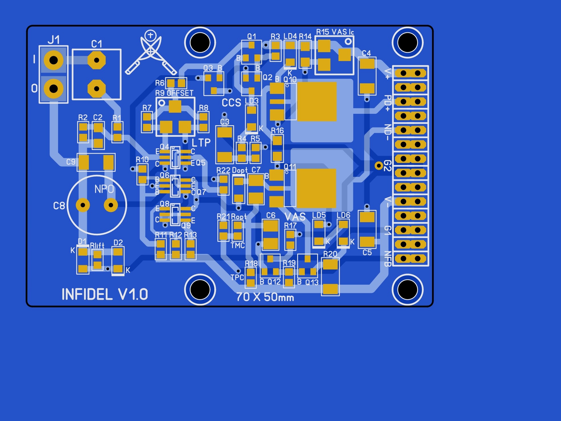

I thought I was the only one who retrofitted these DIY amps into old E-waste ? Cool , this is another design consideration for myAlright I'm making waves on this amplifier project now, let the Frankenstein build begin.
new "mini" OPS's. I do have a Wolverine EF3 board I will use as a sub amp , with my tiny IPS's I will have tremendous flexibility to make
custom adaptations.
I might even make use of my dual SIP 14X IPS connection scheme , a common PC female ribbon cable can connect IPS/OPS.
Very small (2/3rd's of a credit card - below) IPS's allow tight packing of many amps in the same box.
PS - "Infidel" = simpler wolverine IPS....

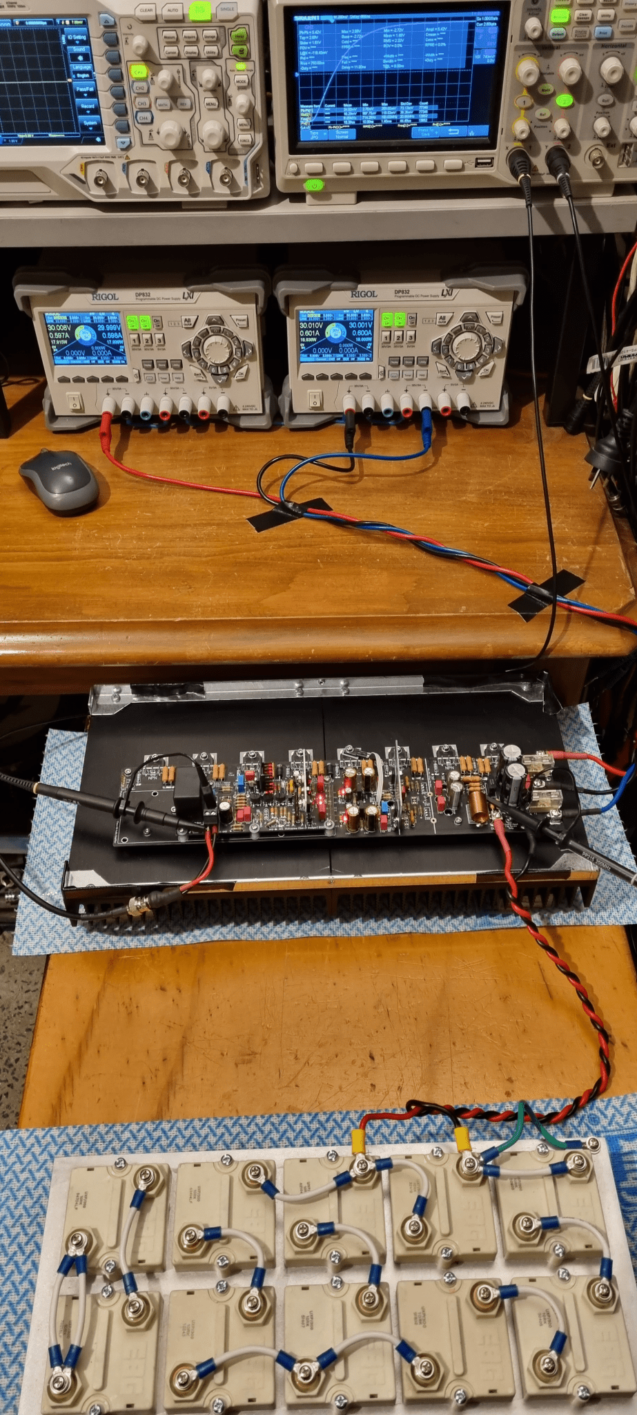

Guys-
IPS boards are assembled and ready to test! (Woot!)
In Dan's excellent video, it appears that he is test feeding the IPS board with about 30V (as judged from the display on the power supply). Once the amp is assembled, the V+ will be closer to 60V. Is 30V sufficient for testing?
The build guide mentions that the testing voltage measurements should be made with floating ground. My bench power supply has a ground lug in addition to the + and - terminals. Does this mean that I should not connect the ground terminal on the IPS board to the ground terminal on the power supply?
Appreciate the guidance!!
Jon

I used 2 supplies to achieve +/- 60Vdc rails.
You leave the ground lug on the psu out and use the 0V terminal in between the "rails"
Hope this helps
- Daniel
