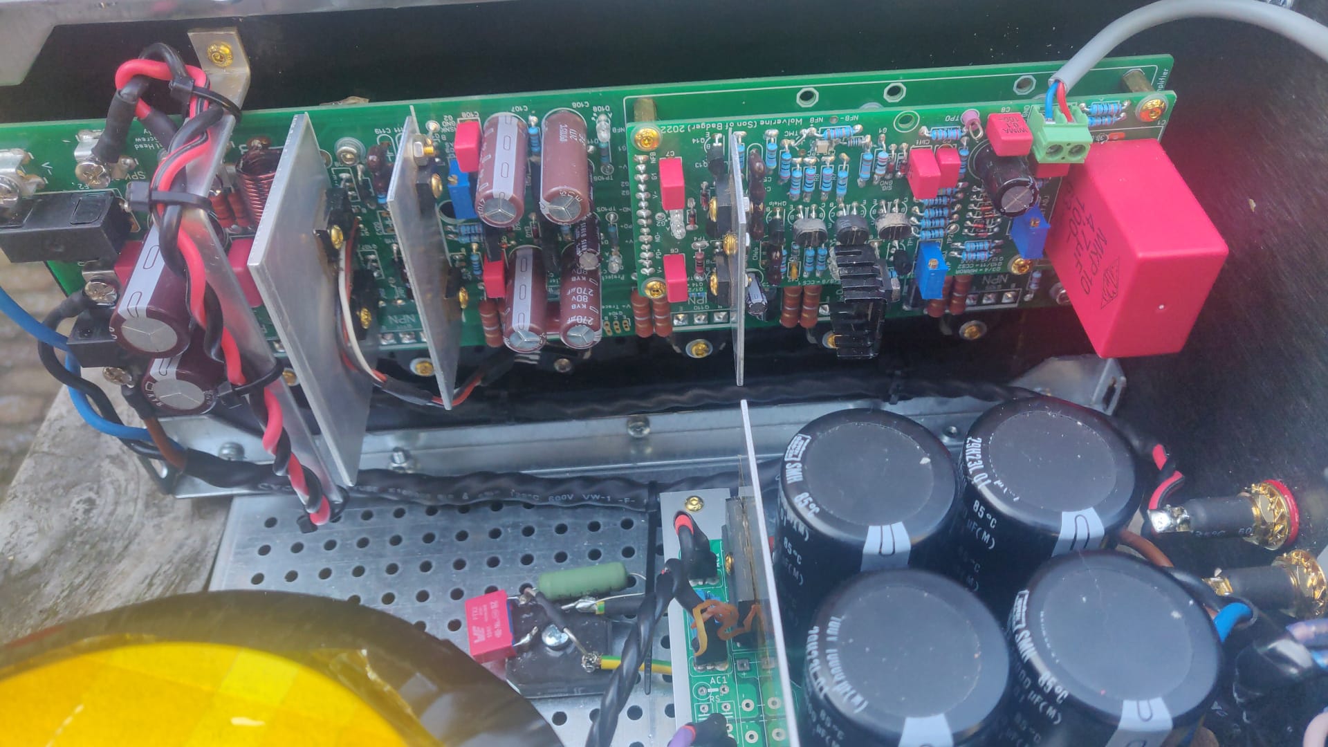

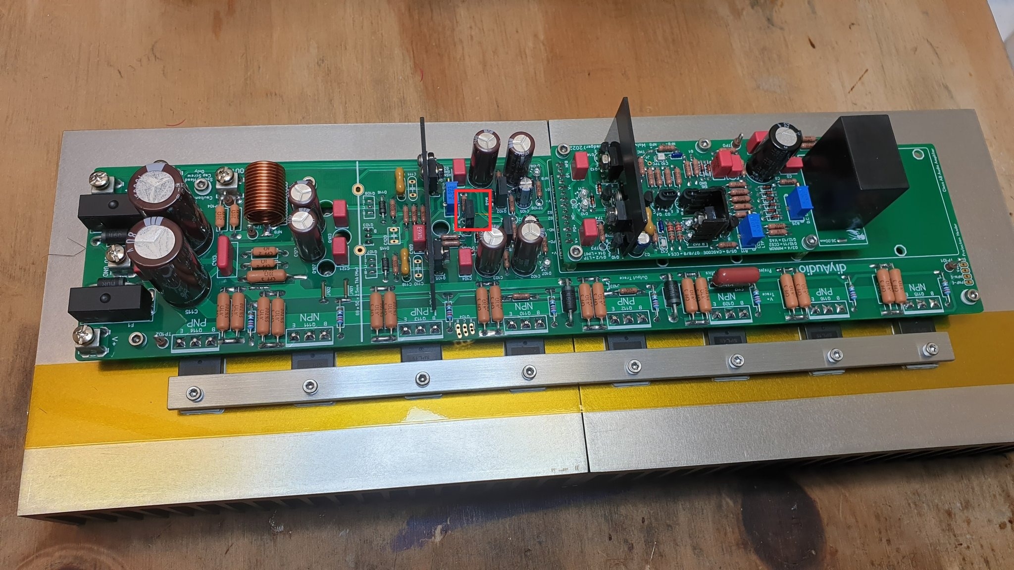

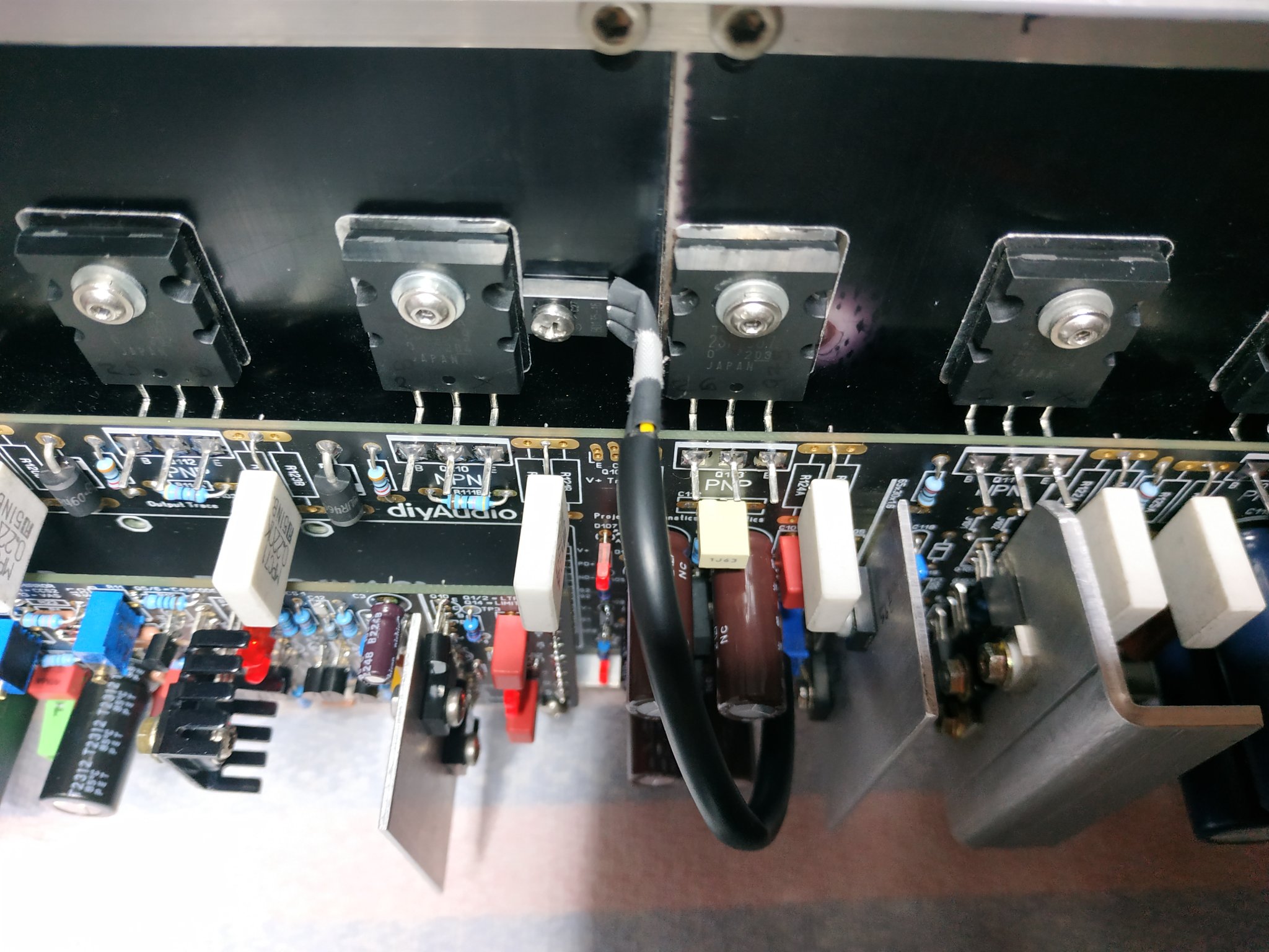

No, the whole arrangement of the vbe multiplier and the temperature compensation was completely reworked. Details are in this thread and the updated Schematic and Bom. We have been updating the build guide and a revision should be available in the next few days.Output Vbe transistor placed there for demonstration only?
https://www.diyaudio.com/community/...he-wolverine-build-thread.385920/post-7360185Is this the new position for vbe multiplayer?
Maybe you missed this post, details there. 👍

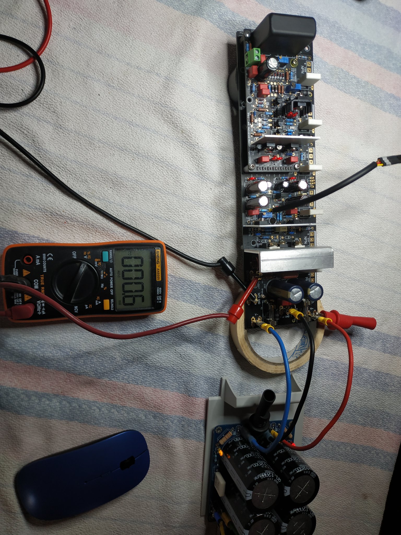

So in the interest of being frugal, as one has to be all the way down here, I've found a doner amplifier chassis. Getting heatsinks drilled and tapped is no issue.
The corpse is a Parasound HCA-1206 with PSU caps that had gone up in smoke and made a meal of the PCB too, thanks to the main caps being under spec'd from the factory. Whilst pulling it apart to begin inspecting the case I noticed its chock full of Sanken 2SC3263 and 2SA1294's, which are also on the wolverine output list. Could these be reused at all in my 3 pair, with proper testing? You'll have to sympathize with me wanting to be cheap, but shipping here is spenny and funds have really tightened up. On the other hand, I fully understand if you want to tell me no, the wolverine is deserving of only the highest quality new parts you Scrooge.
My power supply is going to be the (unregulated) hypex smps1200a400 65VDC as I already have one of those here.
I would say reuse them, after testing. They are great outputs!Sanken 2SC3263 and 2SA1294

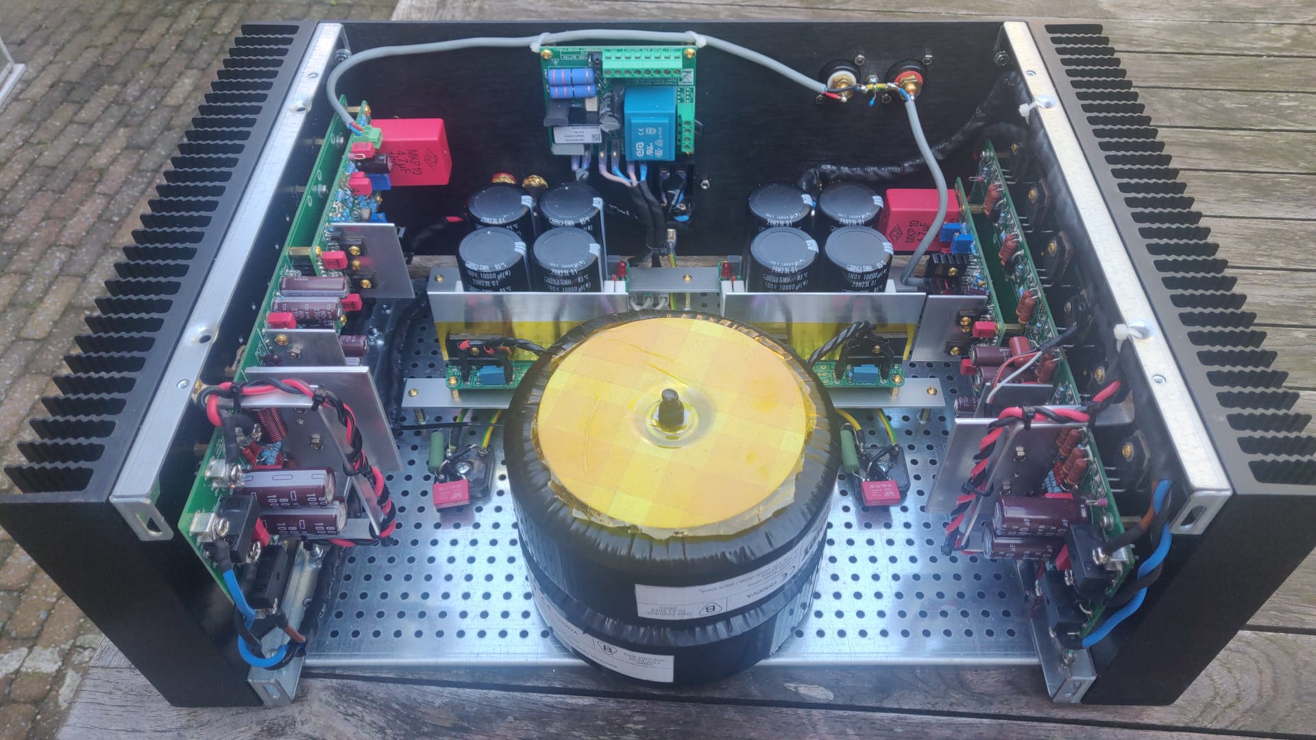

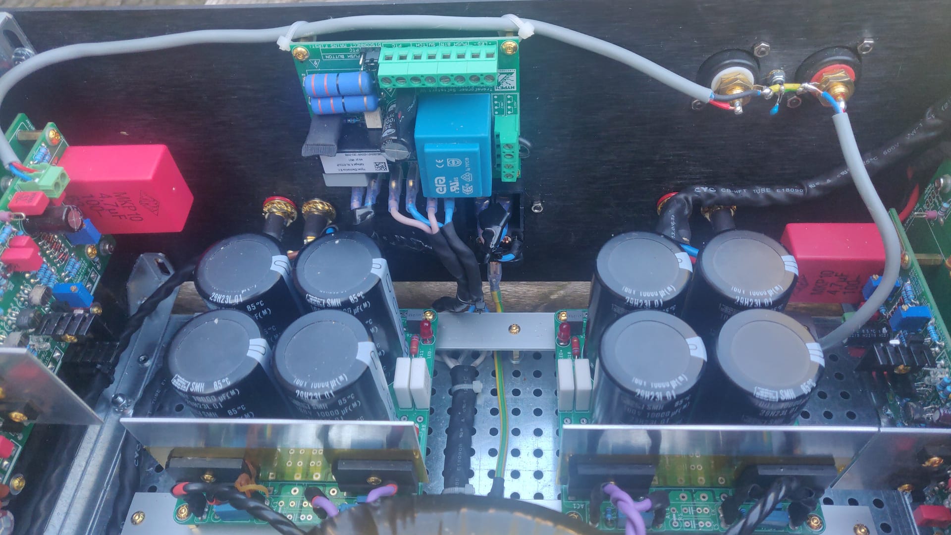

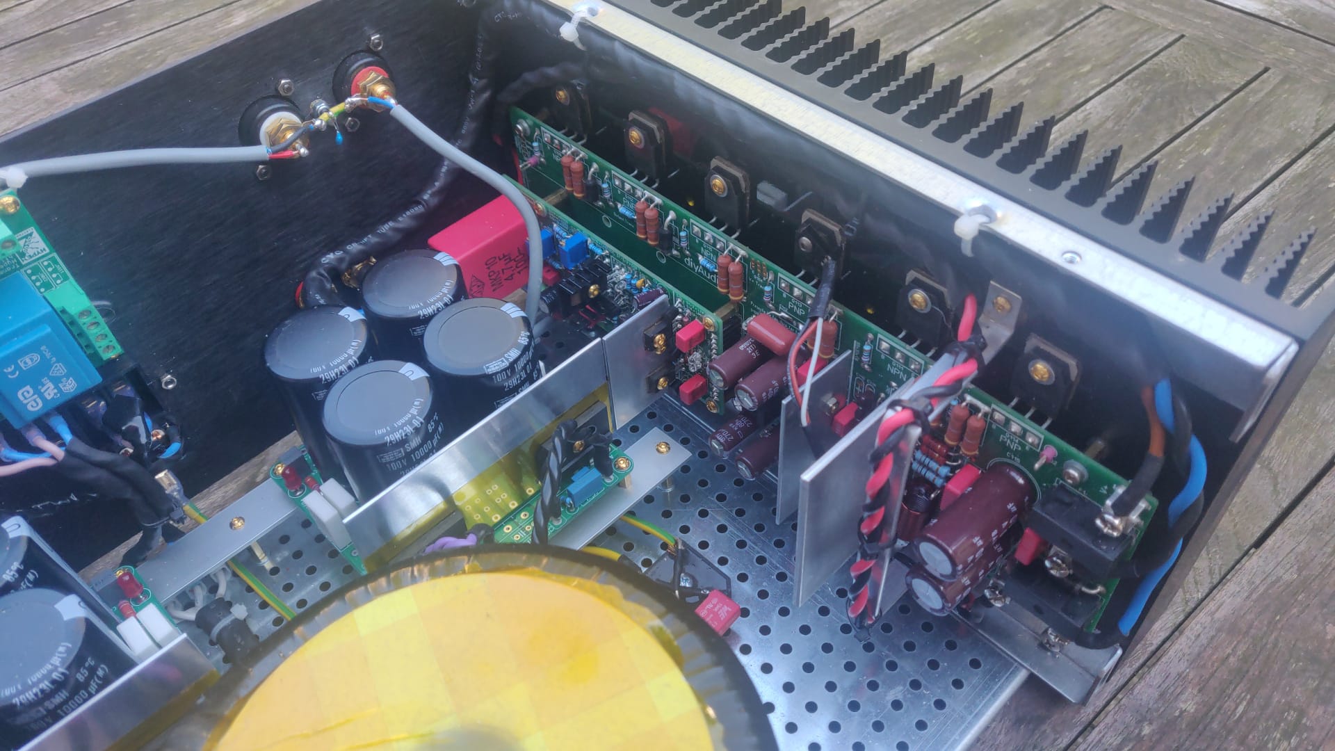

Final assembly and wiring done. Of course some should haves and could haves. Used as much tips as I could comprehend. I'm not a 100% happy with the wiring but for now as good as it gets I think......All the noob support appreciated!!

Great work Willem !Final assembly and wiring done. Of course some should haves and could haves. Used as much tips as I could comprehend. I'm not a 100% happy with the wiring but for now as good as it gets I think......All the noob support appreciated!!
