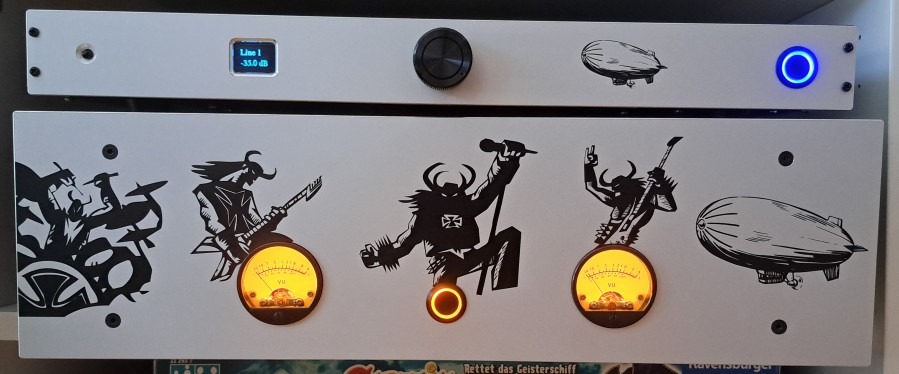

Parts selection, soldering, wiring, ... everything is important. But in the end, it's also about optics 😎
I WANT THOSE GAUGES!... where do you get them and how to wire them.... 😁optics
The ones I used were similar to these:
https://de.aliexpress.com/item/4001211032454.html
(I used a yellow version with LED backlight - gives this sort of steampunkish look)

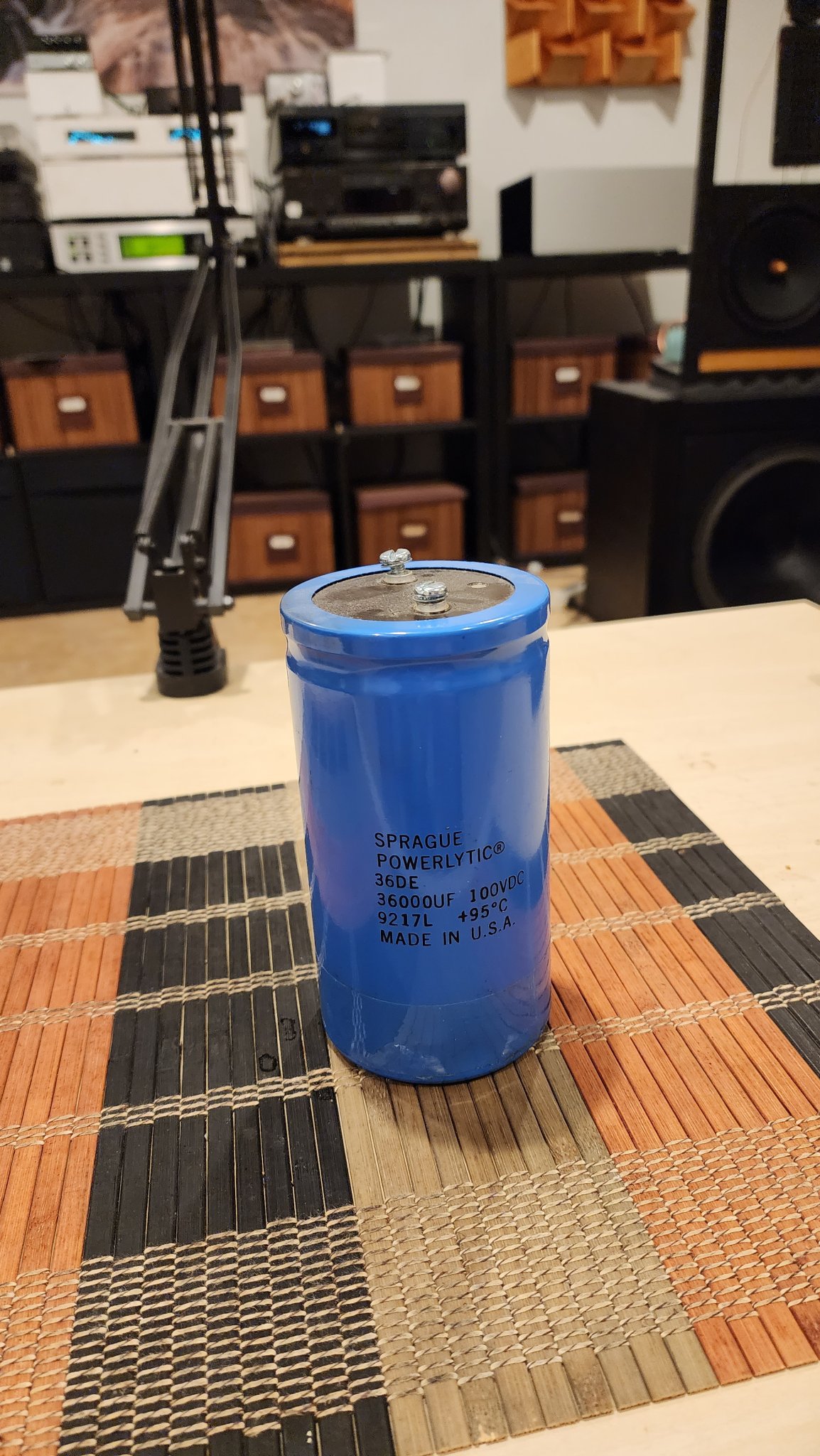

Weird question, i am building second power supply for second wolverine, what's maximum capacitance recommended/allowed?
Hi Adason,

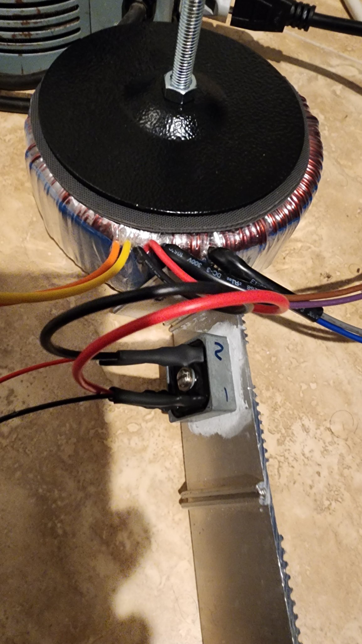

What sort of transformer and rectifier setup do you have or plan to use ?
This information can help to decide on what is required
- Dan
- Dan

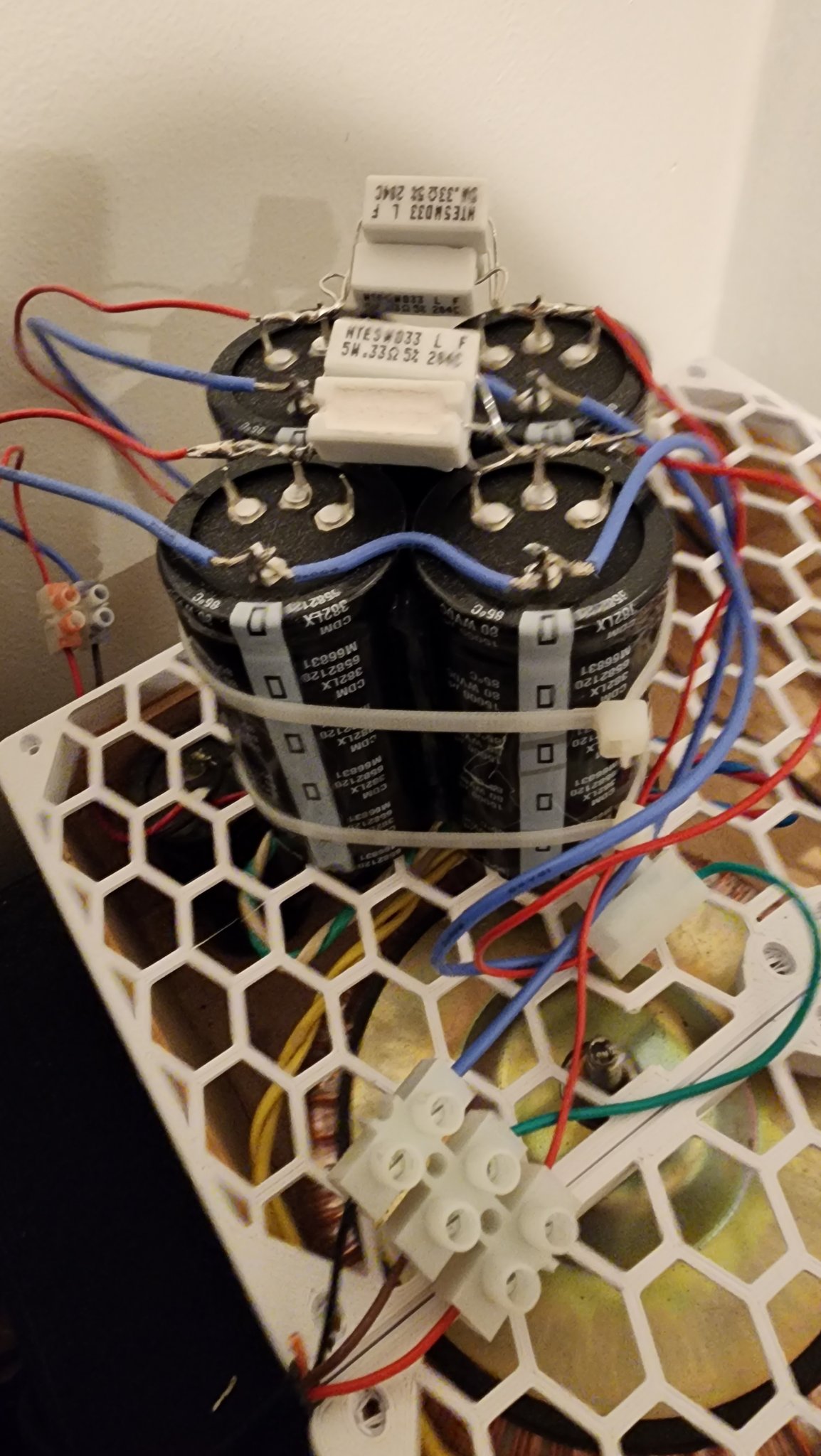

Nice capacitors.
You may want to consider RC snubbing large Electrolytics.
What model rectifiers ? I would check peak current capability. Just to be safe.
Hope this helps
- Dan
Hope this helps
- Dan
I have abandoned big caps idea. Too much stress on toroid. Will just put bunch of small caps in parallel to make smaller usual value.
