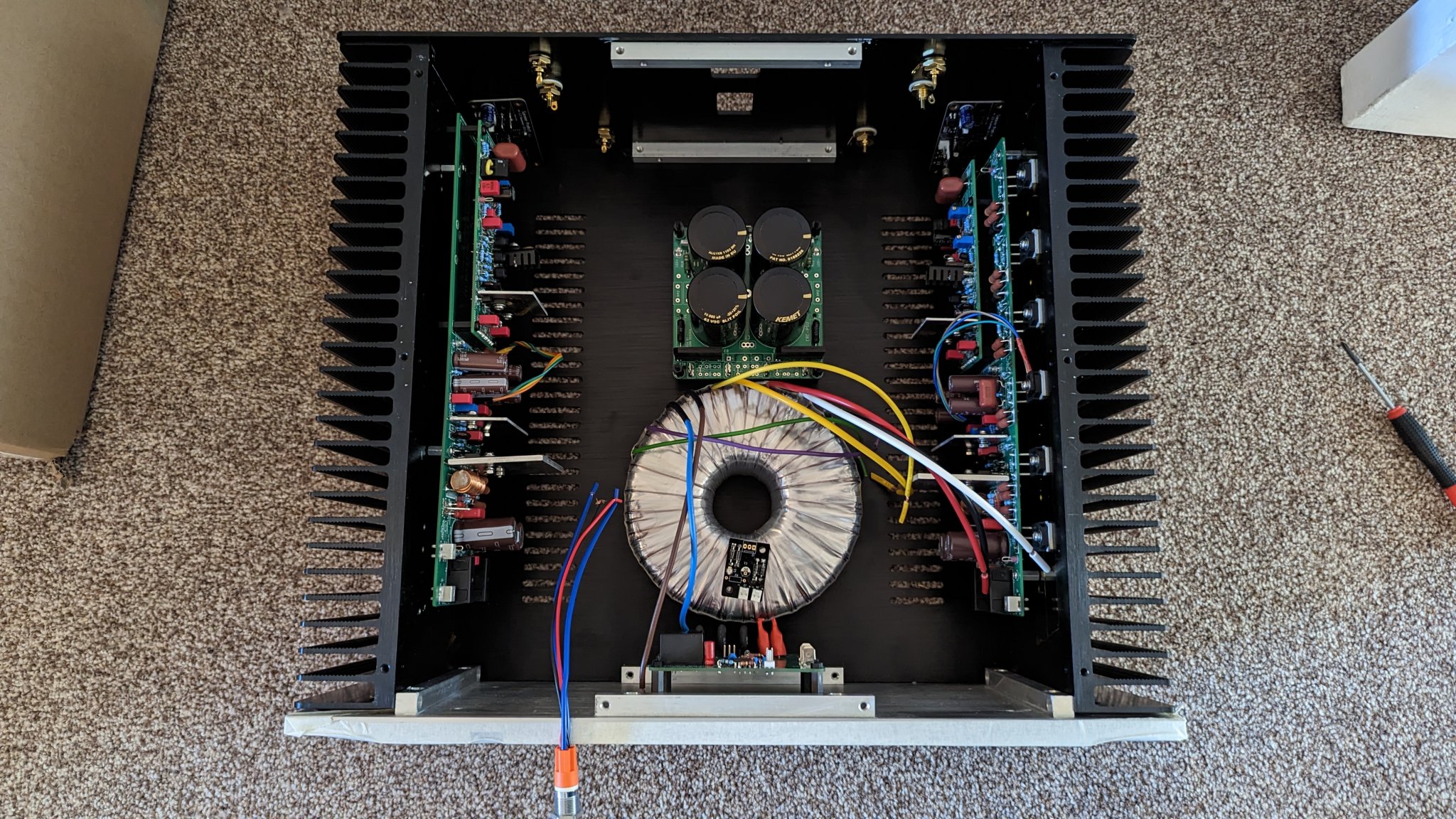

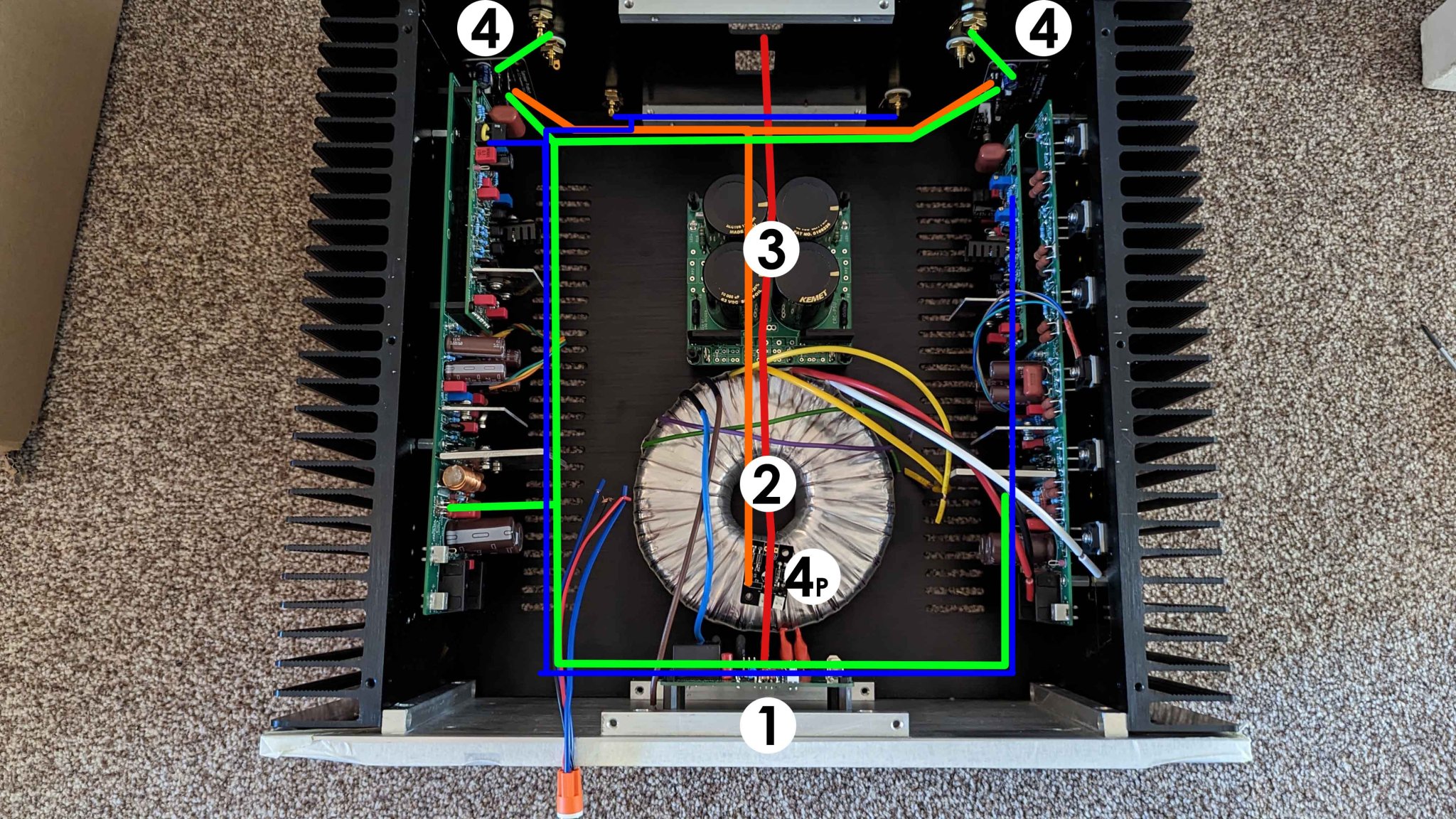

Layout.
1. Soft start (situated either at the back or front panel)
2. Traffo with electrostatic screen
3. Power supply
4. Speaker protection (18 v DC)
4p - Speaker protection low capacitance power supply
Switch most likely will be at the back panel.
I understand it is ok to:
A. Run AC (RED) wires, twisted straight through the middle via soft start then back to transformer and rectifiers
B. Run wires (ORANGE) from 15V secondaries of the transformer to tiny PSU (4P) and after that run (twisted) along the red wires then split to left and right channels as shown
C. BLUE signal input wires to run along the perimeter as shown, twisted.
D. Amplified signal (GREEN) twisted to run alongside the blue path to the pair of speaker protection and then into speaker hook up points.
As well, can you recommend the location and type of ground without using fancy boards as I don't have them?
Suggestion how to proceed with electrostatic screen 2 wires from the transformer, where to hook them.
Thank you

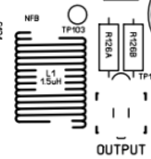

A while back someone claimed there were no silk screen errors. You may have been joking. Unfortunately, there are two sets of 126A and 126B on the EF3-4 boards V4.0. It's not a problem if you are paying attention and know the difference between emitter resistors and output networks.

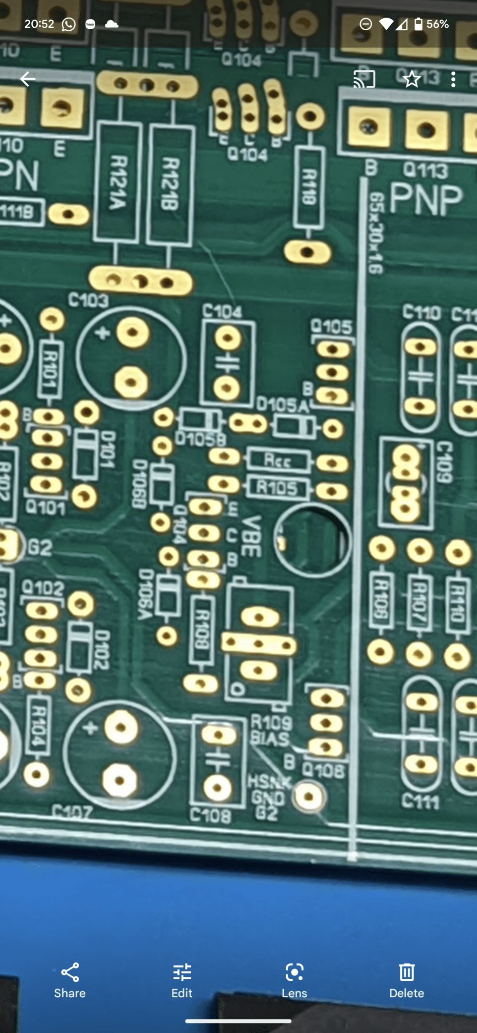

106A and B? Maybe they edited w/o notation, but that's not what their post says (emphasis added is mine). I have not checked my boards, but I will.I do not see 2 sets of 106A and B on the board. There was a 105 A and B.
As I recall a reply on the same question > Directly to the chassis.Suggestion how to proceed with electrostatic screen 2 wires from the transformer, where to hook them.
On the EF3-4 V3.9 board there is actually two sets of R126A and R126B. One set is to the right of Q115 and the other set is below C113.

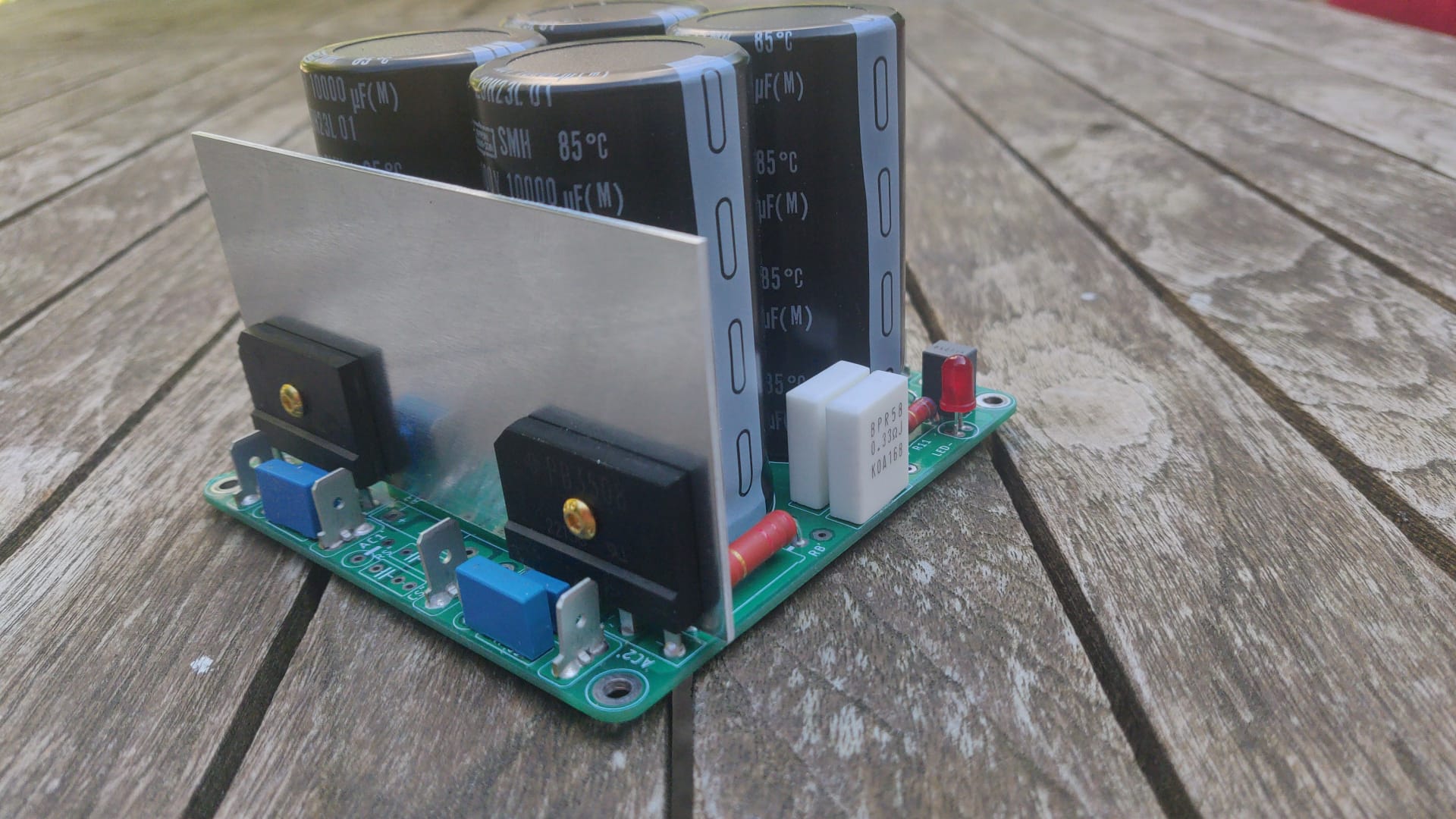

Rectifier heatsink.
The metal backplates of the rectifiers are not connected to any pins (measured it). Can I use just 1 plate or should I seperate them for extra safety?
I could also use some mica insulator but I prefer to just use some thermal grease.
What's best practice, risk etc...?
thx in advance
thx in advance
I would have placed the heatsink a little higher so that air can circulate more freely underneath and heatsink is not so close to resistor.
Yeah... saw that. I will cut a piece to have some space there.not so close
EF3-4 silkscreen from the latest guide (v33)
