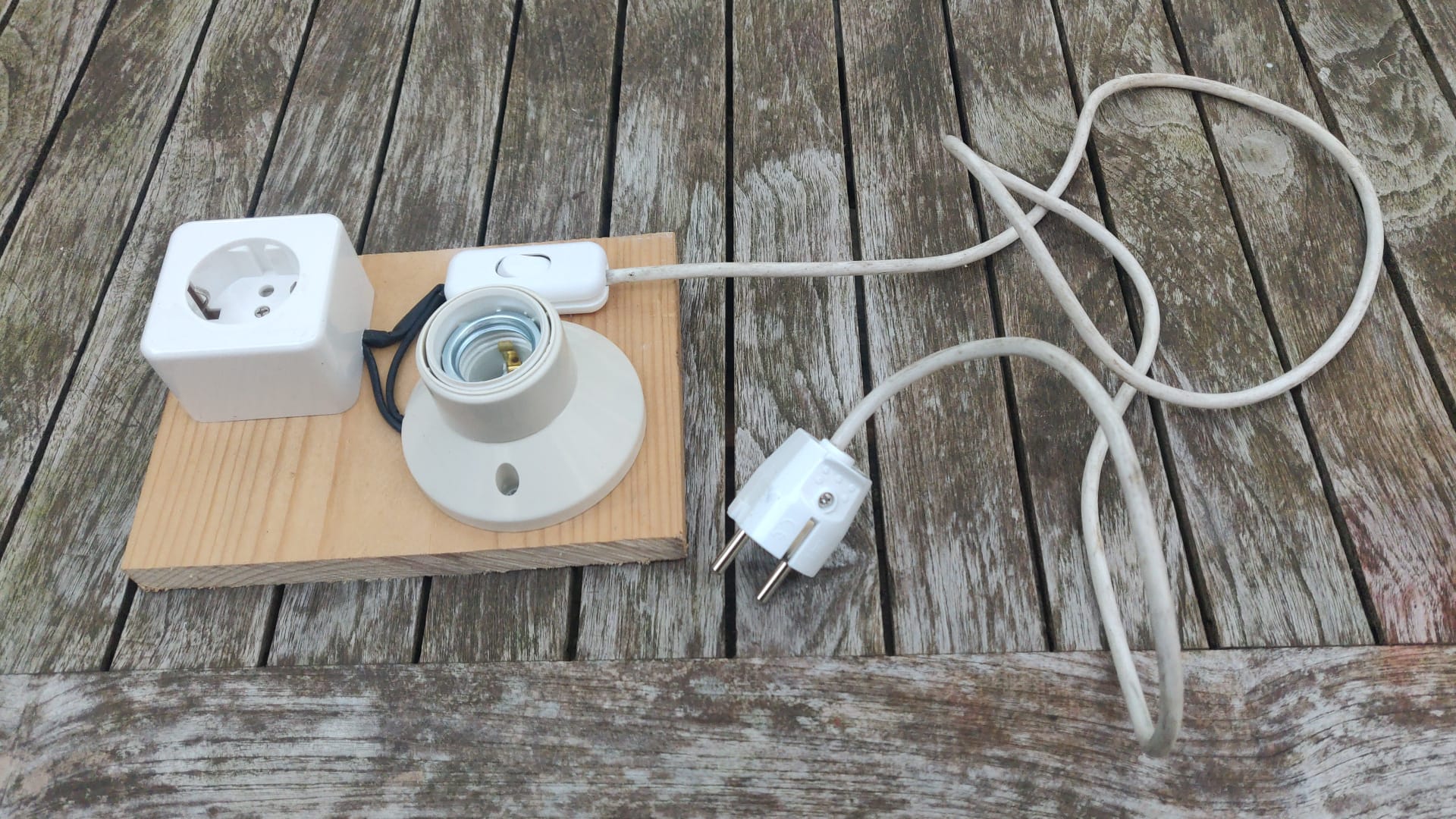

While waiting for the final part,...some alu plates to heatsink the rectifiers...thought I'd make the simple current limiter which I didn't have yet🙂🙂

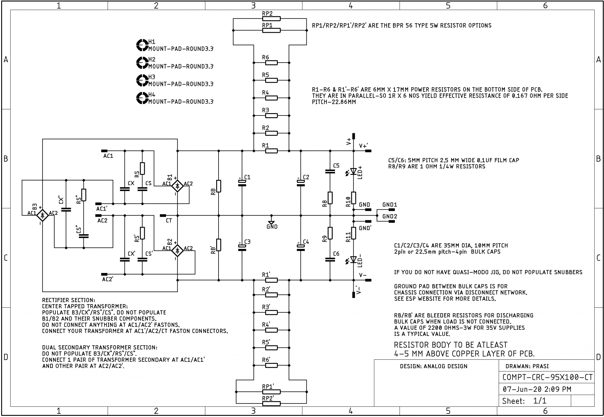

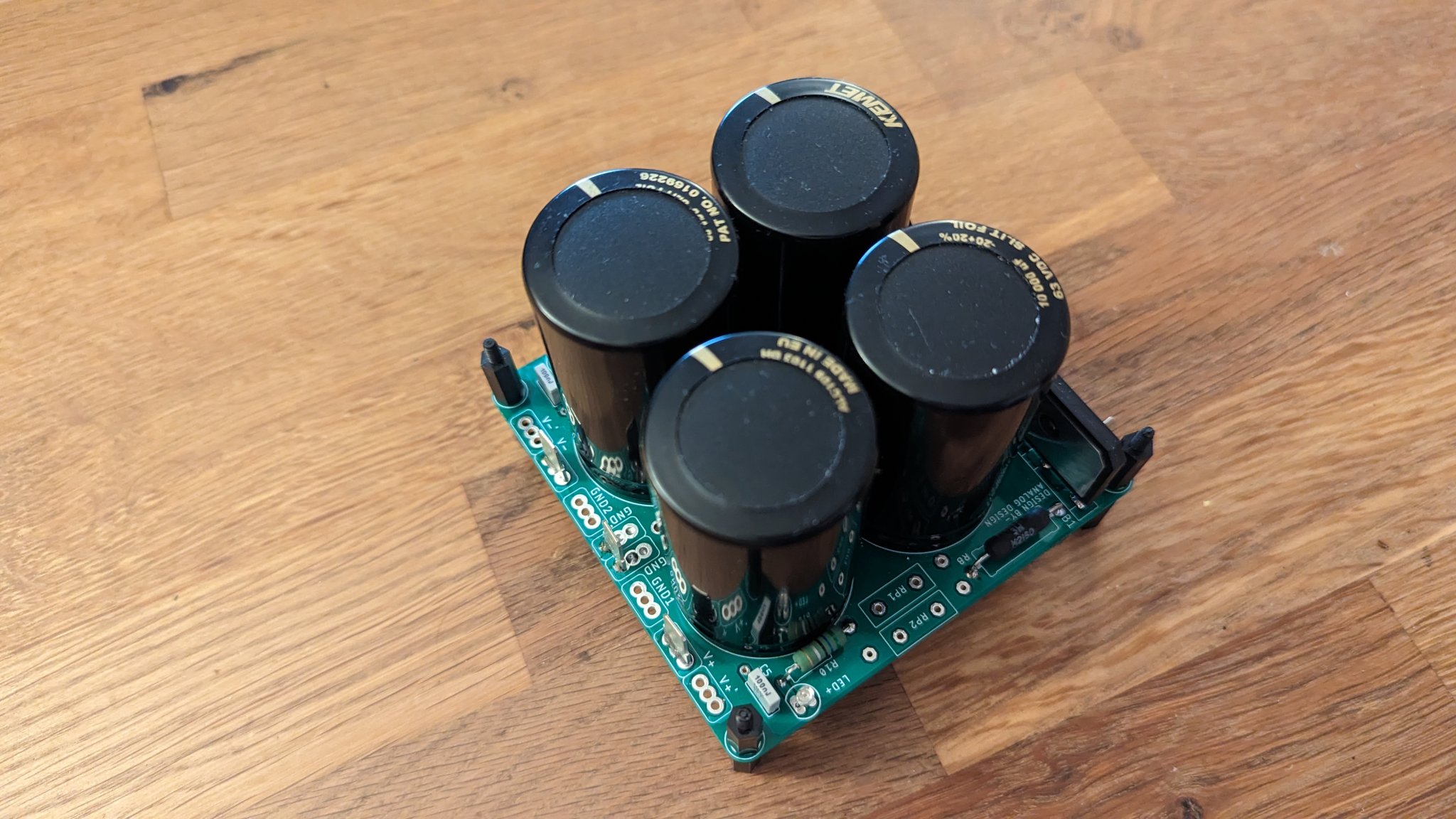

For my power supply, I have used Prasi CRC in rectifier + capacitor configuration.

I'm using the same psu boards. My rectifiers are postioned the same. I can't see how you can mount them the wrong way as there are markings all over the place🙂shiny side is towards the capacitor side?

YesWhat are those flat bridge rectifiers mounted? The shiny side is towards the capacitor side?

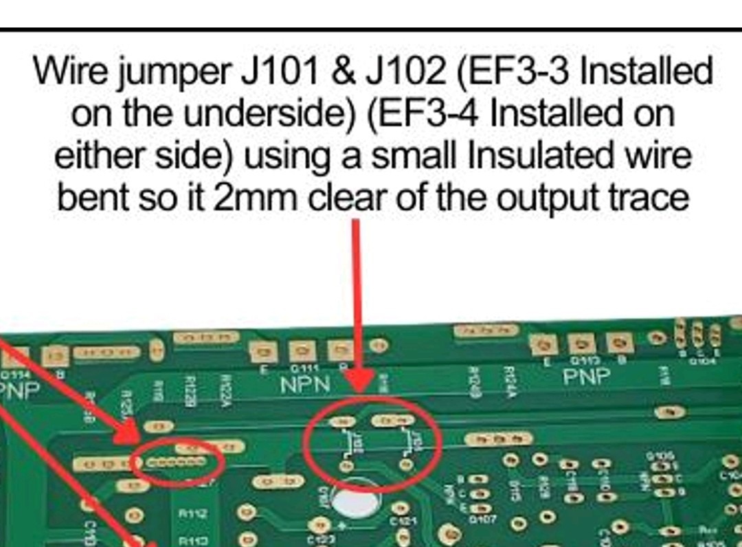

Hi Guys, two questions:
Can I use this 0.6watt 0 ohm resistor as J101 and J102?: 594-MBB02070Z0000ZC1
There is no mouser stock of the BOM suggested MUR460's, can I use 821-MUR460R0G instead?
@felix1024 : the overcurrent detection circuit is really nice. The four resistors implement a single slope VI limiting isn't it ? Where did you find your inspiration, and did you adapt the values to fit the SOA of the Wolverine output devices ?
@ghitus, yeah I know I can use a normal wire, but I have a whole bunch of 0r resistors that I think are exactly meant as jumper wires, so I think I can use them and it will look neat. Just want to make sure it wont lead to problems. If not a good idea than I will just clip the leads of some component and use that
