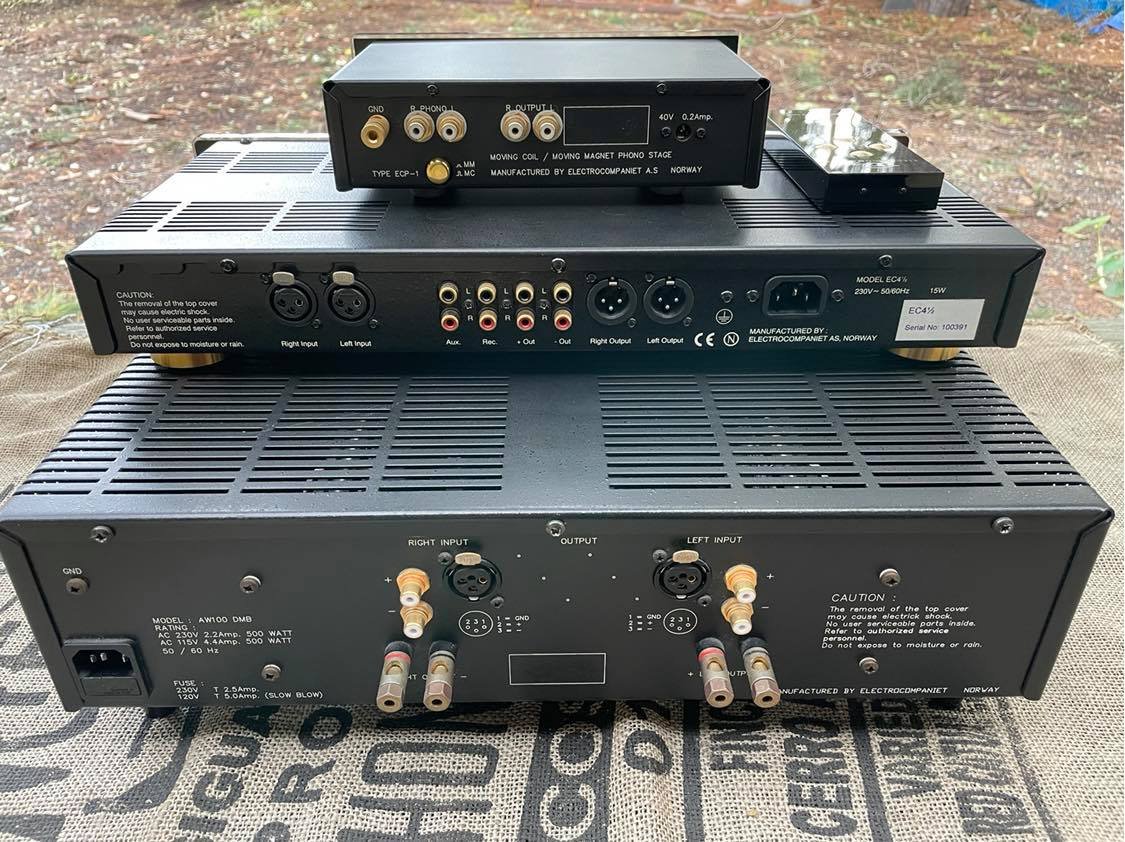

Back to Electrocompaniet. My friend has one of the basic models, namely AW100dmb model special edition or so with marble-like front panel. The system is on the attached photos although I took that photo from the internet. It's fully balanced dual mono amp with damping factor crazily high: 8000 and in this version power output is about 120W RMS into 8ohm.

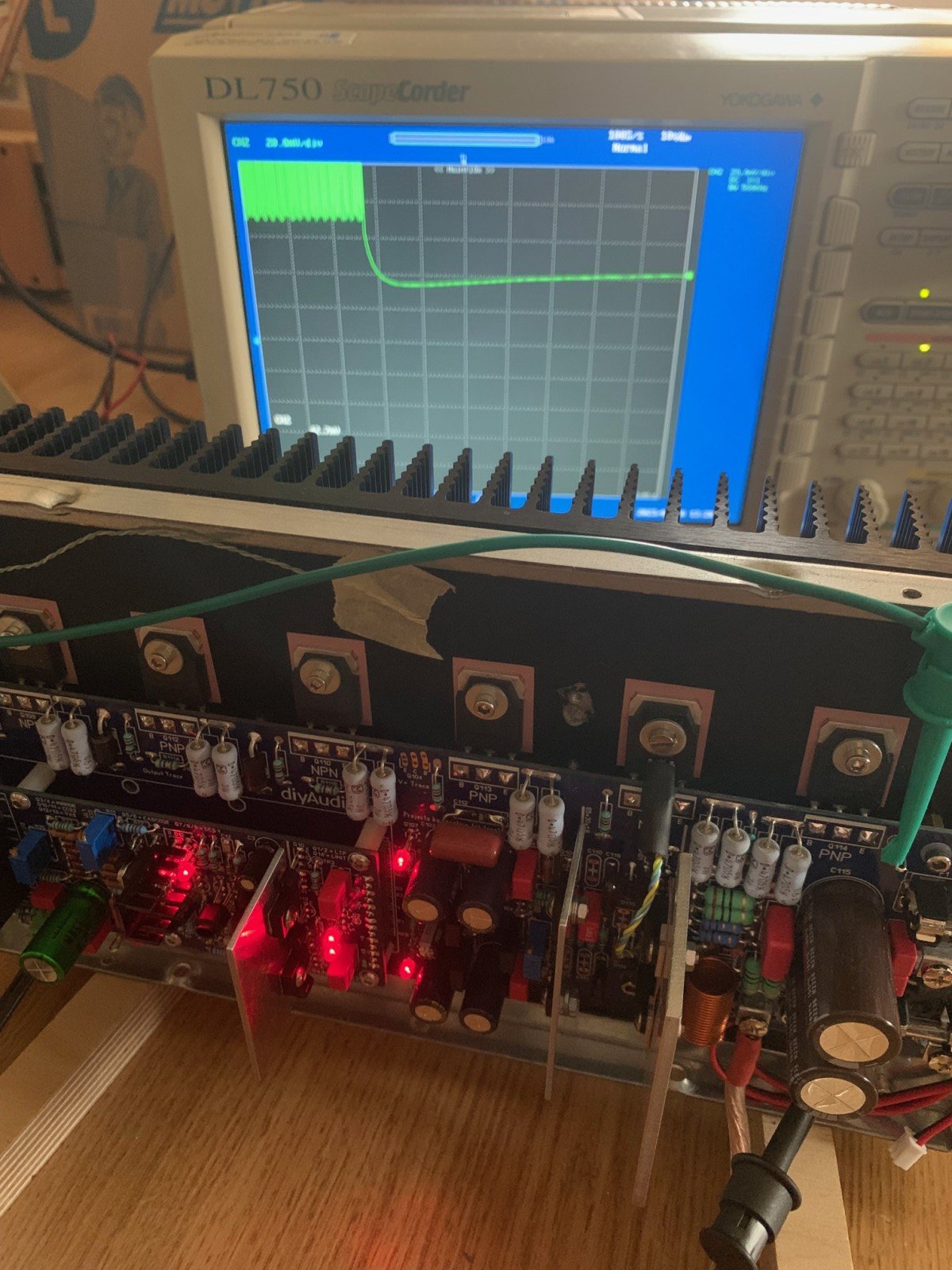

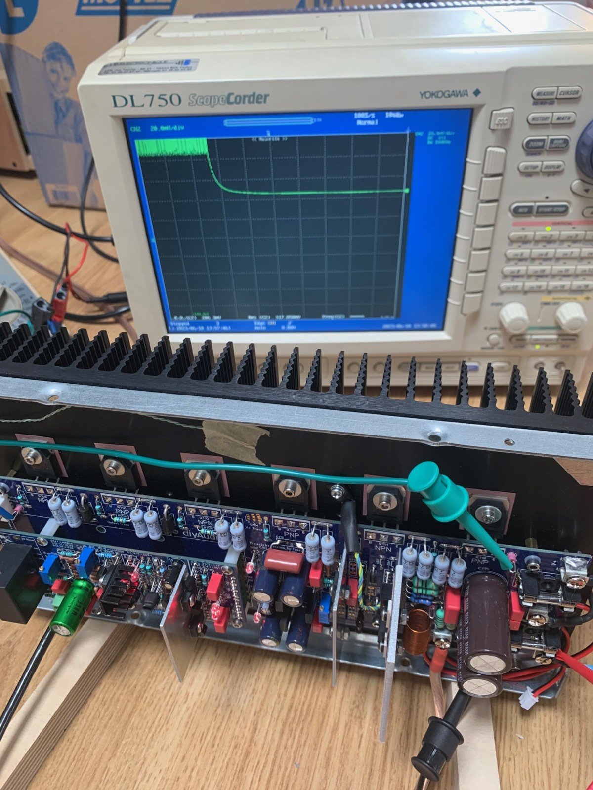

The function of Rcc is to keep the output of the vbe multiplier stable if the current source changes due to fluctuations in rail voltage.
The intrinsic emitter resistance re’ of Q104 is about 6.5R. The vbe multiplier will increase this by the Vbe multiplication factor of ~6
So 39R. This means that if current through the collector of Q104 increases by 1 mA, the bias spread will increase by 39mV. This is a significant fraction of the 44 mV output bias voltage across the emitter resistor.
So in summary as the collector current changes the value of re' changes.
The output of the vbe multiplier then also changes. So a value of Rcc is selected so that any changes to the collector current through Q104 which changes the value of re' are mitigated by the voltage drop across the Rcc resistor so the output of the vbe multiplier remains the same.
Hope that helps
I did a simple load test with the new Vbe multiplier on my EF3_3, first with Q103 on the heat sink between Q113 and Q111, then with Q103 on top of Q111. First I adjusted for each case the bias to 44mV without signal, with burn in and all. The I applied a 1kHz sinus tone of 50W in a 4 ohms load until the heat sink heats up to 50°C (measured with a thermocouple taped on the surface). I suddenly stop the function generator and plot the bias between TP-101 and TP-102 as a function of time. On the scope 20mV/div on the vertical axis and 10s/div on the horizontal. As you can see, with Q103 on the heat sink the bias returns smoothly to the steady state value. With Q103 on top of an output there is a slight dip towards 35mV but overall still a nice result. With the old configuration the bias dipped below 20mV. Good work you guys.
