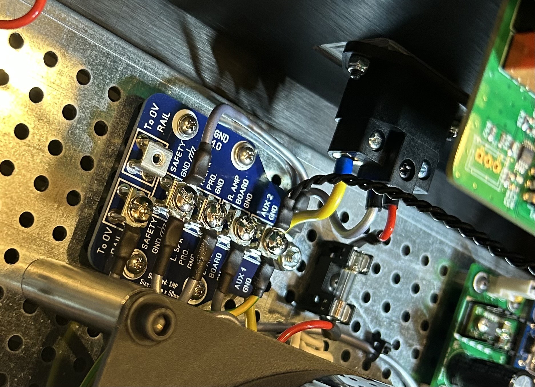

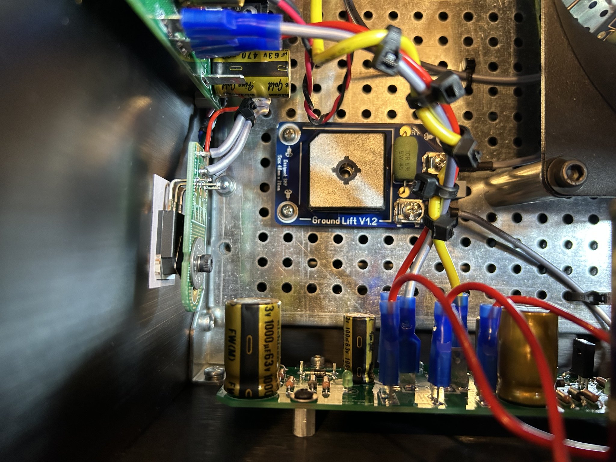

No, they are not. I ordered all the components for mounting these two pcb’s from Digikey. You do save when you buy and build in bulk not in singletons. You do have the option to use your own components from stock as well, the recommended components are just that, recommendations. But they are GREAT recommendations with regards to safety. The T-GND in particular is an excellent pcb. It makes the super crowded chassis ground bolt a much neater and safer feature imho.Are any components included in the ground lift pcb from pcbway? I just noticed that the price for 5 pcs of the ground lift pcb is $37 and the price for 5 pcs of the T-ground pcb is only $6,50. 🤔
Best,
Anand.
I would give you the PCBs for free.Are any components included in the ground lift pcb from pcbway? I just noticed that the price for 5 pcs of the ground lift pcb is $37 and the price for 5 pcs of the T-ground pcb is only $6,50. 🤔
You would only have to pay shipping
PM me if you want
Hi Anand,No, they are not. I ordered all the components for mounting these two pcb’s from Digikey. You do save when you buy and build in bulk not in singletons. You do have the option to use your own components from stock as well, the recommended components are just that, recommendations. But they are GREAT recommendations with regards to safety. The T-GND in particular is an excellent pcb. It makes the super crowded chassis ground bolt a much neater and safer feature imho.
Best,
Anand.

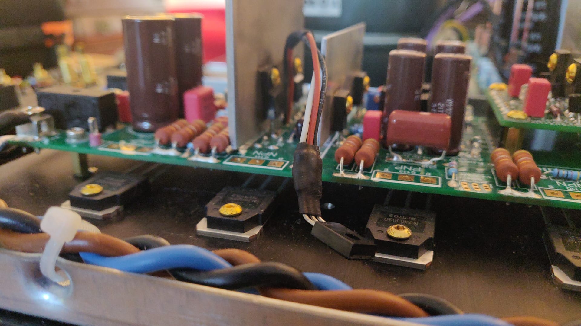

Thermal spreader improvements as suggested by fireanimal installed. See post links below.
Should I tap a hole between the 2 outputs or use the one just below the amp board which came with the modushop sink. I've understood mounting it directly ontop of the output is not the correct way. Too much thermal swings?...not a 100% sure....
#2057
#2065
#2057
#2065
I am not an EE but I am familiar with thermal engineering. Temperature difference between the two points would be minimal and thermal delay is only a few seconds at the most. So it should not make a big difference. That said, I had the tools so I drilled a new hole between the 2 outputs.
The original hole for Q104 is a bit further away and with the increased thermal delay it probably would make a difference.
You can mount directly on the output transistor with no problemThermal spreader improvements as suggested by fireanimal installed. See post links below.
#2057
#2065

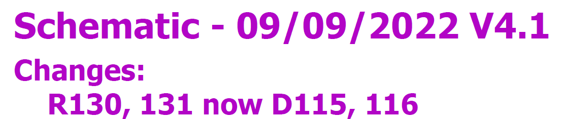

I'm on my way to order parts from mouser, but the MBR1100G (D115, D116) is out of stock. They expect more next year. 😴
Are there any replacement diodes for these?
There is stock at Newark https://canada.newark.com/on-semico...er-diode-single-100-v-1/dp/38K4498?CMP=AFC-OPI'm on my way to order parts from mouser, but the MBR1100G (D115, D116) is out of stock. They expect more next year. 😴
Strange, when I change country to Finland it says lead time is 51 weeks for the product. I'll se what I do.
This one seems to be in stock https://fi.farnell.com/en-FI/on-semiconductor/mbr1100g/schottky-rect-1a-100v-do-41/dp/2535567
Where are these D115 and 116 diodes? I do not see them in the parts list nor on the schematic. Did I miss something in this thread?
Thank you,
Thank you,
By the way, what about SB1100? It is also a schottky barrier rectifier 1A 100V. Mouser has a large stock of these.
Thank you,
Thanks,
if these diodes are to replace these two resistors than SB1100 or SR3100 (3A 100v) should be good enough replacements, am I right?
We are verifyinghese diodes are to replace these two resistors than SB1100 or SR3100 (3A 100v) should be good enough replacements, am I right?
