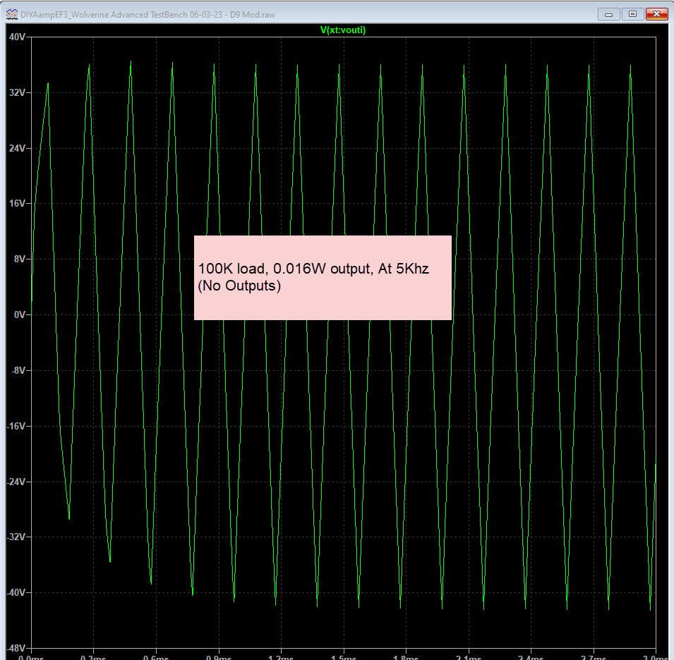

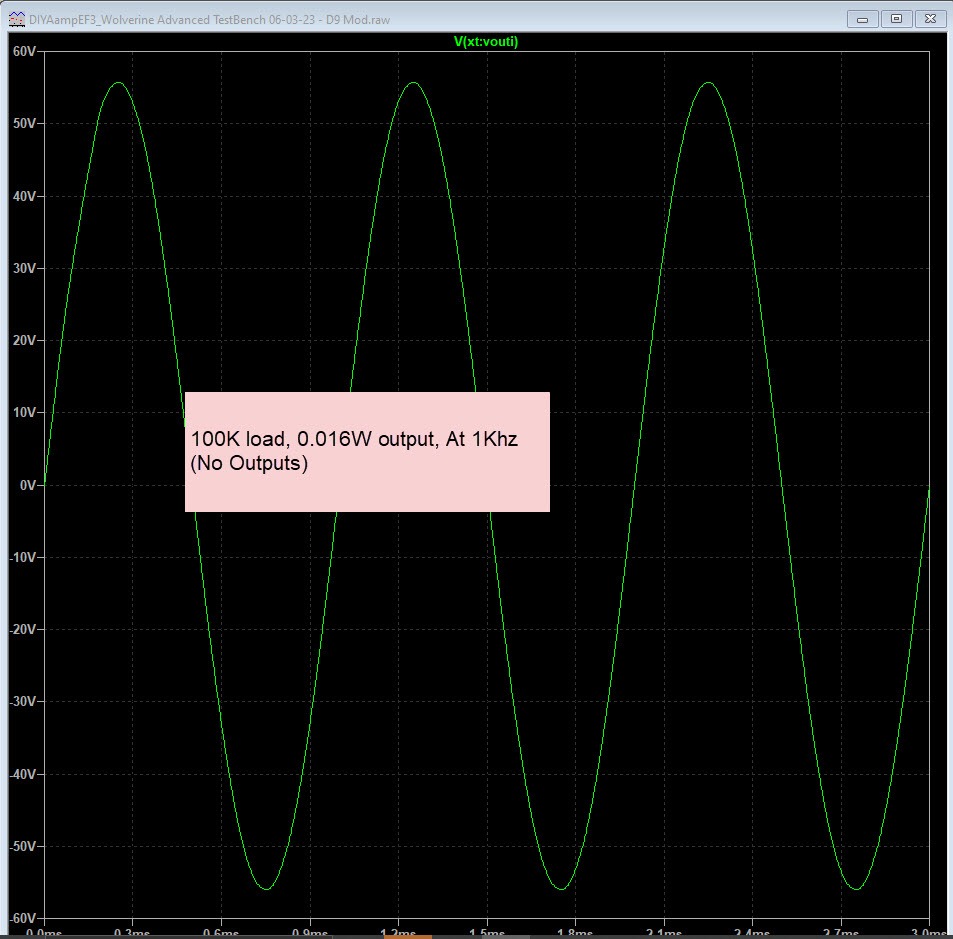

I need some help from you folks. I am working on bringing up an EF3-3 board. I am at the point where J103 is installed and none of the output transistors. Other than that the build is complete.
During testing, I noticed a 6dB/oct roll off starting at 10kHz. I figured it was a cap off by 10 somewhere, but further investigation showed that the problem is actually slew rate limiting. I have swapped the IPS into a working EF3-4 with all of the output transistors, and in that rig, the whole amp works fine out to full power at 100 kHz. (Guys, best to heed the warning about full power testing above 20kHz, lest the magic smoke be released from the Zobel resistor.)
On the output stage I am bringing up, the output looks fine and flat at low amplitudes, and at full 96V pp at 1 kHz. However at full output swing, by 3 kHz distortion starts to set in, and by 4 kHz the output turns into a diminished triangle that gets smaller as the frequency rises. As soon as noticeable distortion shows on the scope, the two LEDs across the VAS get much brighter. I have tried varying the bias from min to max, and it makes a very slight difference in where the limiting starts, but there is no setting that seems to work correctly. Both rising and falling edges are affected, nearly identically. The swing is within 5 volts of each rail, perhaps a bit less on the negative side, but not more than 300 mV. Clipping seems to set in more or less symmetrically.

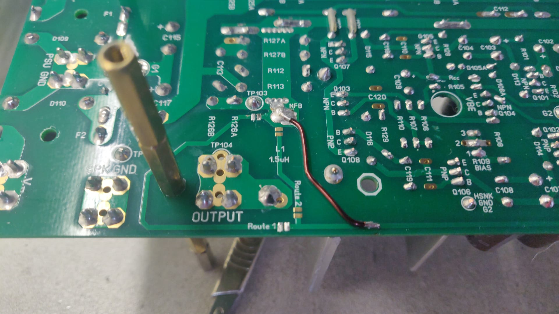

Third and hopefully final NFB route option...🙂....I'm a bit worried to be honest about desoldering R105 to R108 for the other improvement as I soldered both sides and I really don't want to remove anything else to gain better access or do I just cut them away and suck the leftovers from the bottom?

Great job on the feedback trace! Easiest way is with a good solder sucker, heat up the part from the bottom and suck the solder out, then de-soldering wick the remaining. Small pliers or tweezers is all that's needed to remove them, and to reinstall. I did it a few times, so speaking from experience 🤣

Does someone know for a fact that the pre-drivers or drivers should be able to drive the output Zobel (C113) rail to rail at high frequency?
I pulled the driver base resistors and caps and then replaced R110 with a pair of 240 ohm resistors and tied that junction to the output trace at J103. At 10 kHz, around 3.4 volts peak, the output began to clip. I measured the current through the 10 ohm Zobel resistor and it maxed at around 22 mA. That seems low to me, but as soon as I popped out the Zobel cap I can now get the pre-drivers swinging within 3.5 volts of the supply rail out to 60 kHz or more. The Zobel net at 10kHz is about 160 ohms and is mostly capacitive.
Unless one of you can tell me that this is indicative of the circuit not working, I am going to write this off as yet another Homer Simpson moment in my illustrious electronics career. Doh!
The test without the outputs installed is just meant to be a circuit check. If it passes the points outlined in the build guide then there is no need to go any further.
I have run a few simulation for you and can confirm what you are seeing with the outputs not installed.
If your Output board passes the tests listed in the build guide to preform when you only have the drivers installed you should be safe to install your outputs.
