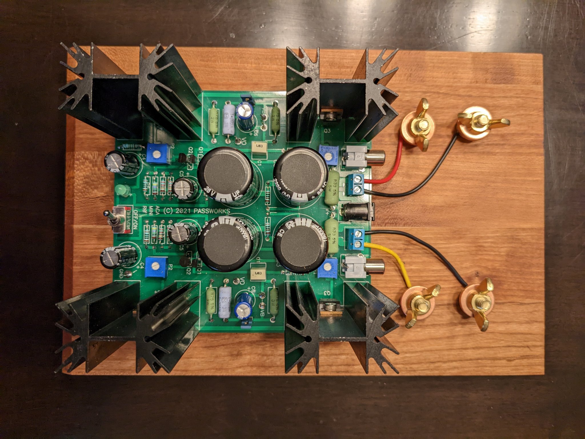

I have the ACA Mini board but had to source the parts myself as kits were sold out at the time of my order. I did not see any insulater pads for the transistors. The photo by 6L6 appears to apply only heatsink grease. Is the grease all that is required or should a mica or other pad be used? Thank you.
Insulators are not required if you use the PCB mount heatsinks. (They certainly won't hurt if you hav some.)
If you mount the transistors to another surface insulators are required.
I used a tiny dab of grease on each FET. The heatsinks seem very effective. It takes about 10-15 minutes for the amp to fully warm up. If in doubt I would use the grease. Most people over apply it. It really only takes a little dab in the center of the FET.Hello all,

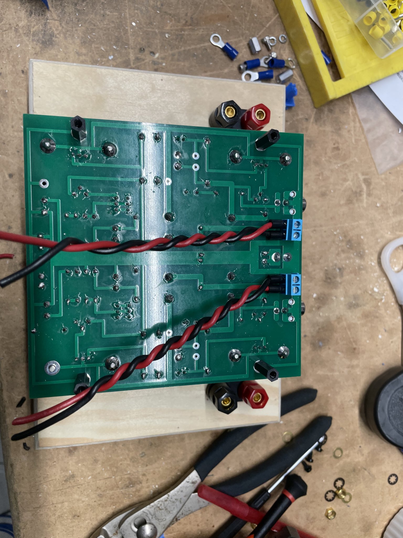

Has anyone bridged a pair of ACA minis? Is it possible? if so how?
I did it and it works well. I used a simple unity gain inverter circuit with a TL071 to feed the negative side. But, you could probably use a resistor to tap the inverted signal from the drain of Q1. It looks like there is a symmetric inverted signal there. But... I have not tried it and I'm not sure what effect that would have on the bias. Considering it would be driving a 100k load plus divider resistor I'm thinking it could workHas anyone bridged a pair of ACA minis? Is it possible? if so how?
This is what I did with a TL071 and it works well. Unity gain stable and FET (Hi Z) input were the reasons I chose this part.I did it and it works well. I used a simple unity gain inverter circuit with a TL071 to feed the negative side. But, you could probably use a resistor to tap the inverted signal from the drain of Q1. It looks like there is a symmetric inverted signal there. But... I have not tried it and I'm not sure what effect that would have on the bias. Considering it would be driving a 100k load plus divider resistor I'm thinking it could work
Someone smarter than me could probably figure out something better.

Bal+ to right channel hot lead. Bal- to left channel hot lead. Bal gnd to Mini gnd. Connect speaker + to Right + and speaker- to Left +.Would you guys mind letting us know how exactly you wired the balanced input to the amp?

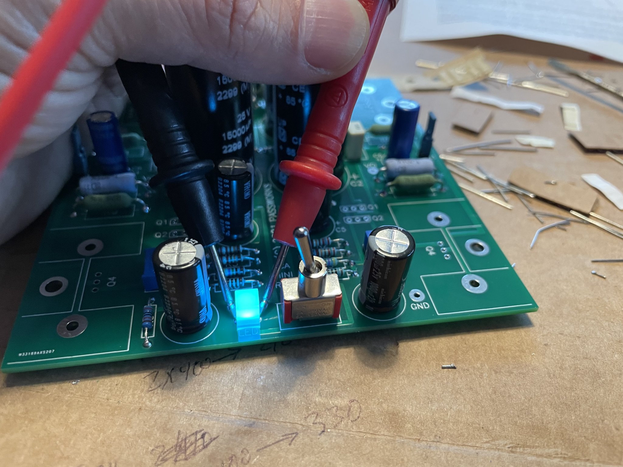

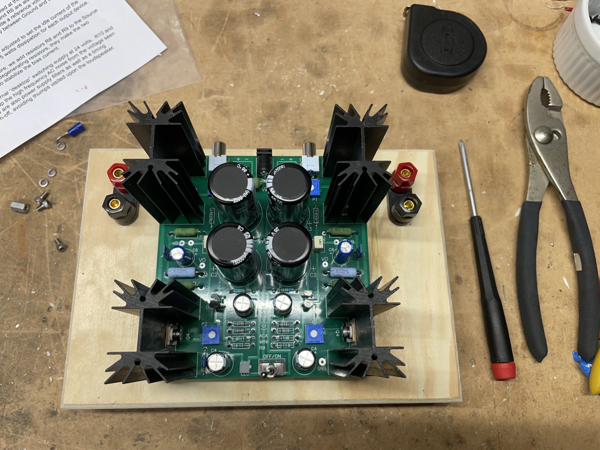

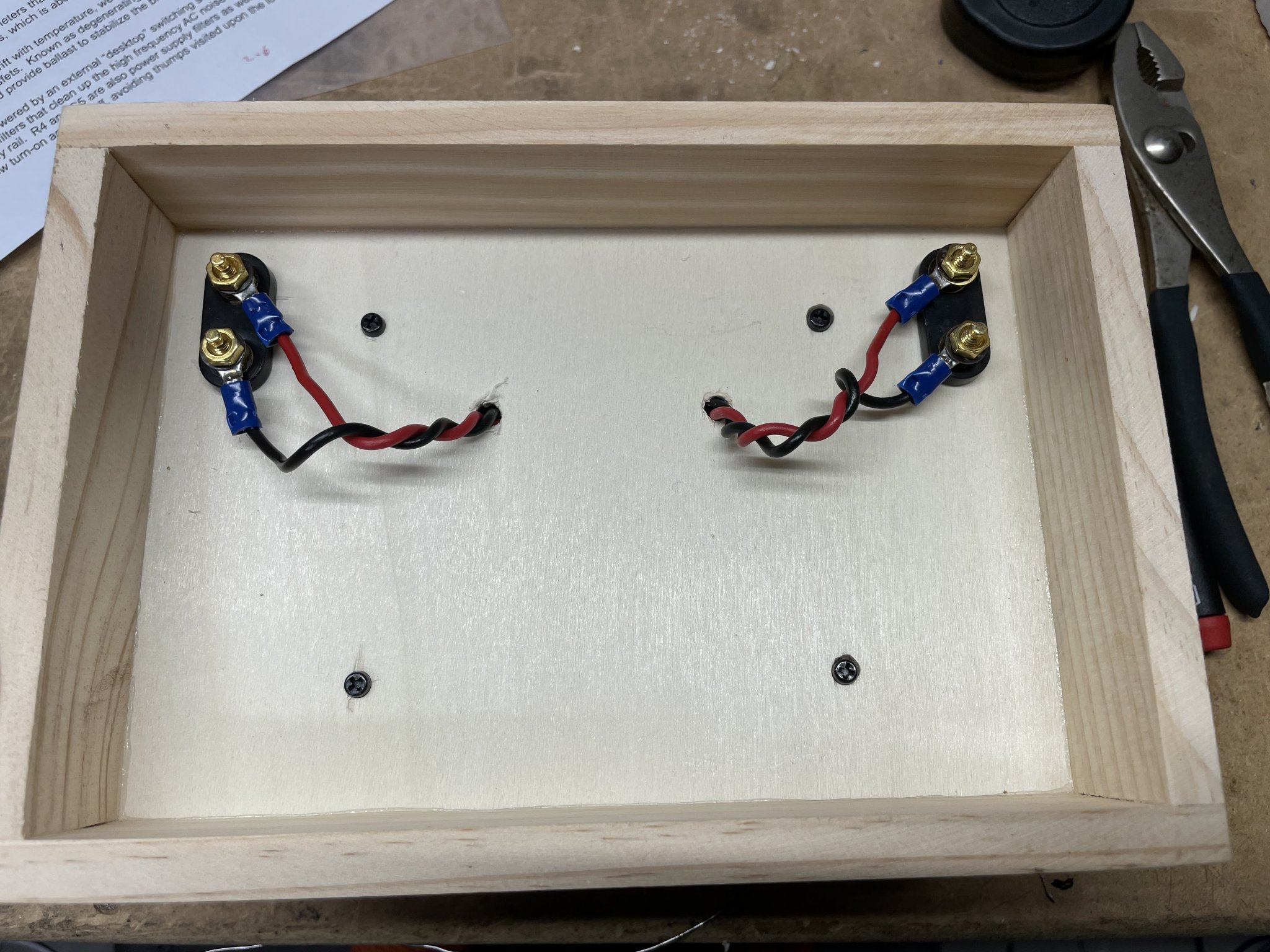

ACA mini is ready for action. I went to get a picture frame at the craft store, but ended up with this box for less than $6. Speaker posts and “ice blue” ice cube LED were in the parts box. Today I’ll test it on real speakers. It sounded great on my bench speakers. I may paint or oil the box at some point in the future.
Thanks Nelson for another cool project!!

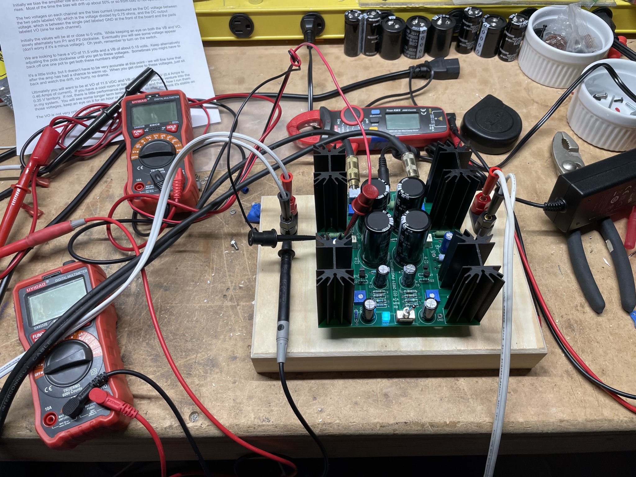

I’ve had this amp playing a few hours today on 91dB JBL 4410 monitors. Wow. This is easily the best bargain in audio. It punches several levels above its weight. Well done on this kit design!!!

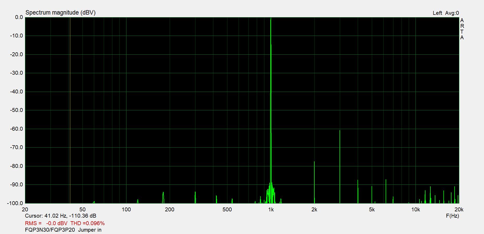

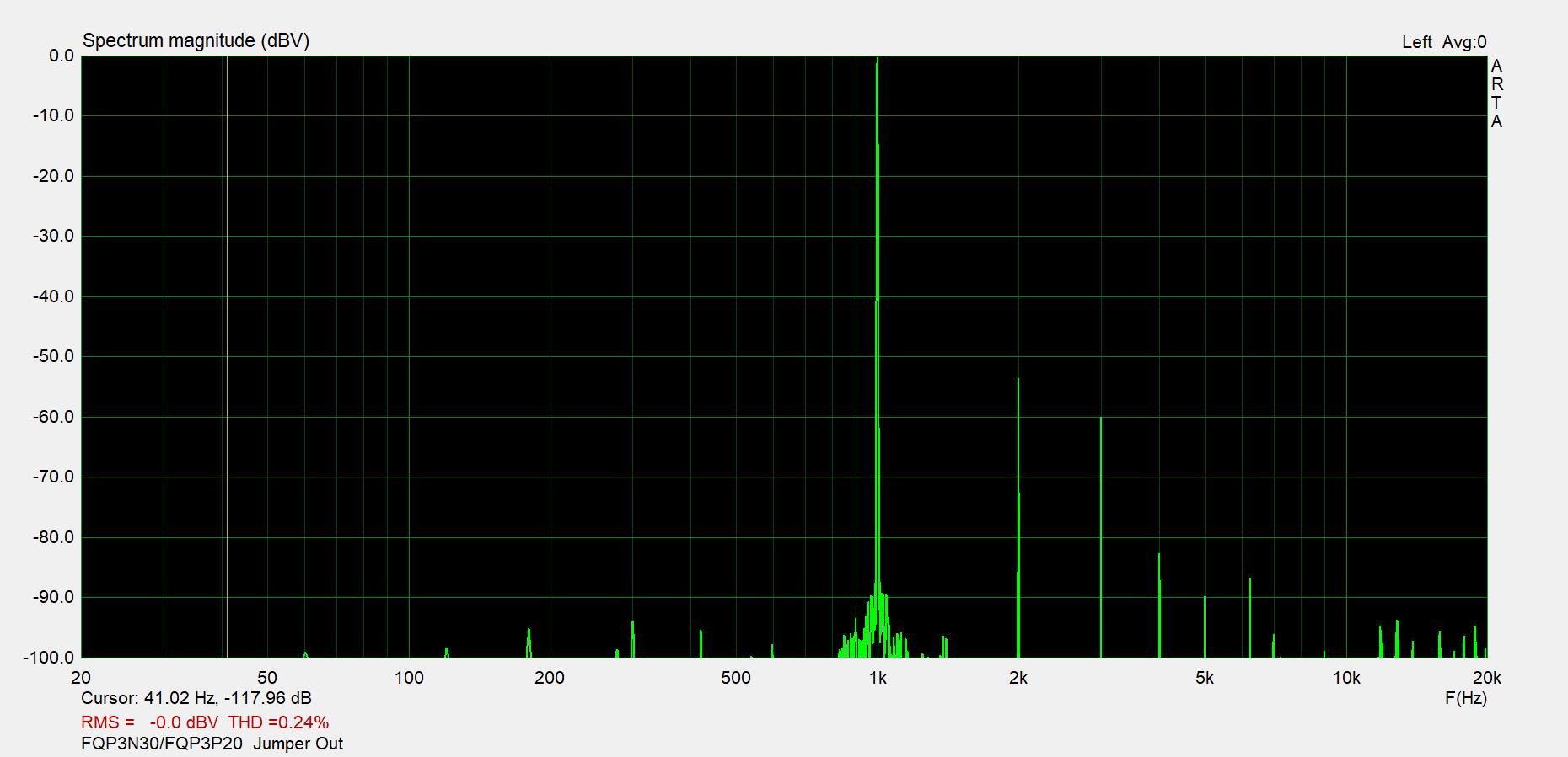

Just for kicks I put some FQP3P20/FQP2N30 in an ACA Mini. It biases up just fine, but the pots are set closer to the end of their travel (almost fully clockwise). I have not listened yet. I have a second ACA Mini with the Harris 520/9520 to compare. Should be interesting.
Here's what 1 watt output looks like on the spectrum analyzer:
