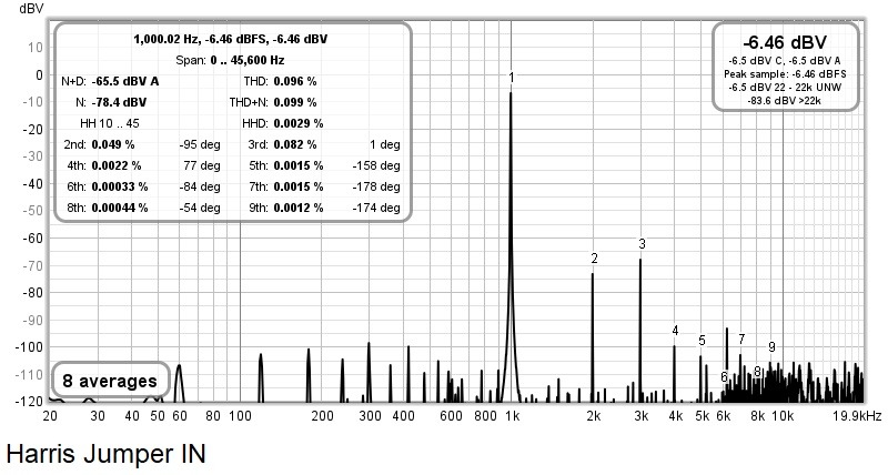

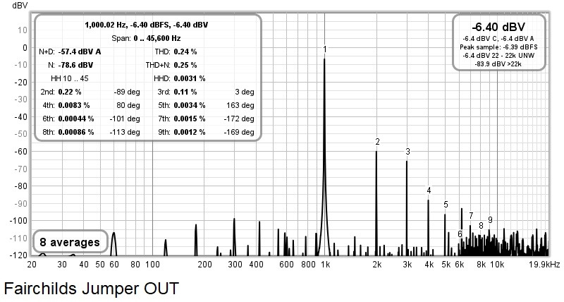

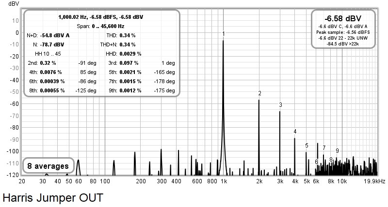

I'm trying the REW software for the first time. It's capable of giving information on the phase of the harmonic distortion

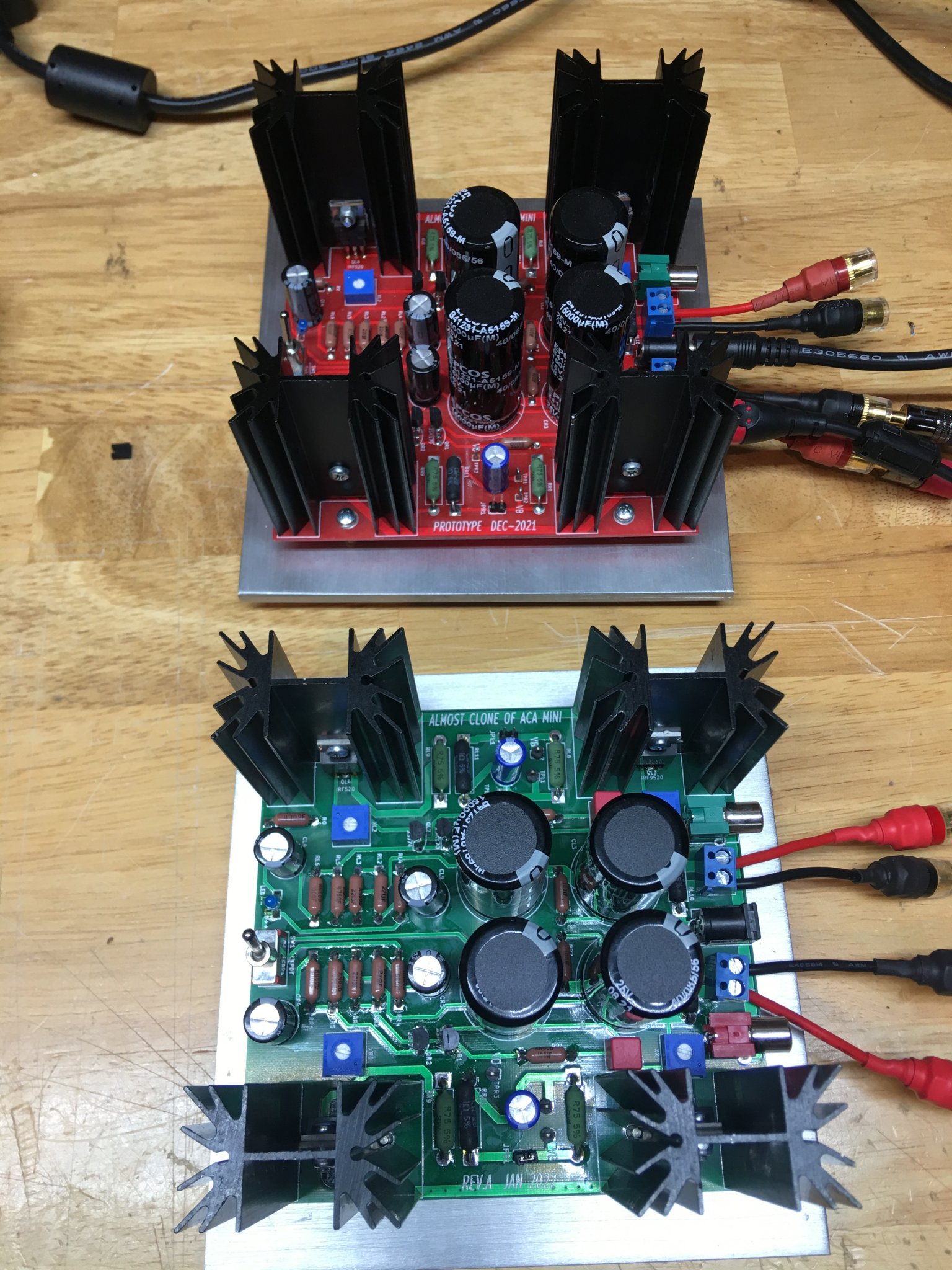

Kevin - what else can you say about the the FQP sound? I plan to to build one with some FQP’s I matched up earlier this year for Aleph Classic group buy and my Juma F5 mini build, and I want it get my head in the game. What I think I learned this evening…
I did the chassis swap and added the filter. PSU voltage dropped a touch as expected. I needed a rebias. either this amp opens up with the rebias or after some time coming up to temp. My first chassis was a bench build, cook, bias, simmer, adjust, etc. Then I put it on real speakers and never turned it off. So it sat at temp and simply sang beautifully.
Did you keep your Harris and Fairchild or Onsemi both hot and just move RCA and speaker cables hin and forth?

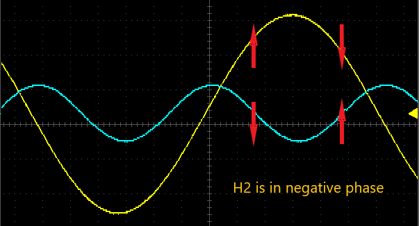

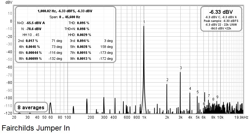

I'm trying the REW software for the first time. It's capable of giving information on the phase of the harmonic distortion.
There is one important fact to consider, regarding REW phase information. For our purpose, it's wrong by 180°.
Different logic is used for the notation of relative phase and negative phase is marked as starting 90° before phase of the reference signal and -90° is starting after reference signal.
So, REW measuring -90° H2 phase is not a negative H2, but positive H2. We want situation where REW displays 90° H2 phase.
Hopefully, this picture helps:

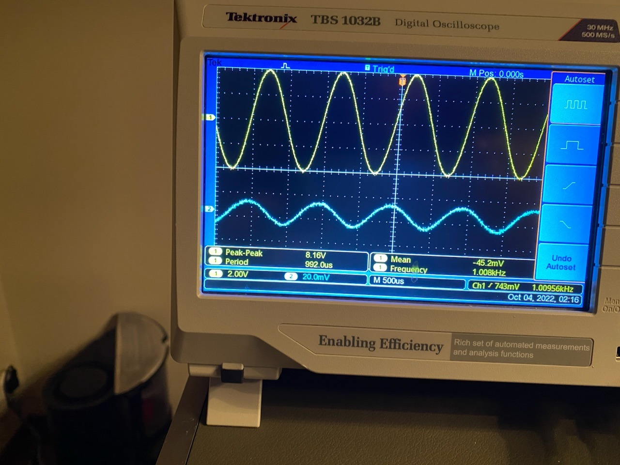

A little bit of time lag on the residual, forgot to compensate before taking the pic. This is the residual of my F2J, in this case inverted pos phase meaning neg is shown here.
So, the "Prototype" amp with the Harris outputs sounds more like candy apple. The "REV A " amp with the Fairchilds sounds more like sour apple. 🤣
Give me a minute for a more serious answer. I'm going to do some listening tonight and I'll keep in mind that I'm doing a review. I just hate trying to put what I'm hearing into words...but I'll give it a go.

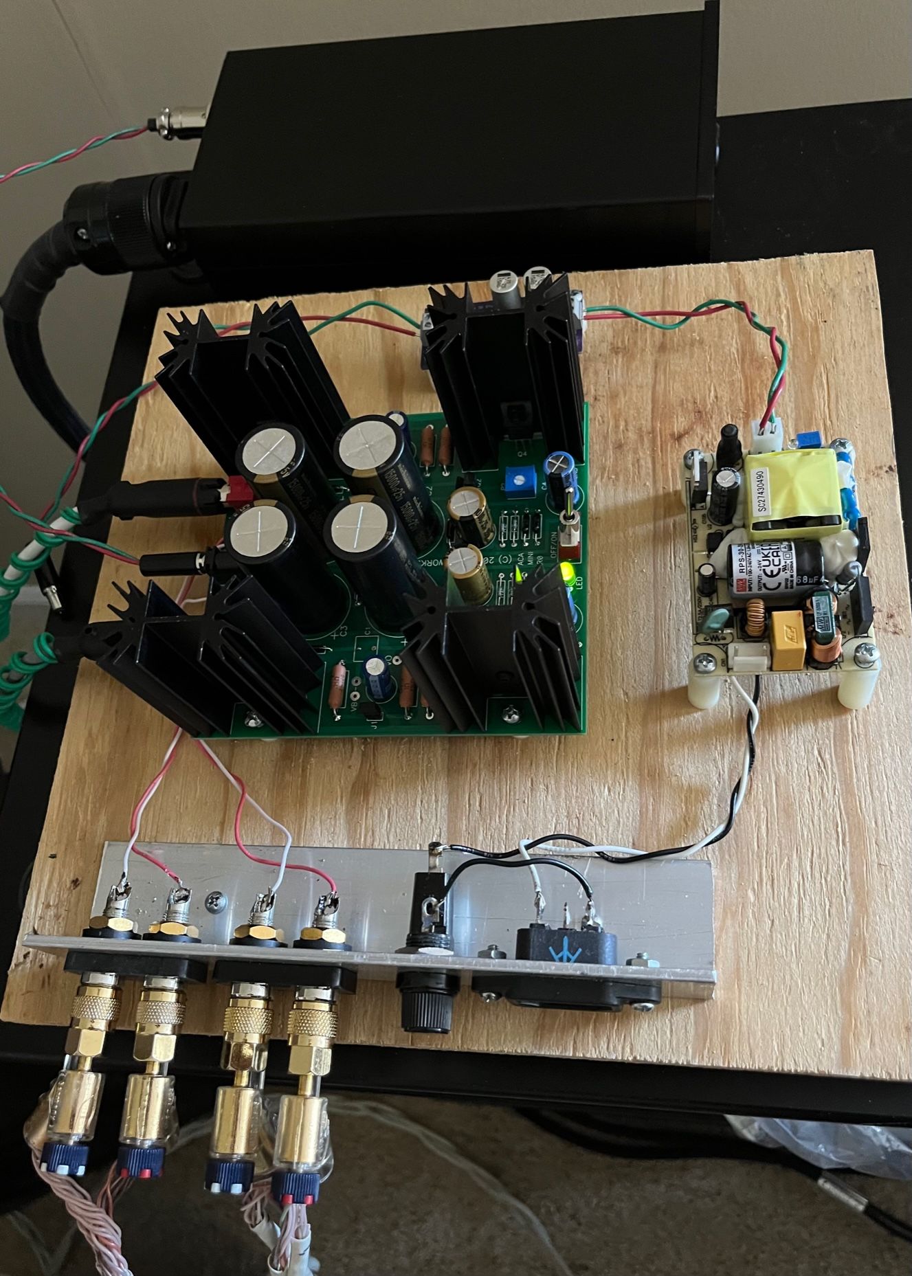

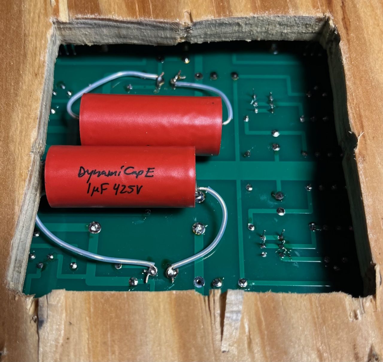

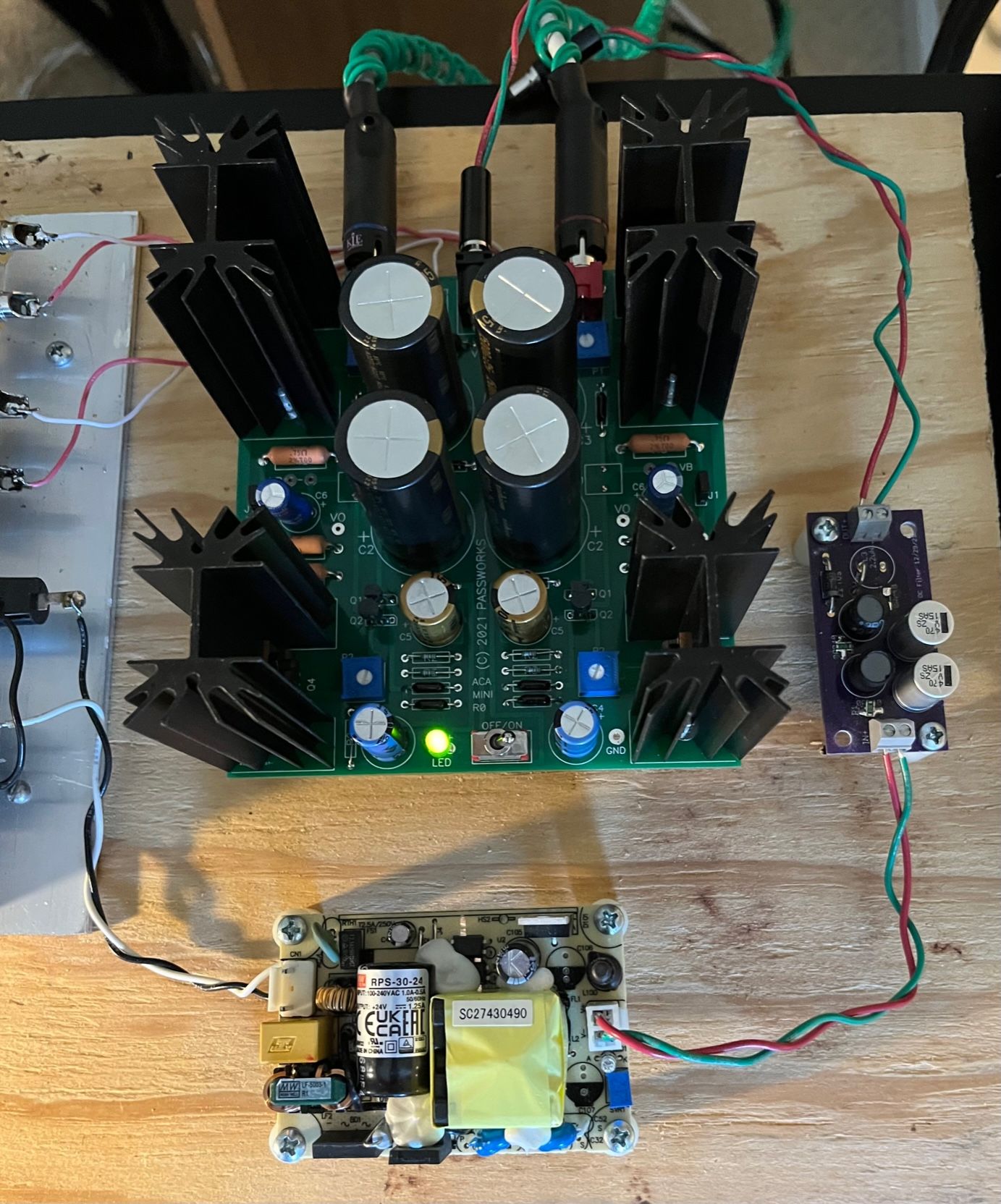

I bought the ACA Mini Essentials kit and parts from Mouser at least as good as the BOM. IMO the components that needed upgrading the most are the input coupling caps, C1, so 1uf Dynamicaps were used from my used parts stash. These were soldered on the bottom of the PCB for obvious reasons. An open chassis Mean Well 30VA medical grade switching PS (Mouser 709-RPS30-24 $16.65) plus a PO89ZB SMPS filter were used to start with.
Sounded pleasing right away! Running the amp 24/7 until 300 hours of break-in time. Today is day 5 - musical detail highly resolved now, better than the Schiit Aegir I sold! Deep base as long as I keep the volume moderate. Using a Chinese 30VA linear supply now. I won’t know if this is an improvement until I switch back to the Mean Well.
