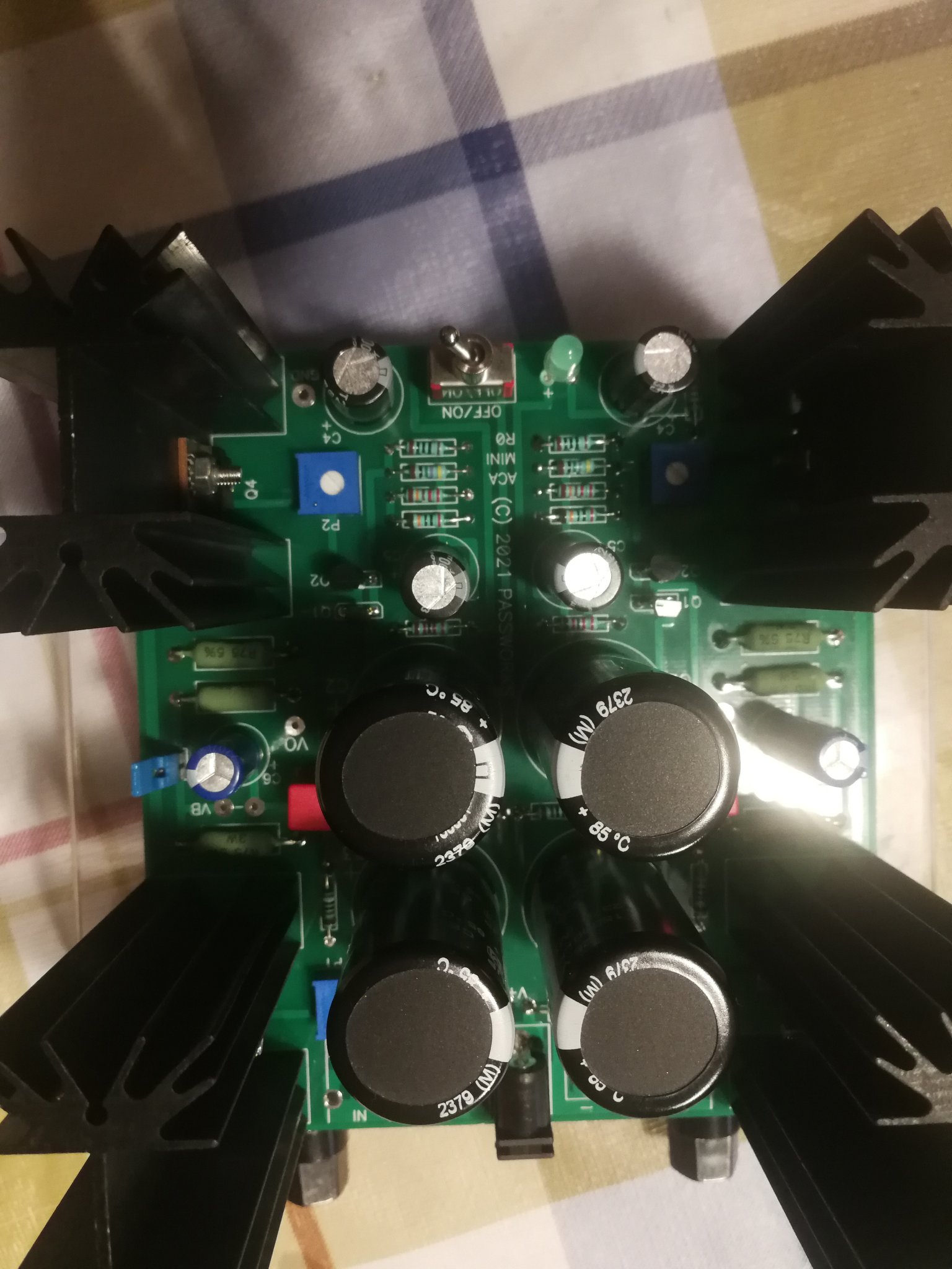

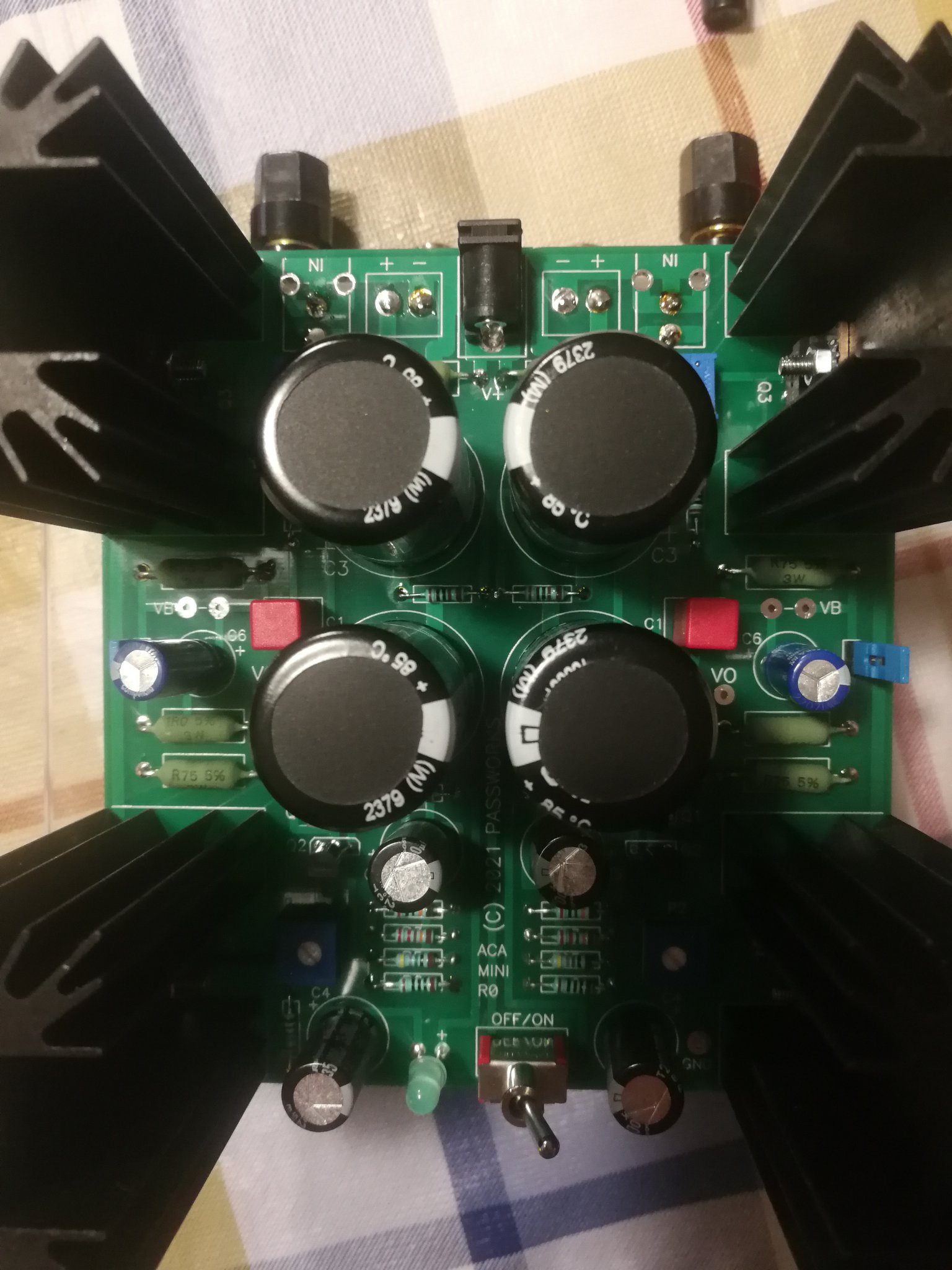

Hi there, I just tested the amplifier and it is a lot of distortion. Could be my mistake or the difference in the JFET? I received the K370 instead of the k170

practically, these two are same part, 370 just having lesser max dissipation
pics

It plays at a normal volume? But is distorted?Hi there, I just tested the amplifier and it is a lot of distortion. Could be my mistake or the difference in the JFET? I received the K370 instead of the k170

May be looks like in the pictures but it is not.@bojo75

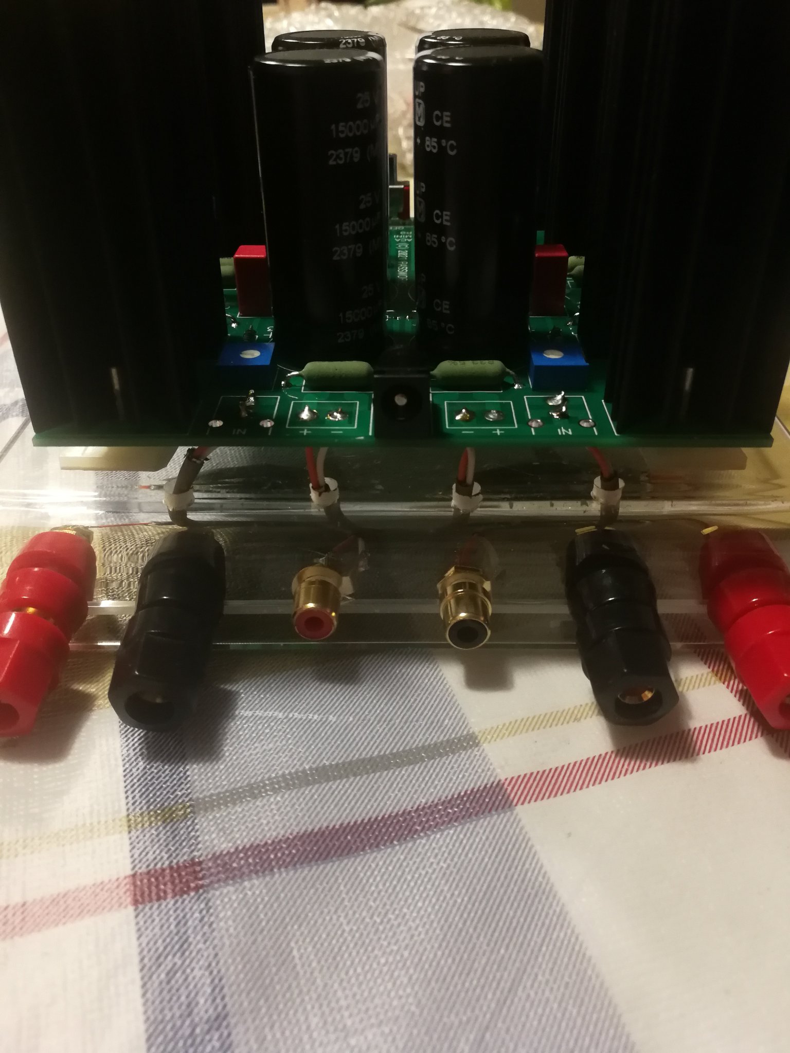

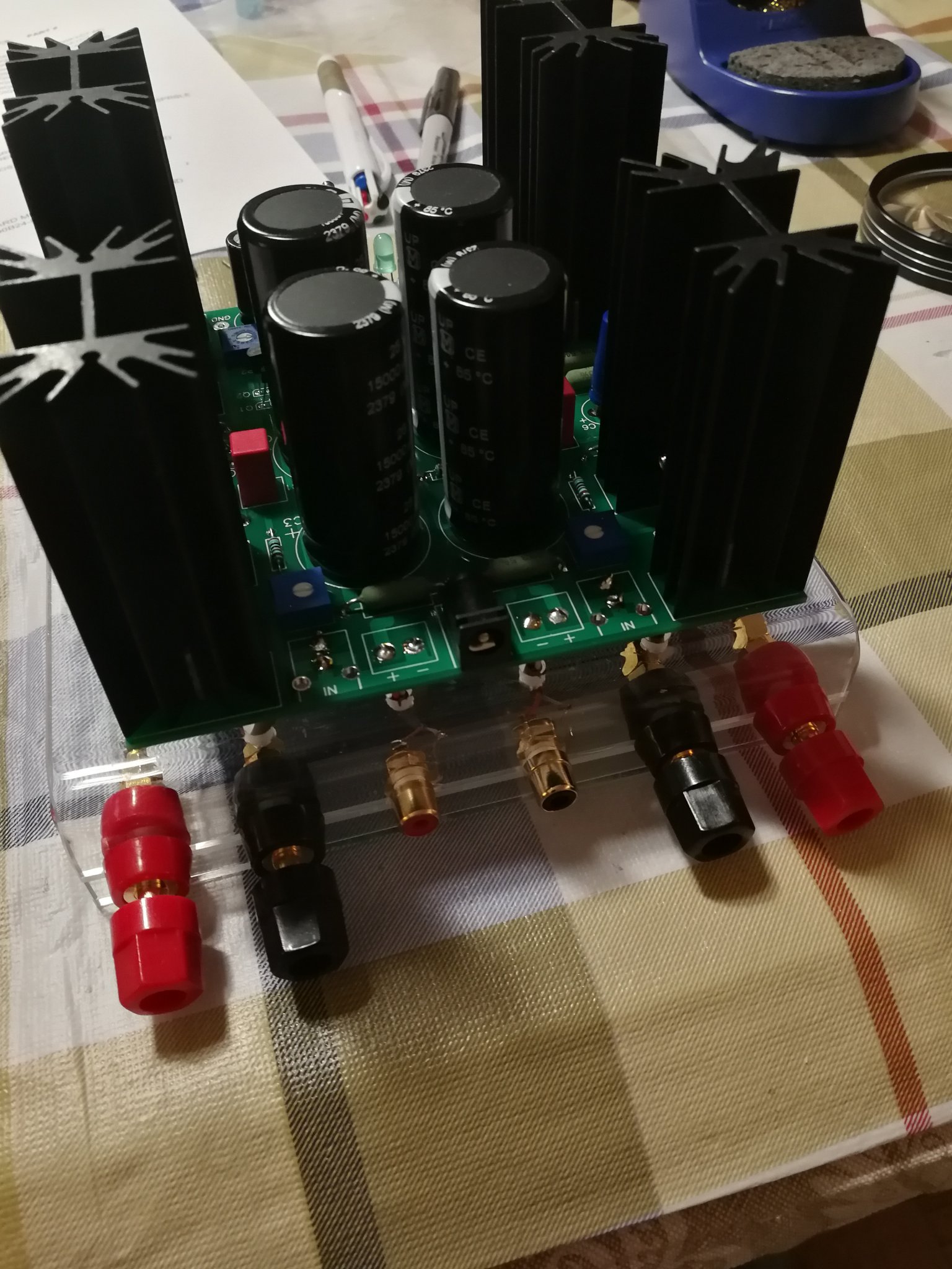

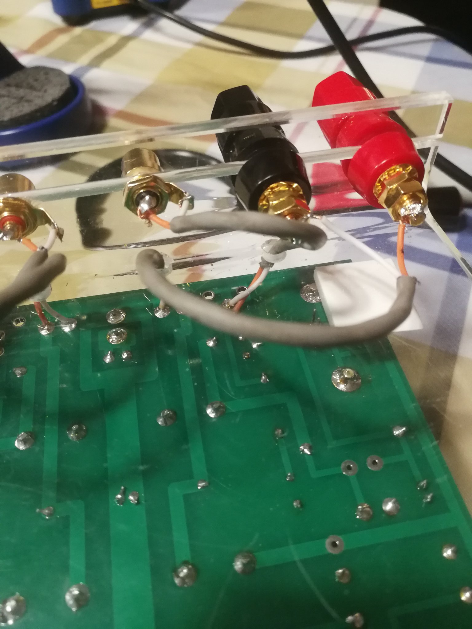

I'm surprised you hear anything...you have your inputs and outputs swapped.

https://www.diyaudio.com/community/attachments/1668337451567-png.1109092/Yes, sounds but not music 🤔
Kevin's questions is very important.@bojo75

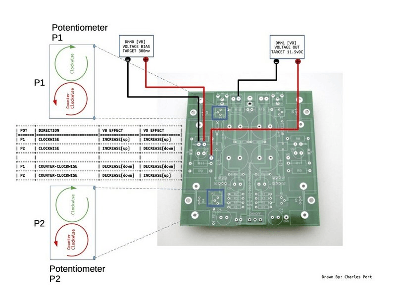

You were able to bias it correctly? What are your readings at VO to ground and VB test point point 1 and 2
'Sounds' but no music is exactly what the amp will sound like when music is being played (loudly) but the bias supply is OFF. Double check your bias and offset voltages and that you have close to 12V DC at the gates of Q1/Q2.
