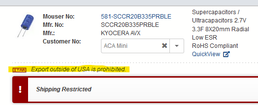

ACA Mini building outside the US just got a bit more complicated - picture from my Mouser cart:
- apparently supercapacitors are on the ITAR munitions list!

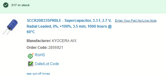

Seems like I can still order them from Farnell though:
Strange. I bought mine from Mouser ( I'm UK). . I think you can come down in value and still have a very low cut off Freq.

Same here in France, says this supercap can't be exported outside of the US.
I like to order from Mouser, so that's aprob indeed, although I didn't even got started 🙂
Any hint of what to use instead from Mouser EU would be appreciated
Answering my own question, or sort of LOL...
Note in the same series the 1F supercap is available at Mouser's and not restricted, perhaps a solution?
It is with 1F way higher than needed for the cut off frequency, and same sizes apart from non relevant height, and has even a lower ESR (not that it should really matter here given the figures but well...)
