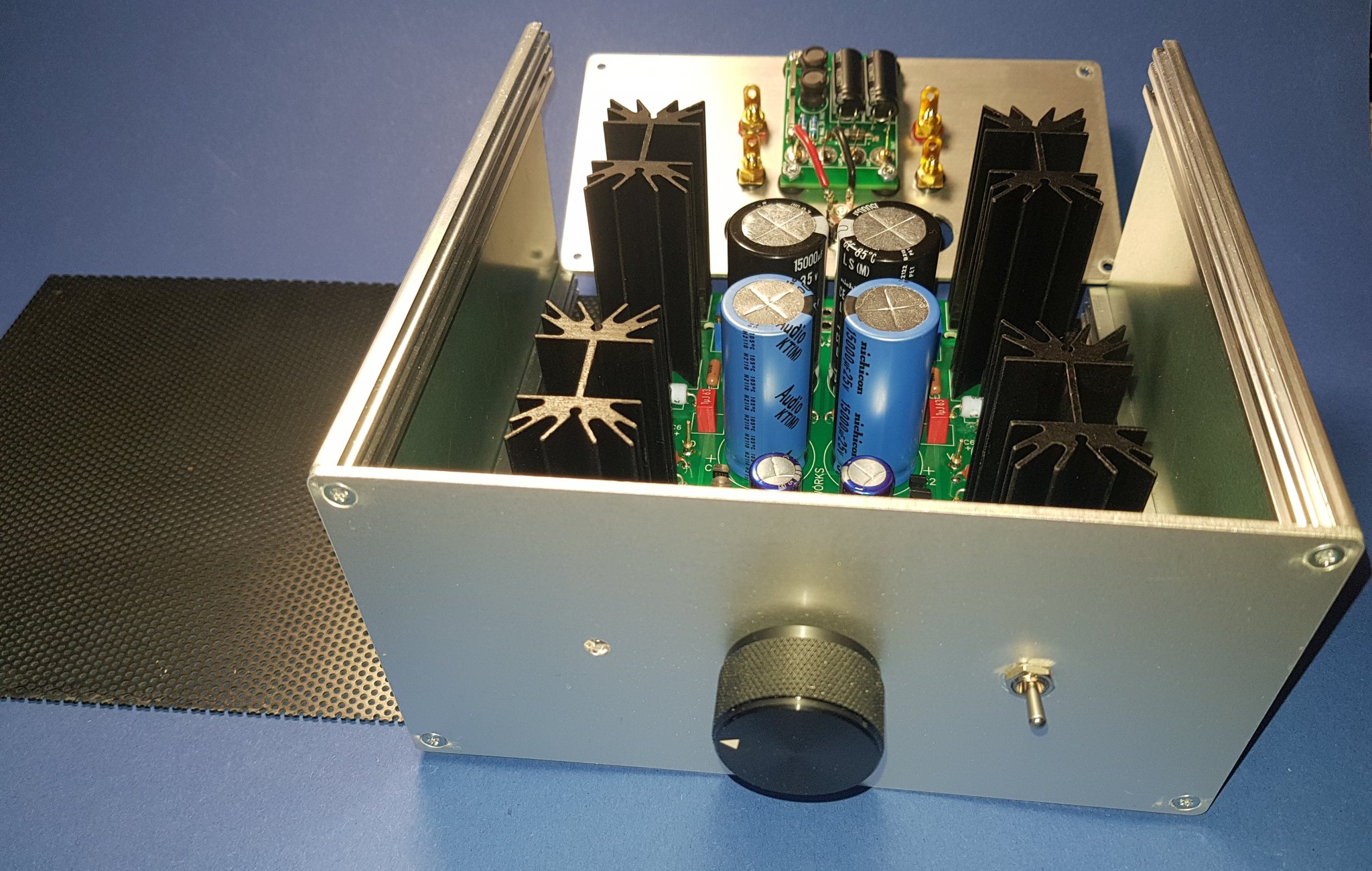

Why not? This is my next build, waiting for the FQP transistors. Bottom and Topplate perforated to enable air circulation. Compared to my first builts just 1/2 high unitWhat about just building it as designed? It was never really meant to go in an enclosure.

Because there’s a difference between building an enclosure around the amp and trying to force the amp into an existing enclosure.Why not? This is my next build, waiting for the FQP transistors. Bottom and Topplate perforated to enable air circulation. Compared to my first builts just 1/2 high unit
.....which is why I laid out new boards to work properly with a little conventional chassis. It was the pricier way to go and kinda defeats the whole Mini zeitgeist ... but I really like it. It fits most rooms better than a bare board. The next build will use an ACA chassis! The blank chassis was just 20% off for Black Friday at Modushop. I've got improved boards now, too and... some Fairchilds from @KevinHeem to pop in to the next build.Because there’s a difference between building an enclosure around the amp and trying to force the amp into an existing enclosure.

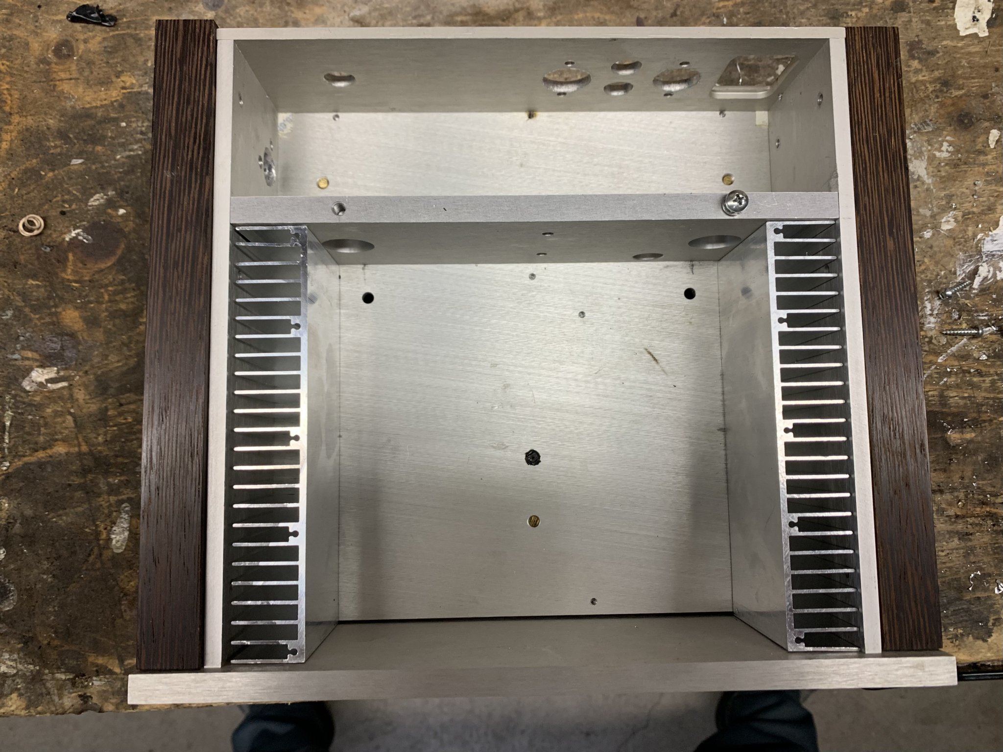

I have a question regarding possible substitutes for the TO-220 heatsinks. My enclosure is not tall enough to fit the board mounted 2.5" heatsinks.
Could the 4 pc Mosfets Q3,Q4 be bolted on my aluminium enclosure frame to maintain 20W dissipation specification @60 deg. C ? If so, what would be the total area required per Mosfet for proper heat dissipation? Each of my panel are 8" X 2.5" X 3/8"

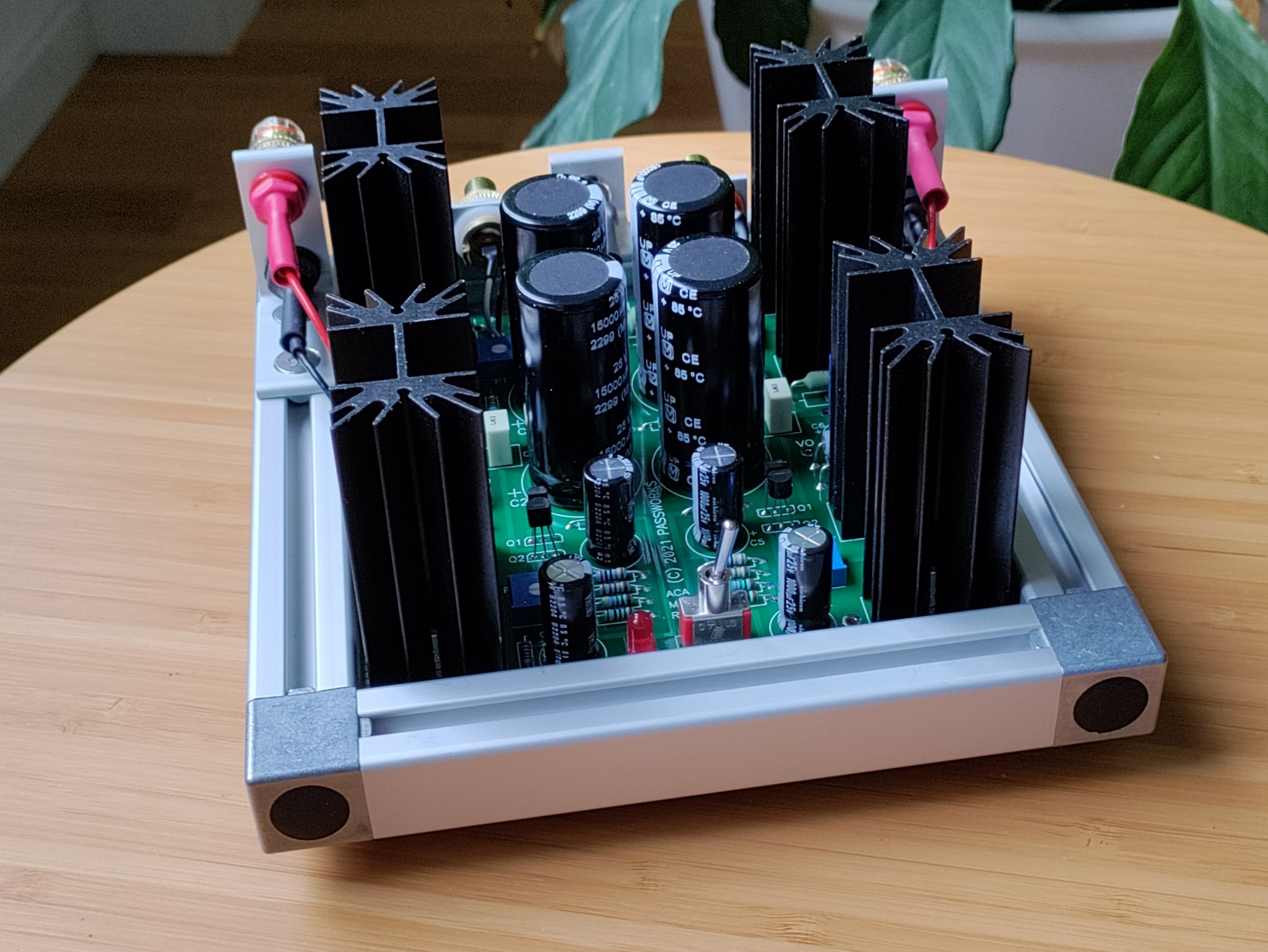

Getting there. Mounting heatsinks to the inside with thermal paste, still have to figure out the top plate design. Compact chassis, hardest and most expensive part now figured out!
Drill holes under and above the heatsinks for airflow. They are useless without airflow.

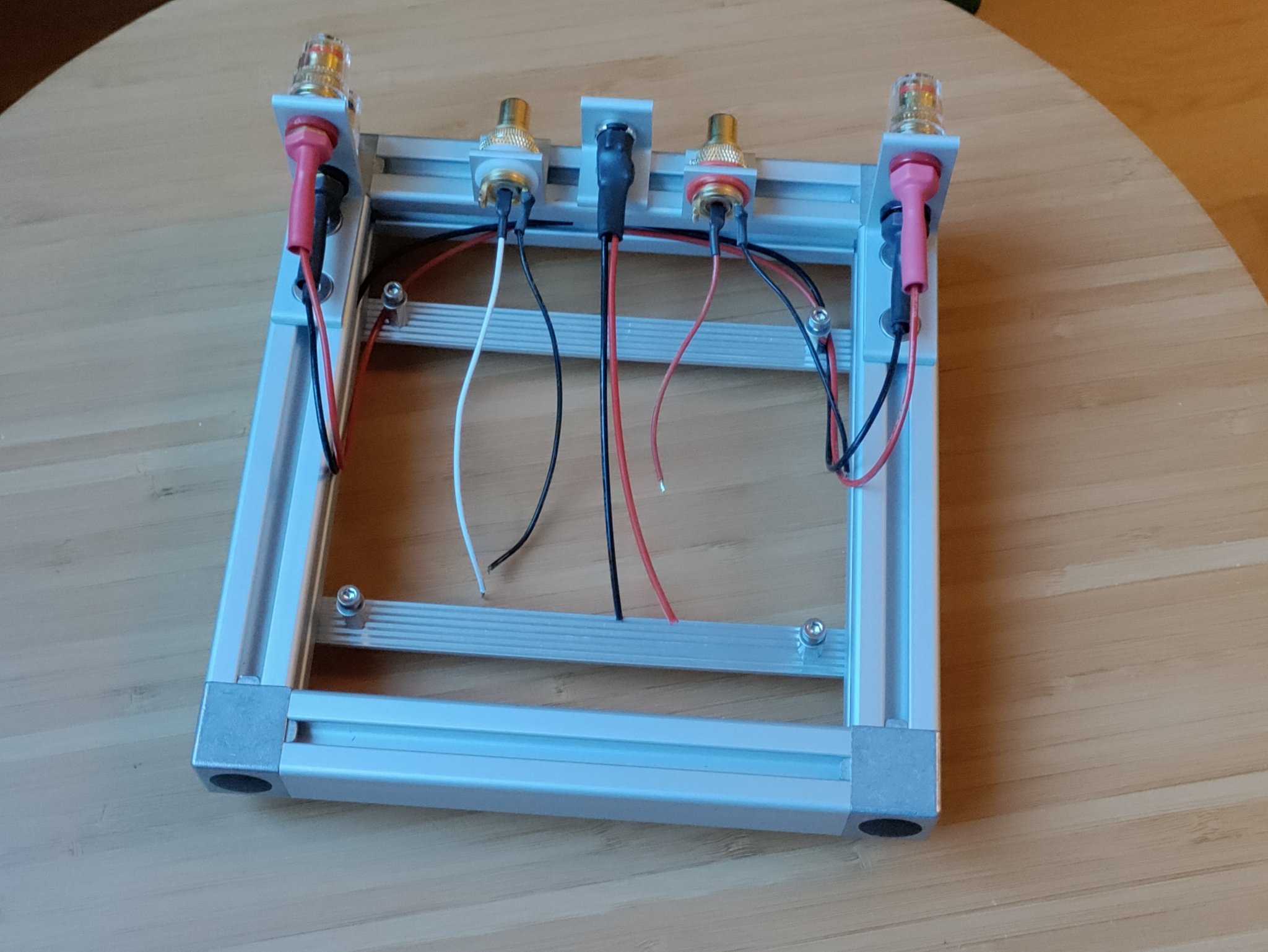

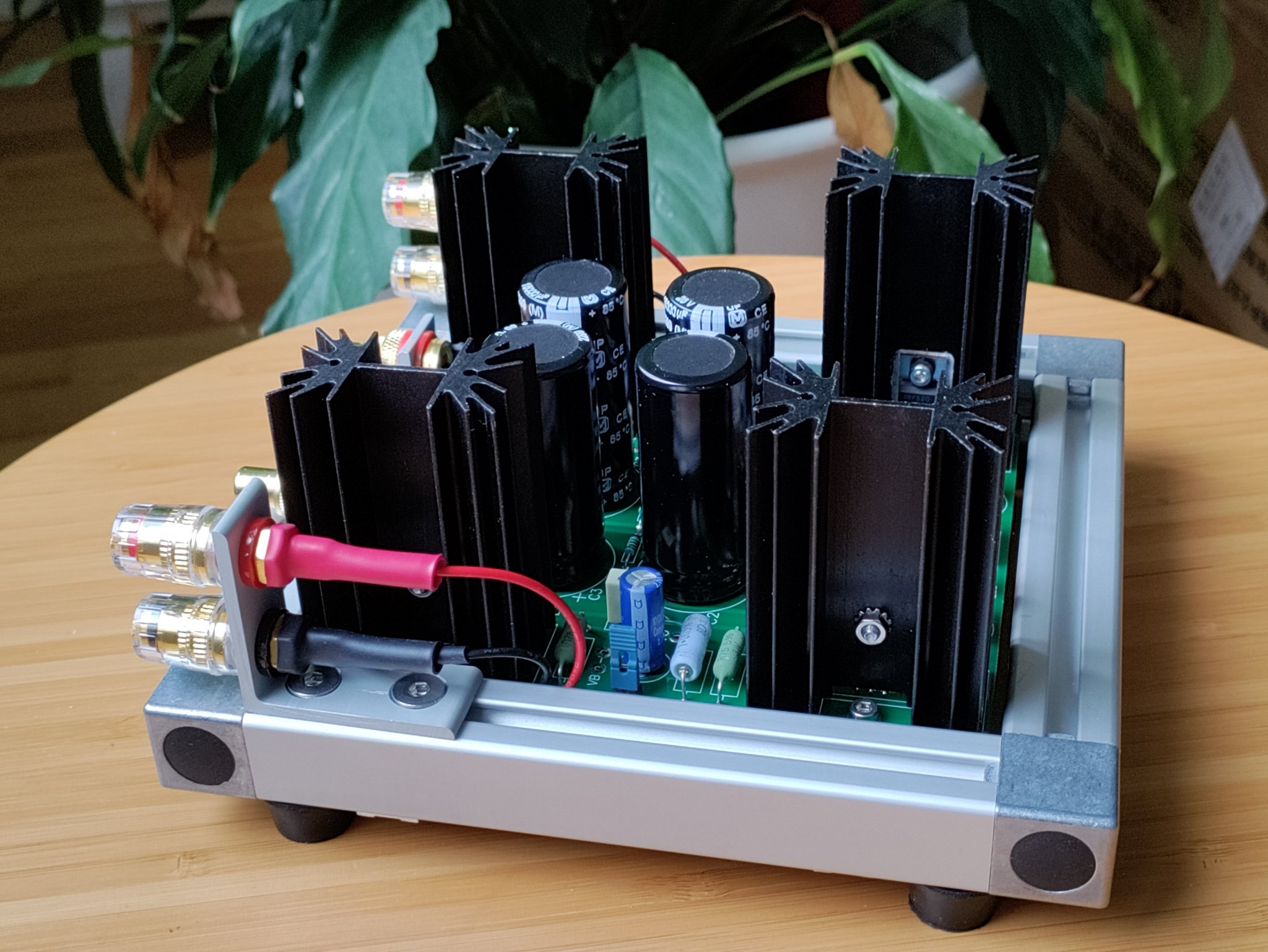

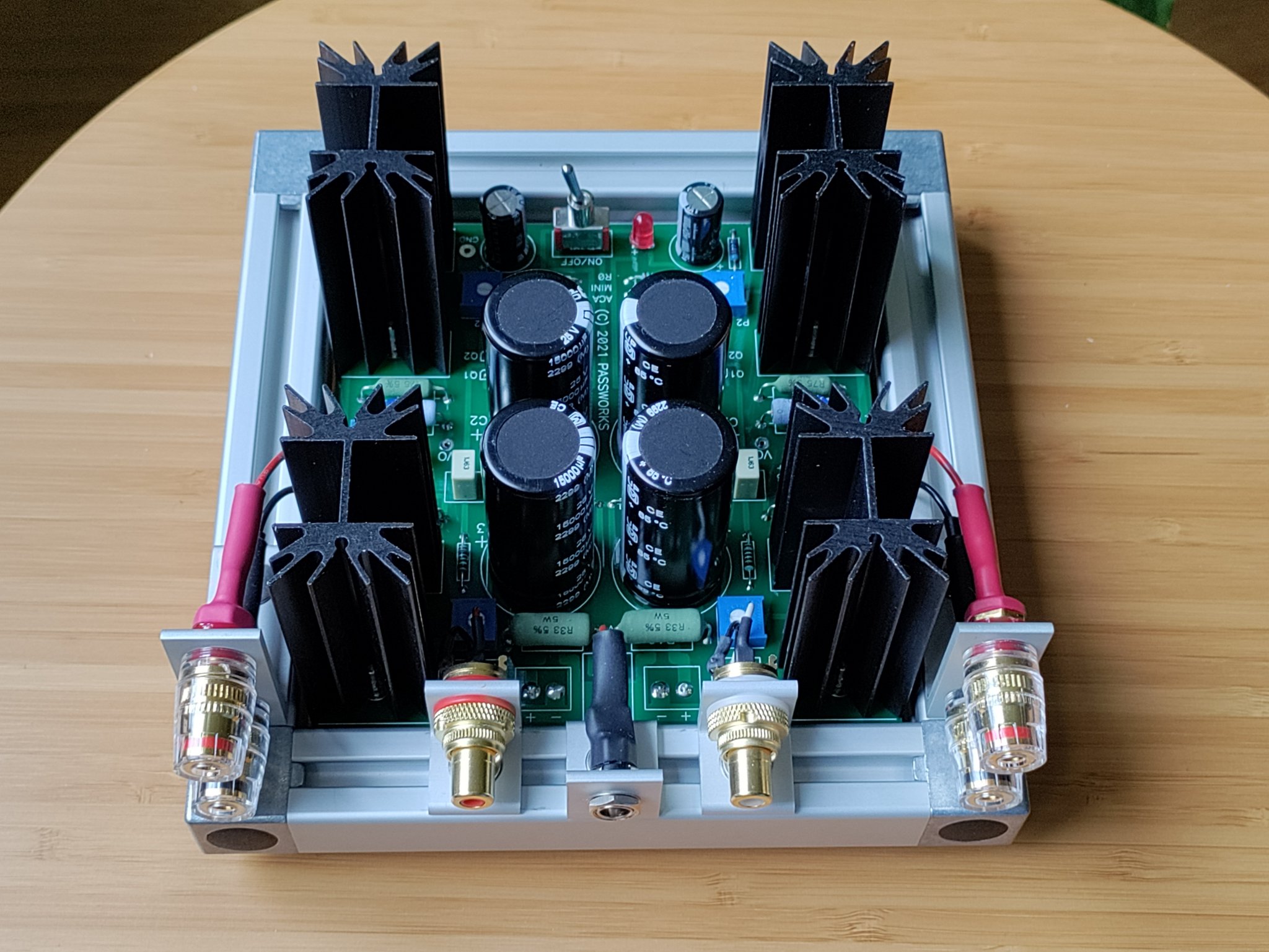

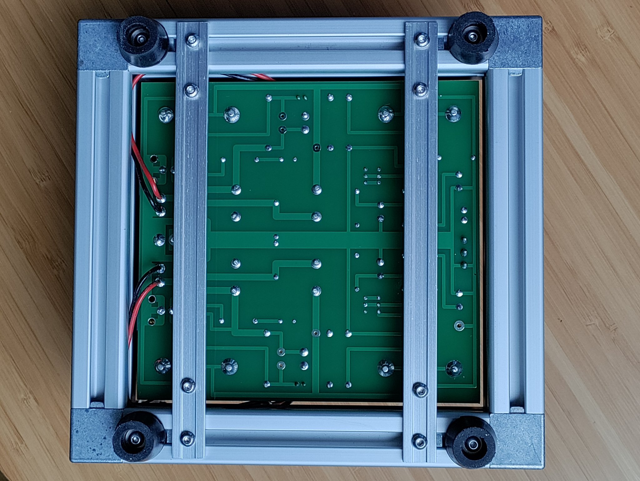

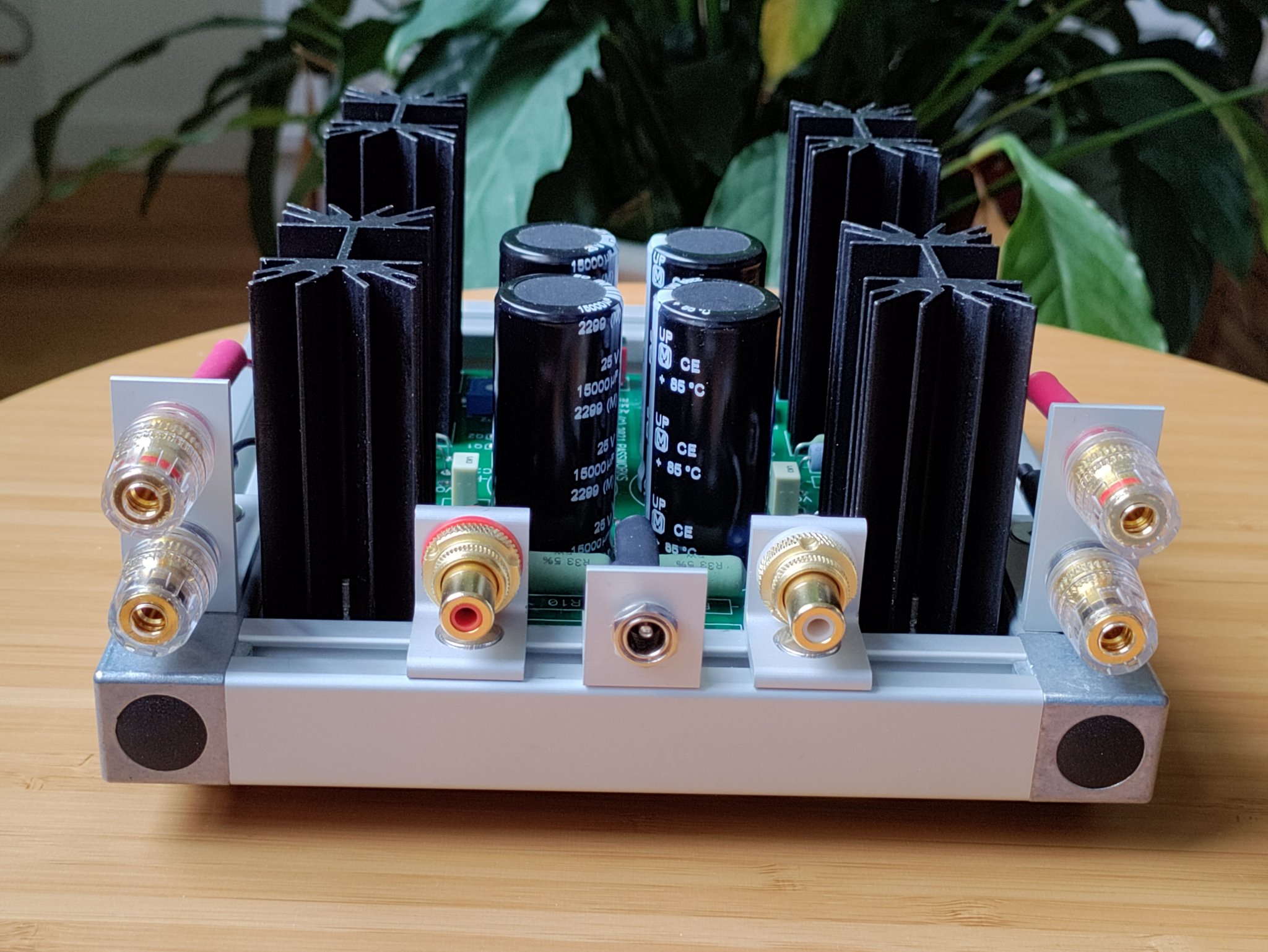

And open frame it is!

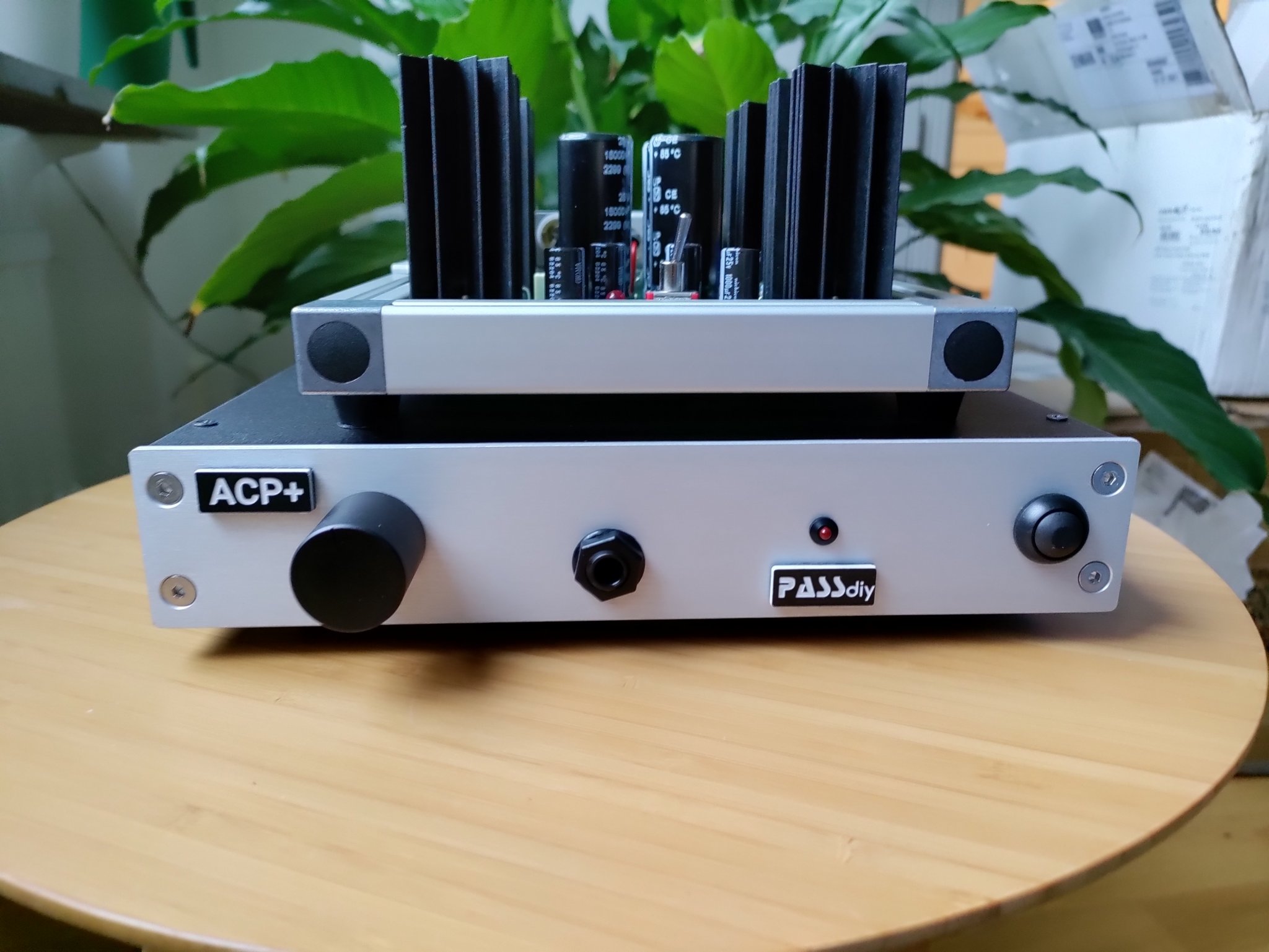

This is my first PPP (Papa's Push-Pull) and it really punches above its weight. 🥊

Fuuuugly!!And open frame it is!
Looks cool but dust collector. Not for kids or pets aroundAnd open frame it is!
😀Fuuuugly!!
Thanks! And I should say that thanks to the frame weight there is no risk that it is pulled away by large cables. Better than I hoped.
That’s what I was thinking..or have a cut-out on the cover top plate above each heatsinks.Drill holes under and above the heatsinks for airflow. They are useless without airflow.
My Aleph J gets warm with huge heatsinks. Difference with this one the entire frame is thick aluminum so hoping will dissipate heat. Key is airflow I agree
