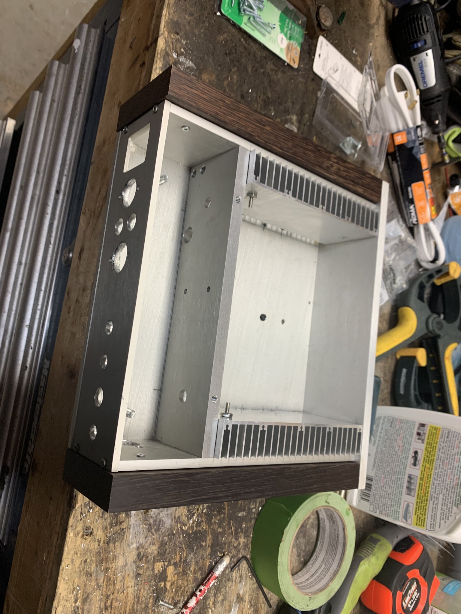

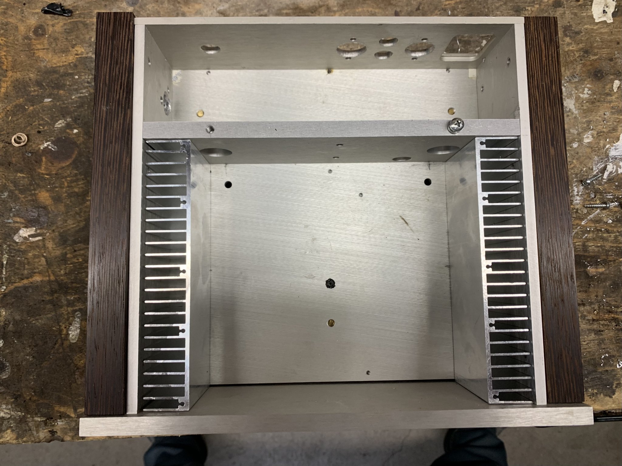

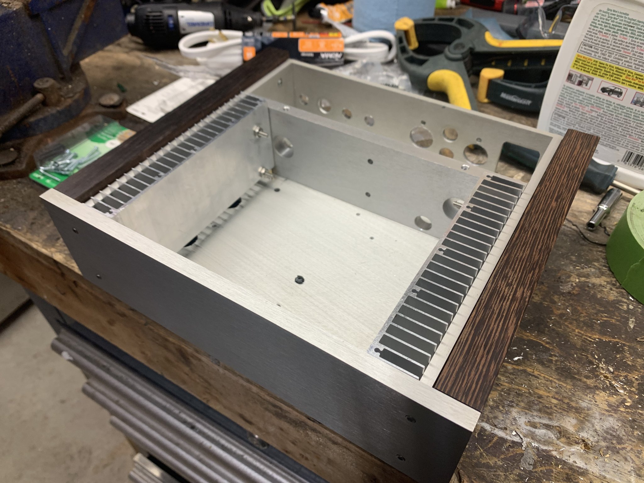

That’s what I was thinking..or have a cut-out on the cover top plate above each heatsinks.
My Aleph J gets warm with huge heatsinks. Difference with this one the entire frame is thick aluminum so hoping will dissipate heat. Key is airflow I agree
I think it looks great. I would think sinks of that size would take care the dissiption no matter what, since this is the mini. But drilling holes will of course ensure circulation and keep things cooler. Great work on the chassis!! Perforated top plate is a good idea. A few holes under too, and you’ve got circulation.

put the heatsink in place of the wood.....
Is that really nescessary? A bunch of mid to high biased A/B designs put the sinks inside, and this is the mini…
But maybe those A/B’s are notoriously unreliable. I know my KAV300iL was, but that was rated 200 watts into 8 ohms, almost with no sinks at all. So things got pretty hot, and proportionally distorted, to say the least. But still, aren’t his sinks OK for the mini with a perforated top and a drilled bottom plate?

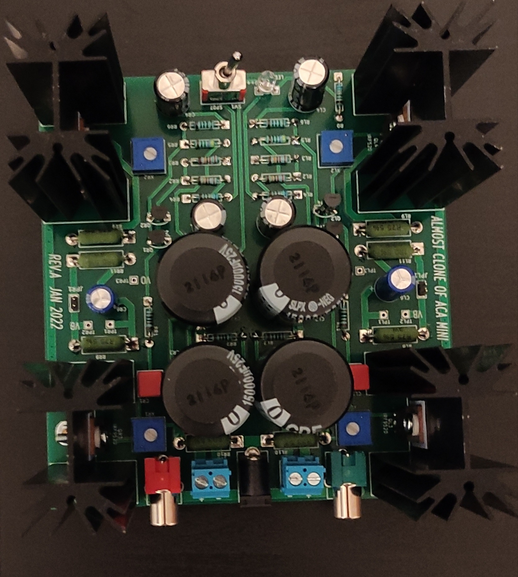

Finally mine is running! I had an issue with a faulty harris irf9520 but now is running! Thank you all for support and for this project!

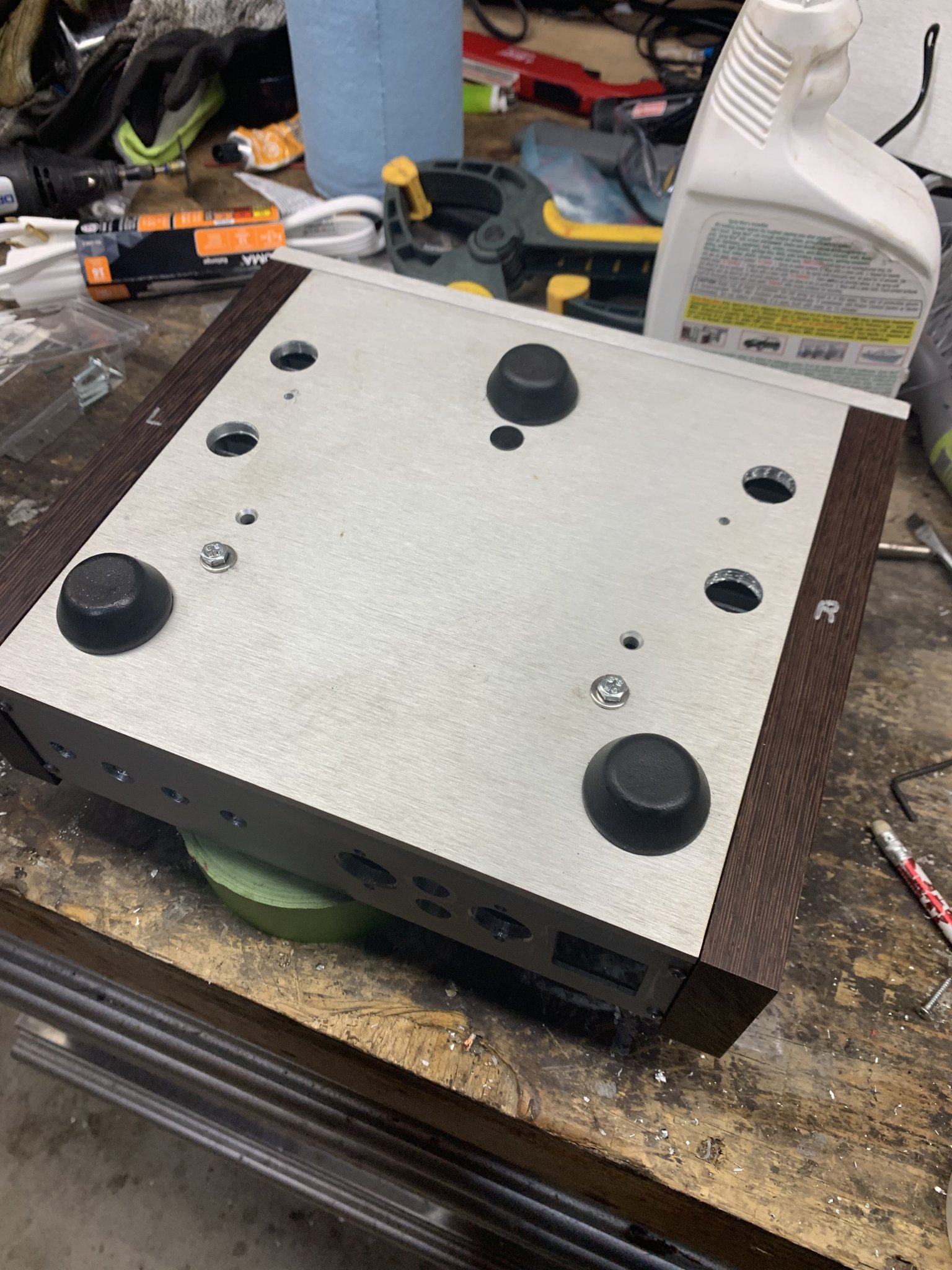

And in the plate below or it won’t work.
These heatsinks work by convection, the air next to them is heated, it rises, and then replaced by cooler air coming in from the bottom.
Drilled ventilation holes under the sinks, ready to assemble. The top cover plate will be cut around the heatsinks. Quite happy how it turned out given the fact it’s an old project chassis colllecting dust that was re-purposed for the ACA mini. Saved a few bucks!
