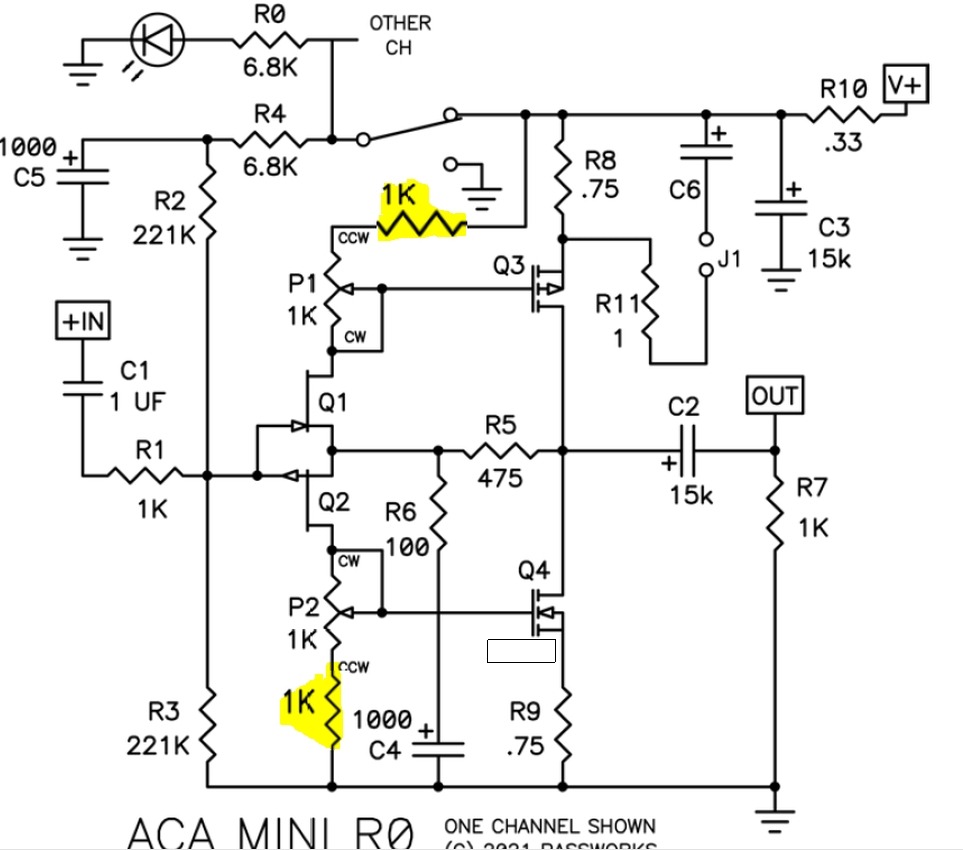

My actual build with FQP MOSFETs also reach only half bias. As I dont have 2k trim potis on my stock, can I add 1k resistors in series with the pots as shown here?
That looks like the fix, just remember to set the pots back to zero. You could probably use <500R values. Use what you have in your parts stash.

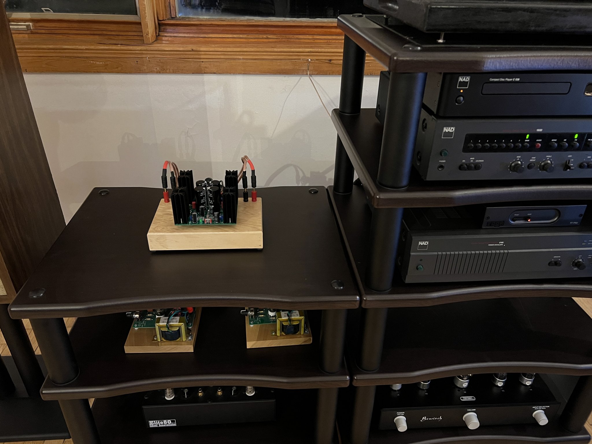

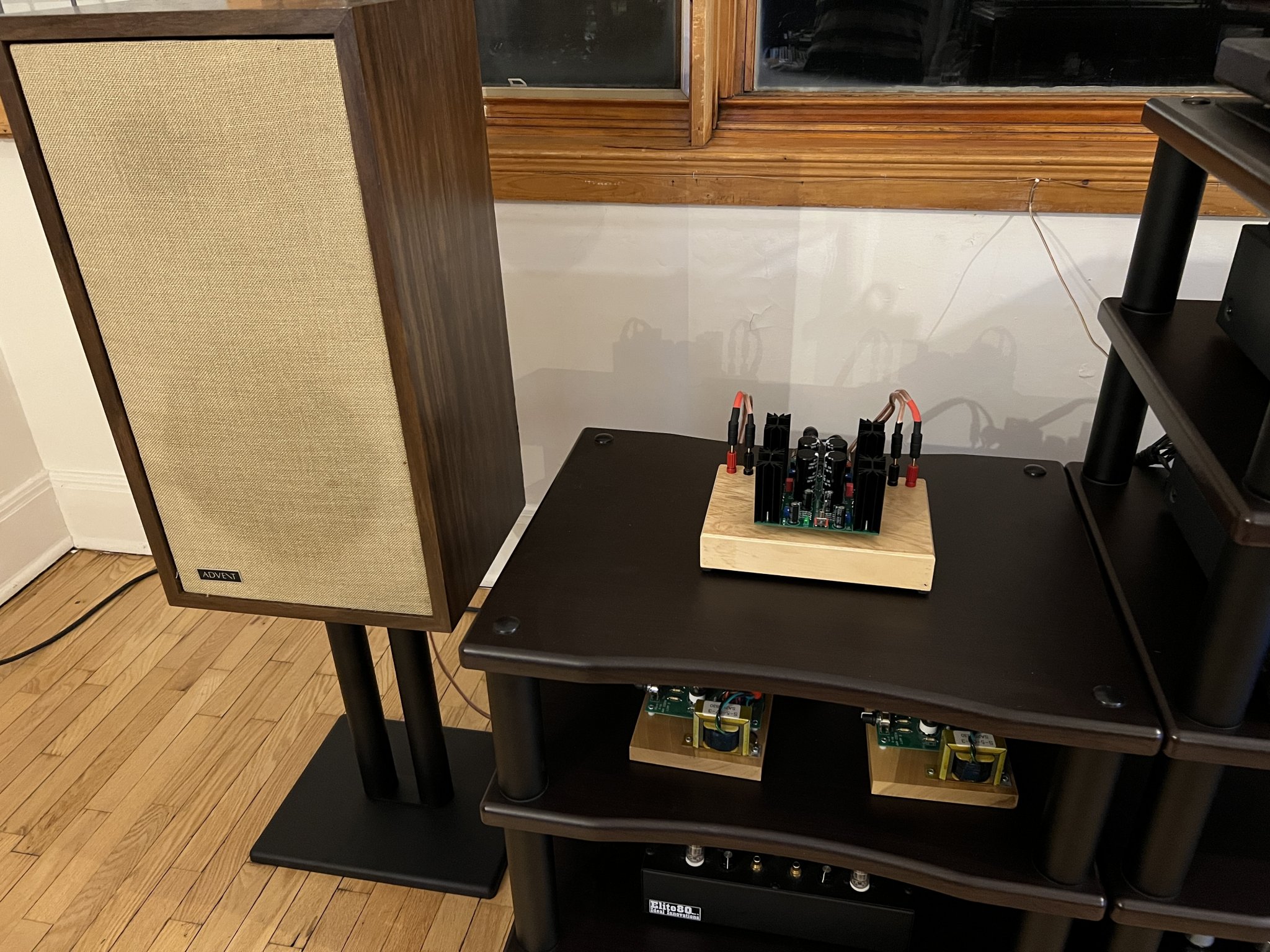

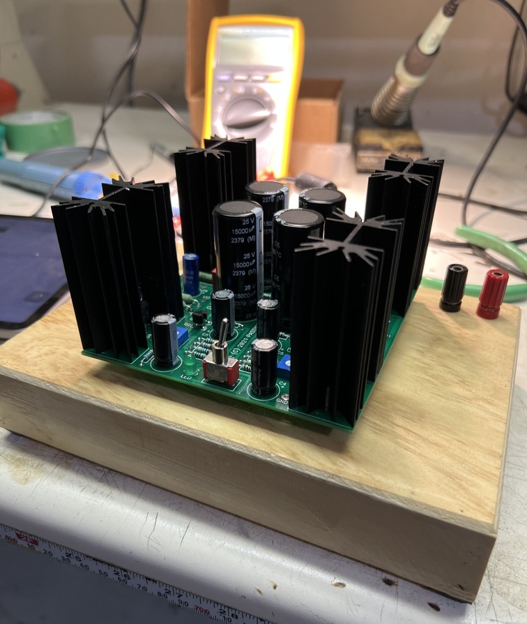

Hey all!
My little ACA mini is rather impressive! Bias has been stable for the last 18 hrs (297 mV, 11.45 V left, 299 mV, 11.52 V right), and it is valiantly right now pushing a pair of 1973 Large Advent (with brand new original specs woofers from Simply Speakers). Bass is very good too!
Sorry if this has been discussed before, the search engine is not very good, but I noticed a strange issue:
One MOSFET's heat sink is significantly cooler than the other 3 (which are around 45-50 degrees Celsius)! Left front one (IRF520). Barely above body temperature. And that was after over 18 hrs being ON. I used only a very small amount of white paste from a CPU cooler kit, properly smeared. The MOSFET itself is also not very hot.
Music is fine, at least by ear--both channels appera to be performing similarly. What gives? Cheers!
--Christian

They should feel even, and certainly not be cold. That usually happens when devices not balanced during bias. Did you measure offset?
Thank you guys! After another 12 hrs or so, they are now close to each others in temperature. And yes I had measured all voltages properly ("Bias has been stable for the last 18 hrs (297 mV, 11.45 V left, 299 mV, 11.52 V right)"). I am listening to it right now--wow!
