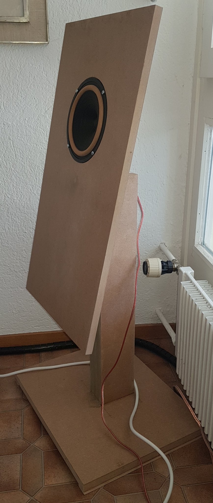

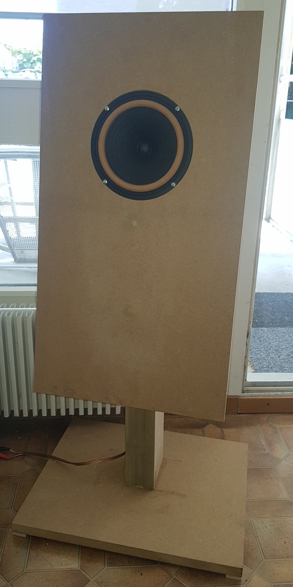

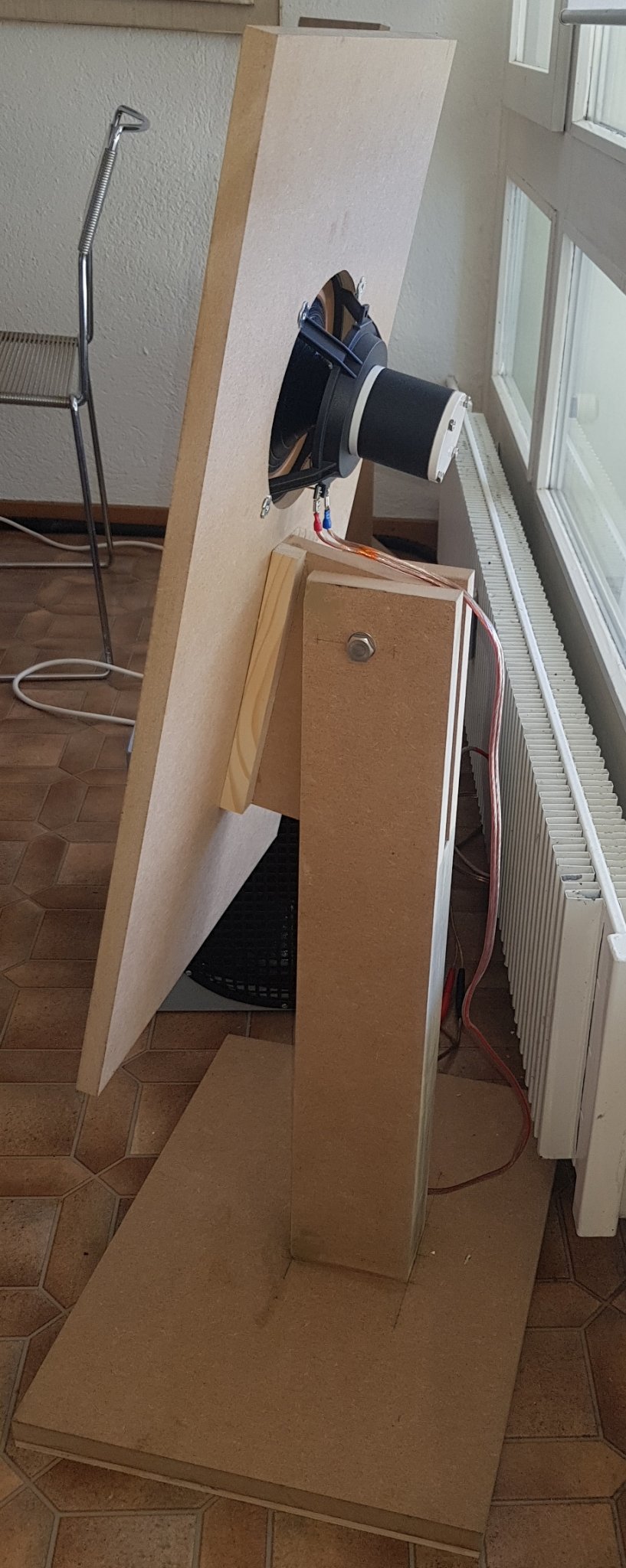

I used a Pass 6X24 crossover and the ACA mini has driven open baffles with chinese Diatone P610 alnico clones, supported by a subwoofer driven by a t-amp.

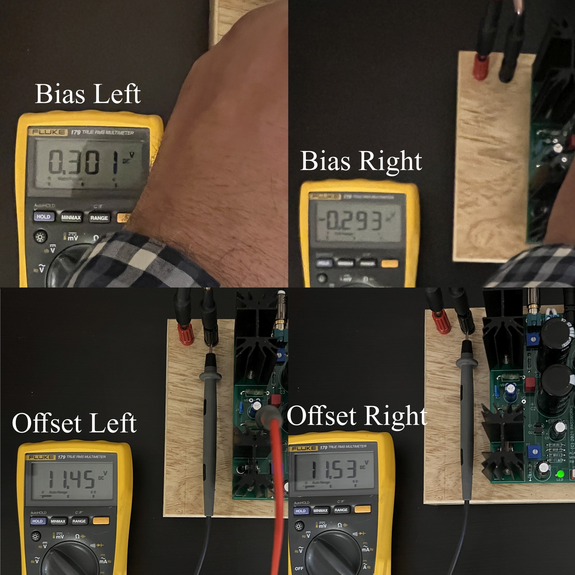

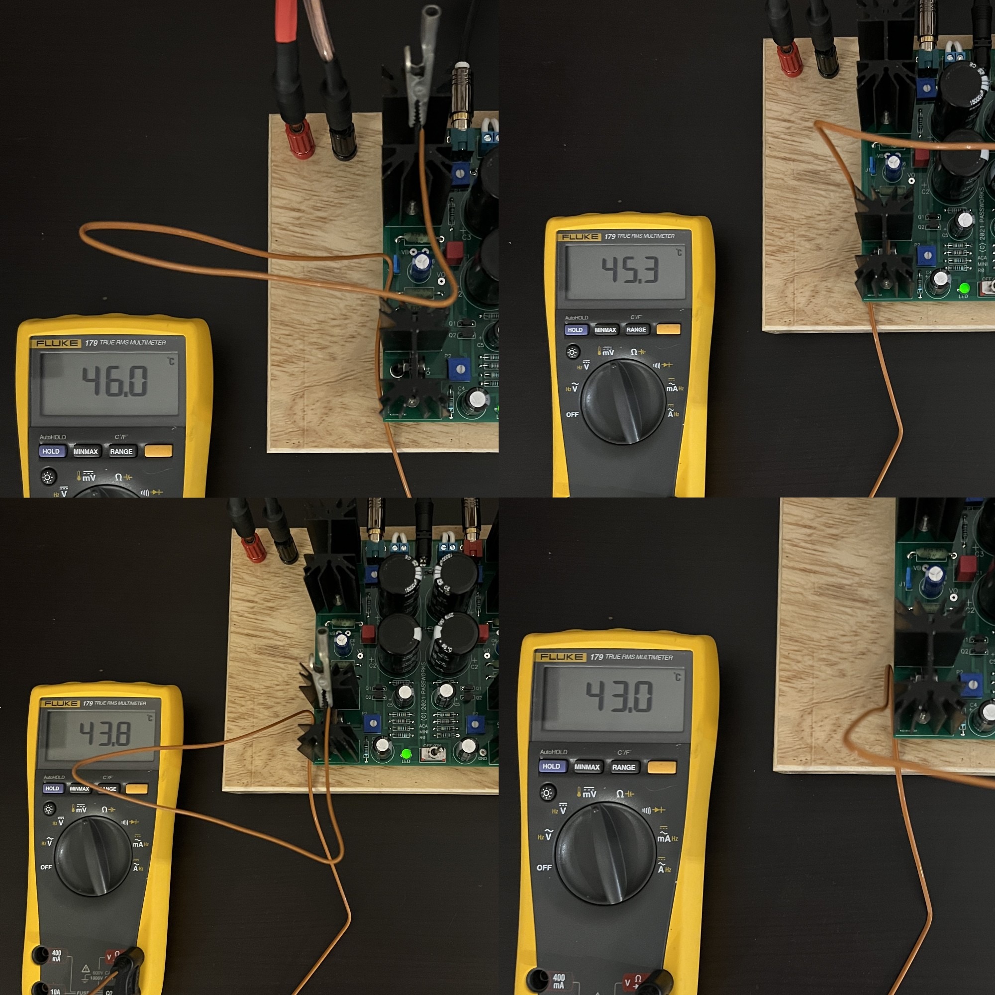

Thank you for the help. For completeness' sake, let me share my experience with this amazing little piece of electronics. This may perhaps be of some help to future builders!
First thing to remember, the transistors are all different! I had made the rookie mistake off switching MOSFETs in the right channel. Good news is the SMPS brick immediately goes into protection mode, and no damage is done.
I had set the biases and offsets on my bench using a single voltmeter (took my time) approximately at first. Then I had my dinner and refined the settings about an hour later. Voltages values had remained quite stable anyway.
Then I brought it upstairs to its workplace. Took a litle while to get everything ready, so the amp had cooled to ambient temperature.
The source (FM radio in MONO mode) was ON before firing up the amplifier. After turning switch ON: music only in right channel at first!
Balance L-R was achieved after about 10 minutes (relief!!!): the left channel took significantly longer than the right channel to come to life at first. Note that the misplaced transistors were in the right channel, so this has nothing to do with it. Also, all four MOSFETs are mounted using about the same VERY small amount of white thermal paste, smeared properly. Bolts were torqued approximately the same (close enough...). For a long time, the left channel IRF520 was noticeably cooler than the other three.
Following the suggestion from KevinHeem, I cycled it off and on a few times since. As far as I can see, that's all that was needed. Now biases and voltages are very stable and sound is of course still amazing. I was able to measure the heatsink temperatures after I located my thermocouple, with no signal--don't want electrons to be diverted to those pesky speaker voice coils! Amp had been on for more than 24 hrs. The temperature values themselves need to be taken with a grain of silicon, but they were all measured the same way. As can be seen in images below, they are close enough to each other now, including the strange lower left one! My living room was about 20 degrees.
So everything is great and thank you again and again for an amazing design, Mr. Pass!!! Cheers all.
--Christian

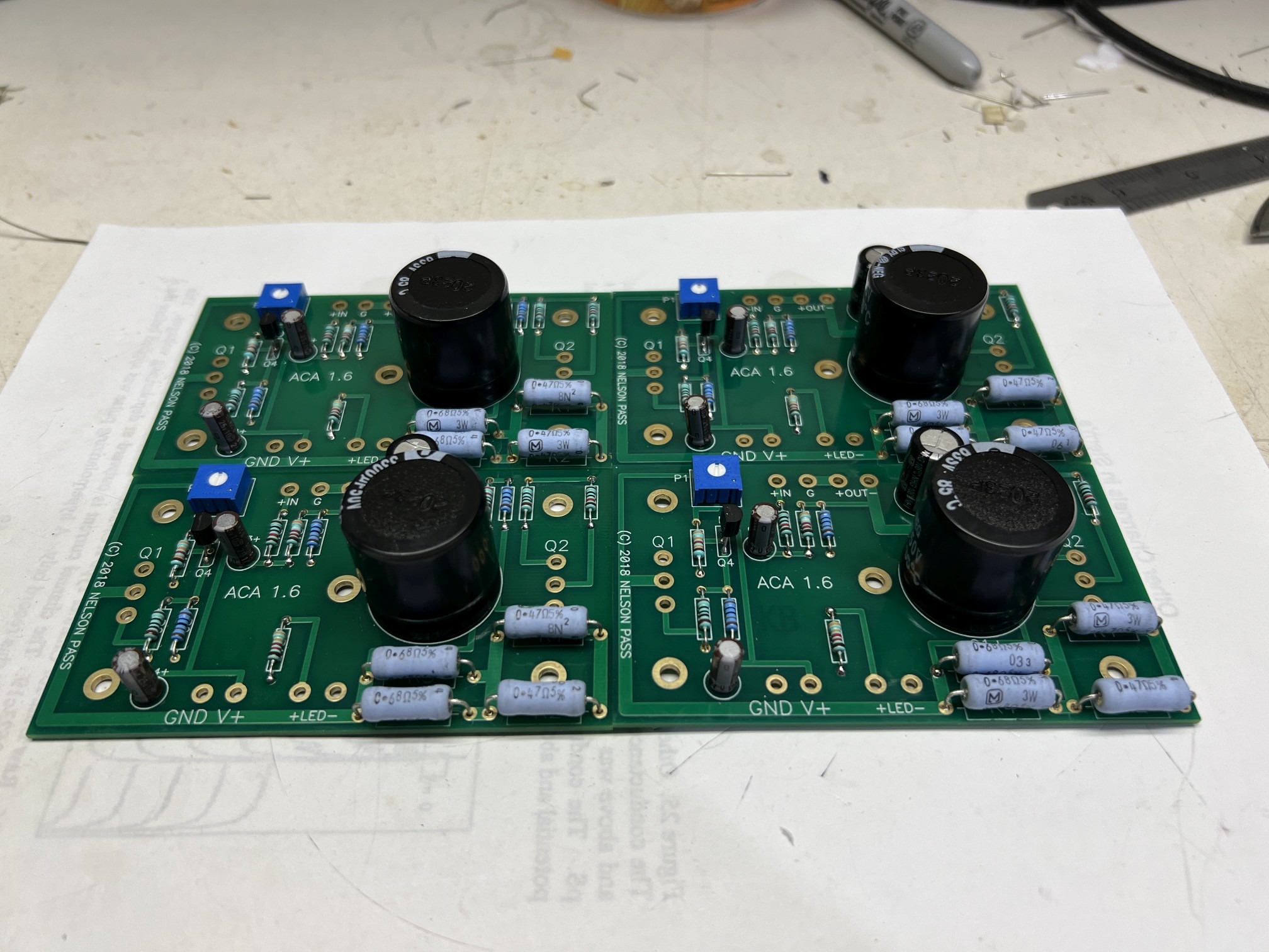

P.S. Now I need to finish those two ACAs, destined to monoblock operation!

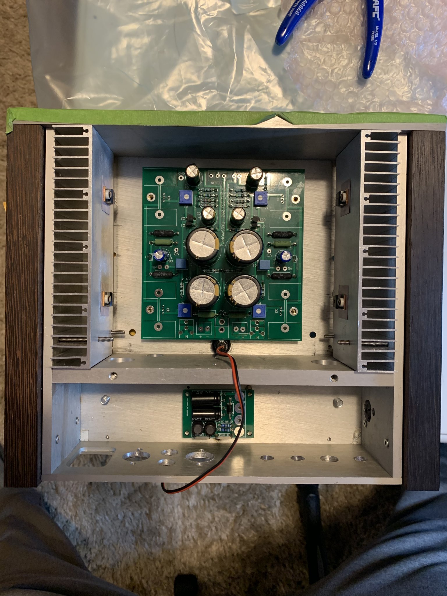

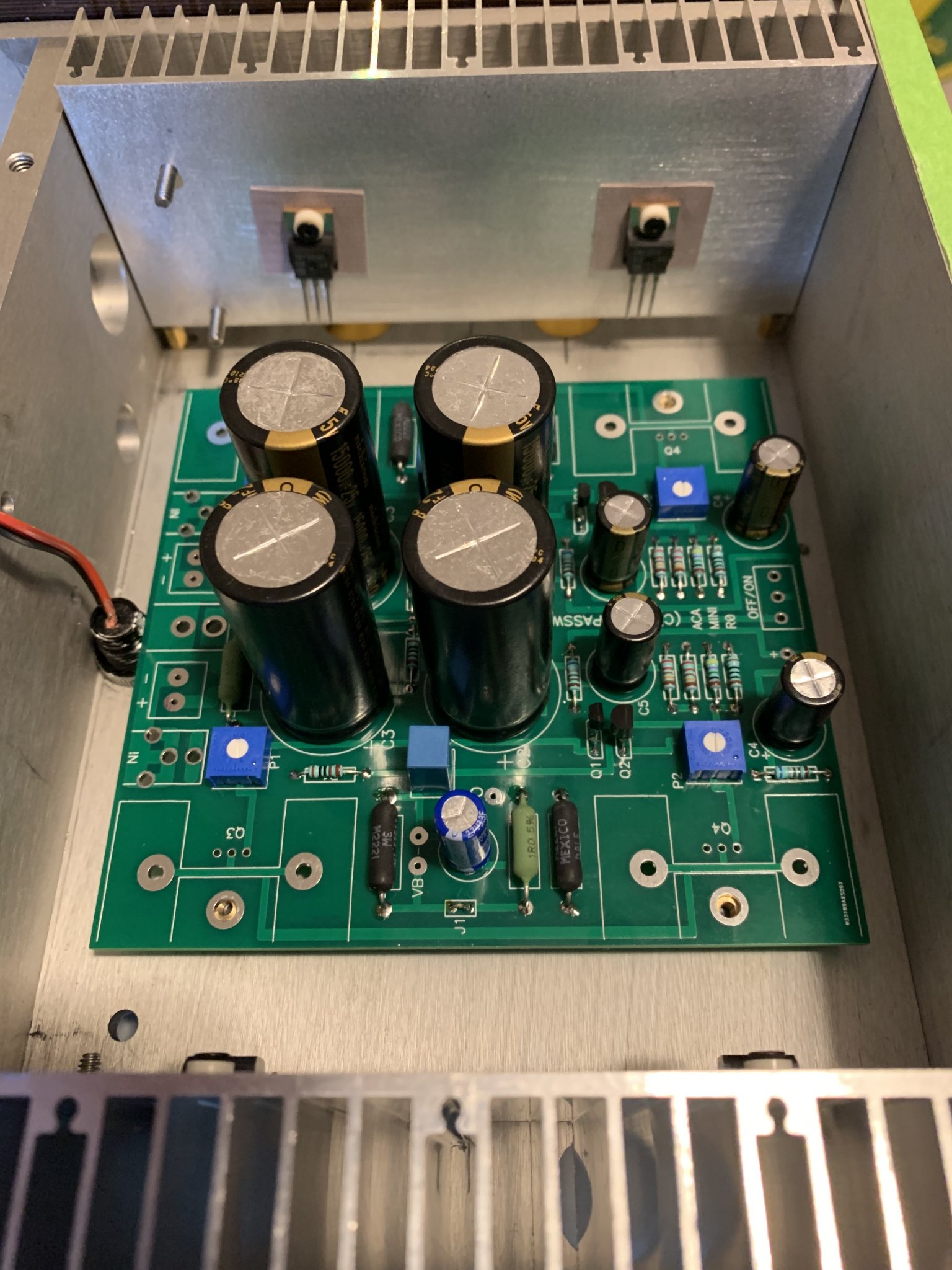

Nelson,
Should I replace the 1K pots with the 2K? I just finished assembling the old kit
