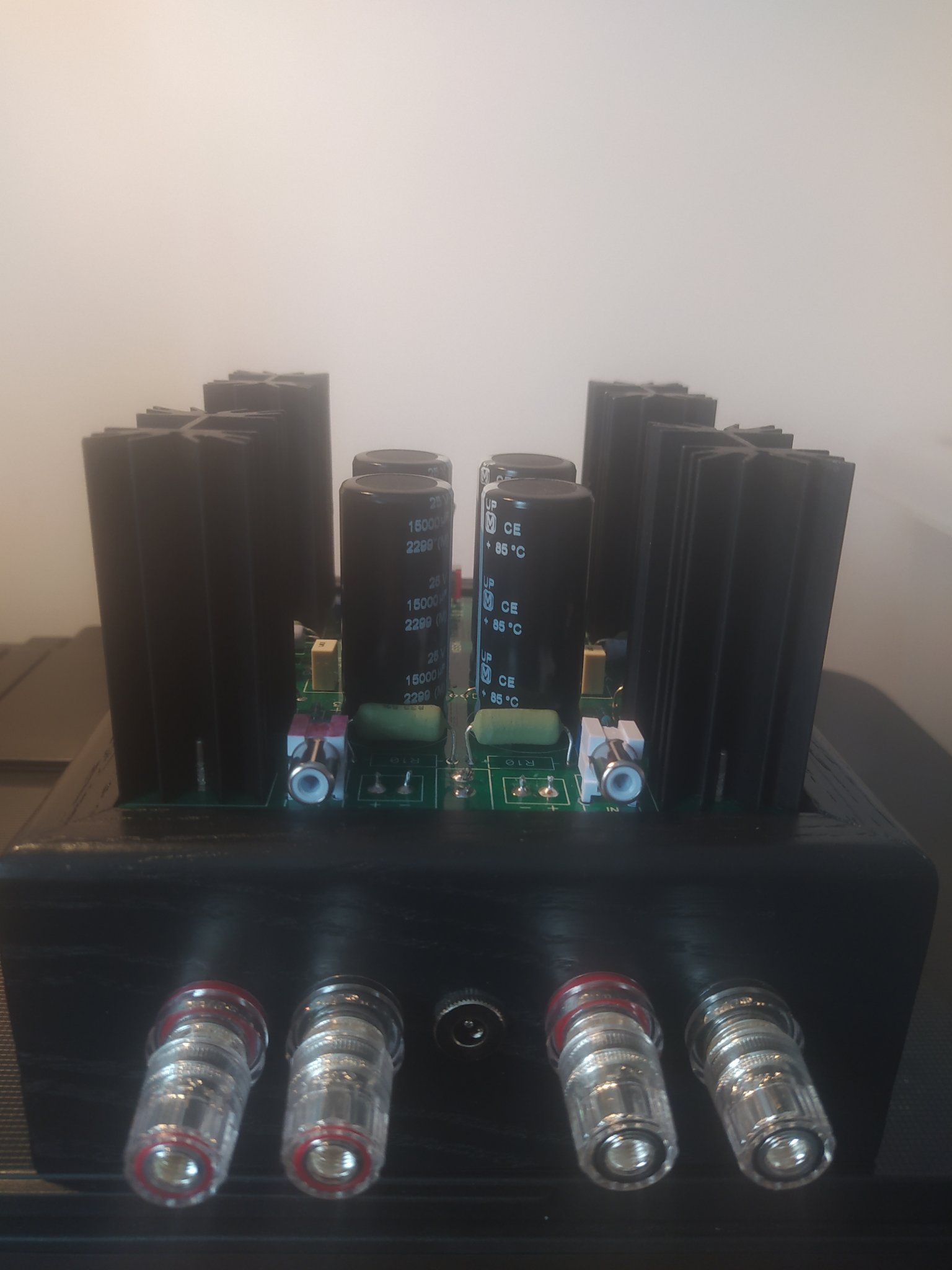

Nice! That custom base and connectors are perfect!Finished Mini with Filter inside Ash purpose made timber box. Sounds fantastic with Korg B1

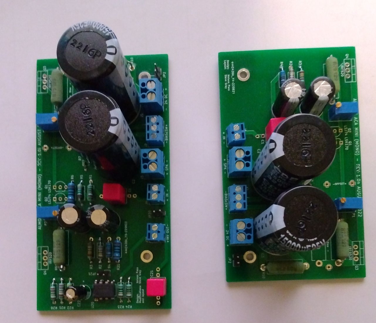

I did my own board layout making two mono boards with space for a unity gain op-amp inverter on one so it could be used as part of a bridged pair. I figured the op-amp up front (TL071 low noise FET input) was no big deal at all. The power amps are still all the same and the signal being amplified already went through more op-amps than you can count between the recorded instrument and the CD or record being listening to. BTW, ACA Mini bridged sounds very good to my old ears. Here is a picture attached of Rev 2. I Tested and listened to Rev 1 but bridged have not hooked these up yet. I have a par of ACA chassis to put them in. Been too busy lately to get it done. The boards you see here have a more usable layout than Rev 1. Also no FETs or 'Jumper in' circuit populated here yet and the connectors are more mainstream. I'm listening to my Rev 1 stereo amp as I write this,audiosteve did it. Search his name and the word Mini. You should be able to track down some of those posts.

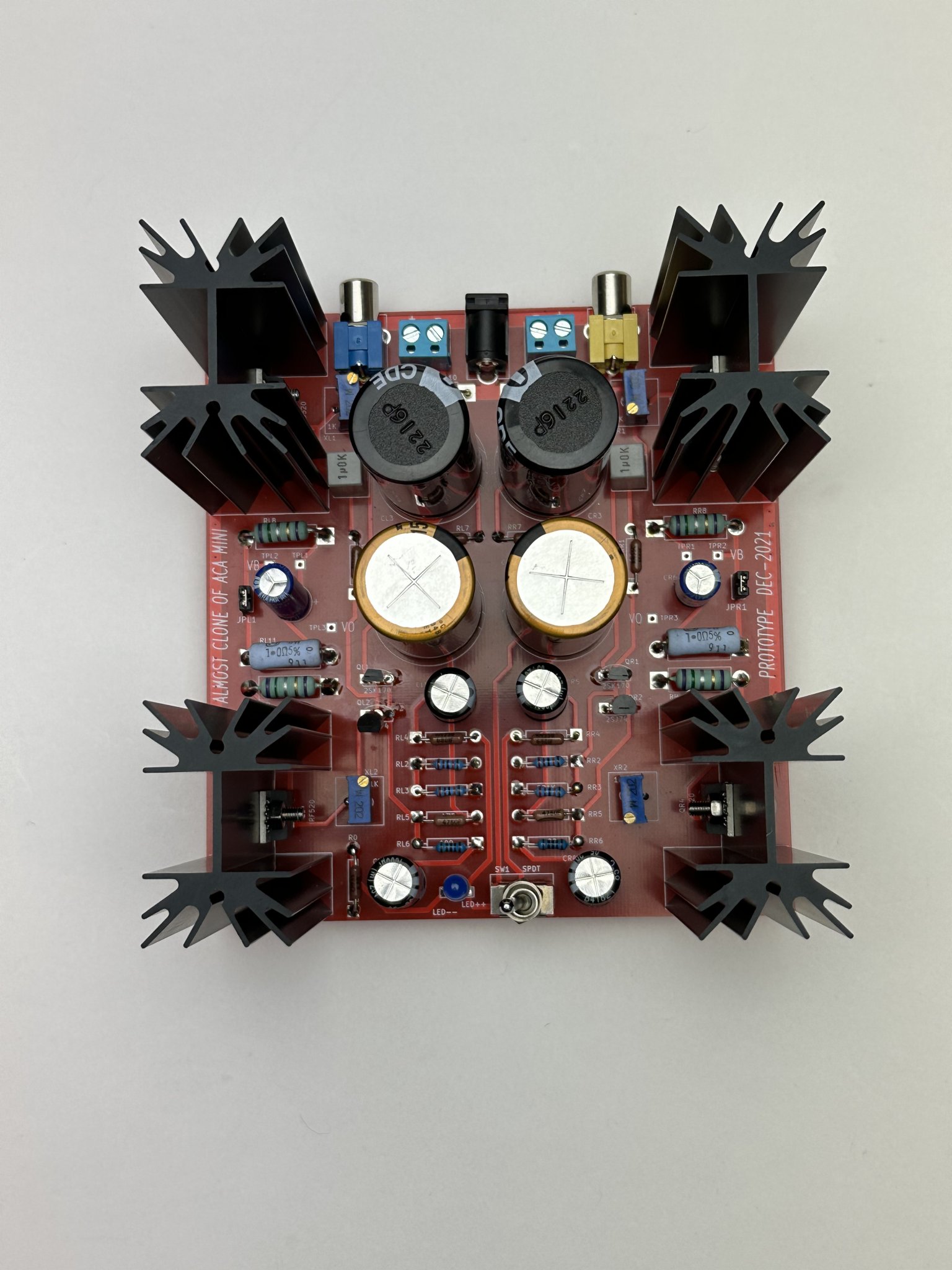

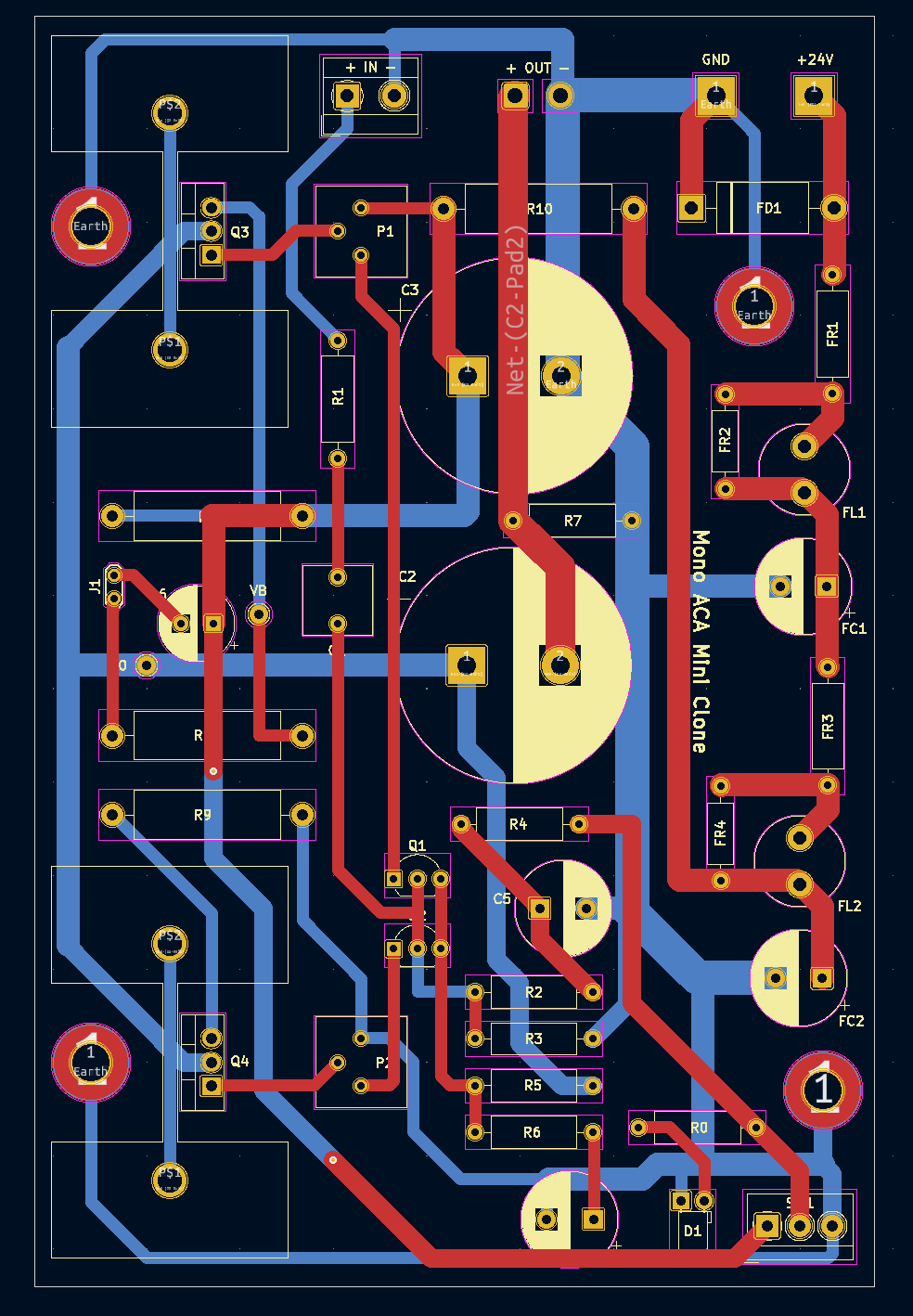

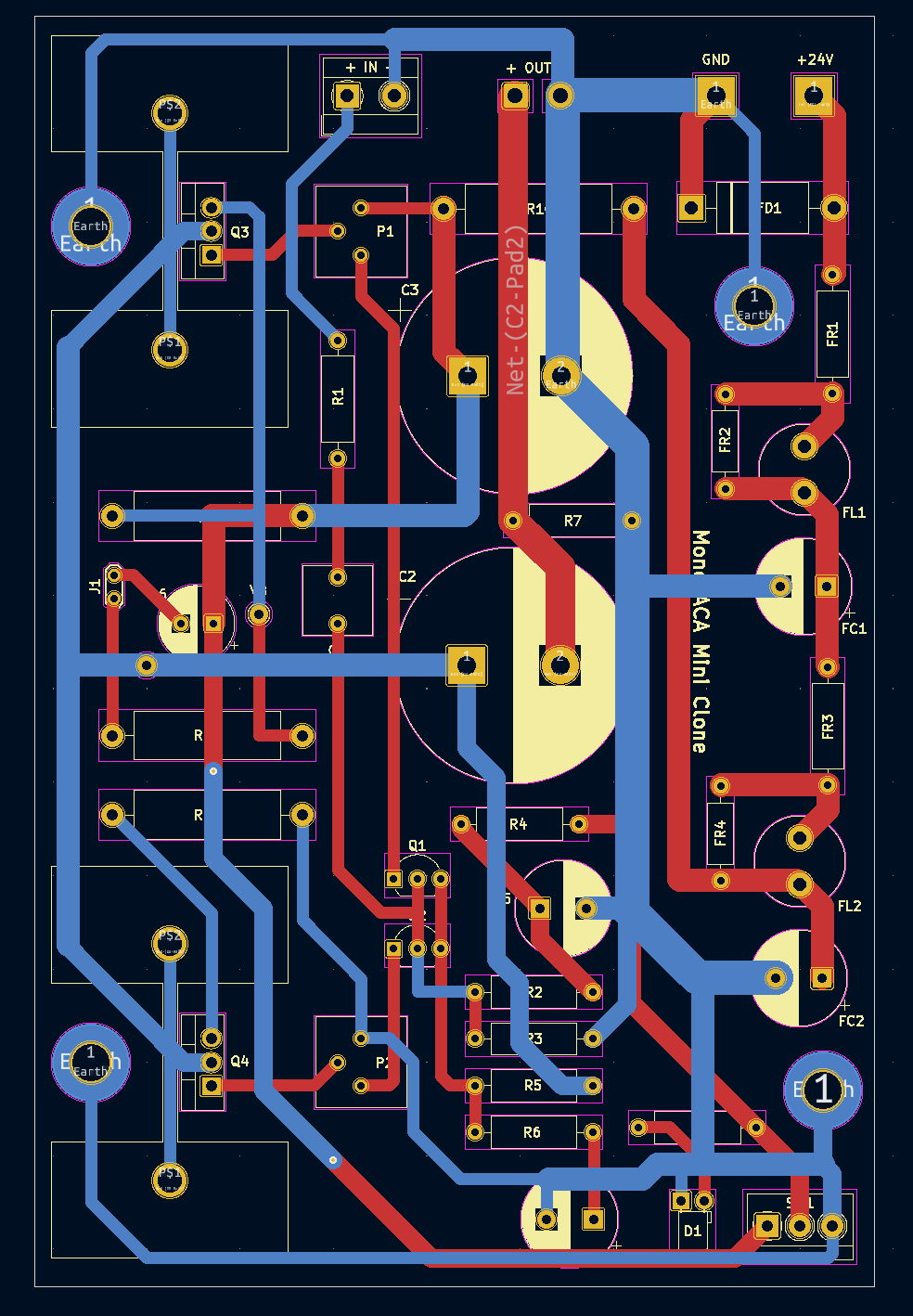

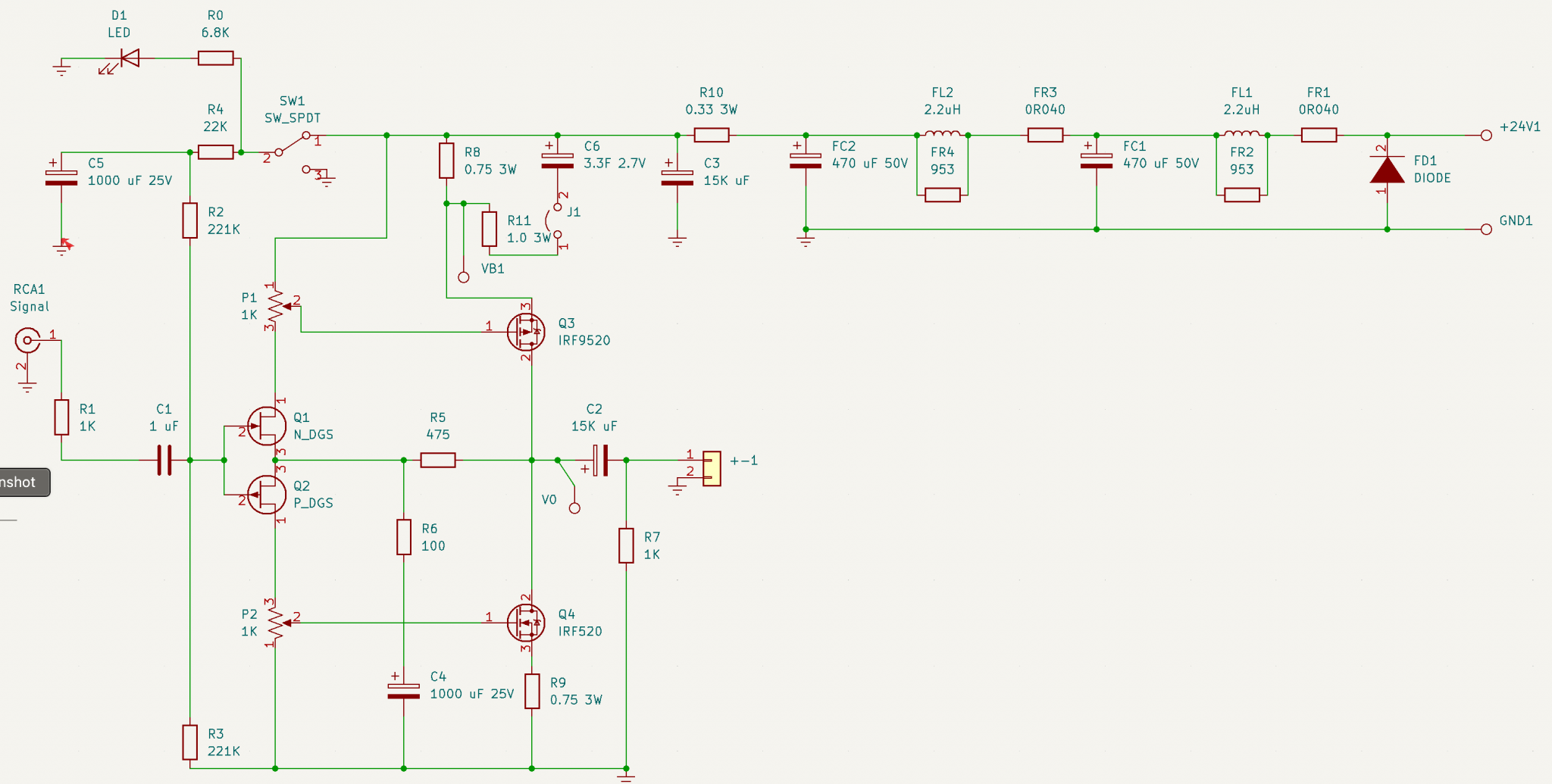

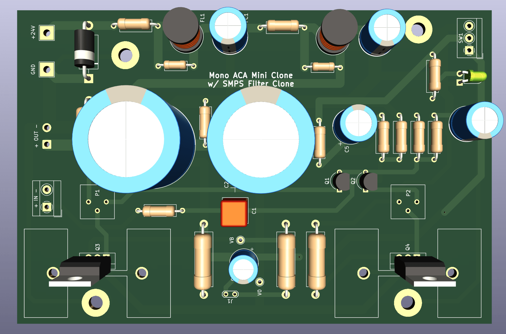

So....I saw a KiCAD video on YT and ended up making an ACA mini mono board with @Mark Johnson 's SMPS filter. Can you guys tell me if I've effed up anything pls? This is the first time I've used KiCAD and I'm not a circuit designer or an EE so feel free to be as brutal with your comments as needed
That looks pretty good to me. But then, I'm only a lapsed EE. I'll leave layout analysis to someone even remotely qualified.
Do the mounting holes conform to UMS?
Negative. I just threw them where there's space. Not sure what I'll do for enclosure yet - will figure it out later.

They're meant to use the kit's heatsinks to save money.

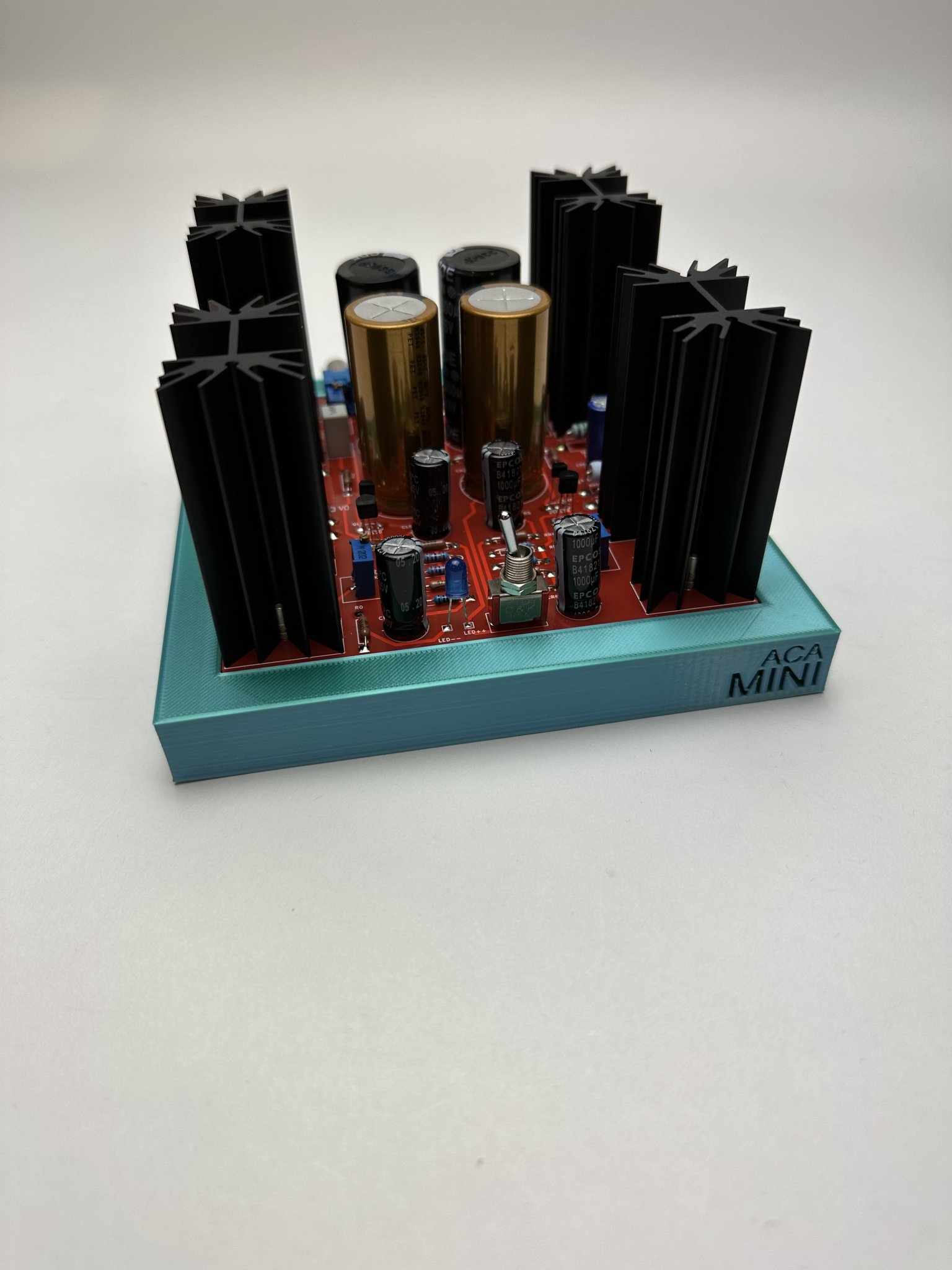

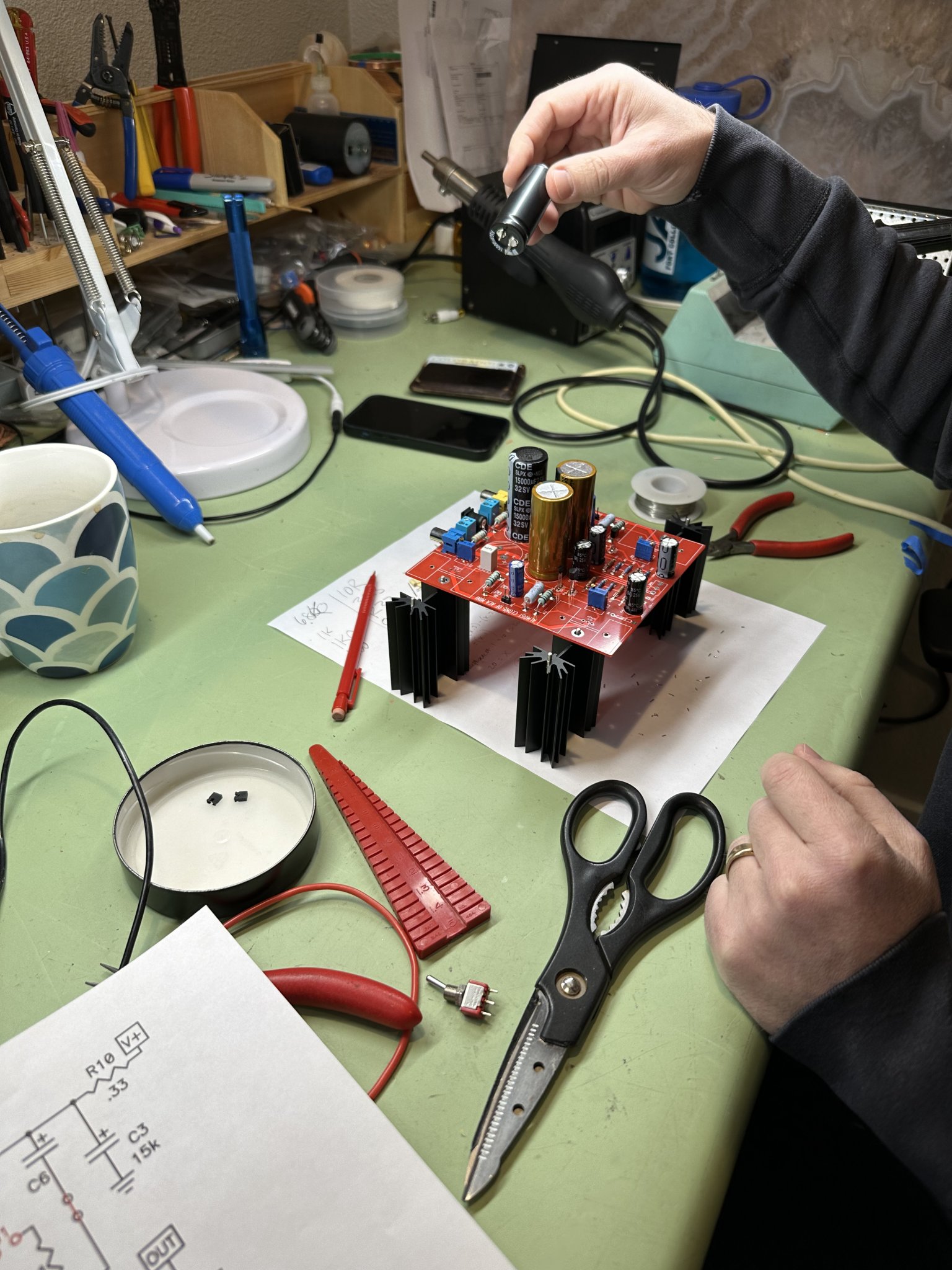

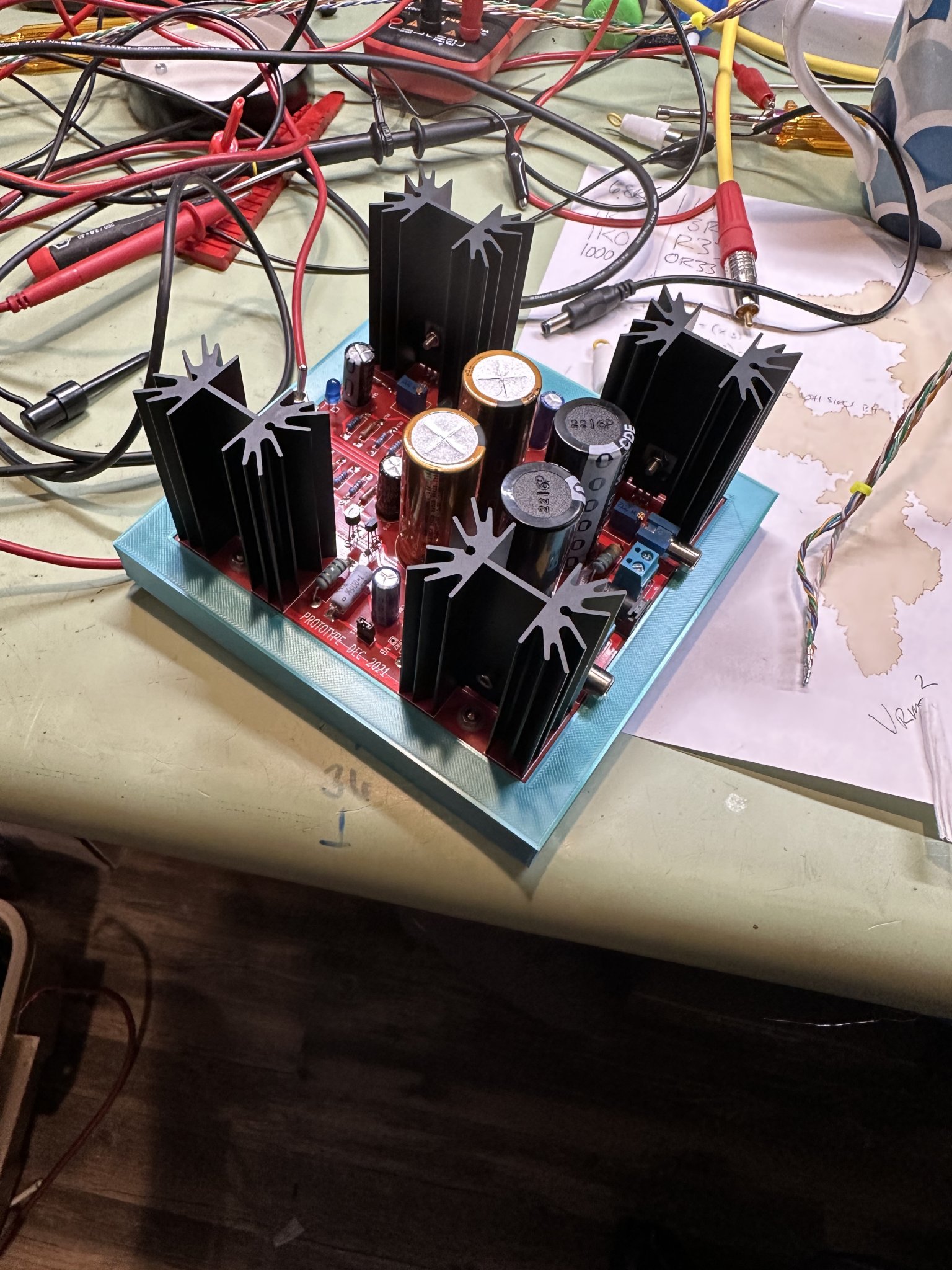

Wow! That 3d printed base looks gorgeous!
If you're willing to change the I/O around you can probably make the whole layout more efficient. And an easy one; move the line from Q4 to P2 to the bottom layer and you can get rid of the vias in the power line that crosses it.So....I saw a KiCAD video on YT and ended up making an ACA mini mono board with @Mark Johnson 's SMPS filter. Can you guys tell me if I've effed up anything pls? This is the first time I've used KiCAD and I'm not a circuit designer or an EE so feel free to be as brutal with your comments as needed
