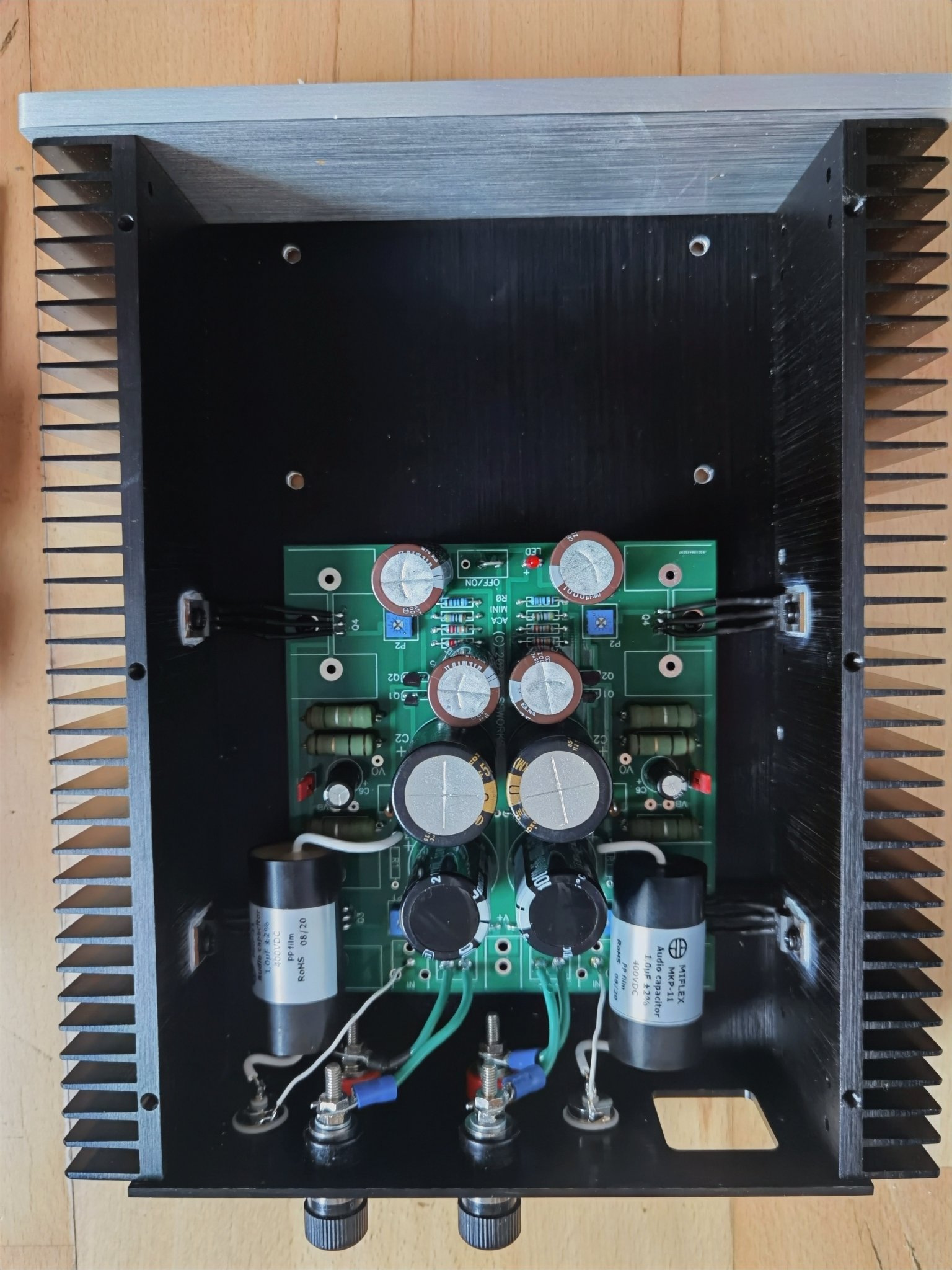

Firstly, I am by no means an experienced guy, just like to build some small stuff and have a good listen. So I maybe ask stupid questions...
So, I recently built a ACA Mini and like it very much, so much so that I decided to build another one in a case with heatsinks to be able to crank current up a bit.
So far so good, here is the current state...
Then I realized that the whole circuit is grounded through the 4 mounting holes, so the ground of inputs and speaker connection is connected to the case now.
This doesn't feel right...

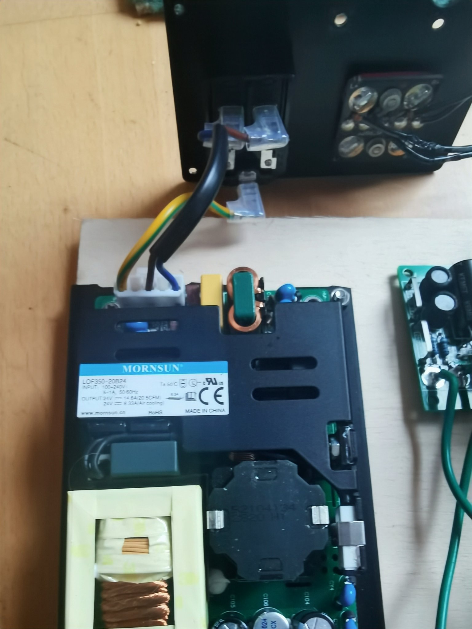

Also because I want to use this power supply, which is also grounded by the mounting screws by the famous yellow/green wire.
Question: is it ok to mount the amp board with nylon screws for isolation, and connect the supply as on the picture, so the case is connected to safety ground by it?
And then...the supply can put out 26V, is it ok to run the amp like that, also with some more current?

It may run to hot. 24 to 26 volt may sound like a very small increase in voltage but because power (dissipated) has voltage squared as a term in the equation it makes a big difference.
You could see getting on for 20% more dissipation per device even if you don't alter anything current wise. Somewhere in the region of around 18.5 watts to 22 watts per transistor. That makes a big difference to the heat.
Give it just a 100ma or so more bias and that figure jumps even higher to around 27% increase per device.
@Mooly: thanks for those figures, I'll increase the current carefully then, but those sinks are pretty big compared to the small Aavid ones so there should be some headroom. Just don't want to destroy it:)
So the active devices can take 26V I assume then? Want to squeeze out a little more out of it.
I better correct that :) I was thinking of the standard ACA...
Same applies but the numbers are very different. You would see around a 10 to 12% increase in dissipation per device by increasing the supply and correspondingly more if you increase the bias as well.
Sorry about that...
Heat is the enemy, the transistors themselves can handle far far more than they see here... as long as they are not running to hot.
You can easily put some numbers in to see how big things get for small increases.
If you have 12 volts across the transistor and it passes 400ma then you have 4.8 watts of heat for that transistor.
Increase the supply so you have 13 volts across it and you also up the bias from 400 to 500ma and you now have 6.5 watts of heat. That is per device and is nearly 36% of an increase.

Nylon standoffs and a ground lift should work well. CL-60 would be easy.
So I built a pair of dual mono ACA Mini boards up with a dual'ish mono power supply. Although I only had 24 volts, I cranked the bias up to something like .450 per device and with the large heatsinks, the MOSFETs didn't even get above say 35-40 Celcius with an ambient of around 17 Celcius. That was with the heatsinks faced down on my test bench. So crank her up and use the back of one of your finger knuckles to get a sense of how warm it is
