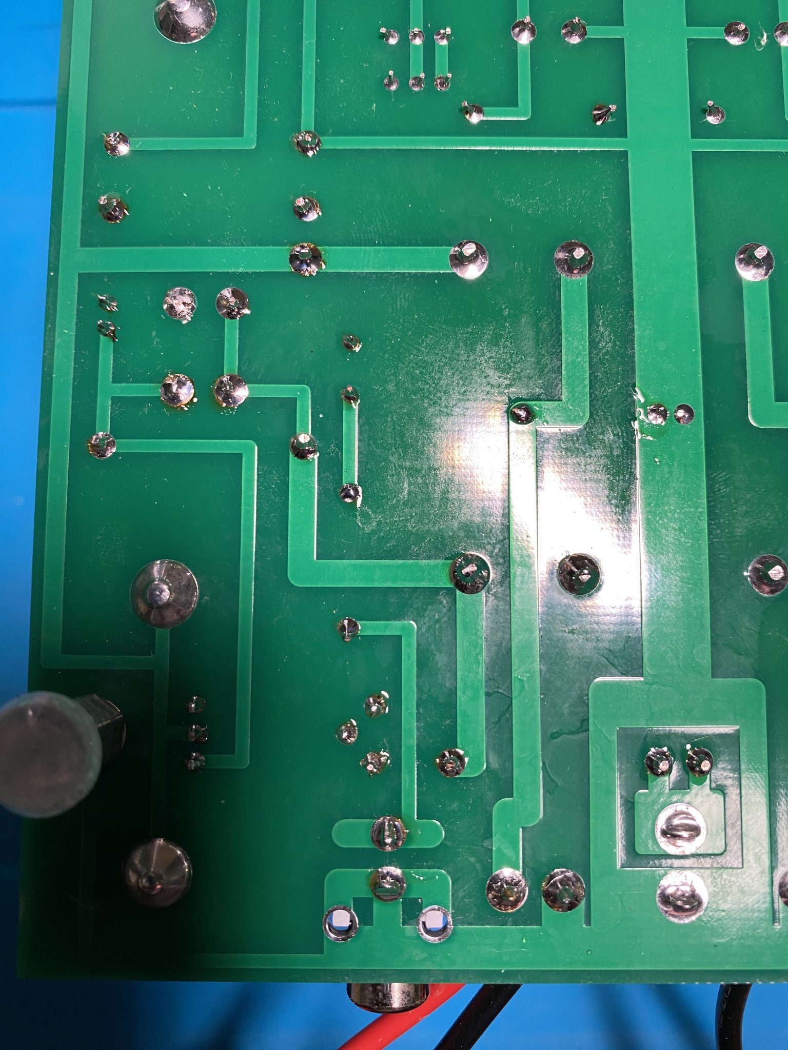

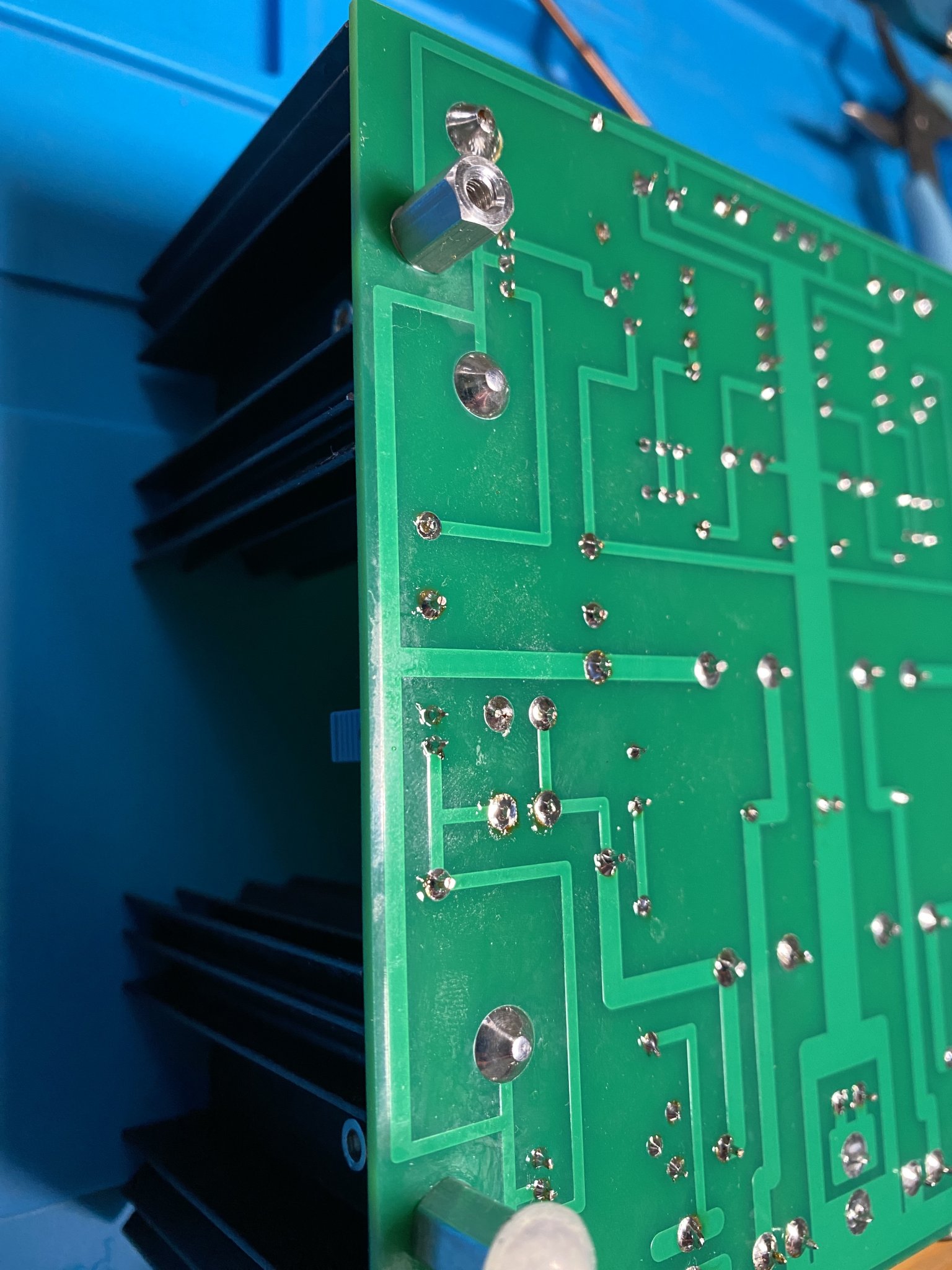

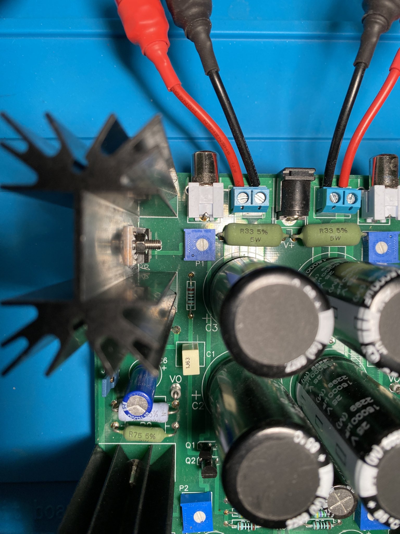

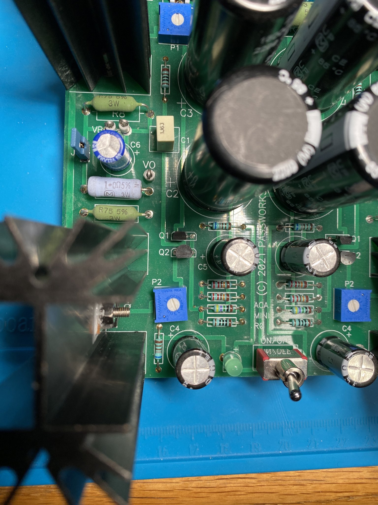

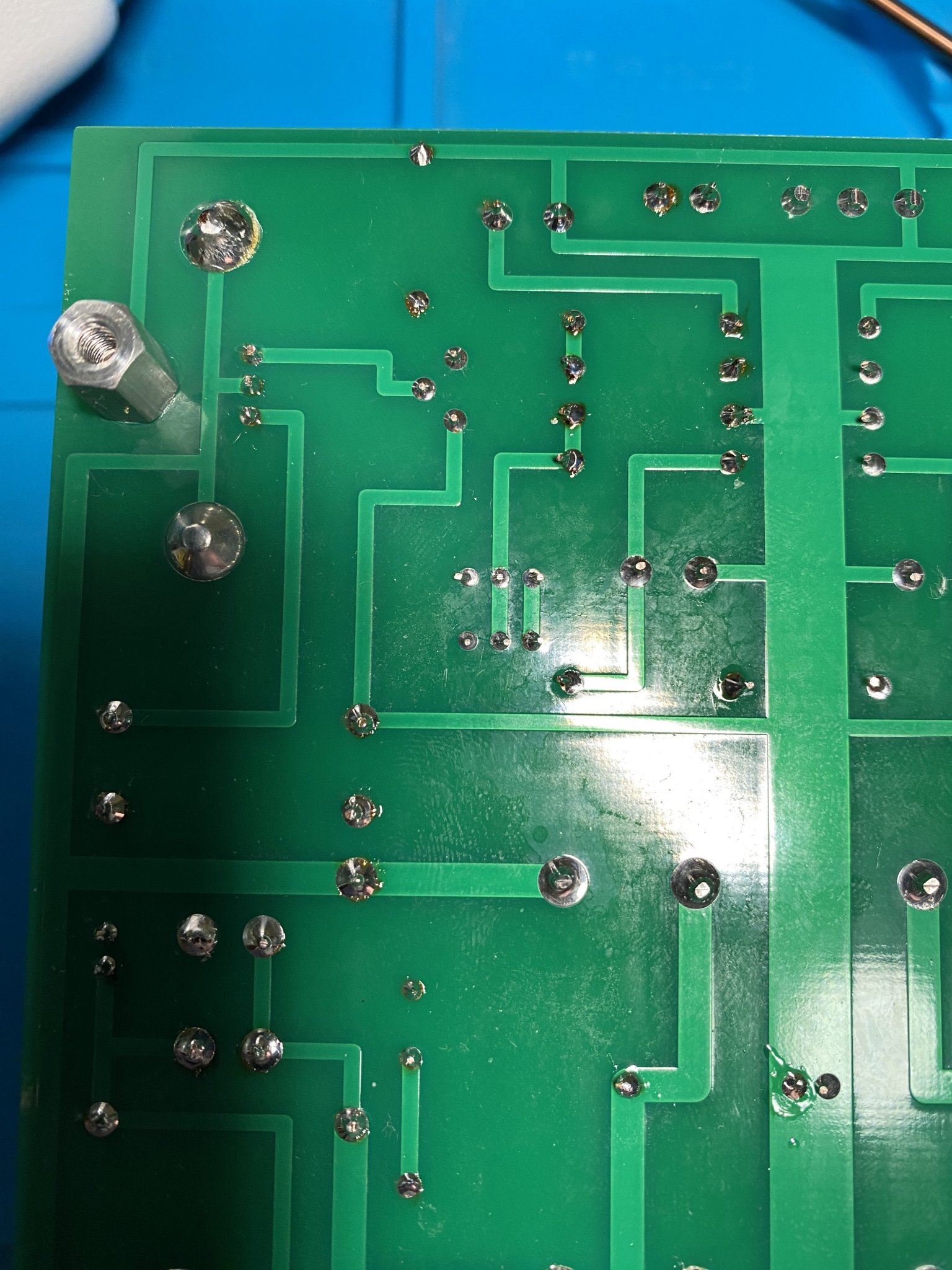

I have been enjoying my ACA Mini since I built it a few months ago. The transistors came with a sticker that said they were matched by Nelson Pass. How awesome is that? It sounds great, but now I need some trouble shooting help. A few weeks ago, I noticed the left channel was silent. Both channels bias just fine, but the voltage doesn't change on the left side when music is playing.
I had time today to reflow each solder point on the left channel but that channel remains silent. The cables all work since both channels play fine when I swap a different amp. The RCA plug has connectivity on both legs. Everything looks okay to me.
I am at a loss as to what could be wrong. Photos are attached (I didn't clean the flux after reflowing and adding a bit more solder). Thanks for any suggestions to get this back up and running.

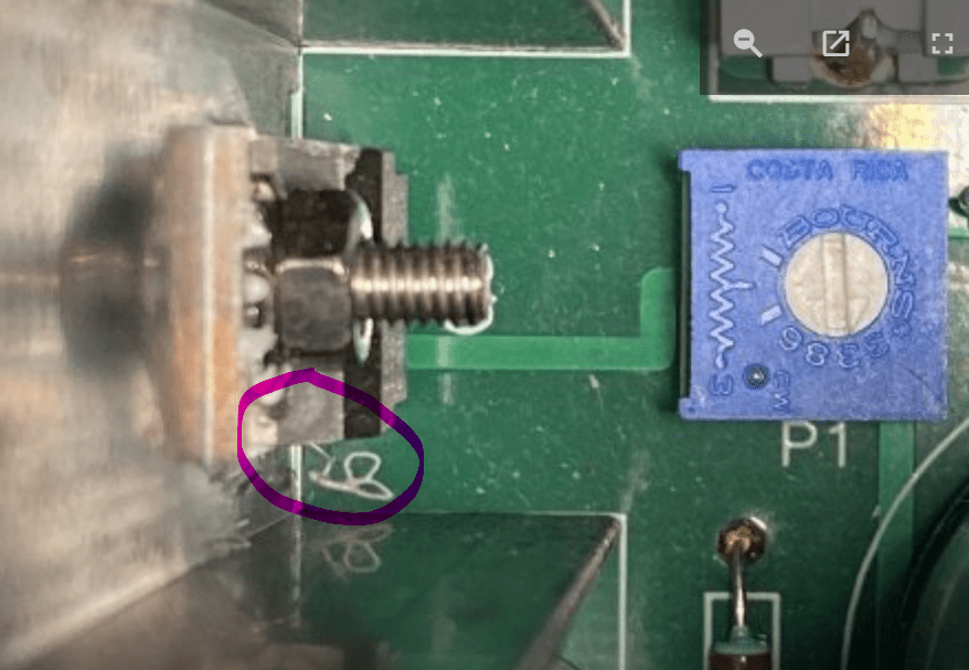

It is working again! Thanks for taking a look through my photos, von Ah. That goober is thermal paste that I need to clean up. I added the paste last night, concerned that I had somehow overheated the Harris transistors.
The issue was that I didn't install star washers on the back side of the heatsinks. I only installed them on the front side like a goofball. Now that I have a good ground connection, both channels are making beautiful music again. Yeah! Now I can reclean it and put my Elekit TU-8600 up for sale to fund my next project.

It is odd, huh, @Mikerodrig27? It looks like the PCB track directly connects the drains, with or without the heatsink.
I reflowed the entire left/problem channel last night to no avail, but today noticed a connectivity problem from the center pins of the 520's to the heatsink post. Once I added a star washer to the backside of the heatsinks, connectivity happened. Every other connection on that channel also beeped on my DMM. I'll get it cleaned up and touch up the bias since I added goop to the 520's. Let's hope this was it. I love this little amp.
