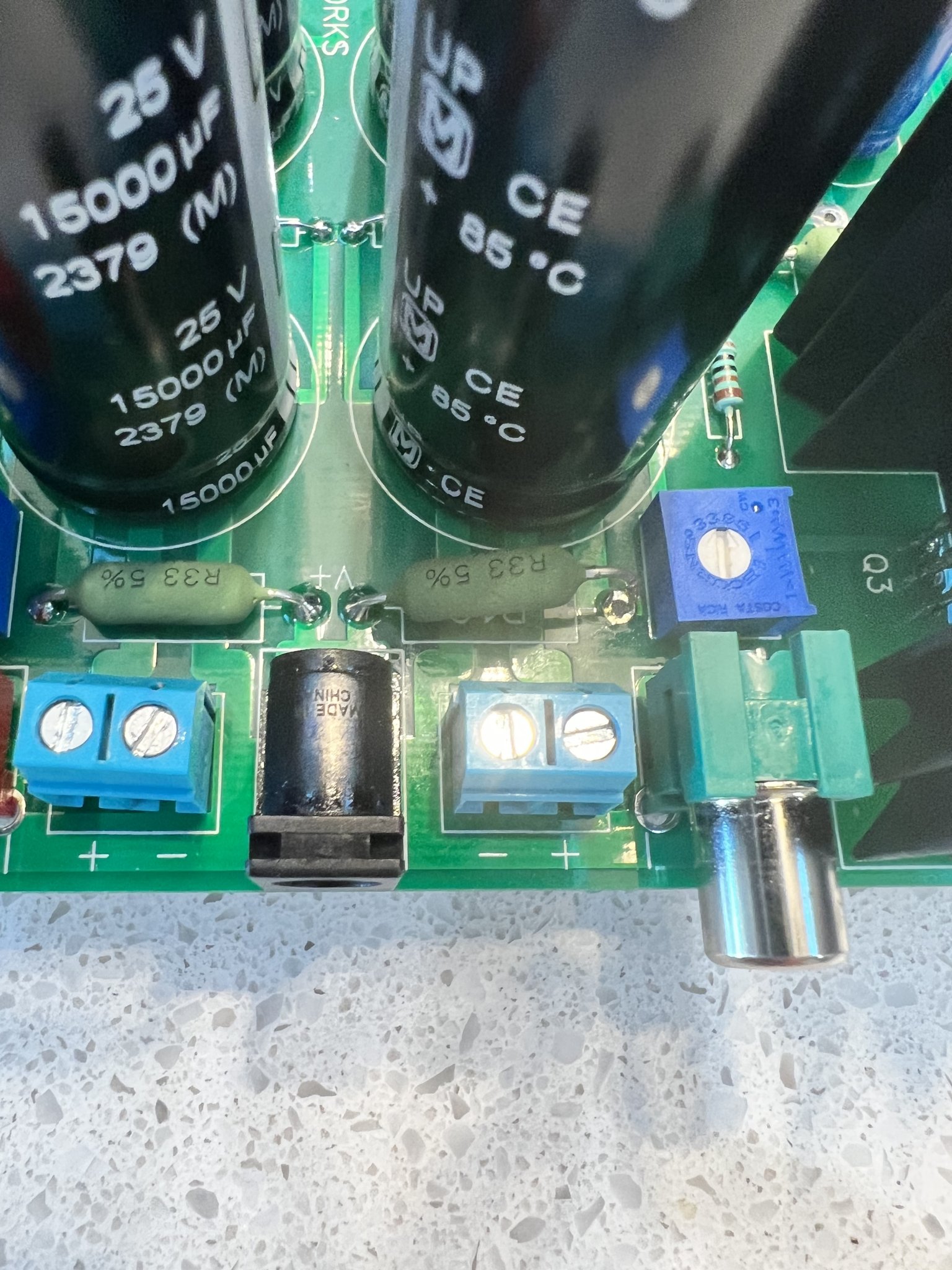

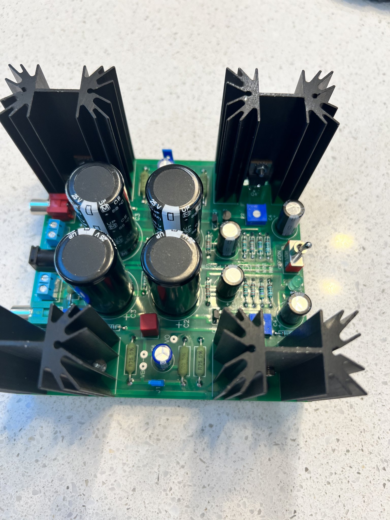

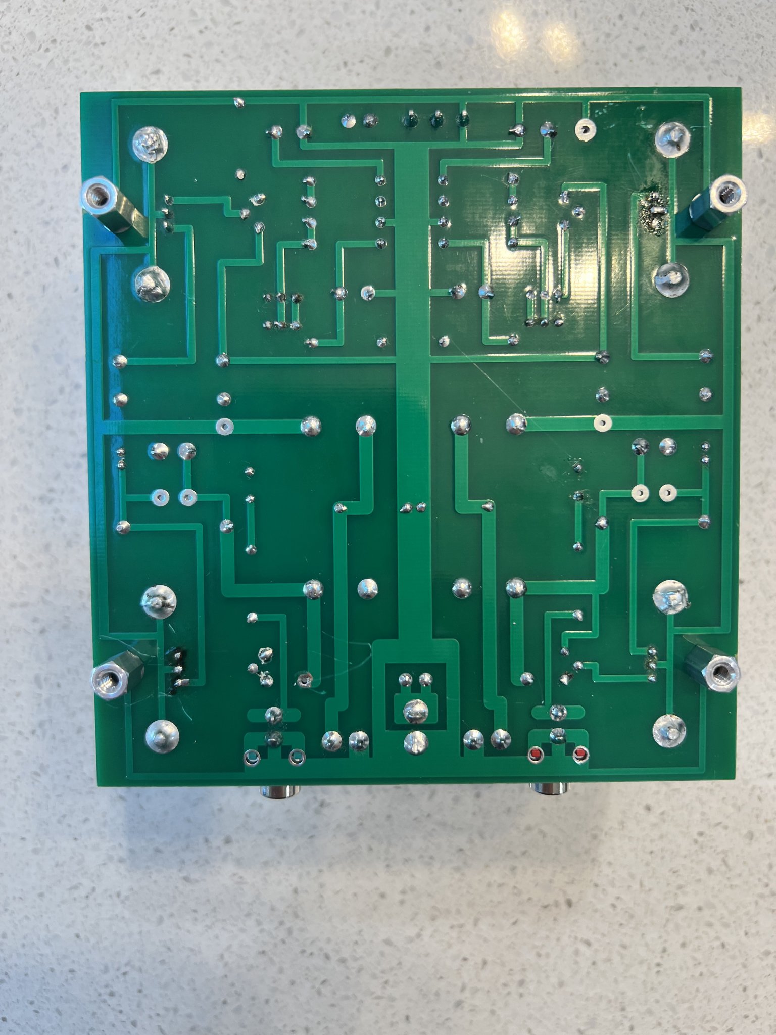

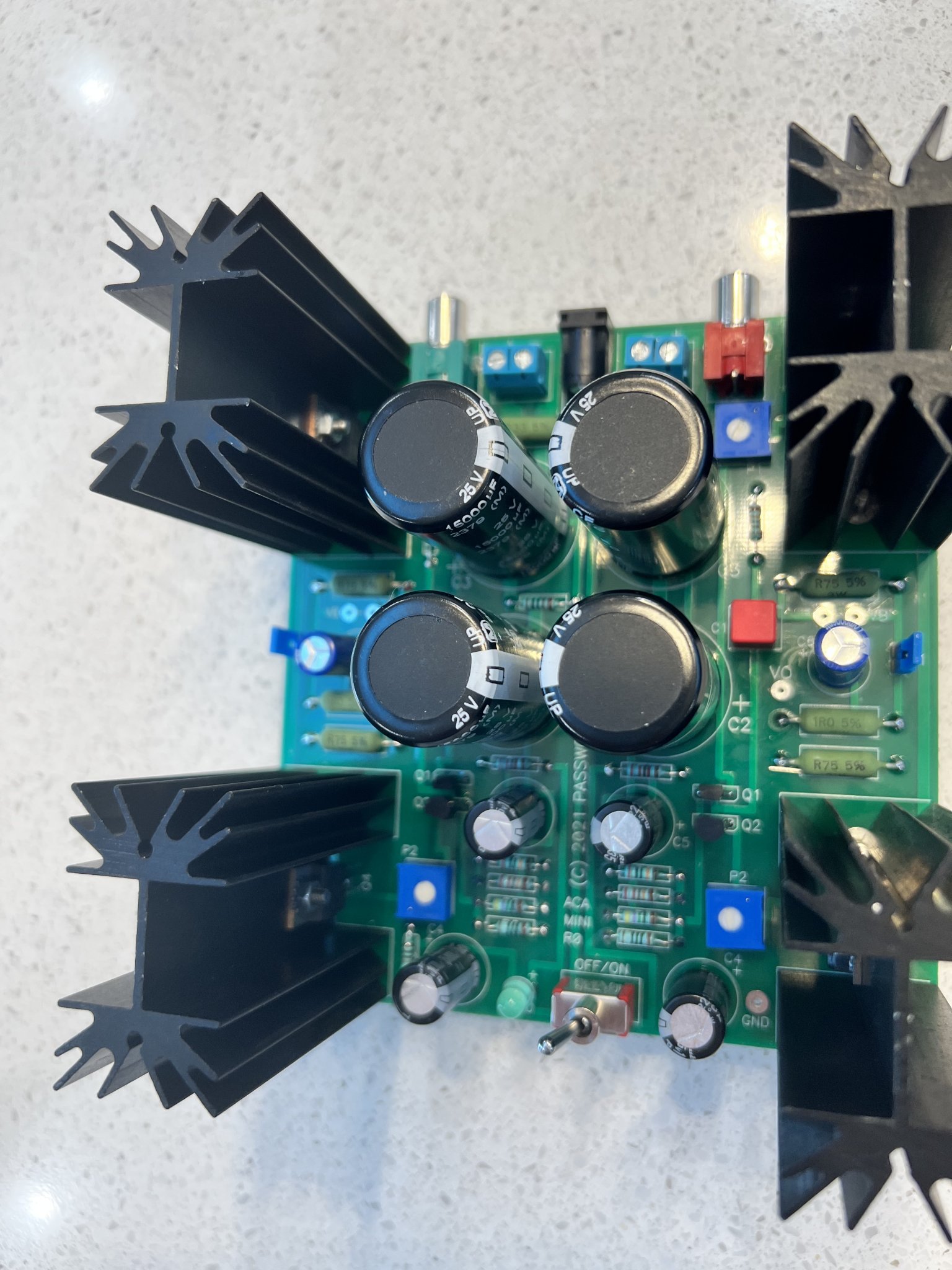

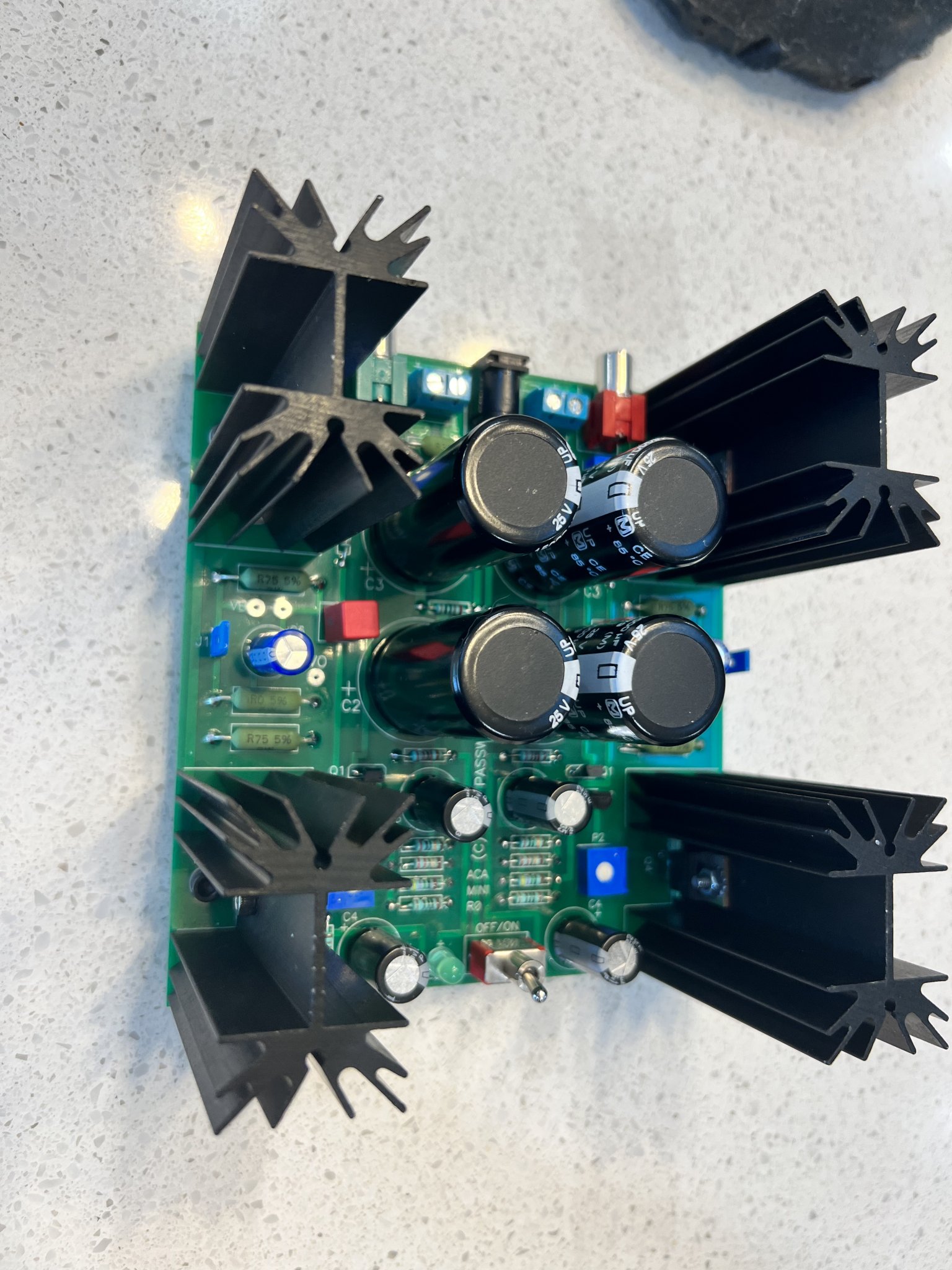

Here are some pictures. A couple notes about my build and errors I made before power on and biasing, which seemed like it went fine. I thoroughly cleaned the board, then reviewed everyhting before initial power on. I had already fixed one mistake at that point, the transistor polarity on one side of the board I had to desolder and resolder to do this, I used an inexpensive desoldering tool. The transistor, did get hot. I unsoldered and chanfer direction of one of the film capacitors, as I wanted them the same direction on each channel, even though I do not think polarity matters there. But for consistency, I did it anyways. The fets. I had it in my head they were all the same, so I so I put them in as if they were. I noticed it before power on and moved them to the correct places. you can see the rework where i did that. That's about it, I think.

I recommend unplugging the amp and using your DMM to test for continuity for each component on each channel. Use the schematic to follow the path, marking off each confirmed trace. If you find a trace that doesn't have conductivity, you will know that component is having a problem (either reflow the solder joint or replace). Fluke has a nice explanation here: https://www.fluke.com/en-us/learn/blog/digital-multimeters/how-to-test-for-continuity
Ok, just re plugged in. The right channel is the one with R10 disconnected. Left channel reads 24V on the right channel. No LED is on at that point? Checked the connector for continuity. It is open. Thanks for the help everyone so far...
Left Channel reads 24V on both sides of the R 10 until protection kicks in. It also reads 24V on the right R10 where it is connected to the board still.
