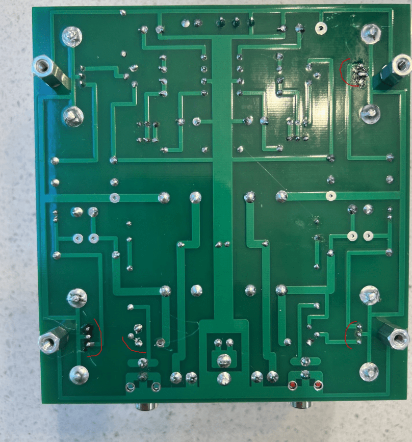

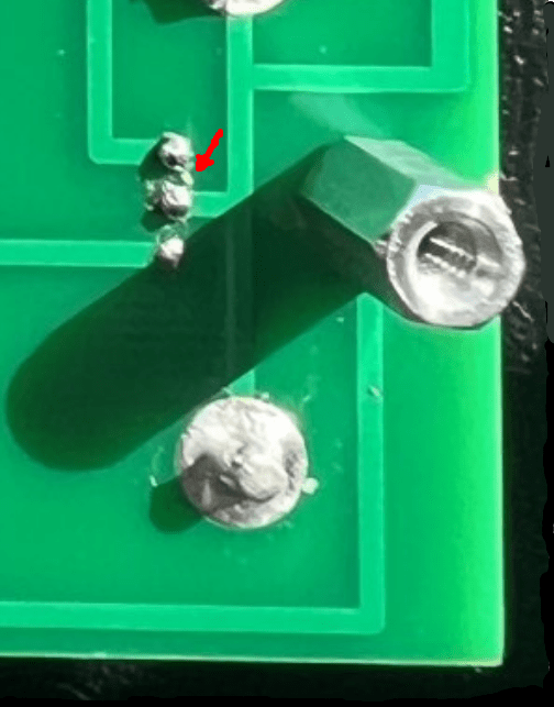

Worth IMHO checking continuity at said legs with rest of the circuit... doesn't look great, but who knows...
For some reason after my rework, they did not flow that well, but I get no continuity on any of those pins tested every combination of pins. Thanks for pointing that out

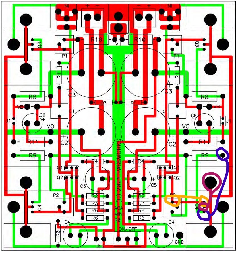

What temp is your soldering iron? It may be a bit low. Adding a bit of flux to the rework joint can also help it flow better. Using NP's artwork from Page 3 of his writeup (attached), you can print it and test for continuity along each PCB trace to confirm you have a good connection.
I tried to circle the pins to show where you should have continuity.
If you don't have continuity, that will be a good clue to make note of. Hang in there--troubleshooting can be frustrating.
Was refering to conituity with the components they are supposed to be connected to, not between legs...

OK, I just re flowed the 2 fets, and the film cap. Fairly happy with them now. Here are the results before, and are the same as after flowing as well
Blue, continuity
Purple, continuity
Orange, no continuity, getting a resistance reading?
Blue, continuity
Purple, continuity
- How much resistance did you read? That's the variable resistor, so some is to be expected.

- How much resistance did you read? That's the variable resistor, so some is to be expected. 113ohms and starts climbing.
- How does the continuity on the rest of the board check out? I have not traced the whole board yet, but I am having a problem with it going into protection, if I had an open circuit somewhere would it actually do that, or would it just not work ?

Man, I was pretty happy with my work, until I blew it up. This was the board before biasing. I am just trying to regain a bit of credibiltiy. I have been soldering for 30 years on and off haha!

Shouldn't orange be 0 (or so) if aiming at the very next legs of the variable resistor directly?

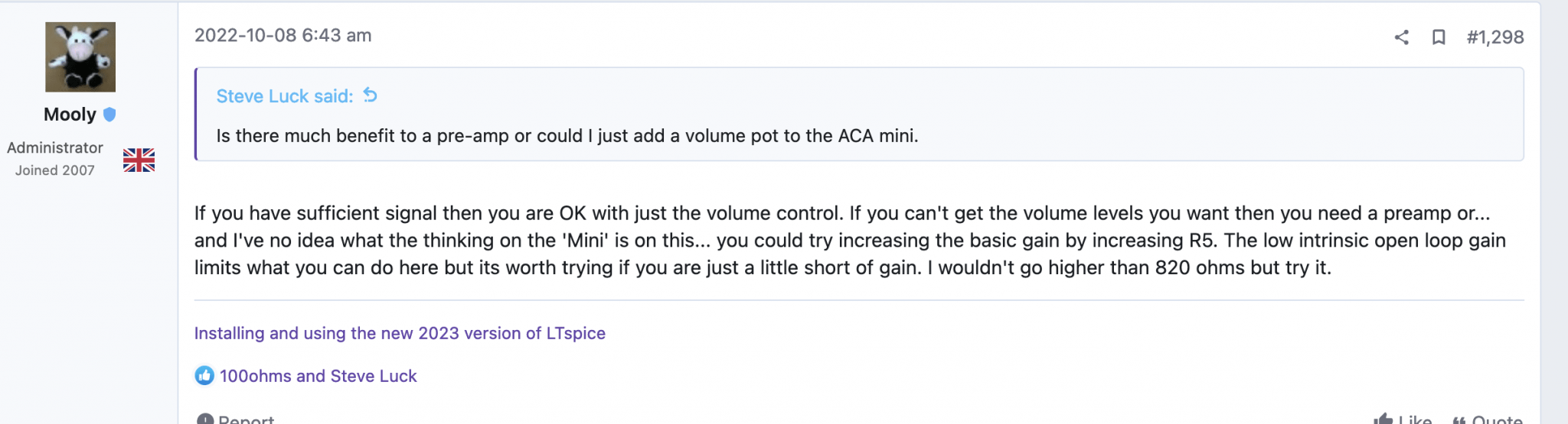

since i use ACA mini just at work with weak Ipod as source (it has not 2V signal Voltage swing), i wonder if i can rise the gain of ACA mini? I found a hint, tweaking R5, but would be happy if someone confirms it as the way to go.

Shouldn't "orange" check be 0R (or negligeable resistance) if aiming at the very next legs of the variable resistor directly?
If so, and it is showing 113R, wouldn't that indicate that possibly one of the ciruit trace from tha transistor is damaged... and a simple fix be just to solder a wire in parallel between said transistor leg and the variable resistor leg?

Update. Last night, after some continuity checks and solder pad reworks and cleaning. I decided to solder back in the R10 leg. I put it down for the night. this am I connected the smps, but did not turn it on for a minute or two based on Chris's recommendation. Well, when I did the whole thing came on, at 9:02 and is still on now. I am reading voltages at the bias points that make sense and are in range. Thinking I leave it one foe a while, tweak the bias and test in my system. Right now, my VB is .200 and my VO is 15.5 on bolth sides give or take. Thanks for the support so far all.
Try to keep V0 between 11.4 to 11.6. V0 lowers when you turn P2 up (or P1 down).Right now, my VB is .200 and my VO is 15.5 on bolth sides give or take. Thanks for the support so far all.
