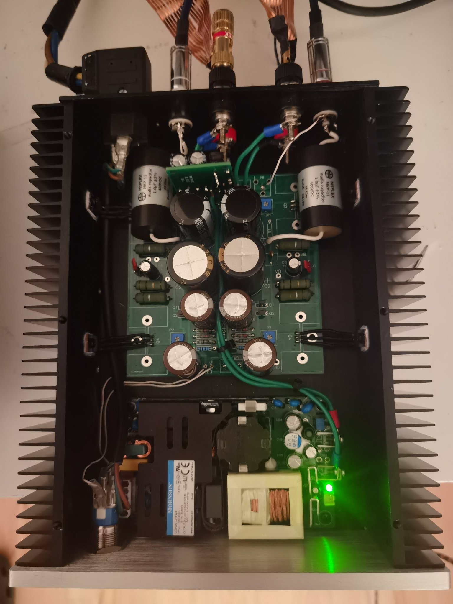

So, here is a rather boring form factor compared to the above... I managed to squeeze everything in a fairly small enclosure, everything is working fine and I even have a fancy led power switch.
Bias is at 0,45VB and 25.5 V, heatsink temperature is 45C at max.
Sounds better than the one with standard parts, I used an Audio Note tantalum resistor at the input, Takmans otherwise, good mkp caps, and Nichicon KW as outputs.
Sweet sounding now after quite a long burn in time, like it more than my EL84 SEP with approximately 4 Watt. And I like this one a lot...

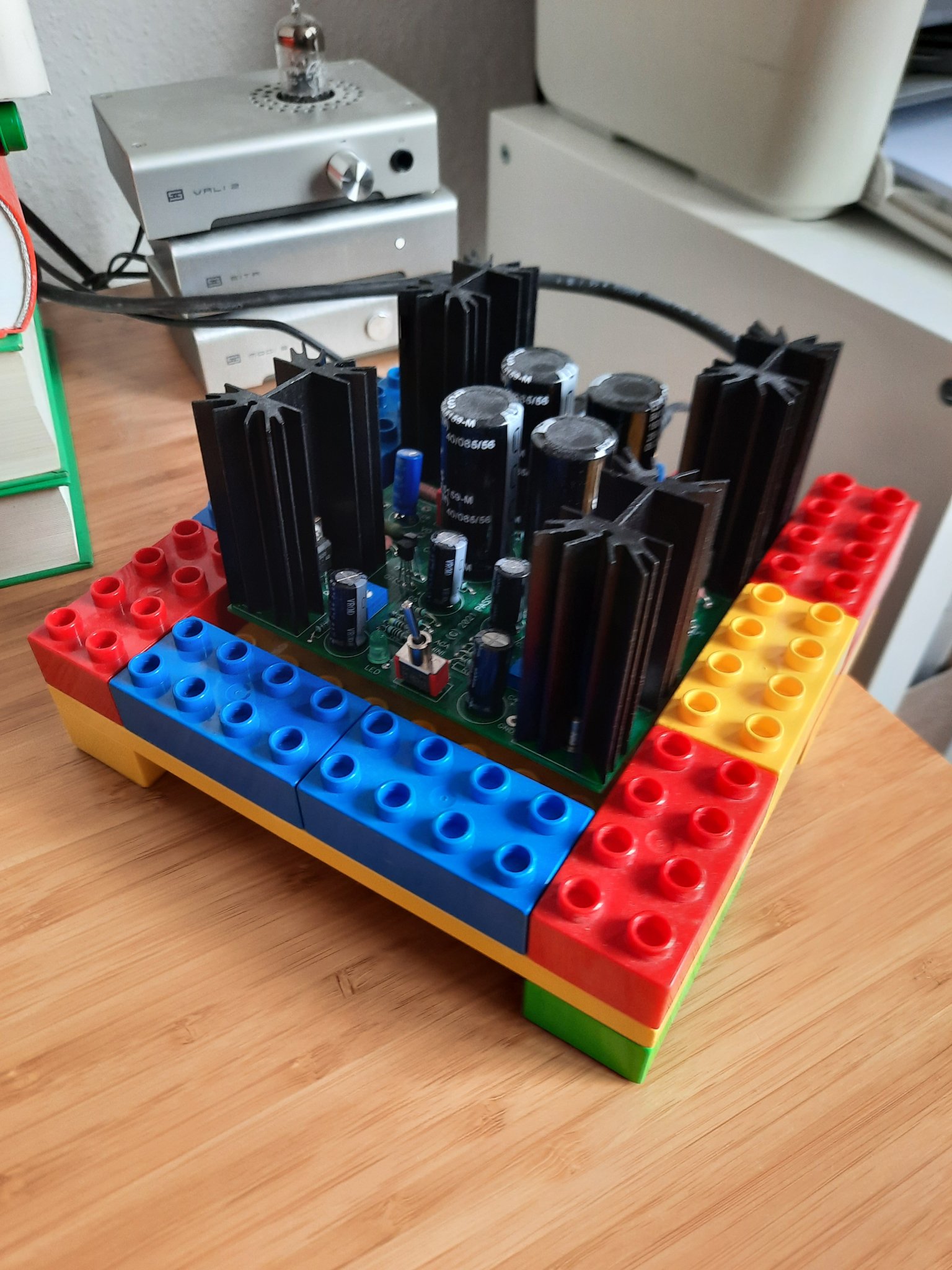

This is squarely in the realm of “try it and find out”.
Will there be some amount of aluminum plate that will move enough heat away from the output devices to keep them in thermal equilibrium at a suitable temperature? Yes, absolutely. How big is that plate? No idea…
And of course, once that chassis is warmed up, the heat has to go somewhere, usually the air. Will anything be on top of that chassis? Will it have good airflow around the bits that are getting hot? Etc…
There is no simple answer of “yes, use the X chassis, will work for sure.” BUT, I am sure that there would be a solution that works exactly as you envision. You have to experiment.
One thing to remember, the heatsinks that the ACAmini was designed around have pretty good thermals, and they operate in free air, which is a best-case scenario for heat removal. https://www.digikey.com/en/products...ion-of-boyd-corporation/530002B02500G/1216384

As additional info maybe try this software (I have not tested it); https://www.heatsinkcalculator.com/flat-plate-heat-sink-calculator.html
IIRC you have a total of 10W/ch to dissipate in heat.
