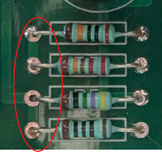

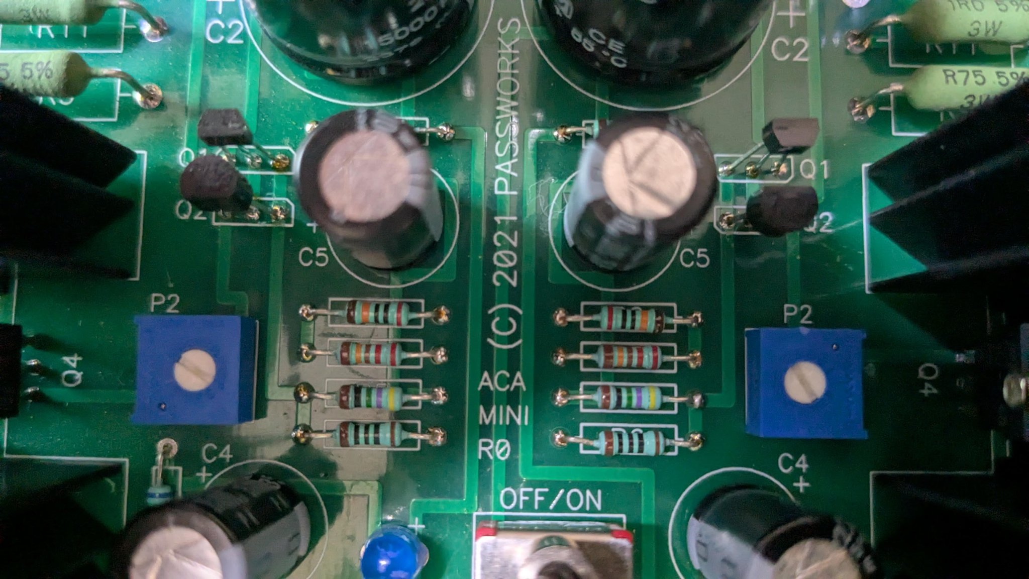

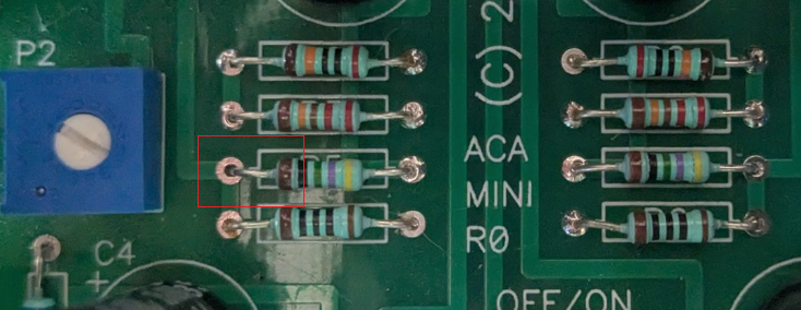

It's not always the case, but 'things changing over time / with heat' points toward solder joints.
I'd start with reflowing these, particularly R5.
Unsoldered, resoldered, biased. Now waiting for her to cool down and see if it sticks. I noticed that one of my Bobas was also shy a little solder so I decided to re-flow that guy as well. Pay no attention to the fact that the top right resistor is backwards and breaks good stuffing etiquette. I'll be punished enough knowing that its there day after day, night after night, mocking me...
Viola! I was skeptical but that did the trick. So my lesson is to ensure that I take the time to get enough solder through the holes. If either of you find yourselves in the Raleigh area, beers are on me!

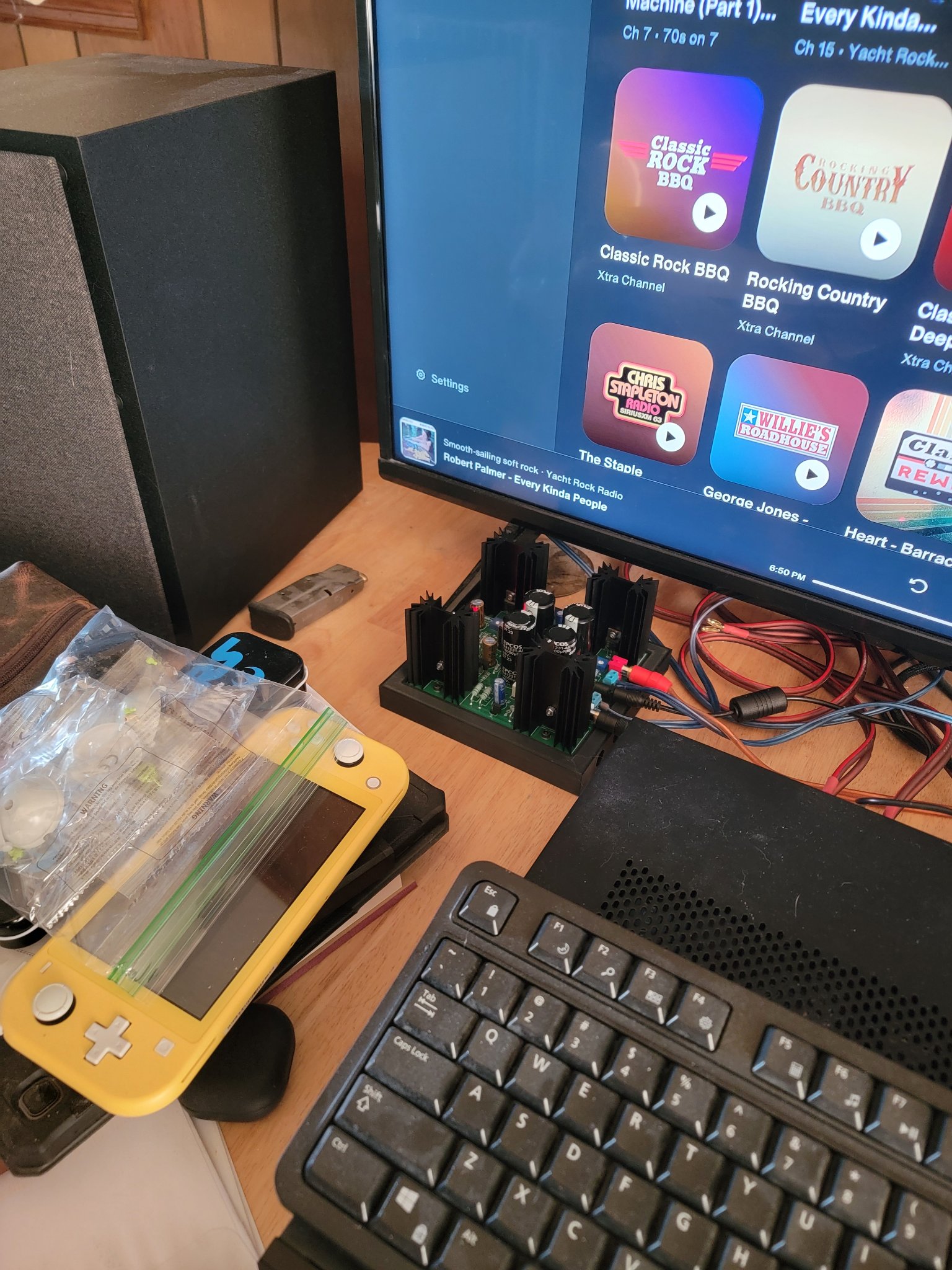

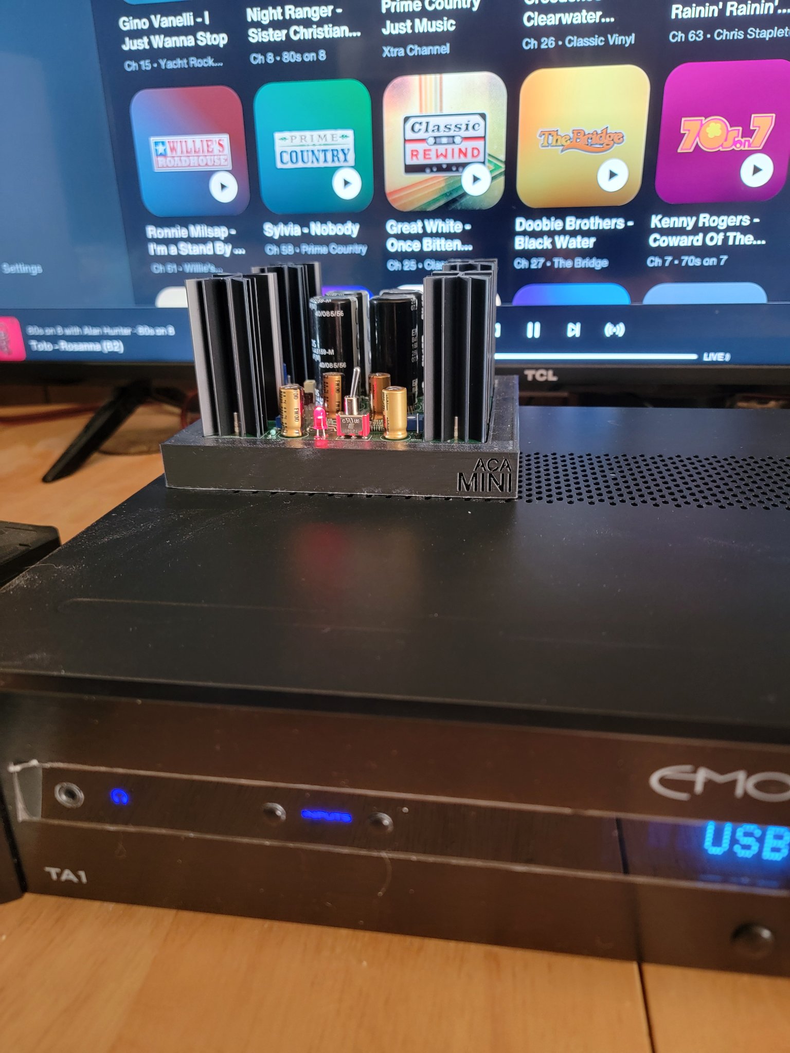

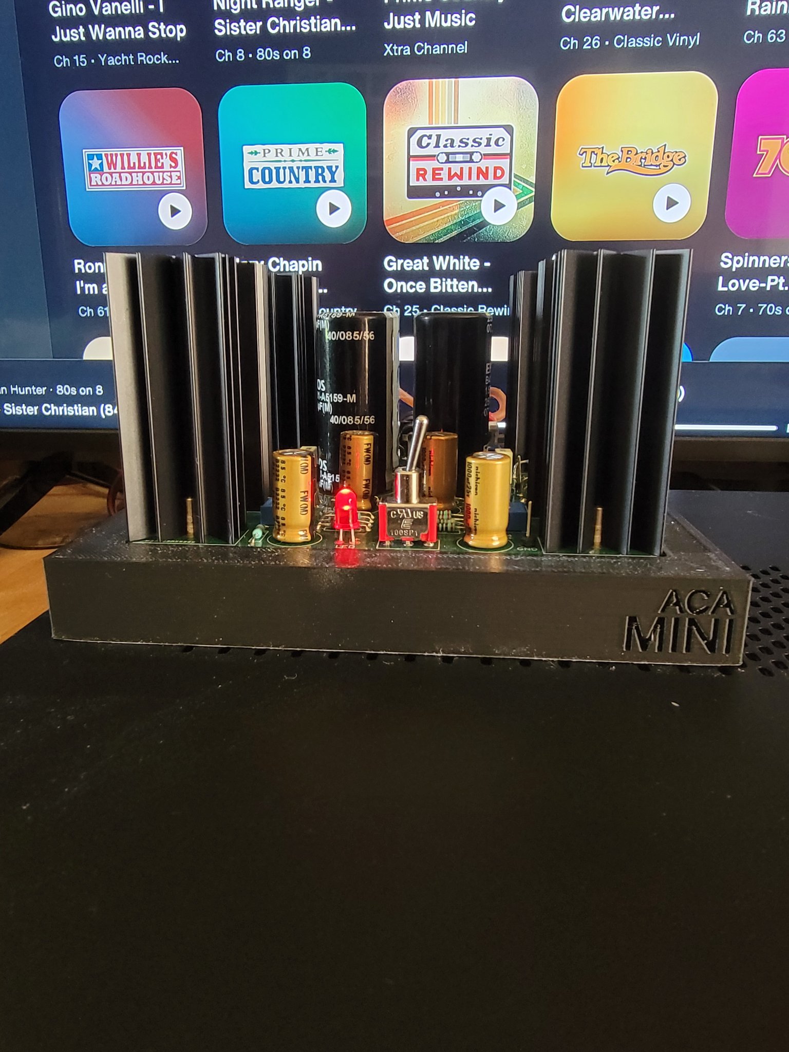

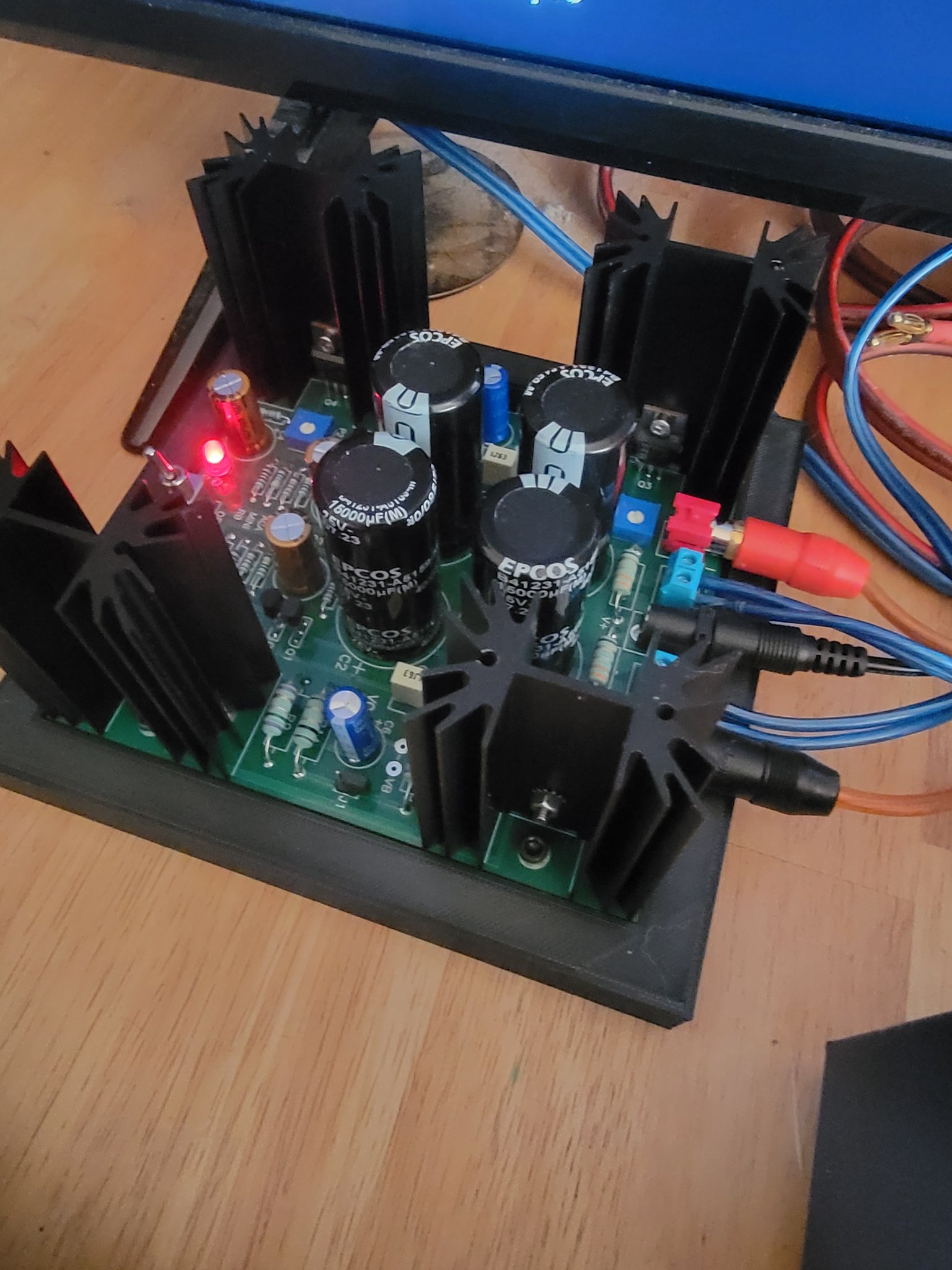

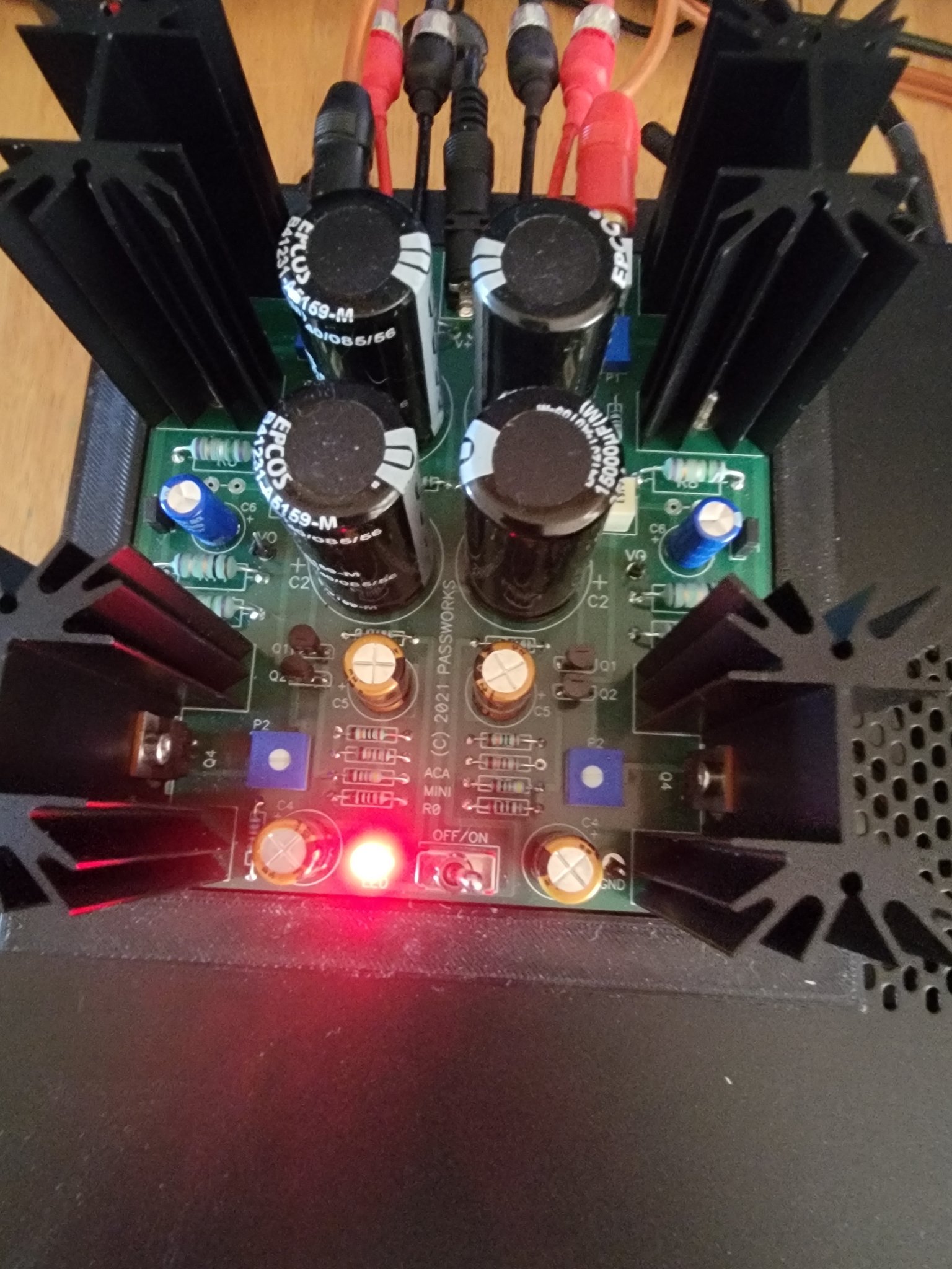

Just completed my Mini this weekend. NO issues...assembled...fired up...took about an hour and half or so to be happy with bias...approx 11.5 volts and .303 mV after about 4hrs of use first day. Today (Sunday afternoon) she's stable on those numbers after just one check..lol..after about 4hrs.
I'm sure experimenting is gonna be fun...but for now...on 6.5 inch 88dB 2 ways...Jumpers out...WOW!!
Special thanks to member tom1066 for a 3d print file for a base for it to sit on.
