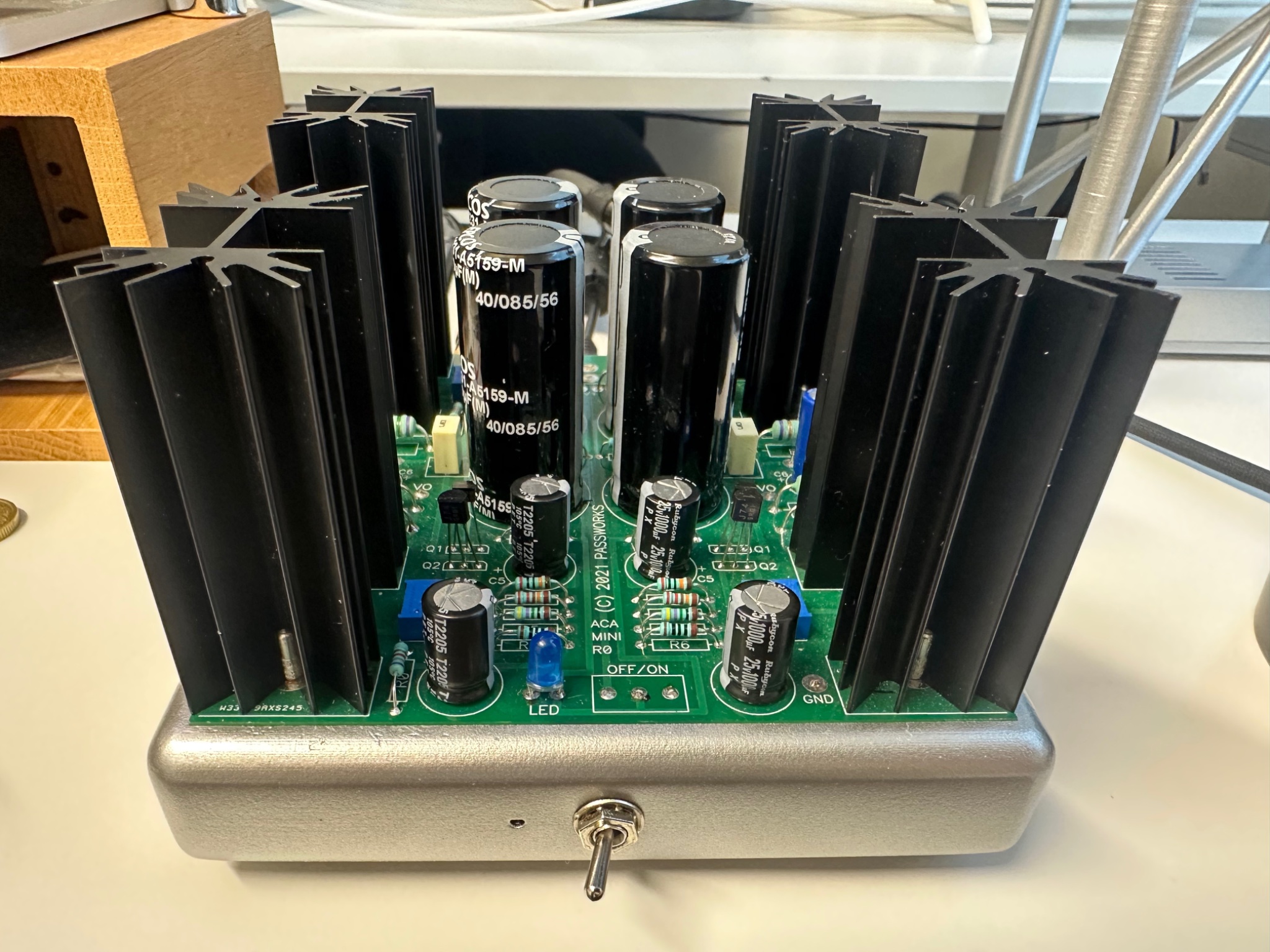

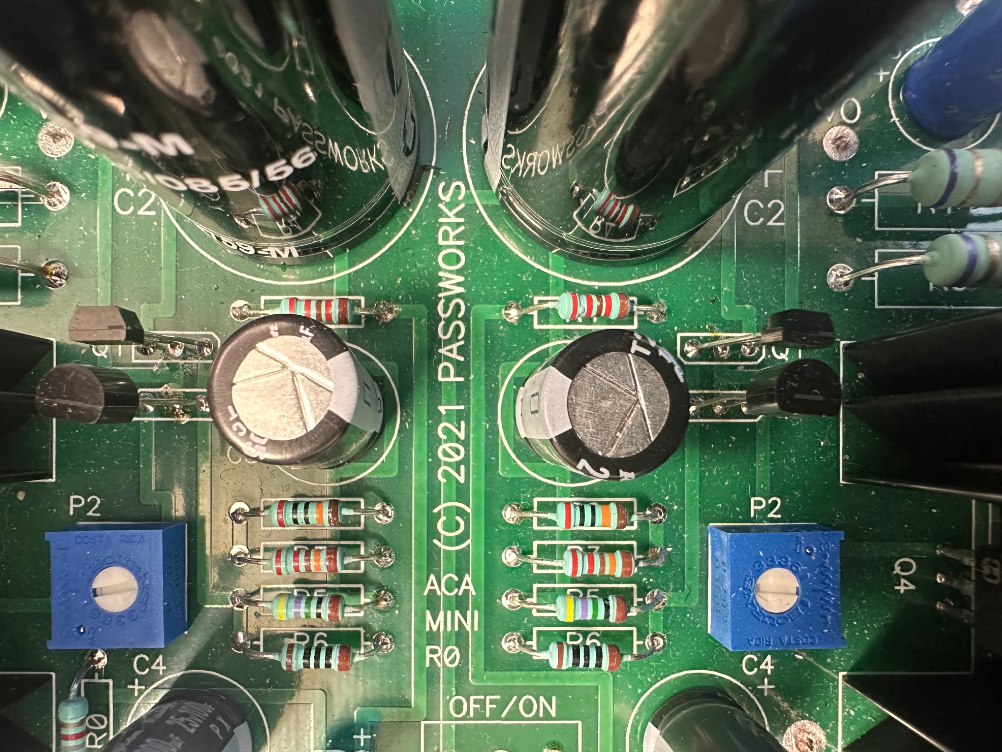

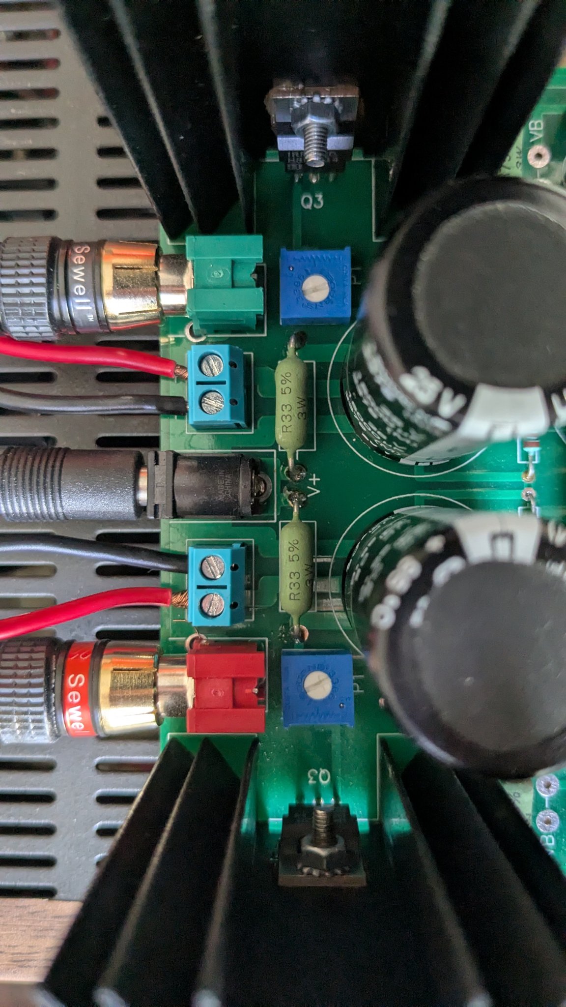

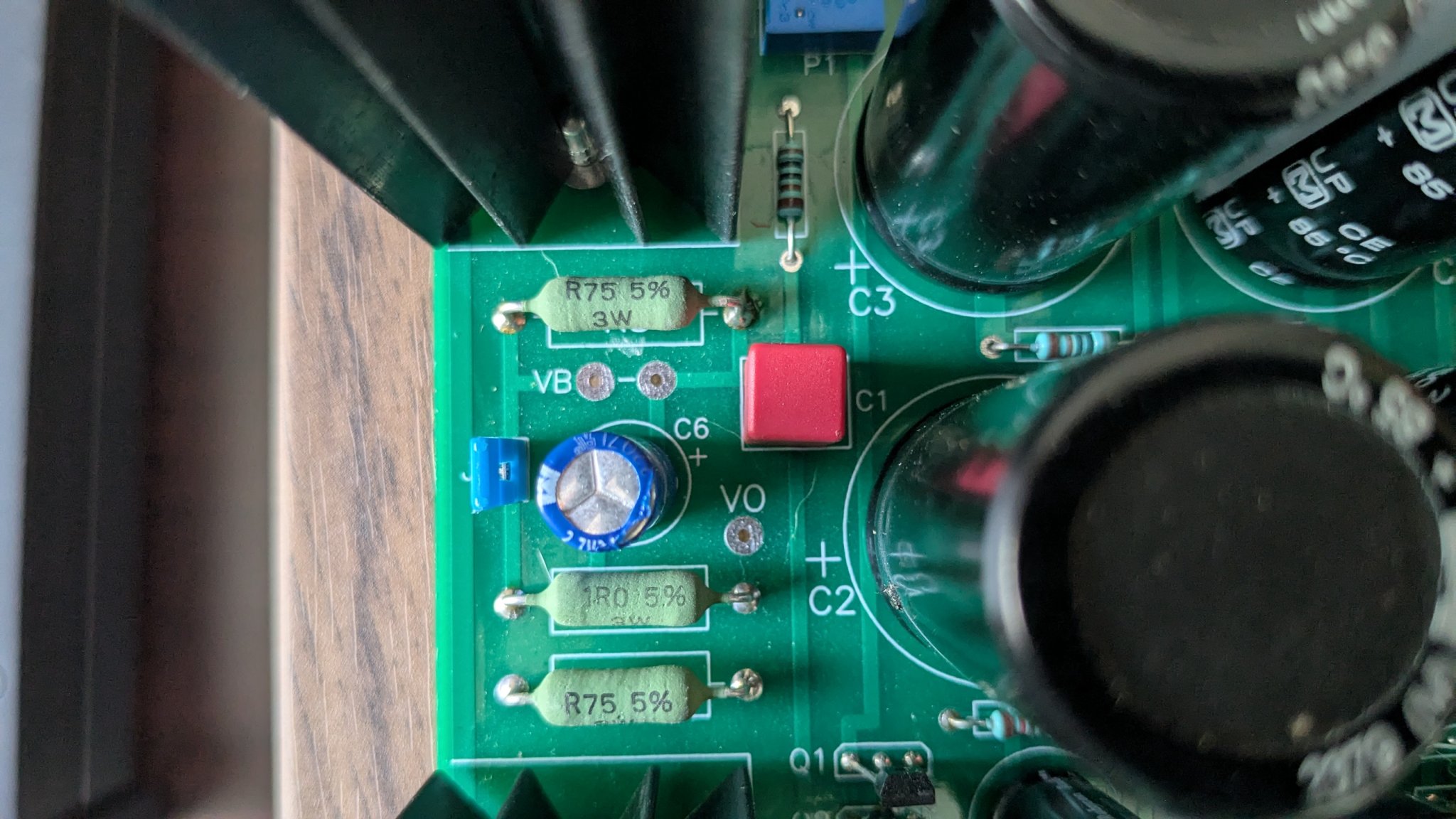

After enjoying the wonderful sound of my ACA Mini for six months, I just discovered—by pure chance—that Q1 and Q2 on the right channel are installed the wrong way around. The markings on the PCB and the build guide are crystal clear, so I honestly have no idea how I managed to mess it up.
I powered it down immediately and will of course flip them as soon as I can (this time without a glass of red wine next to me). But I have two questions that I hope someone here might be able to answer:
  1. How on earth has it still sounded so good with the transistors partially installed backwards?
  2. Could Q1, Q2, or any other components have been damaged, considering it's been used almost daily?

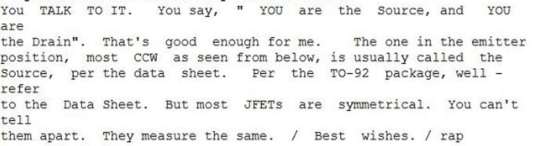

"YOU are the SOURCE, and you are the DRAIN".
But not persistently at the same moment. Either you behave like the source, your partner becoming the drain, or else. .
Well, isn't that a fine example of Schrödingers Cat? Being in two mutually-exclusive states at the same time?
And of Heisenberg's Uncertainty Principle, that you can't look at it one way while if you look in a different way, it would have a totally different characterisc?

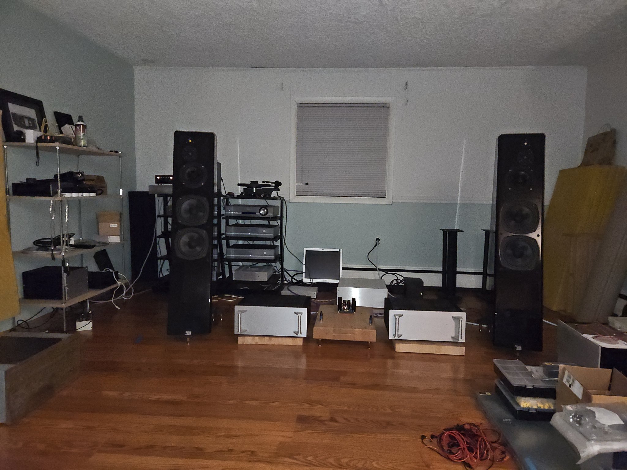

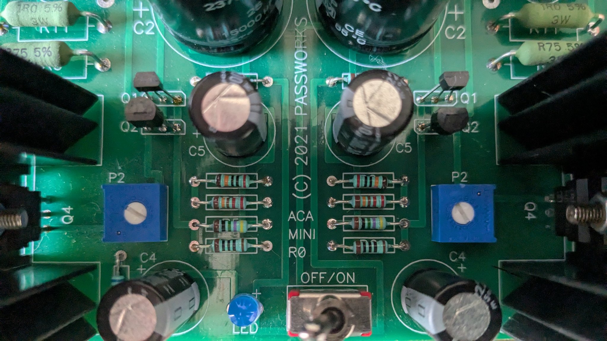

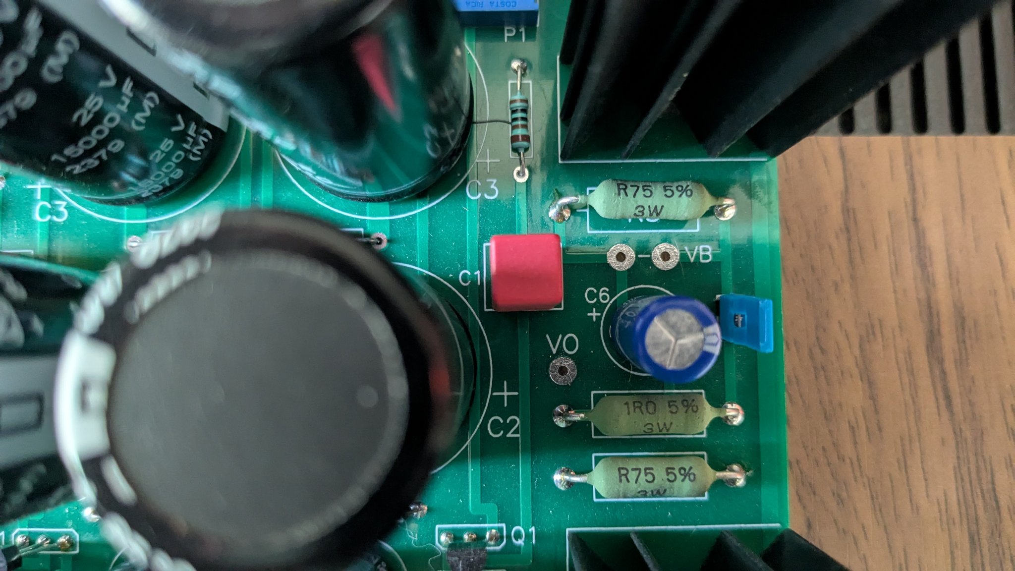

I've been out of DIY audio for 2 years until yesterday when I built the ACA Mini in 3h45m. Had bought the kit in the interim to keep busy but didn't get around to it until yesterday. With little prep it went together fast. Set the VO to 11.5v and VB to .35. Runs a little hot to the touch but the 5 second touch rule is not broken. First tried on Triangle BRO2 at 89db sensitivity. Sounded OK so moved over to Reference 3A Grand Veena at 90db sensitivity. It's mainly a 6Ohm speaker. ACA Mini did ok with simple acoustic music but got a little confused with more complex music. Understandable. Right now, I prefer the jumper off with less 2nd harmonic, but inevitably I lean toward warmer sound. 3rd harmonic always engages me at first but it fades. Get the impression of more control with jumper off.
Kit was missing 1 header and one of the jacks when RCA inserted pushed out the internal wiring. Neither are a problem, although getting a tiny bit of hum in channel with bad RCA. Moving circuit to a box eventually so not a big deal.
Question: I'm getting a little audible distortion. Would cutting back the bias help?
The ACA Mini is between the F4 monoblocks. 🙂
Thank you Mr. Pass and everyone for this cool little kit! 👍

The jumper position you have favours distorsions... but I find that suits the Mini very well, as it is intented with a specific choice of speaker family.
Indeed increasing the bias has positive effets on the sound but I found that 350mV or so was fine and going higher didn't bring big benefits... but increased the heat to a significant level.
Something that did audibly bring benefits and possibly in the direction of more control / firmness and more cleaness / less distorsions to my ears was adding the Murata coil to filter the SMPS (dead easy and plug in / out direct comparison possible "nearly on the fly") and further adding the bycaps I did.
Seach function is your friend, Birdbox offers a kit with all that in your country (low postage costs) plus sexy feet for 10 bucks...
Enjoy the Mini
