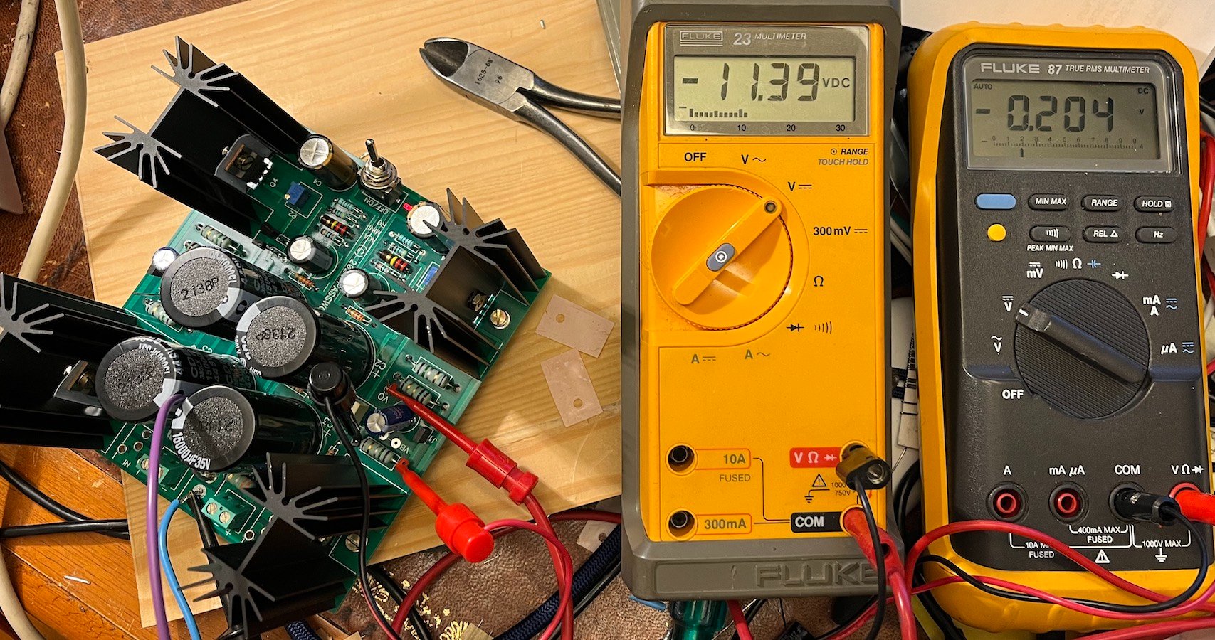

Finished my amp and left channel biased right up. But for right channel i'm fully CW on P1, and getting only about 0.2V on VB, 11.5 on V0. I've read somewhere it can help to solder a 1K resistor in series with the trimmer, to extend its range.
In the end i got both channel biased. Patience was the key.

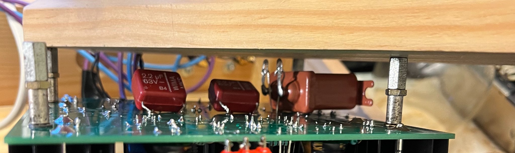

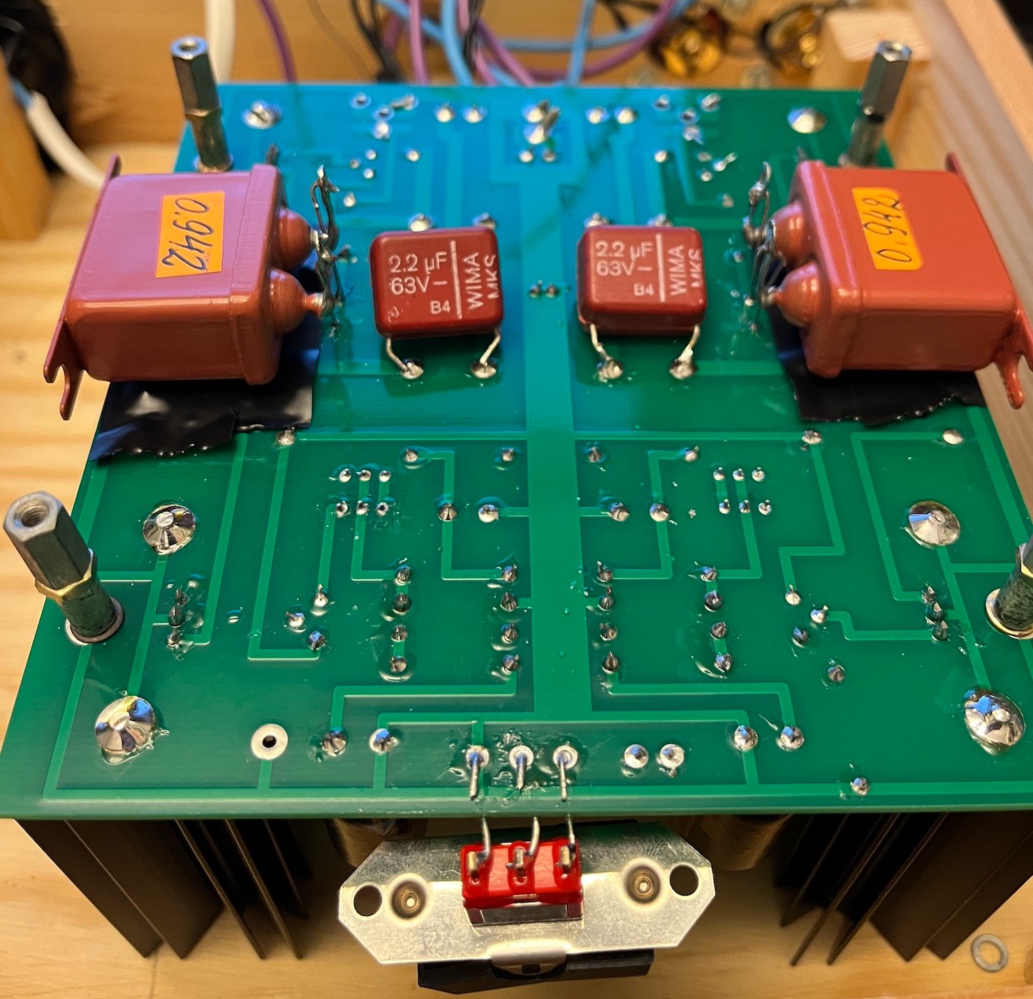

If you guys think i should make my own thread, please say so and i will. Until then i will keep posting about my little ACA Mini that's now a week or so old. I swapped out the stock C1 for some Soviet caps i had lying around, and scavenged a couple 2.2uF caps to use as C2 bypasses from an old amp. I checked that they weren't shorted and in they went. I thought this was the biggest improvement yet. There wasn't quite enough room under the board for the caps, so i put some extra risers on it. Mini on stilts.

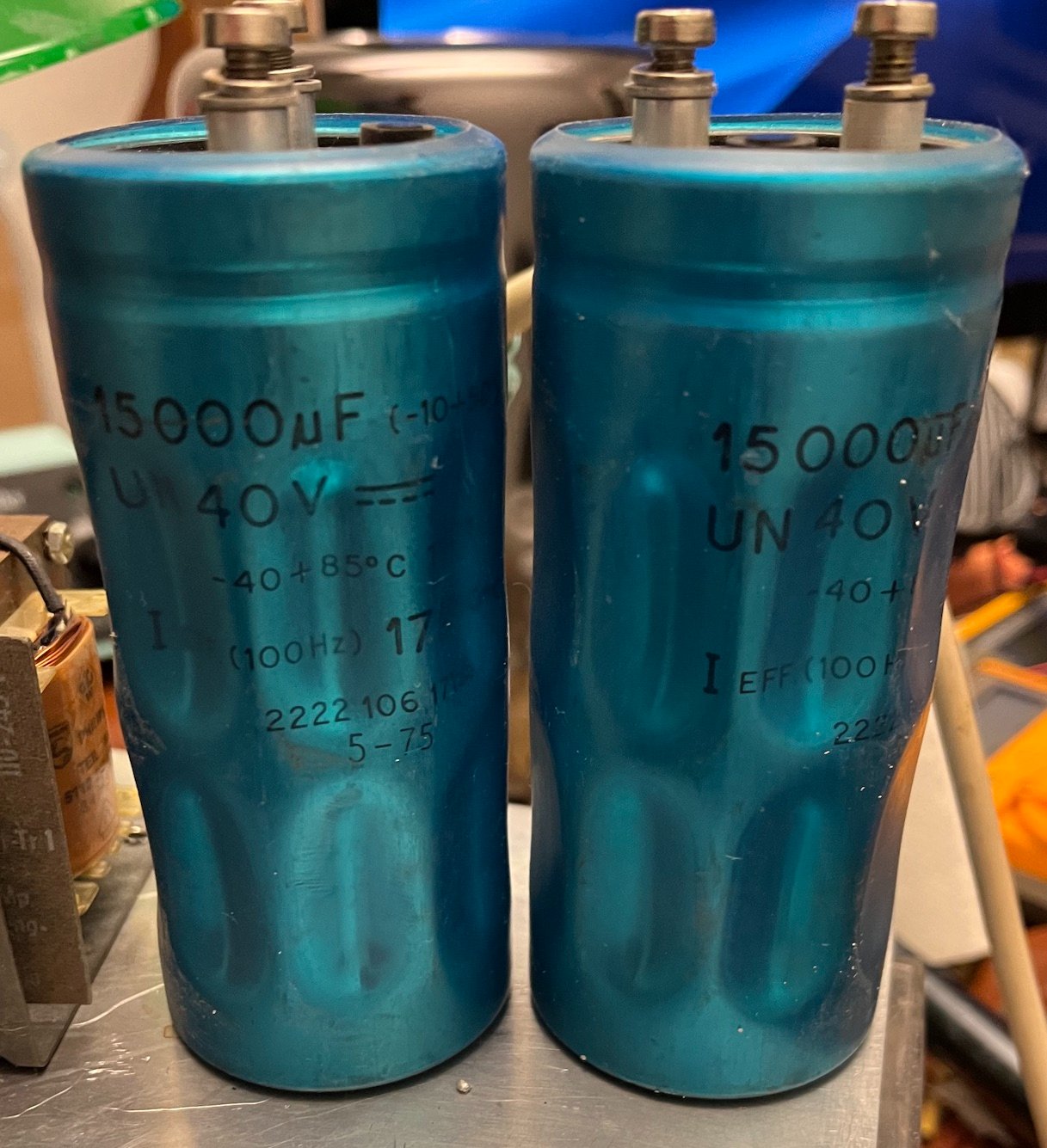

The Wima caps came from an old DIY amp i bought for parts, i believe most parts inside are from the mid-70s. It also happened to have a pair of huge beer can 15.000uF caps inside. I will try reforming them and assuming they take reform well, i view them as fully flight rated. Question then becomes, if you had to use them, would you use them in the C2 or C3 position, and why? Thanks folks!
