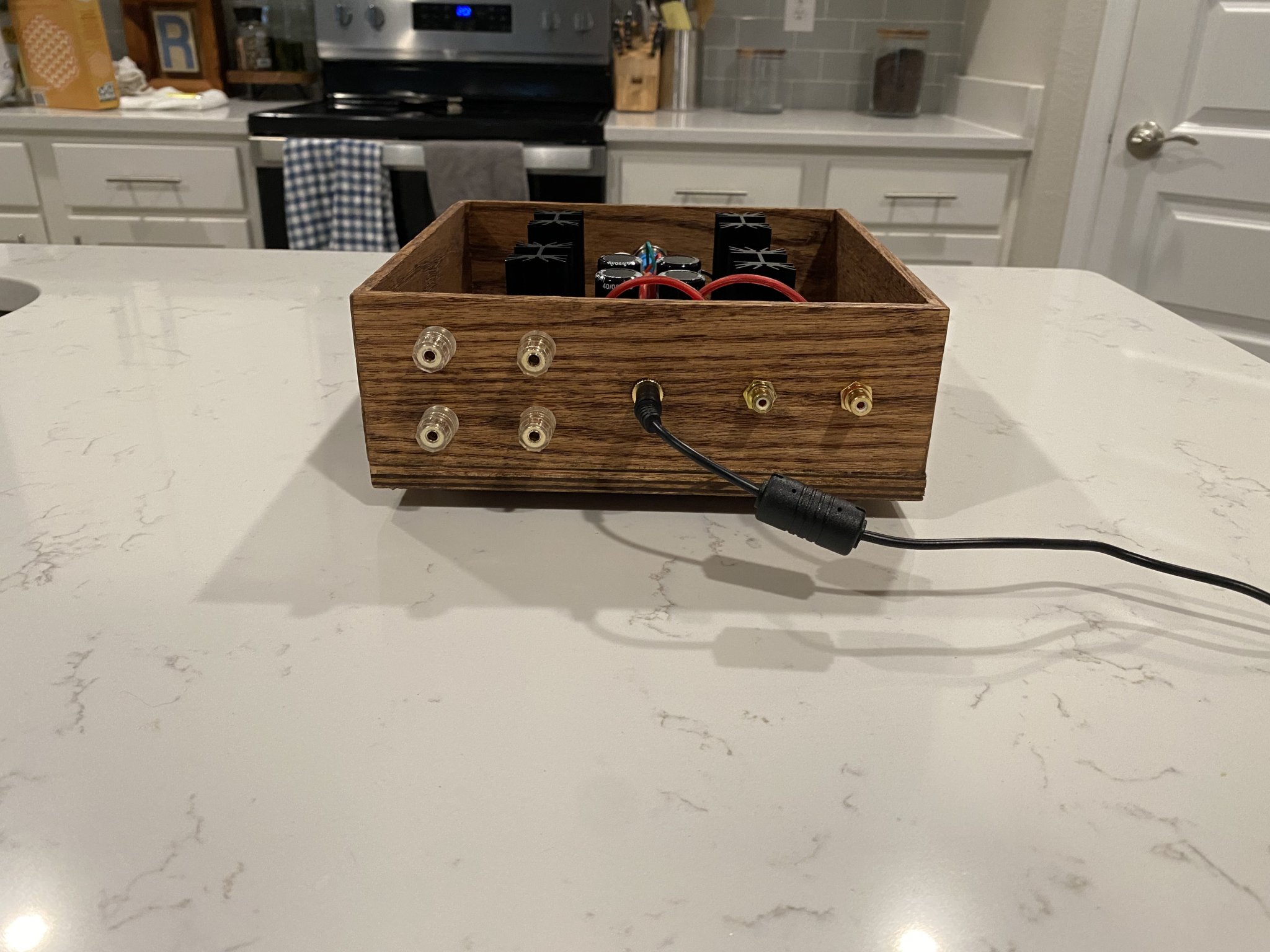

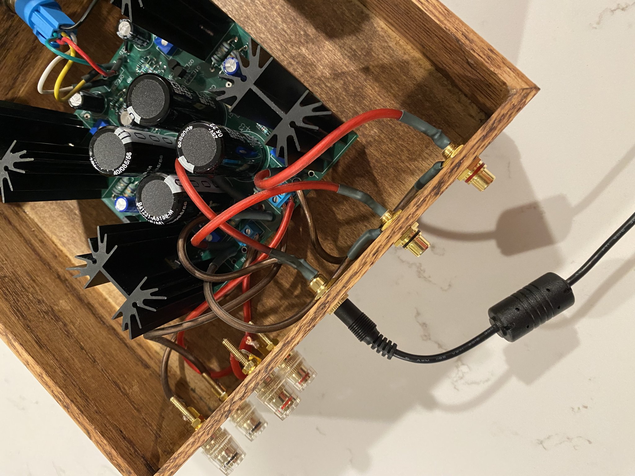

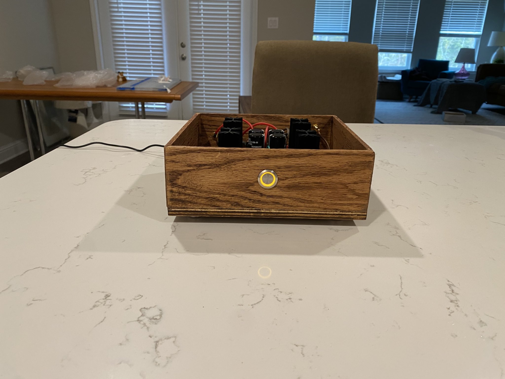

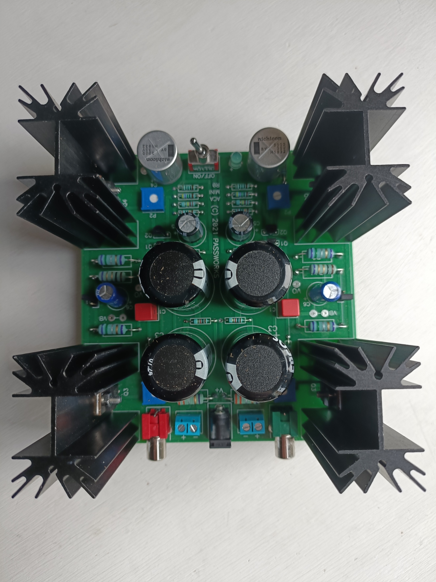

Finished!!!
Thank you everyone for their help! Especially @birdbox and @Nelson Pass
This little thing sounds incredible! It’s pushing my DIY coaxial cabinets with ease. The bass is much fuller than the class D amp I was using while waiting for this to finish. I am super satisfied!

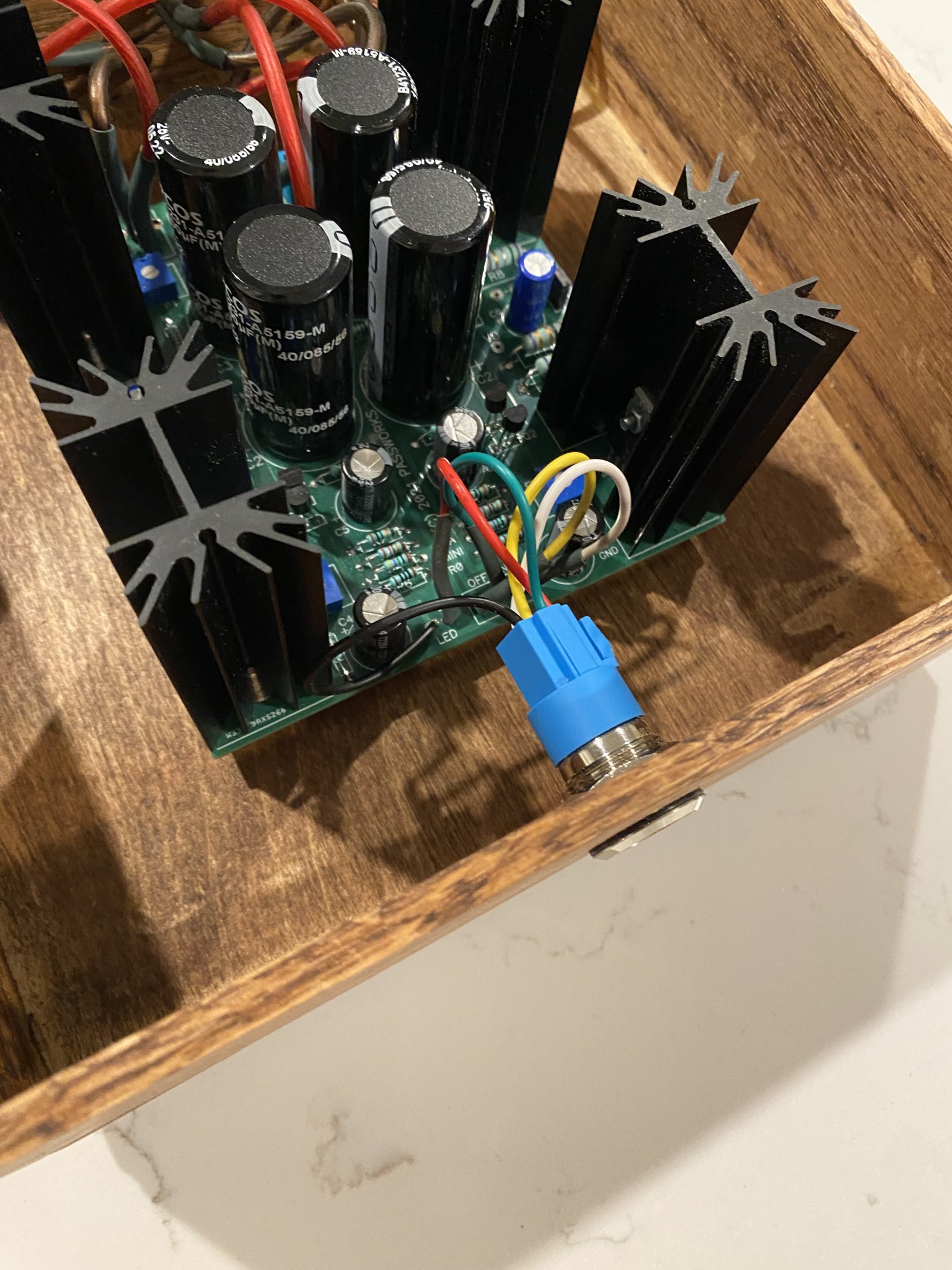

Turns out the wiring was opposite of what we thought. Push in to turn it on. Looks fine to me though 🙂

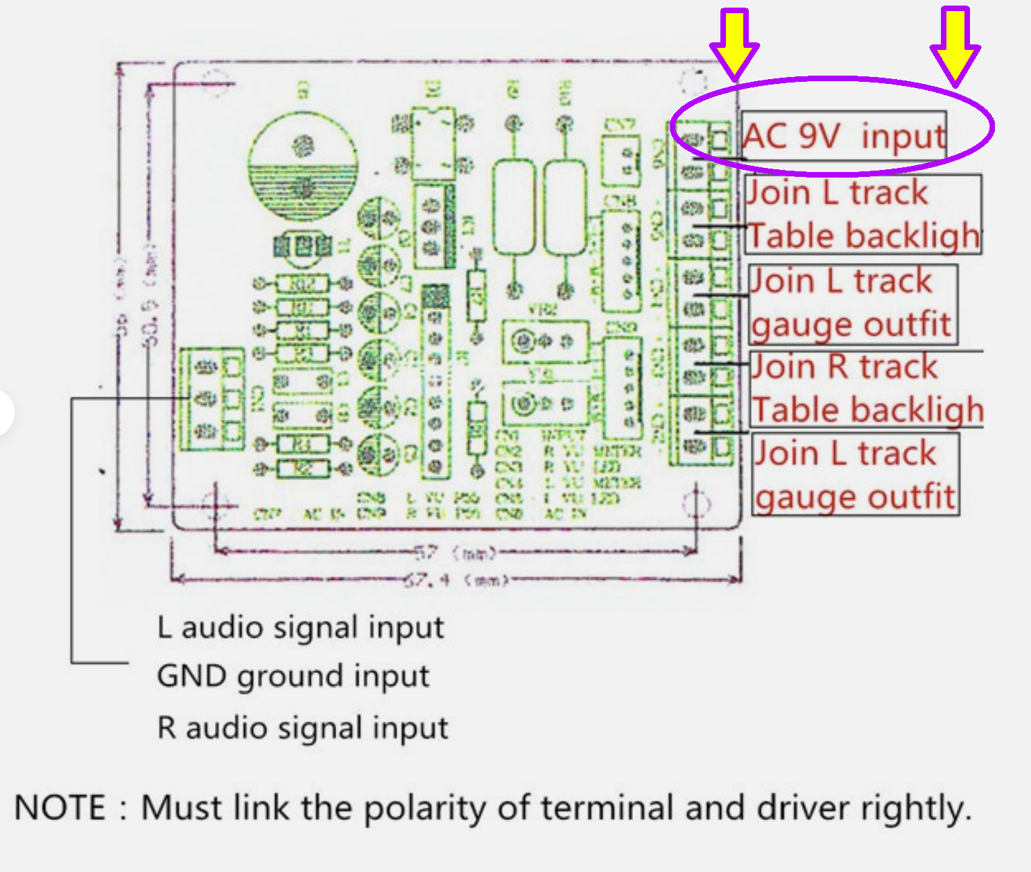

The eBay listing linked in post #3,063 has lots of attached images including the one I copied below. I'm not certain about it but maybe the board needs a 9V AC power supply to illuminate the backlight bulbs and to drive the meter needles (??)
It says "Please select AC12V/500mA AC power input". I'm guessing this means you would need to power this separately from the amp.
A couple of weeks ago, I finally put together an ACA Mini from the DIYaudio store kit. It was super easy—no more than an hour to assemble and another hour to get the bias stable. The trickiest part was adjusting the potmeters, as even the smallest change had a big effect. Next time, I’ll definitely go with 10-turn potmeters for more precision. But overall, it’s been running smoothly for weeks now, so that’s really just a one-time thing.

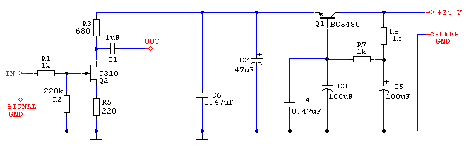

I’m using the ACA Mini as a tweeter amp for a pair of compression drivers, after reading a lot about its treble clarity. I knew it had low gain, but I wasn’t expecting to need to turn up the gain on my crossover to +5dB to match the midrange. Normally, I’d set the gain to around -10 to -12dB with my other amps, so that’s a 15-17dB difference. This suggests the ACA Mini only has around 10dB of gain, which is lower than I anticipated. I thought the gain was closer to 15dB, but I must have misread that somewhere.
I believe the low gain is contributing to the lack of dynamics. I’ve experienced this with other low-gain amps before, and adding a gain stage really helps bring out the "drive," which seems a bit lacking here when compared to my Hiraga amp. Out of the box, the Hiraga just sounds better—not just because it’s louder or more powerful (since 1 watt would be plenty for my 110dB/w drivers). I’m not using a preamp—just a DEQX crossover with a max 2V output. That’s enough to drive the ACA Mini to clipping, but a little extra gain would give it a bit more authority.

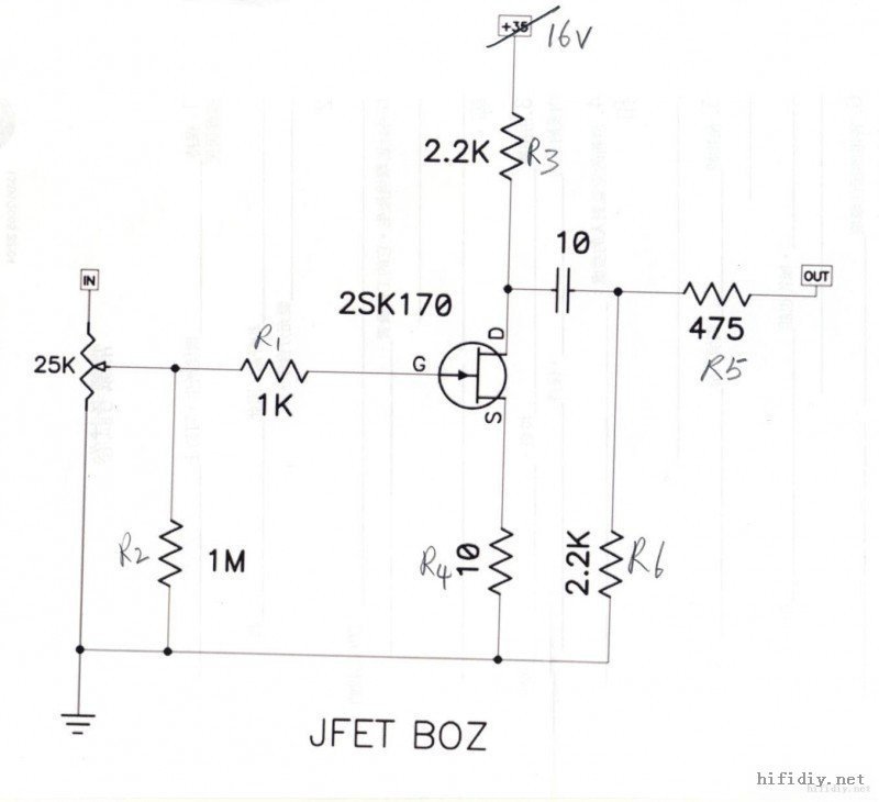

Does anyone know of a simple Class A gain stage that could run off the same power supply? I think an extra 6 to 12 dB would really bring the ACA Mini to life. It sounds great—sweet and clear—but it could use a bit more punch!
