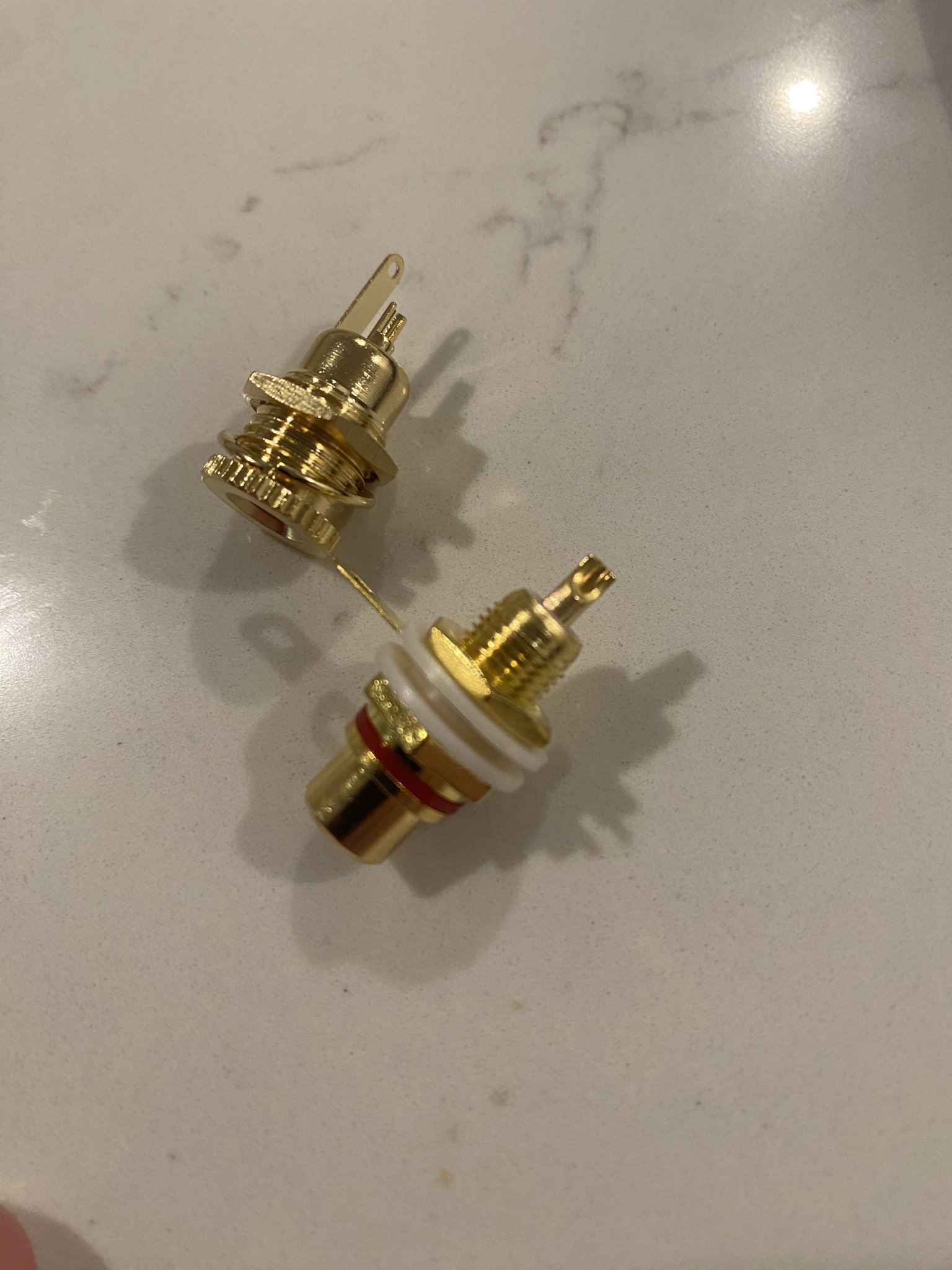

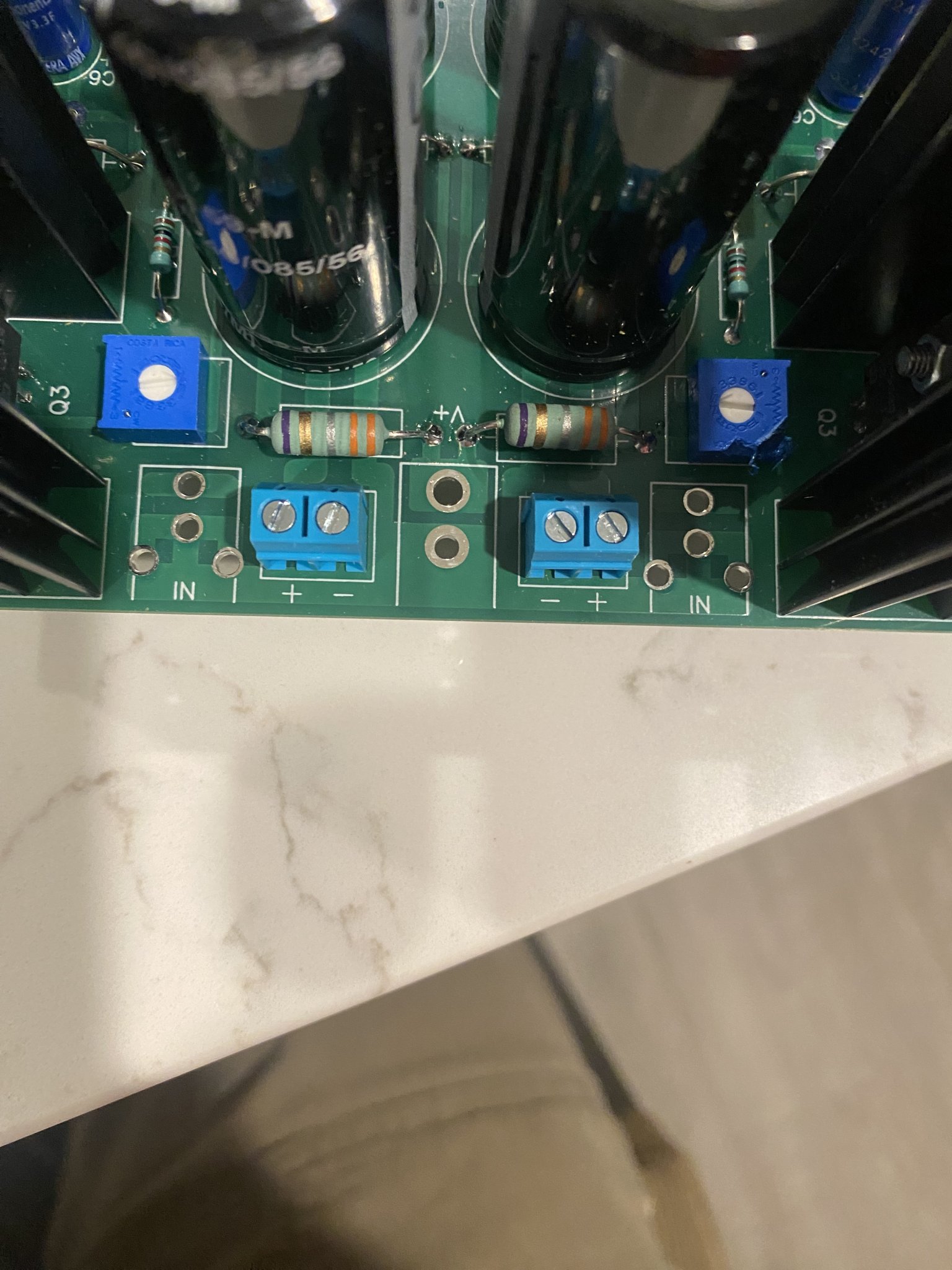

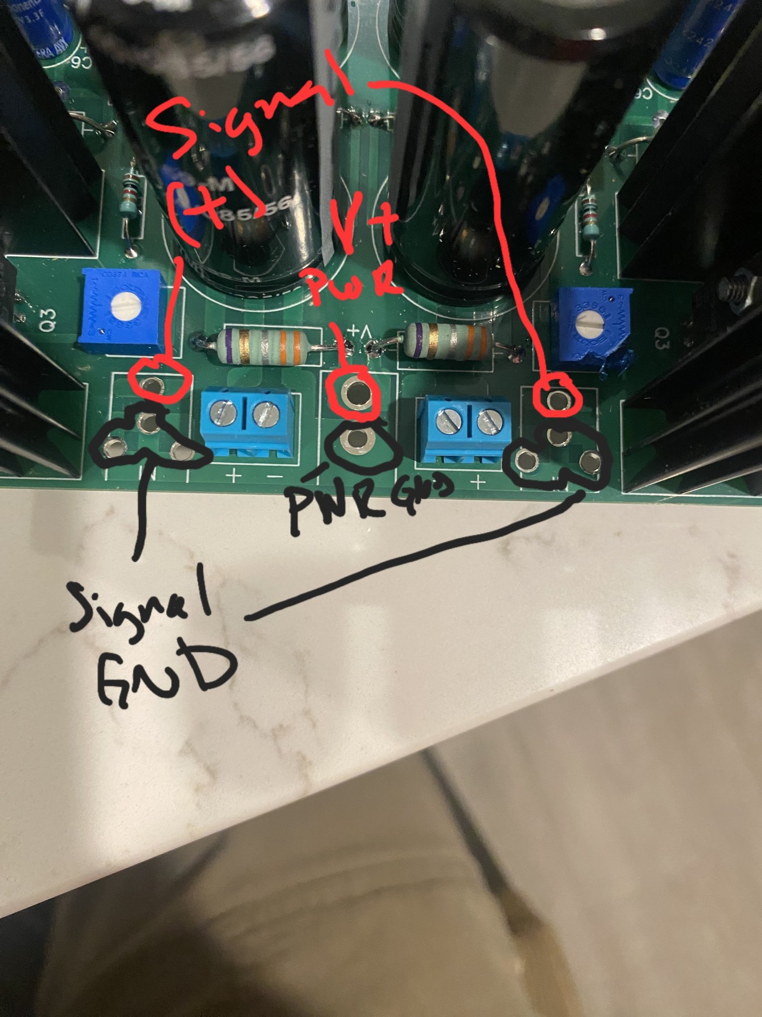

Alright I am back on track. New MOSFET is installed. Now onto my modifications…I am going to build a simple base and walled enclosure where I will mount binding posts, rca jacks, DC power jack, and led switch. I have a couple questions I would really appreciate your input on:

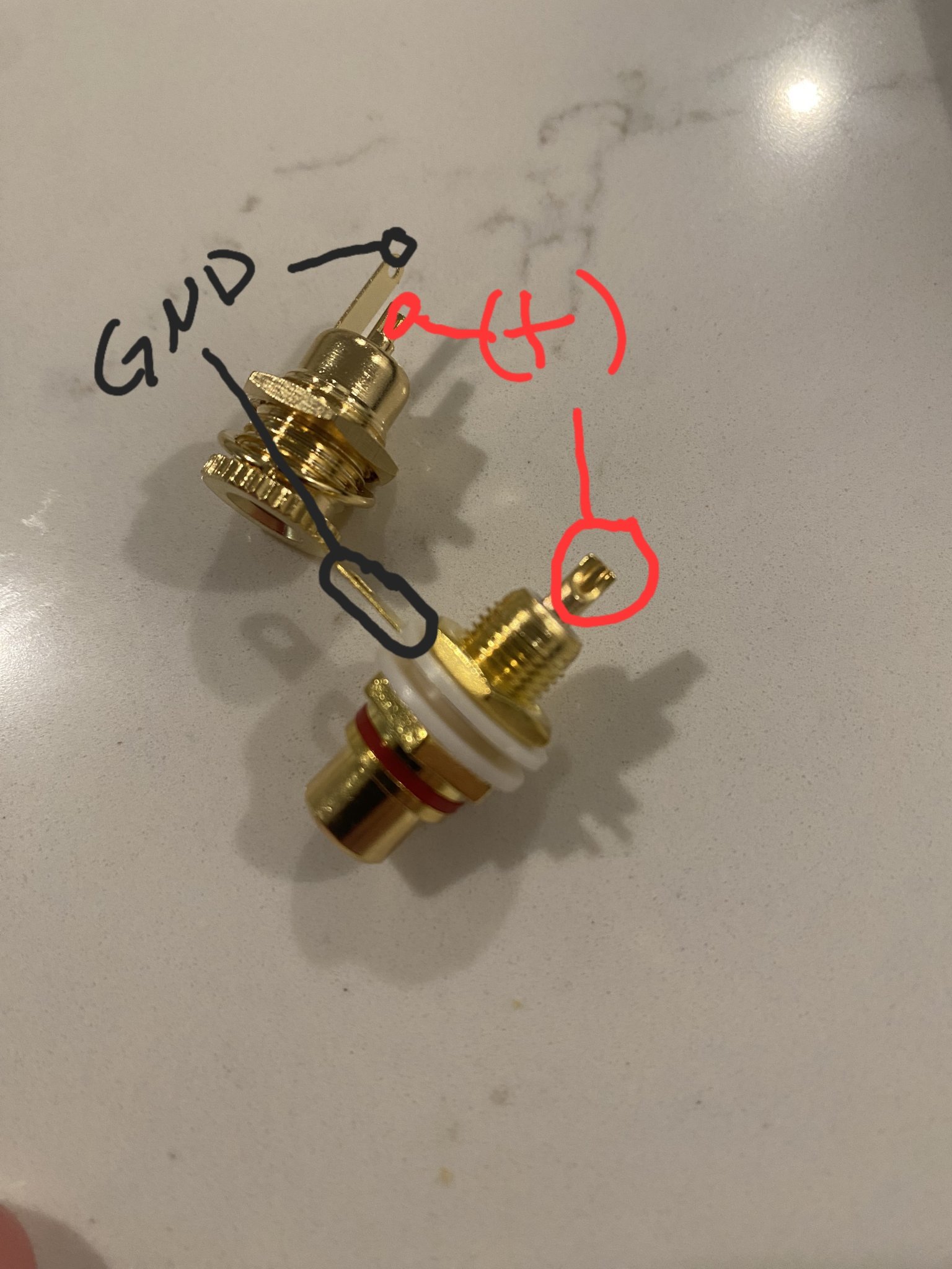

1. These RCA and power jacks…is the the inner post positive and the outer solder tab ground?
2. Can you tell me which hole (top or bottom) is positive and which is negative for both the rca input and the dc power input.

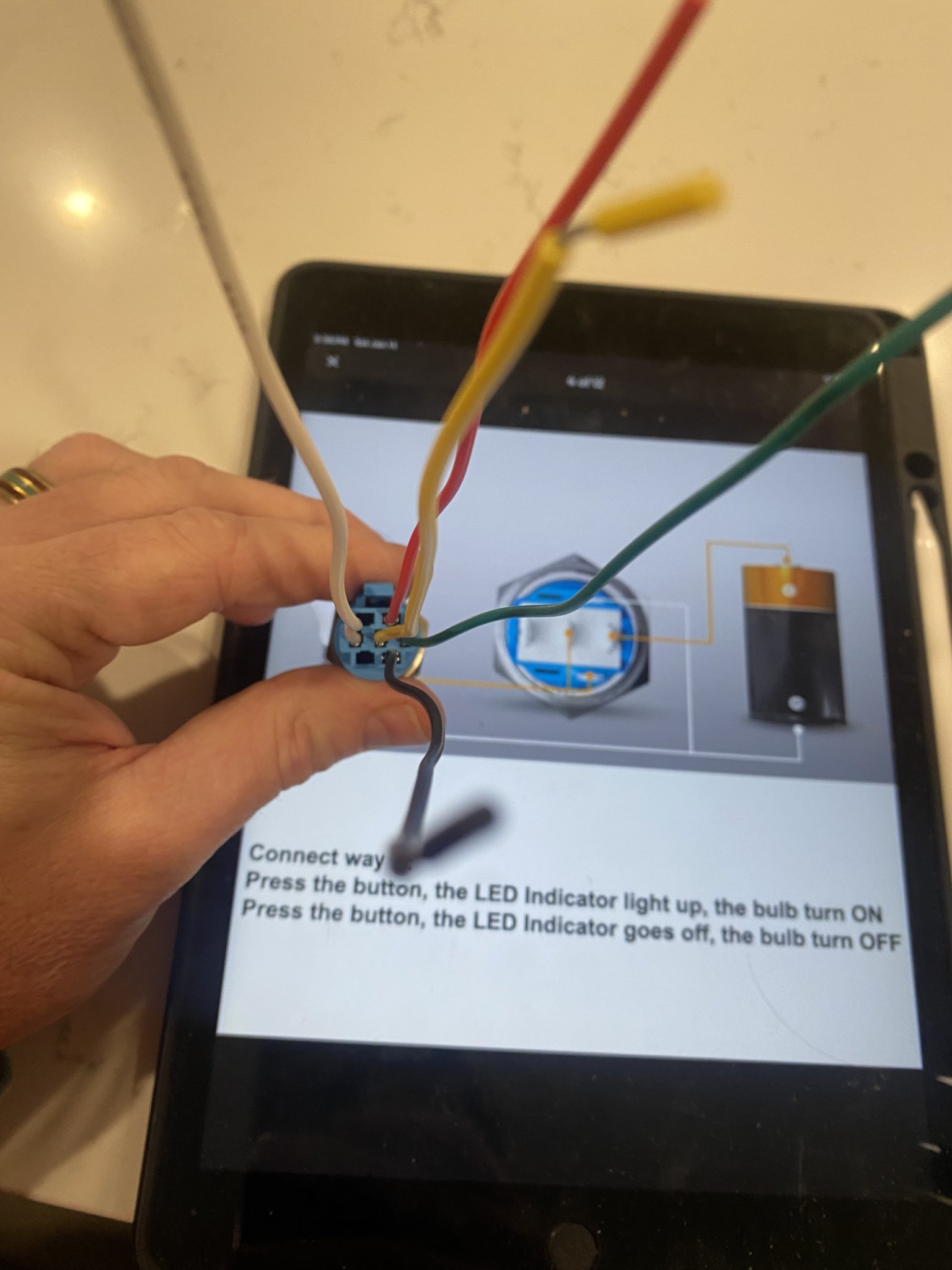

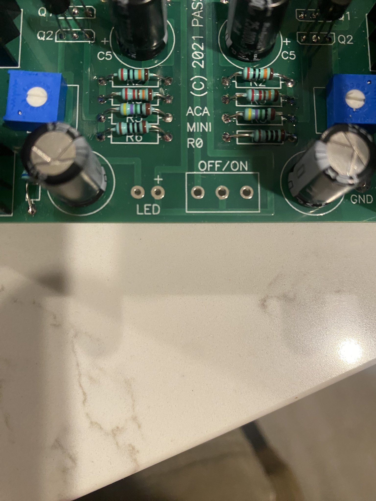

3. Please help with the led switch. It is a 5 wire so I am assuming it’s three for the switch and two for the light. Can someone help me with where each wire goes?
Thank you so much.
Thank you so much.
1) Center pin signal positive as you stated.
2) Ground vs Positive for power in and signal in.
3) Red and Black are LED power, to the two LED holes. Be sure to get red to anode location marked "+".
Yellow and green are the switch scheme listed. Where as green and white would be the opposite switch scheme. Use a DMM to verify what scheme you want...(button "In is On" vs button "Out is On").

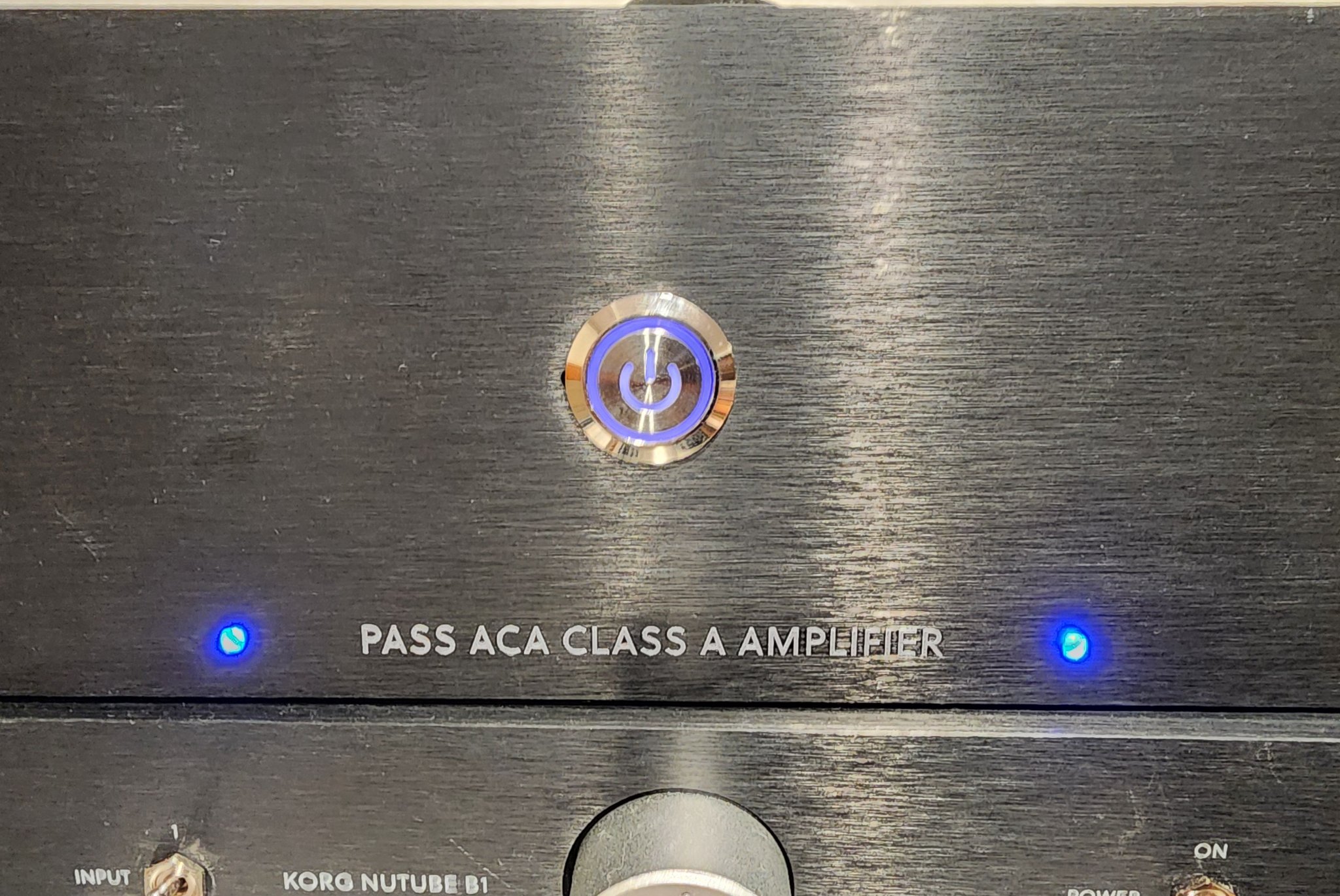

I actually prefer button "Out is On" as I think it looks better when it lights up, however it's slightly counterintuitive as typically (or more common in my experience) button latched in would be on. Here's a picture of button "Out is On"

Ok so for the scheme listed red and black to led holes, then green to right hole, yellow in the middle hole, and white in the left hole. Is that correct? Thanks again!3) Red and Black are LED power, to the two LED holes. Be sure to get red to anode location marked "+".
Please can you share the part number and source of the illuminated push button switch?
cheers
cheers
https://www.ebay.com/itm/4044047079..._feznoasuu&var=&widget_ver=artemis&media=COPYPlease can you share the part number and source of the illuminated push button switch?
cheers
19mm 12V LED ON OFF Push Button Power Switch Latching with Wire Socket Harness

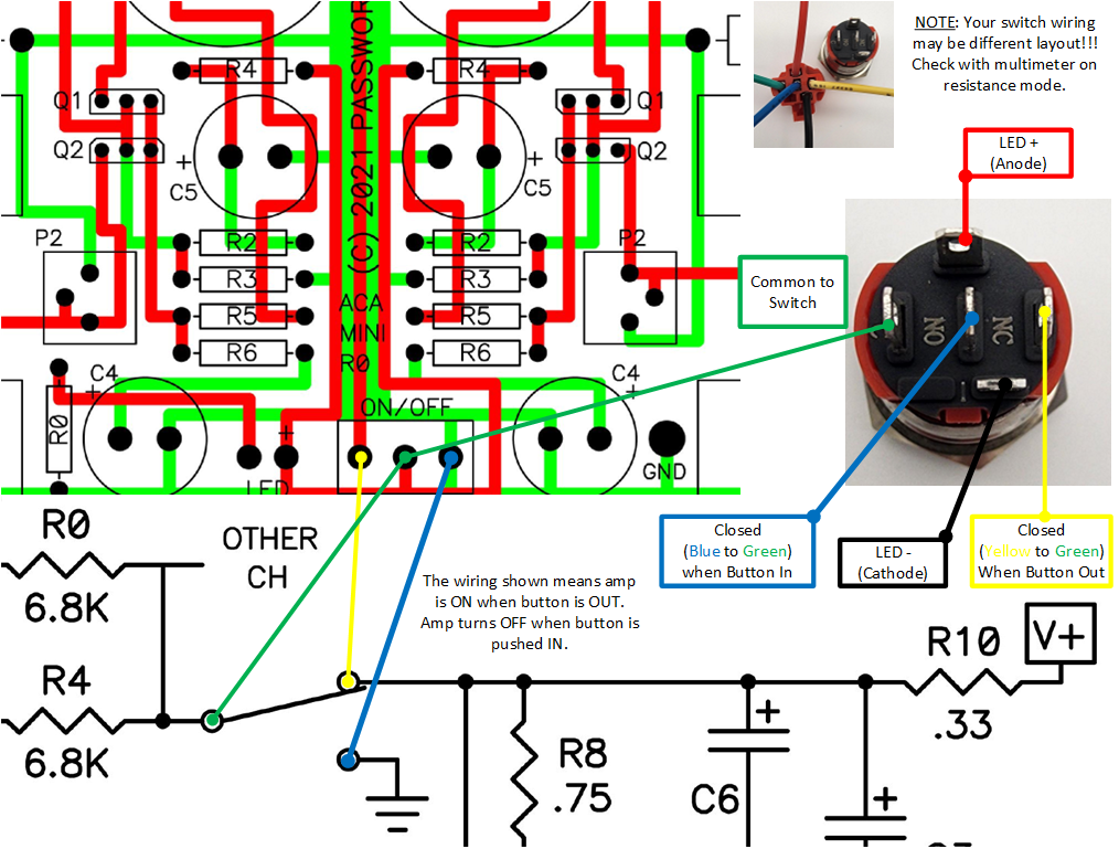

I'll let BeardyWan respond about the switch. I keep second guessing my diagram in fear I'll provide the wrong information.
Apologies, I was actually just interested in the switch. I hadn't realized I had missed a question.
Ok, here's what I put together for the switch I have. Your switch may vary and you can simply figure it out using a multimeter on resistance mode and check the three wires (yellow, green, white in @ross51681 post). Note that the common is the middle of the three switch holes. One of the switch positions connects V+ to the common, while the other position connects ground to the common.
Even if this is wrong (which I hope it isn't), it gives the process of using the schematic, diagram, and switch instructions on how to figure it out. I'll let the experts make the corrections to my errors.
