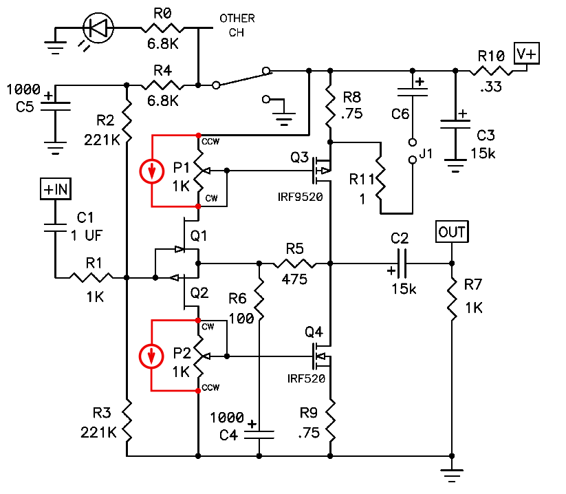

Two pins are for the LED. You'll need to add a resistor for the LED if you tap directly into the 24VDC (typical rule of thumb is 1k-ohm for ever volt, then adjust up/down from there for brightness preferance). So you'll need a 24k ohm resistor for "nominal", 18k ohm for "bright", 30k ohm for "dimmer", or anything in between.

And an idea:
This brings to mind another idea, if we place a small CSS (1-3mA) in series with P1 and P2 we can get a little more open loop gain because the pots need to be turned up higher. The CCS needs to work with as little as 3V across it. For example, a ccs diode like E-202, Mouser Part #954-E-202 or if we used a jfet as a ccs we could trim its source resistor and leave P1 and P2 as fixed values. Would it improve the sound, I don't know.

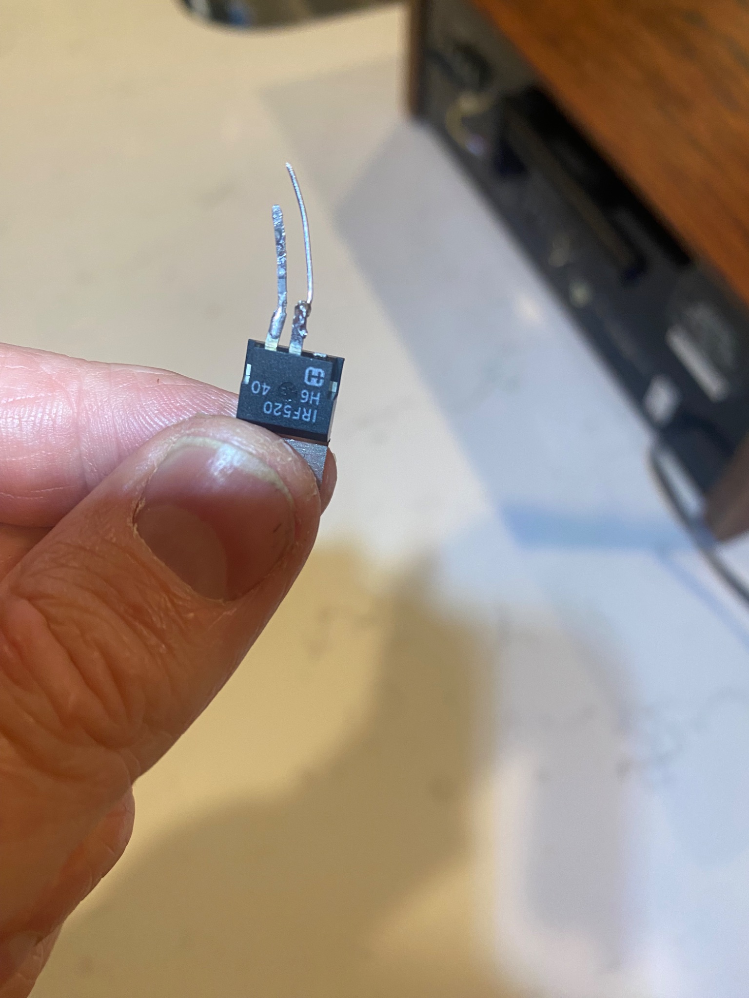

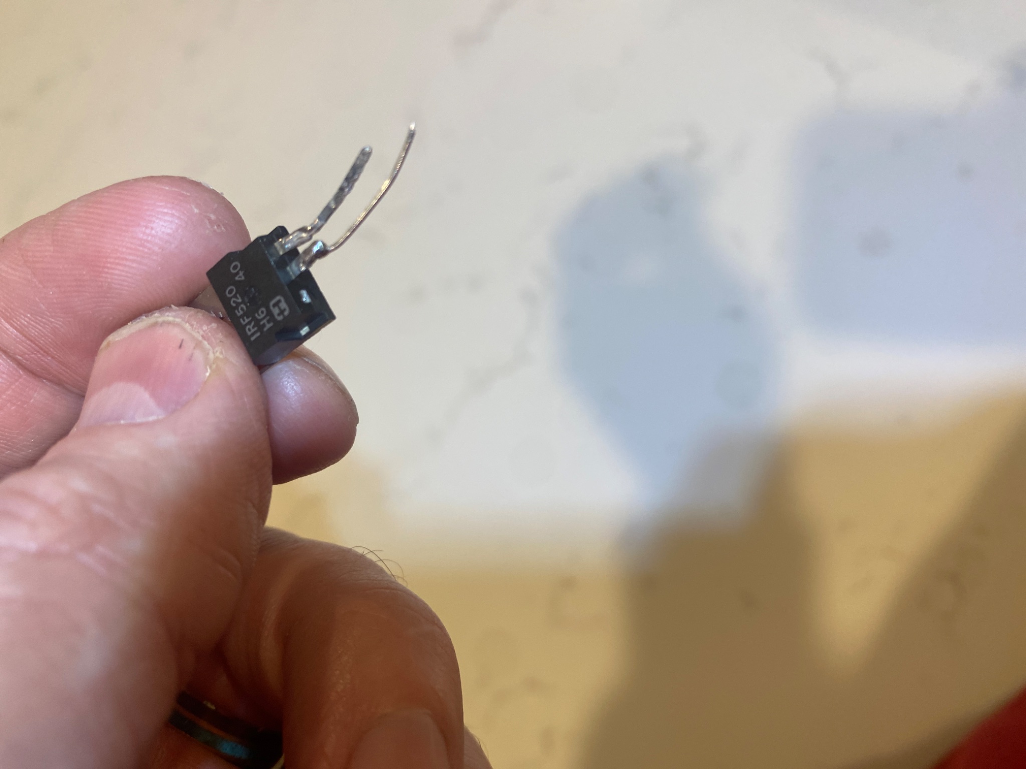

I broke one of my IRF520 MOSFET’s. 🙁
Can someone link me a correct replacement. I see more than one with that part number

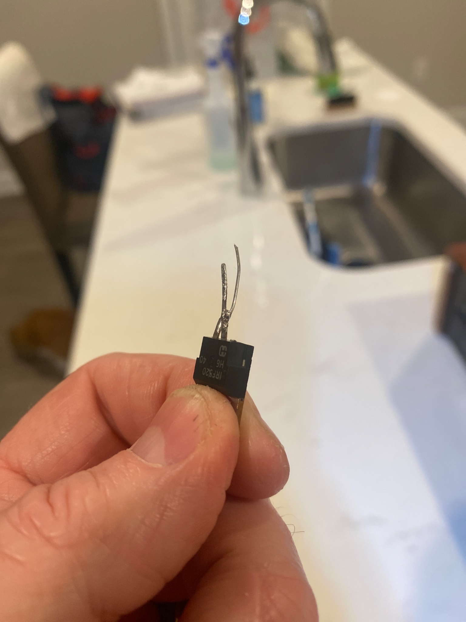

I’m now seeing how they include matched pairs in the kit. Did I screw this up badly? I broke it while desoldering since I installed it in the wrong side…I really hope I don’t have to do that again. I could possibly try and repair the broken lead using a piece of a trimmed resistor lead.I broke one of my IRF520 MOSFET’s. 🙁
Post a good resolution up close picture @ross51681
The experts will tell you what's the best path forward. You may be able to use one of the 3W resistor leads you cut off to bridge the broken lead to the thru hold in my humble opinion.
