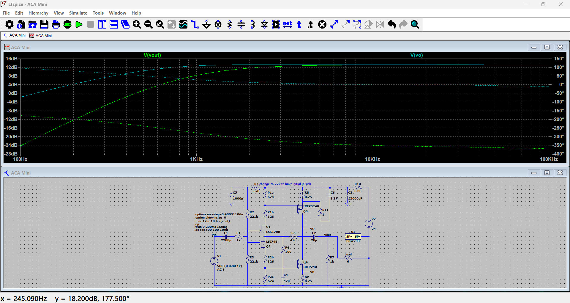

This reminds me of a question I have - if using a line level crossover, do people us a series cap to protect the tweeter too, or is the tweeter safe?
I was wondering if it would be an upgrade to replace the 15000uF output capacitor with a 10~20 uF film capacitor since I will only use the amp from 3kHz on up, or does this only screw things up?
What sort of impedance is the compression driver?
@Stanislav is correct saying that the input cap should really define the response to a large extent.
This assumes 6 ohm impedance and has just 2200pF as the input cap, 47uF as the feedback return and 20uF output coupling cap. For 6 ohms 20uF looks to small to me as it is still playing a big part in the response here.
Vo is before the 20uF cap.

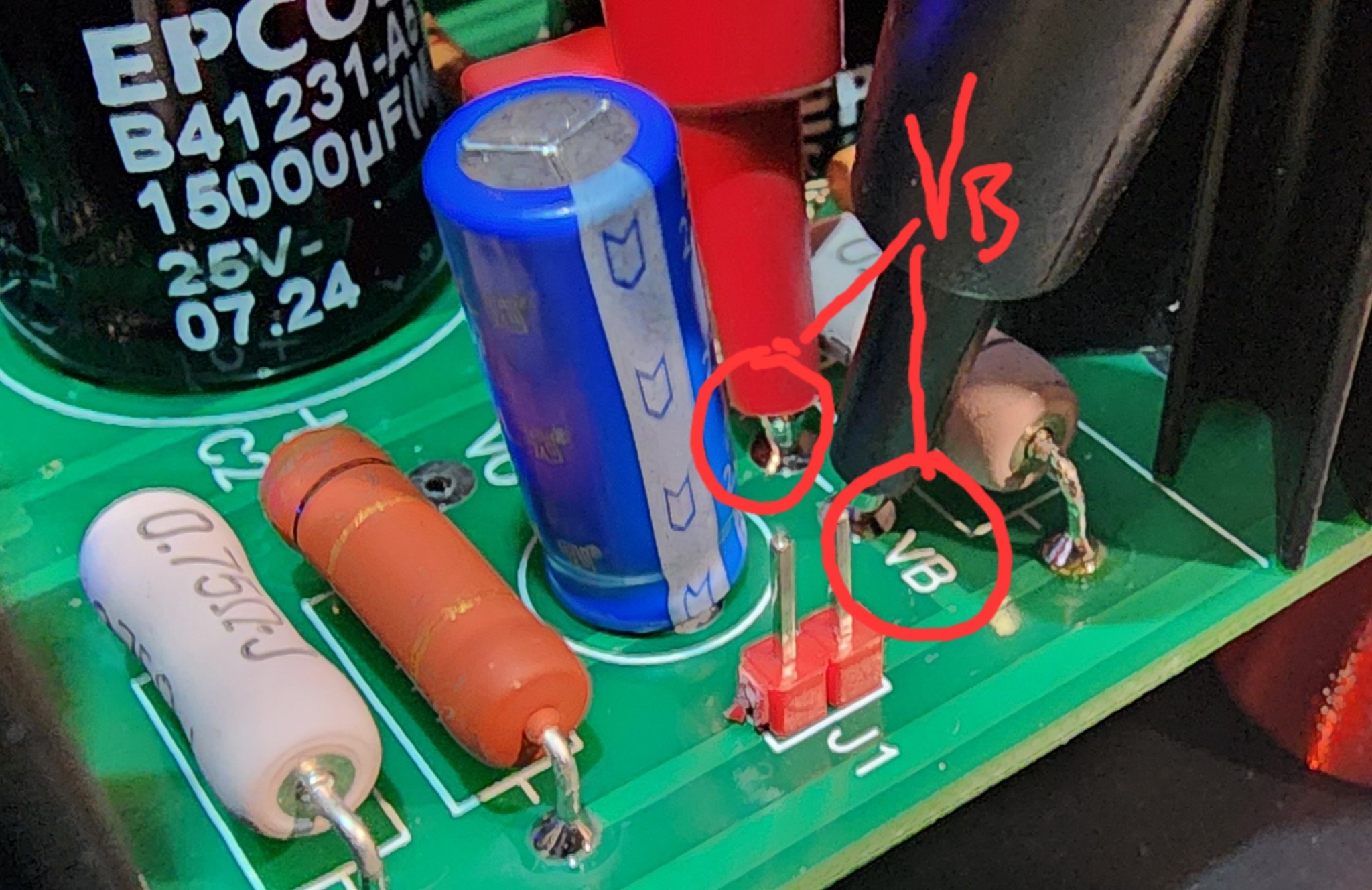

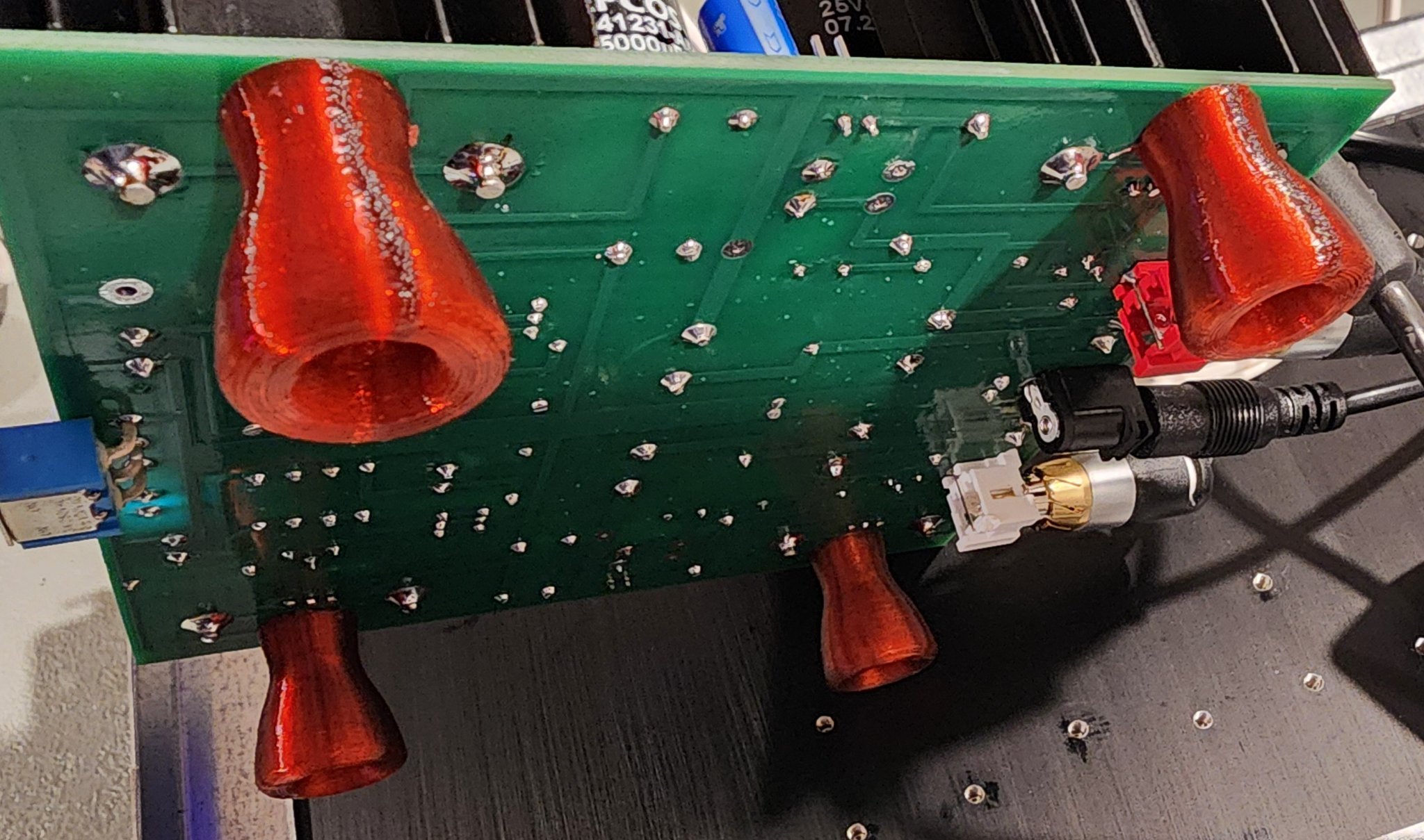

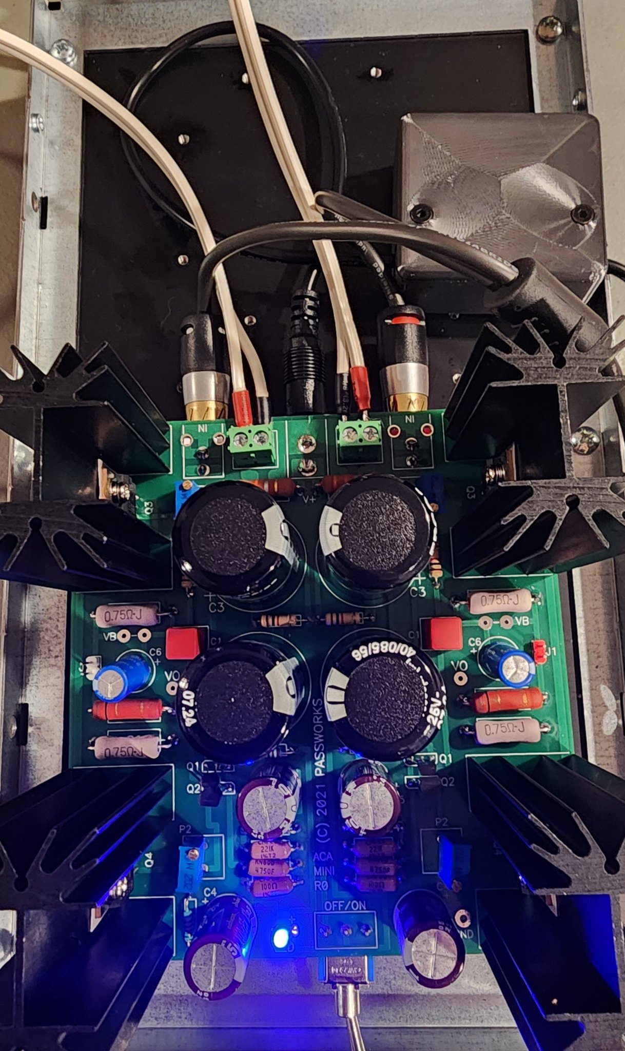

I finished up my seventh ACA Mini last night (I like to give as gifts to family and friends), but ran into an "issue" around 2AM so I didn't get music playing until today. Now it's all dialed in with Vb = 0.35VDC and Vo=11.5VDC on both sides. I used 25 turn pots on this one, and I do like the fidelity it provides. However, they did help exacerbate the issue I ran into, which will be covered shortly (sneak peak...it was user error).
First, let me just say, every time I hook up an ACA Mini and play some tunes I am just absolutely amazed. On this go, I am running it with some old ADS L470's, and they are just making sweet tunes. Bass is actually pretty good on these speakers. As those who have heard this amp know, the mids and highs are unbelievably good. It's gotta be the simplicity and size that makes it so mind blowing that it can sound this good. I'll just end now with it's still one of the best sounding amps I've heard. (Thank you Papa!)
I'm currently using with @ClaudeG's suggested Murata coil in one of my fancy 3D printed boxes. I haven't done a fair AB comparison with/without the coil, so I can't comment on if there's a noticeable difference in sound yet.

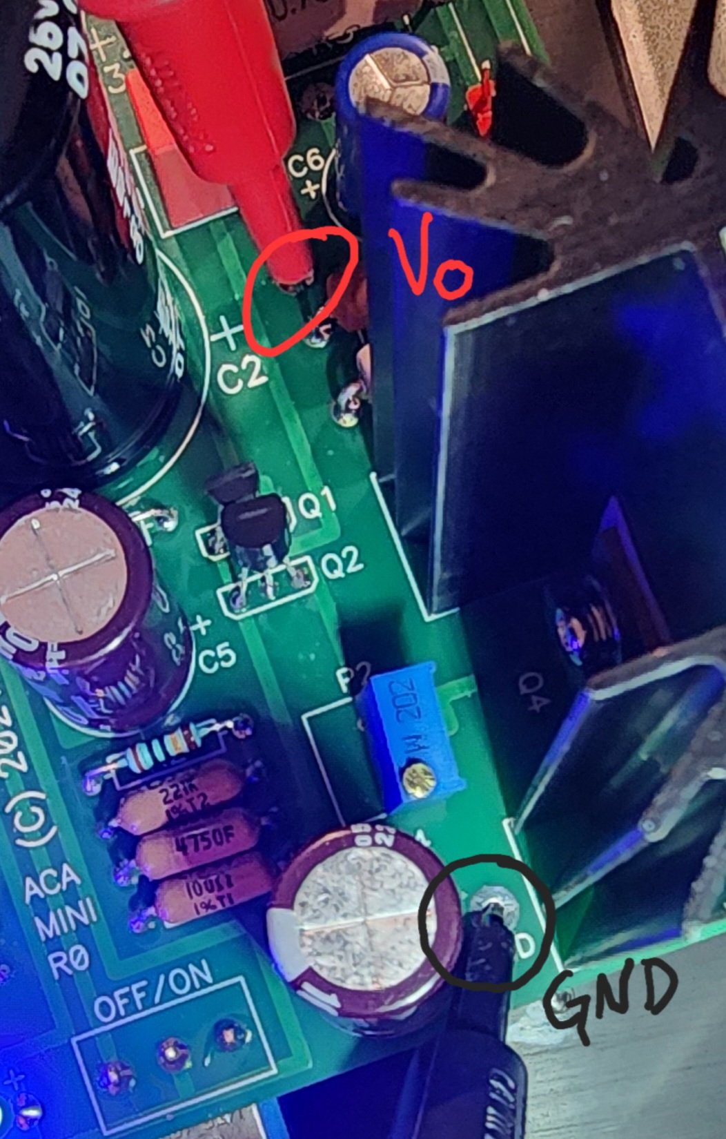

Ok, time to share in my re-learning...The "issue" I ran into which sent me on a near 3 hour wild goose chase until I gave up, looked at the thread, and quickly slapped my hand to forehead that I was so dumb. First, in attempting to defend myself a bit, it was 2AM when I finished populating the amp, so my brain was operating at maybe 50% by then and I was partially distracted by a "Back to the Future" trilogy marathon on tv. My issue was I was using Ground to Vb as my "bias" check. I kept getting 24VDC and I was so confused. I spent the next 2.5 hours troubleshooting (I won't describe the insane things I tried and did in hunting for the "problem") before giving up, going to bed, and reading the thread where someone else had the same issue.
You'd think after building 7 of these myself I'd know that Vb is measured at the two test points next to the "Vb" printed on the board. I'm a dodo....I was a really BIG dodo last night.
So, to help that one other person who might just make the same mistake as me, here's one more picture showing where to measure Vb and Vo.
Bias is measured by the two test points next to the "VB" label (the GND test point is not part of this) and should be 0.30 to 0.35 VDC per Nelson's article guidance.
Measuring the offset, V0 target of 11.5 VDC (between 11.4 to 11.6 is good per article) uses the test points marked GND and Vo.

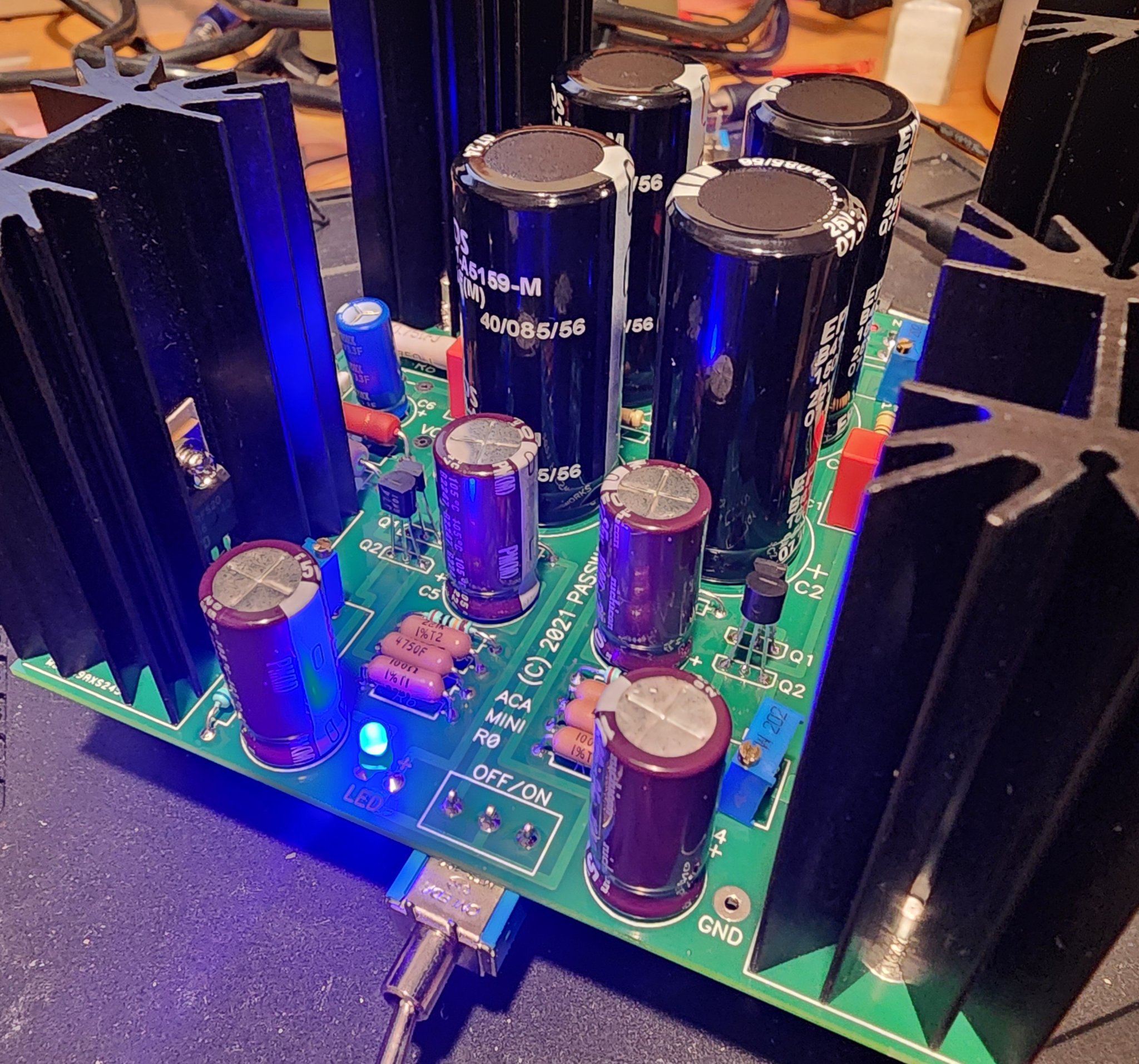

Fist off... Whaou, 7 MINIs!!!
7 Minis....
7...
You clearly beat me, and eventhough my "demo Mini" hasn't been yet really on a big tour at friend's, I doubt I can beat that one day LOL!
But I agree, that little gem deserves to be shared and is the ideal introduction to Papa's DIY. Easy build, low cost, VFM is absolutely great and the look is so cute (and it can be tailored). Sound can even be tweaked... and 2 of them (double Mono configuration) seem to be even much better for whatever reason ...what is it not to like?
Then... THESE SEXY FEET!!! What a beauty! I like also the underslung connections, very nice! Well done again, Dan!
Now to the build. 2AM... Nah, first rule: don't work seriously at 2AM! Oh, I love working at night, and I believe easily you made such a mistake... if you remember my first Mini at 2AM I soldered one of the transistors backwards (lucky me I noticed it while soldering the 3rd one, something just felt odd LOL). So, Dan, given we live thousands of miles apart, it MUST be clearly the 2AM and defo not us! Next time, stop at 1.59AM... and start again at 2.01AM, but make sure you have an accurate clock... that 2AM is very clever 🙂))
And now- perhaps a useful hint - for other builders? That VB measurement can be tricky: some might be afraid to have clumsy fingers, space is tight etc..
In fact, if I remember well, VB is "simply" taken across R8. R8 is one of the big resistors, hence I mount it say "nearly 1cm or so" above the board so this 2W resistor can get some air around of it. Also, R8 stands quite alone, is hence accessible... and has big legs. I never used the tiny and close together VB points: I simply used crocodiles or even touch probes directly at the legs of R8, far easier and probably safer late at night LOL.
I found this easier "for me", but then of course, that's just me...

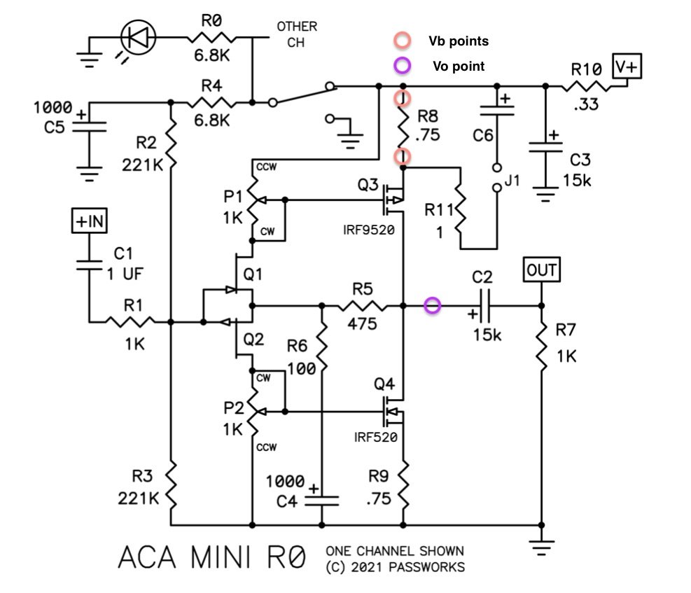

Kudos to birdbox on completing 7 ACA Minis.
Claudes's suggestion for clipping onto the R8 leads is great for the initial phases of setup, esp. when using 2 meters simultaneously. However, for quick spot checks (a good idea during seasonal T changes), I find pressing the probe tips into the solder pads/vias at the Vb points to be super convenient and quick; brilliant minimalist design, IMO.
Below is the ACA Mini schematic marked with the Vb points and the Vo point. I had posted this at some point in the early part of this now-long thread, but repeat it here in case some find if helpful (although it's utility at 2AM, like most things, is doubtful).

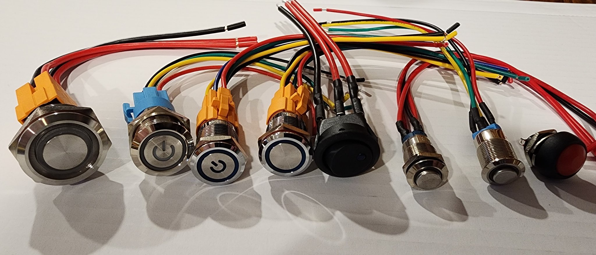

Just got my ACA Mini last night and will be putting it together this weekend. 🙂
I plan to make a wooden case and mount rca, speaker, and power jacks on the back, and a switch on the front. The RCA jacks and binding posts I know how to handle. A couple questions regarding power supply and switches:
1. On the front I would prefer to use a toggle or led push button power switch...are there some that you guys can recommend? Im a little confused also at what voltage/amperage i should get...should it match the power supply (24V)?
2. To install the power jack in the back of the case...I haven't had time to inspect all the included parts. Will the included female power jack be able to be mounted in the case or do I need to look for something else online?

I would purchase a 5x2.5mm female barrel connector meant to be mounted to chassis, like this. There are also ones that come with pre-soldered leads. Just make sure it's capable of at least 2.5A to be as capable as the one included with the kit.2. To install the power jack in the back of the case
The switch that came with the kit should mount to chassis if you'd like to use that and avoid buying another switch. I've had good results with push button switches off the big bezos bookstore. Here's one I used with my MinMax.On the front I would prefer to use a toggle or led push button power switch
There are lots of options from the largest rainforest on the planet.
