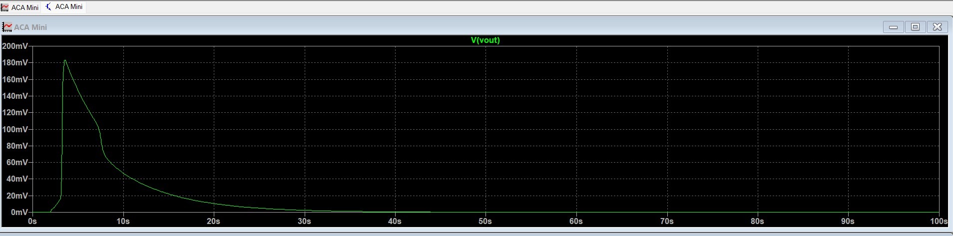

As others before me, I suggest to just connect a speaker (or an 8 Ohm resistor) across the outputs and measuring the transient behaviour again ...
Output capacitor is already almost the best speaker protection
Best regards, Claas
Best regards, Claas
do you hear any crackle or pop sounds from your test loudspeaker?
Nope.
Measured again with a load (6 Ohm speaker) and it's very different. At startup (bias switch turned on), voltage spikes to ~60mv and drops down to 30mv within a few seconds (and continues going lower until settling ~4mv within 20secs). Same thing when bias is shut off. MUCH better than without load.
Shorting the inputs makes no difference (with or without load).

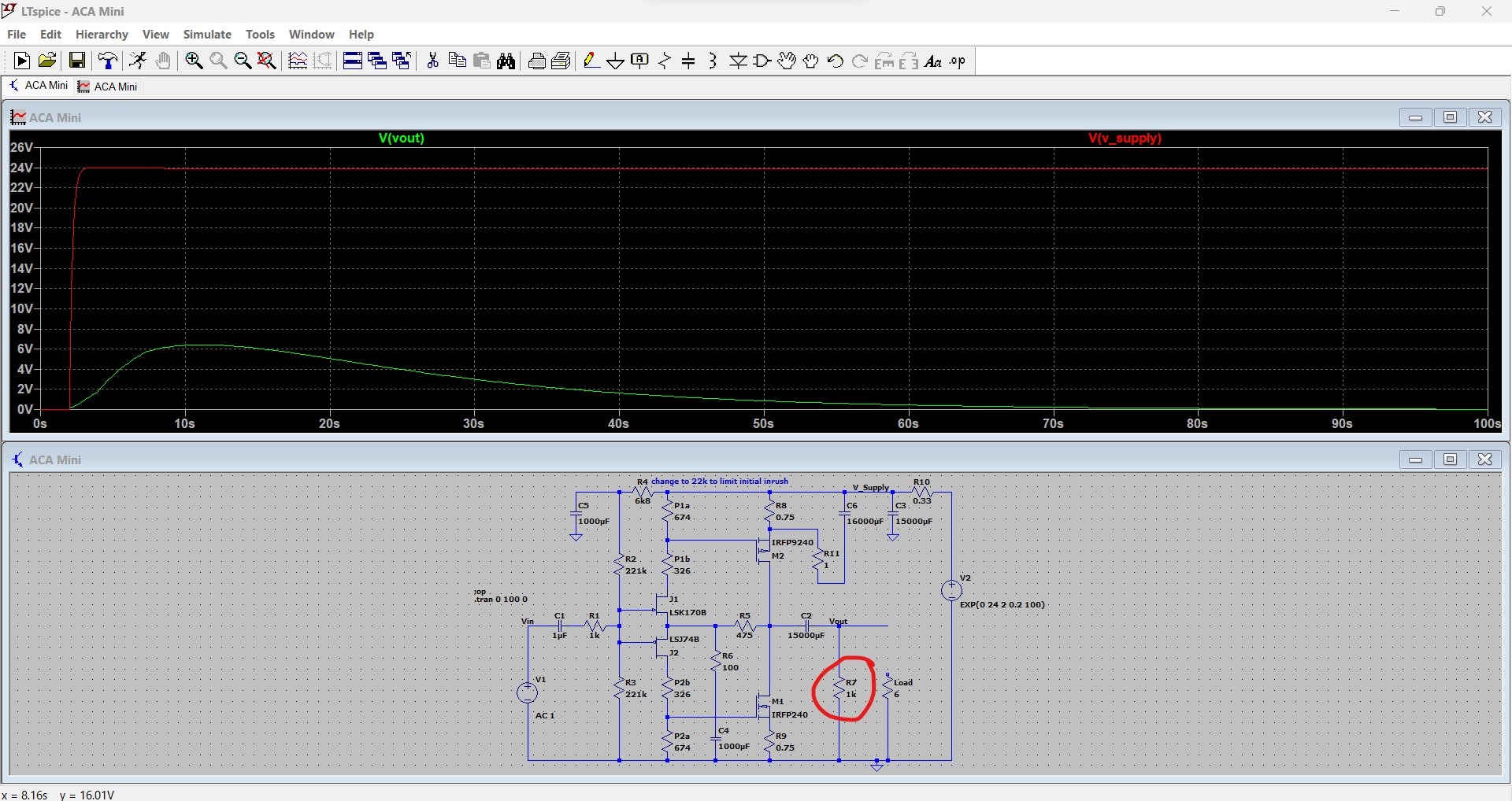

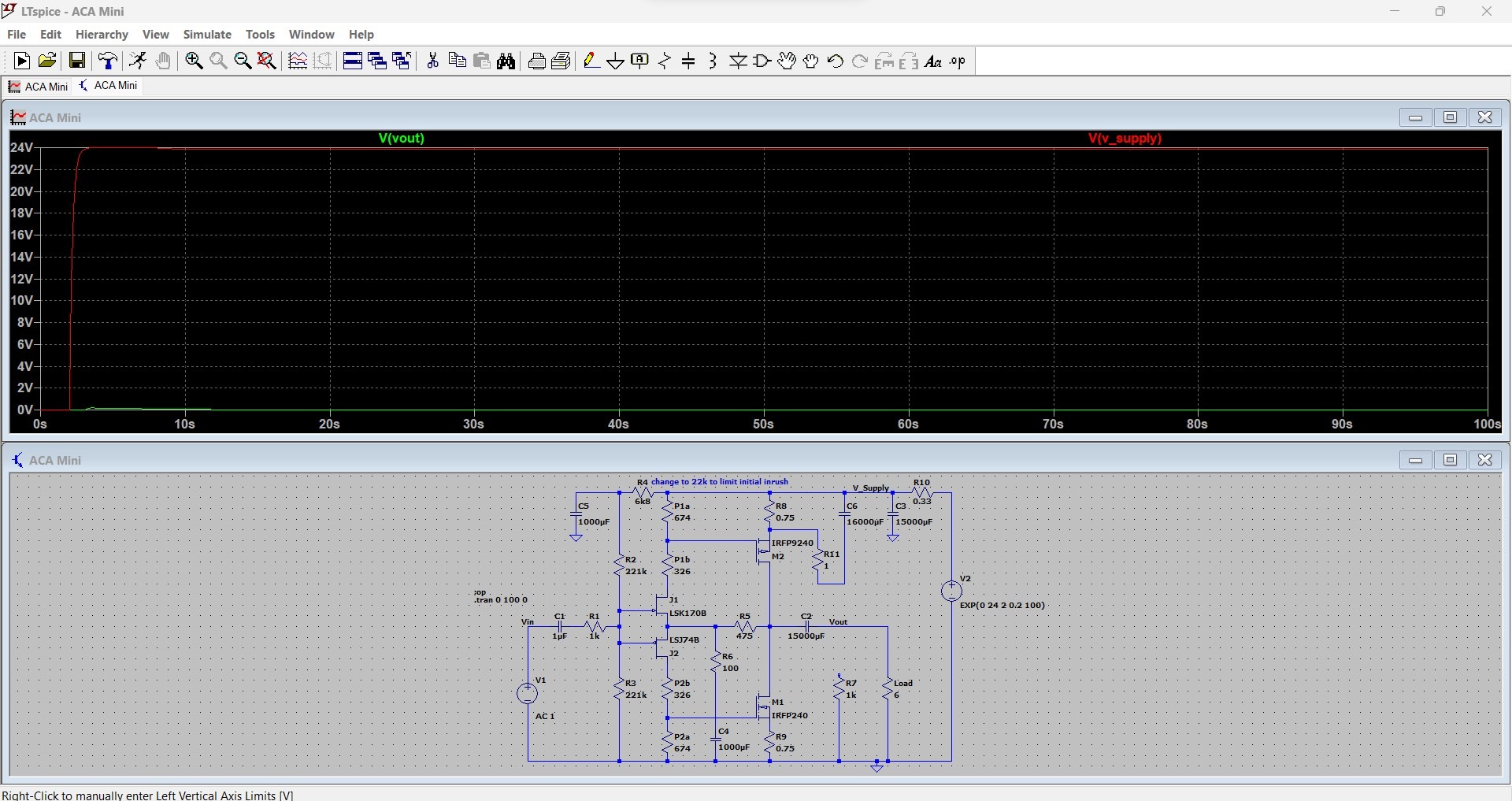

Here is the voltage across the load (a 1k and then 6 ohm) at power on. The supply rises to 24 volts at 2 seconds in. The second image is with the 6 ohm load in circuit.
The final image is the 6 ohm with the voltage scale expanded. Simulations aren't the be all and end all but the result should be in the right ballpark I would think. The time constants are what they are... long 🙂

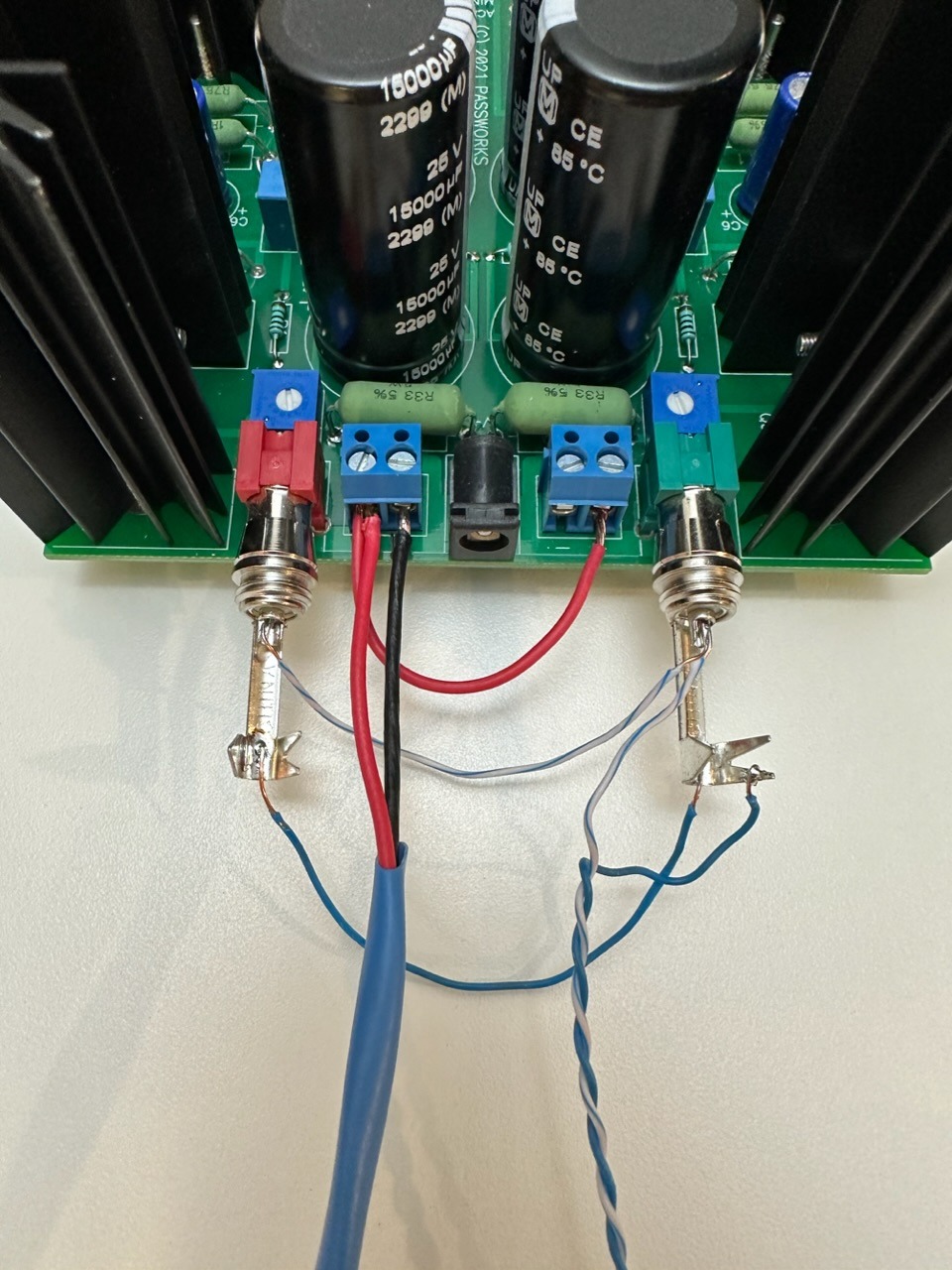

You could also run the channels in parallel, use a Y-cord to the input, and parallel the output jacks. I had one wired that way just a couple of days ago and totally forgot to get any photos…. Whoops.
Anyway, it worked great.

Anyway you could do a picture of that
Or maybe a quick sketch up drawing on that bridged hookup?
input grounds are already parallel
output grounds are already parallel
connect in parallel input hots
connect in parallel output hots
use one channel for input, use one speaker for output

Thanks Zen
That sounds simple enough.

So speaker connections would be the 2 positive terminals if running in parallel
and no ground right?
Please excuse the very crude y-cord on the input.
