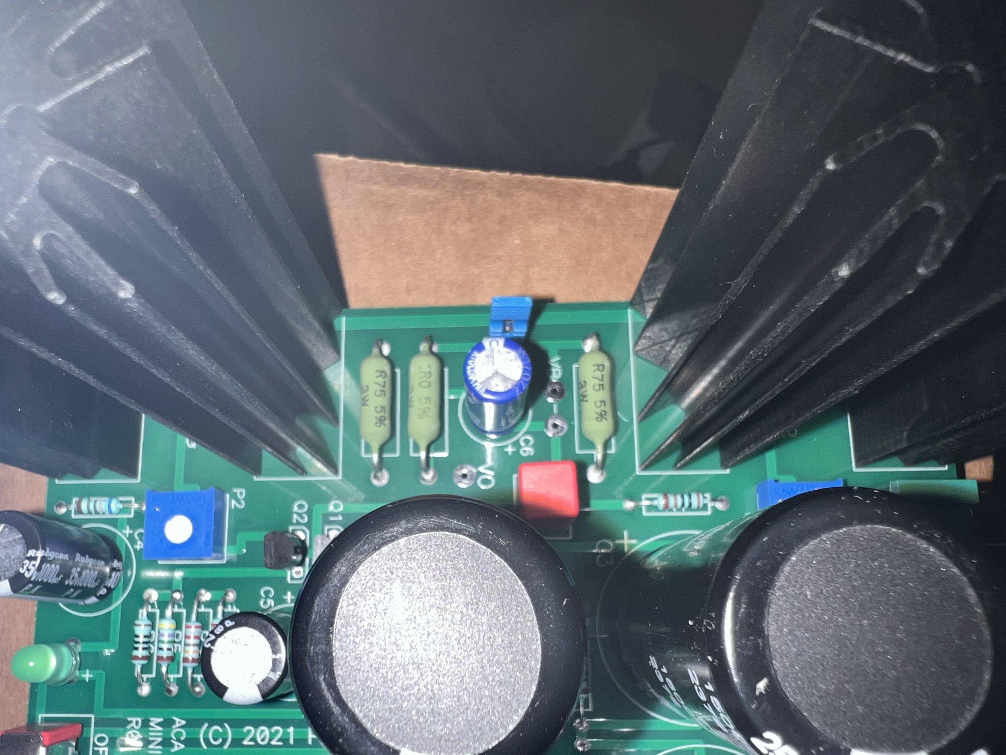

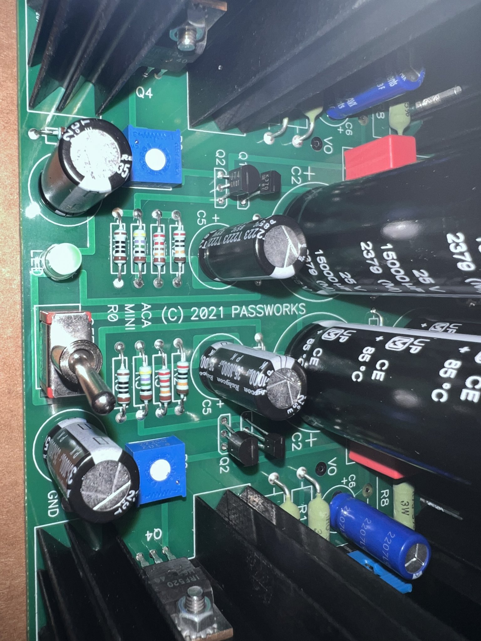

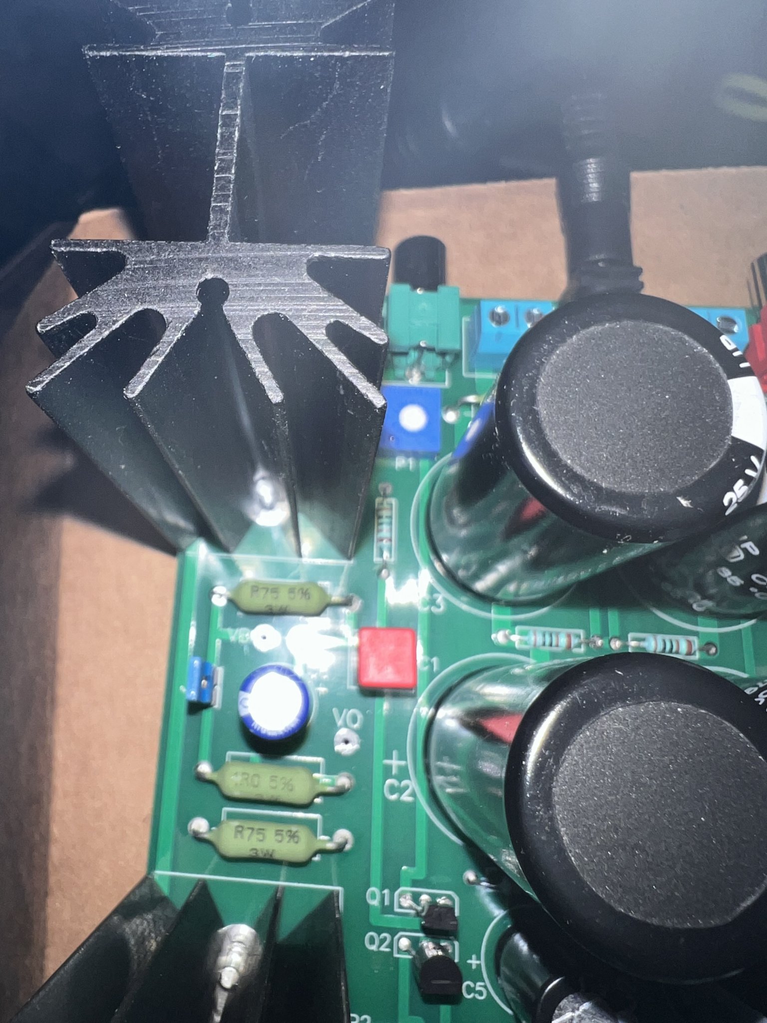

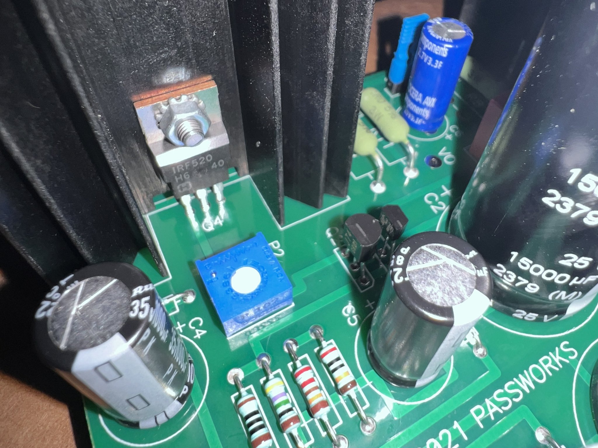

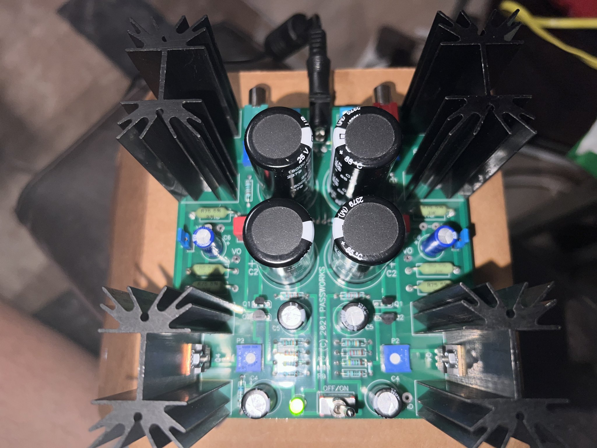

just finished building a kit. VB for left Channel wont get higher than 26mV. VO is 11.5V
Right channel is working ok.
What have a done wrong?
resistors placement. diodes, soldering,no shorts......
it must be something
keep avalanche of pictures, we can't trust you on word
I mean - without pictures we can't even say what's most suspicious
if everything else is OK, I could say that most likely culprit is that you damaged one of trimpots while soldering

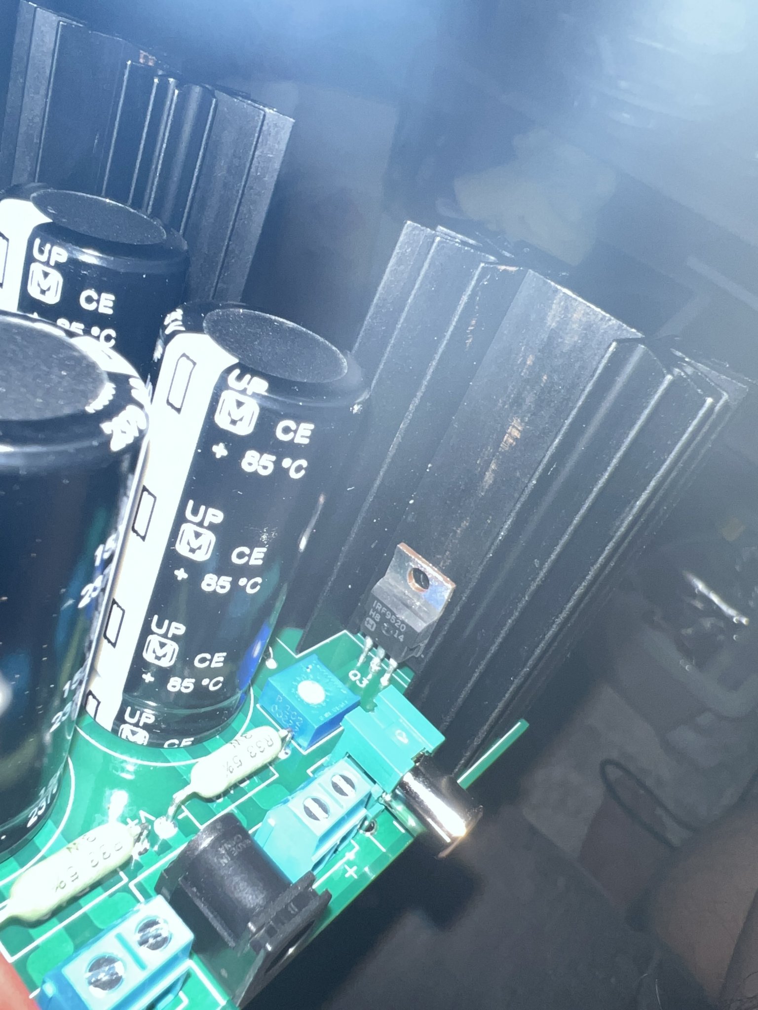

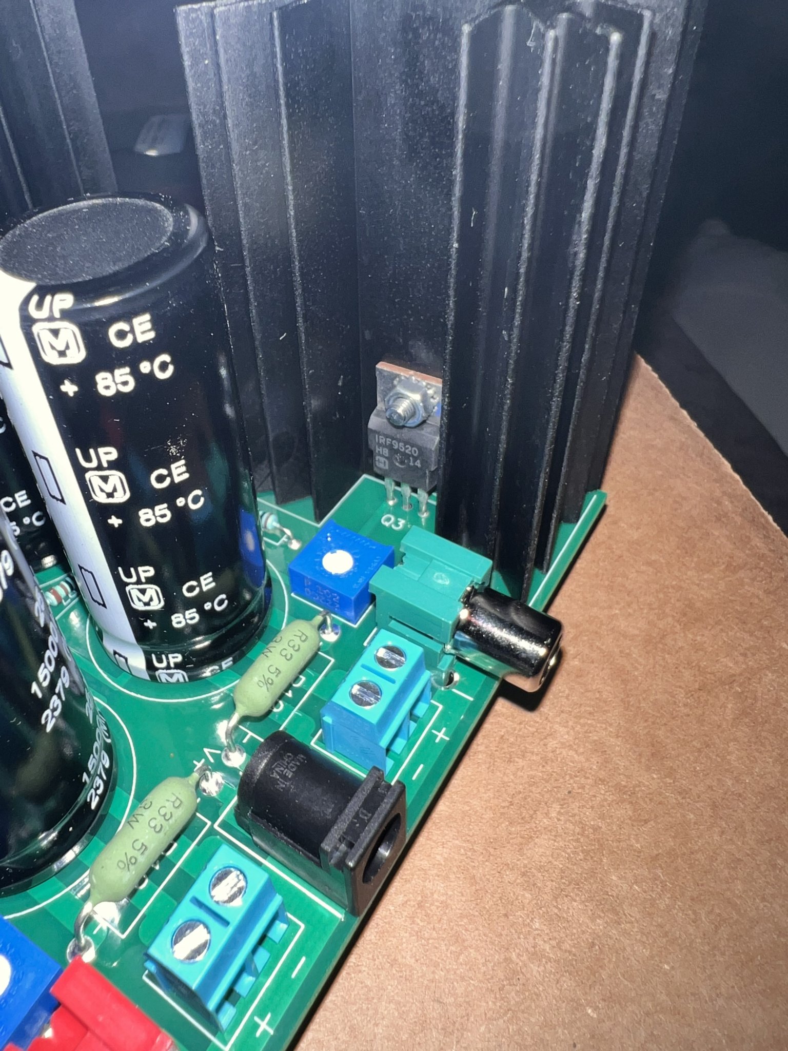

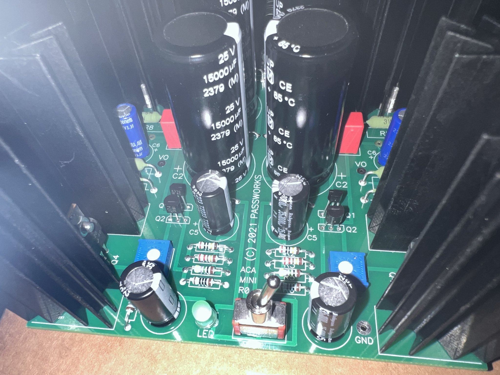

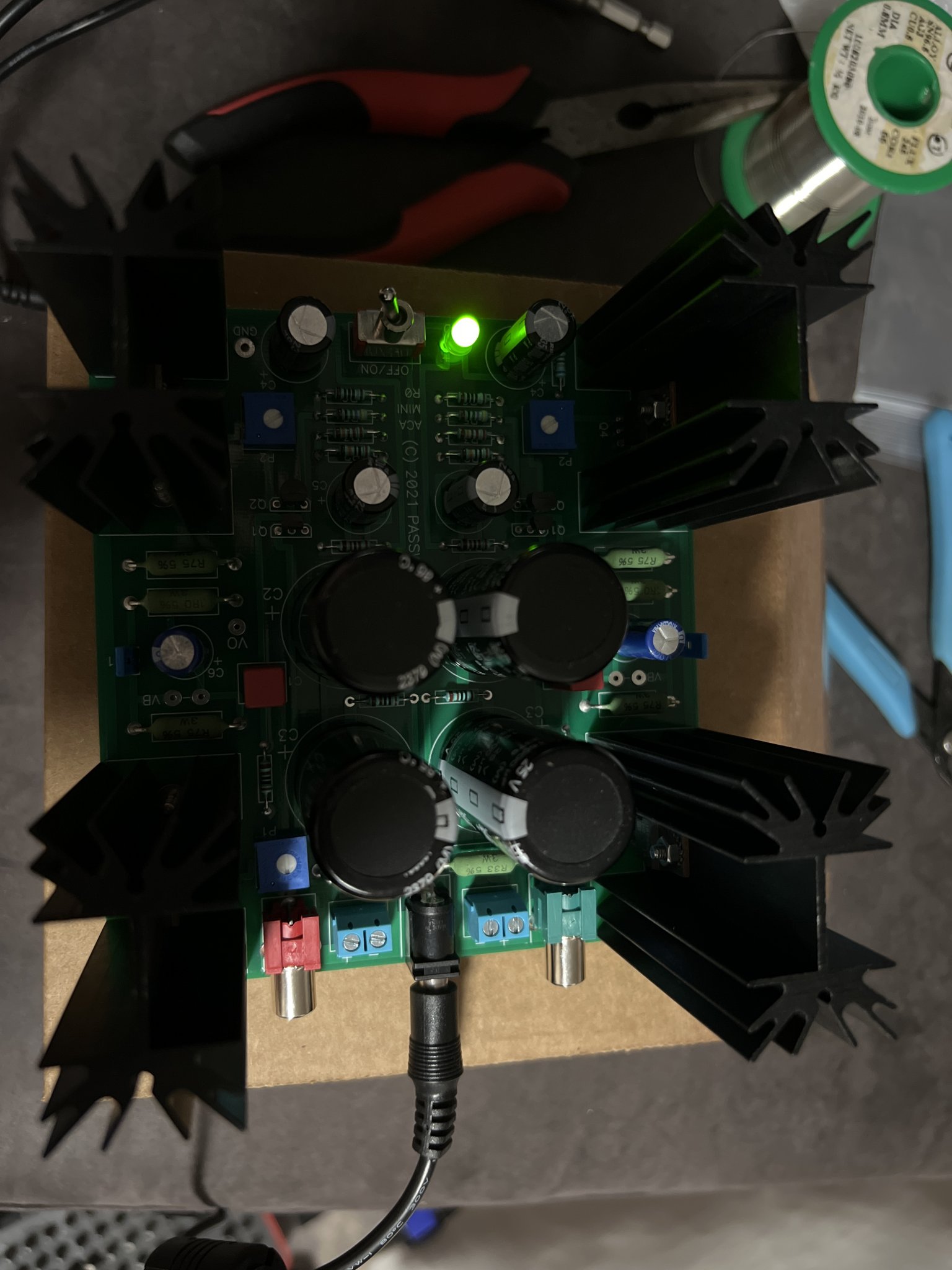

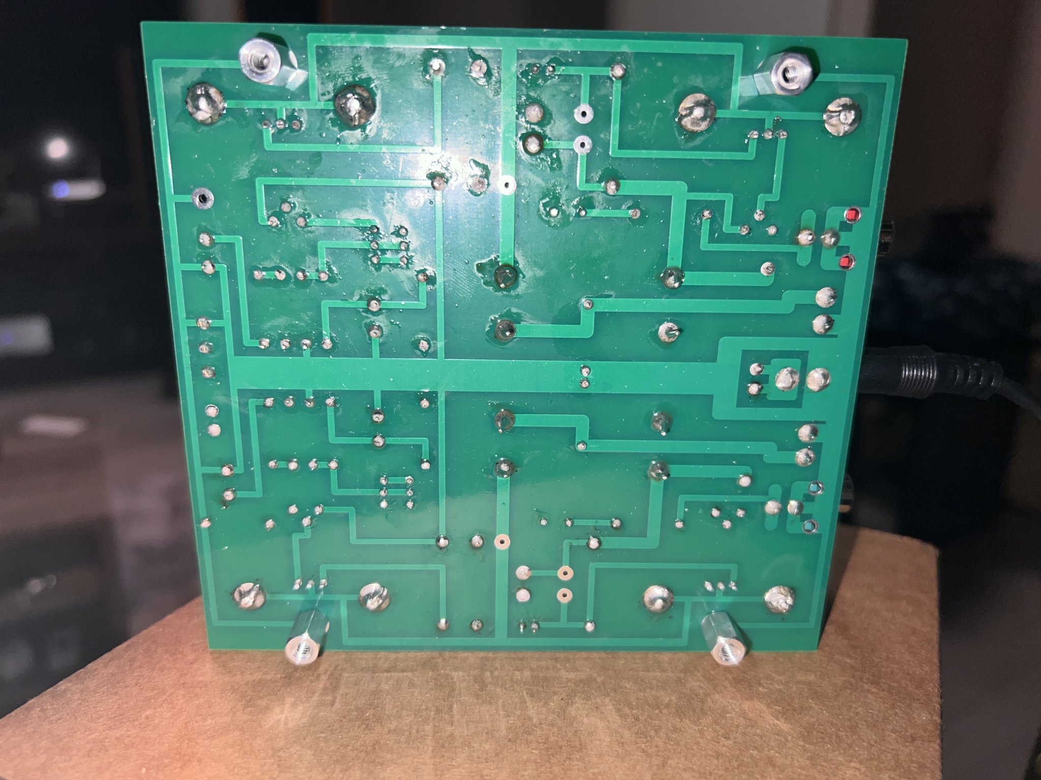

I’ve checked all resistors, capacitor orientations, resoldered all joints for left channel. No shorts that I can tell. The trim pots do alter the VO and VB voltage. It’s just that P1 trim pot only gives a VB range of 0mV to 27mV from counterclockwise to max clockwise. VO I can get it to be 11.5V as expected. While The right channel is biasing correct values. Is it still potentially a trim pot issue or the jfet/mosfet? (Sorry I’m not sure how it check this).

power off, desolder both mosfets, remove them; easiest to do if you add solder to all 3 pads and heat them together with solder tip leaned to heat them at once
then clean pads with solder sucker
that to exclude potentially gate leak, to deduce is there a problem with JFet or mosfet
set both trimpots to min, measure VO and VB, write down
set both trimpots to max, measure VO and VB, write down
of course, there is the other way - replace JFets from one channel to other; if problem stays in same channel, JFets are OK, mosfet is Dodo

now, if counting on fact that you are able to ( same technique as for mosfets) cleanly swap JFets between channels - that is certainly best and fastest way of deducing a culprit

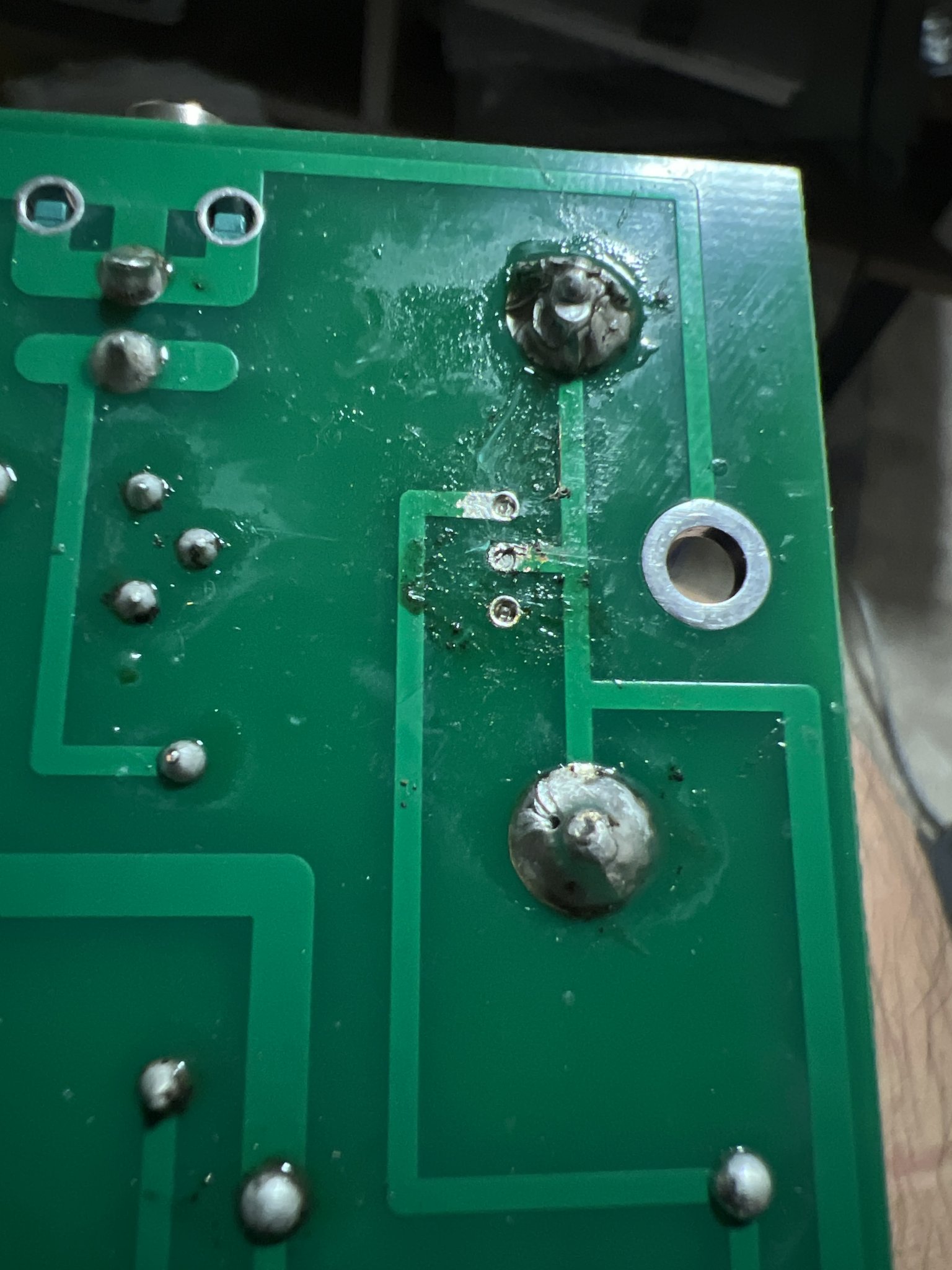

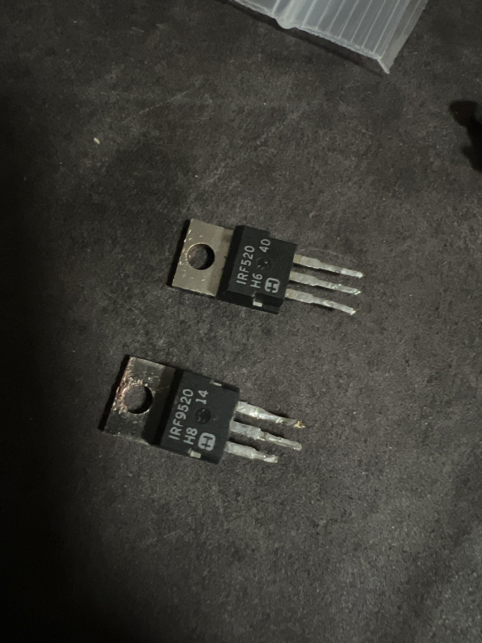

Ive managed to remove the IRF520. While the IRF9520, im really struggling to remove it. Ive put so much heat onto it now, if it wasn’t dead by heat originally, it probably is now. Sigh. Is there an easier way to remove the mosfets? It’s like the solder is also stuck on the other side of the pcb which is hard to access with the soldering iron.
Looks likely needing to get a replacement fet matched kit from the store at this stage. Assuming I can figure out how to remove these fets…

What is your soldering gun set to? I have cooked a few mosfets in the past with the soldering gun and have not had one fail. They are surprisingly touch Did you add a big glob of solder to your gun tip?
it’s on 430degrees c at the moment. Yep added a blob of solder on the tip. Ive got the solder mainly off the underside of the pcb. But it seems the fets legs got so much solder on it and it’s stuck on the top side of the pcb. Cant get the solder tip in the gap as there is one of the big caps in the way. That’s not easy to remove either.
Going to give up for now. Sorry, frustrated. Will try removing the big cap so got space to remove the solder from the fet legs tomorrow.
