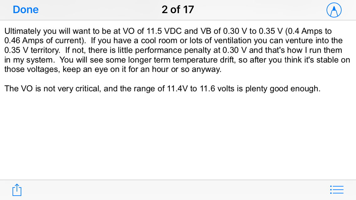

Note that depending on what particular brand of output MOSFETs you use, that P1 & P2 may need to be substituted with 1.5K ohm or 2K ohm pots instead of 1K to reach the requisite recommended bias.
I know for the latest kits from the DIYAudioStore, the recommendation is to use 2K ohm pots. That’s what I have ordered for my build.
