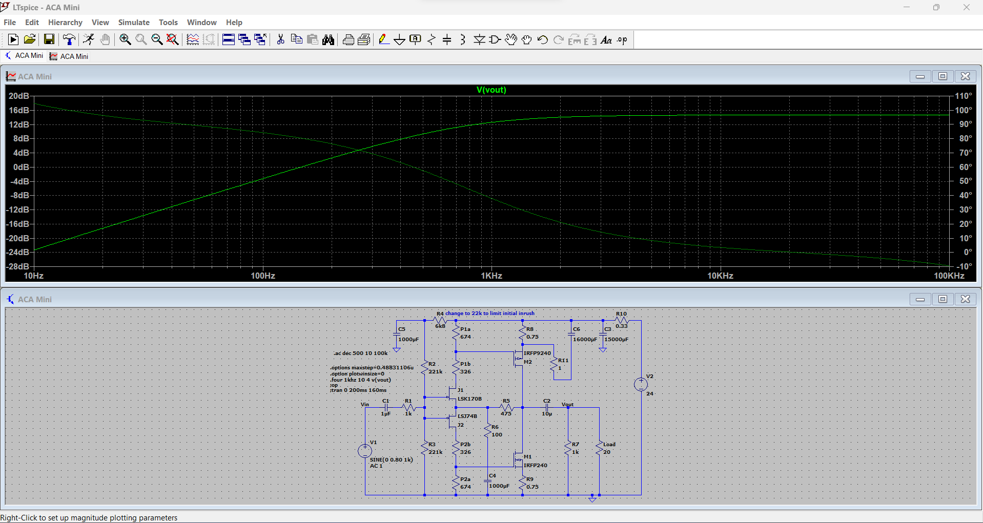

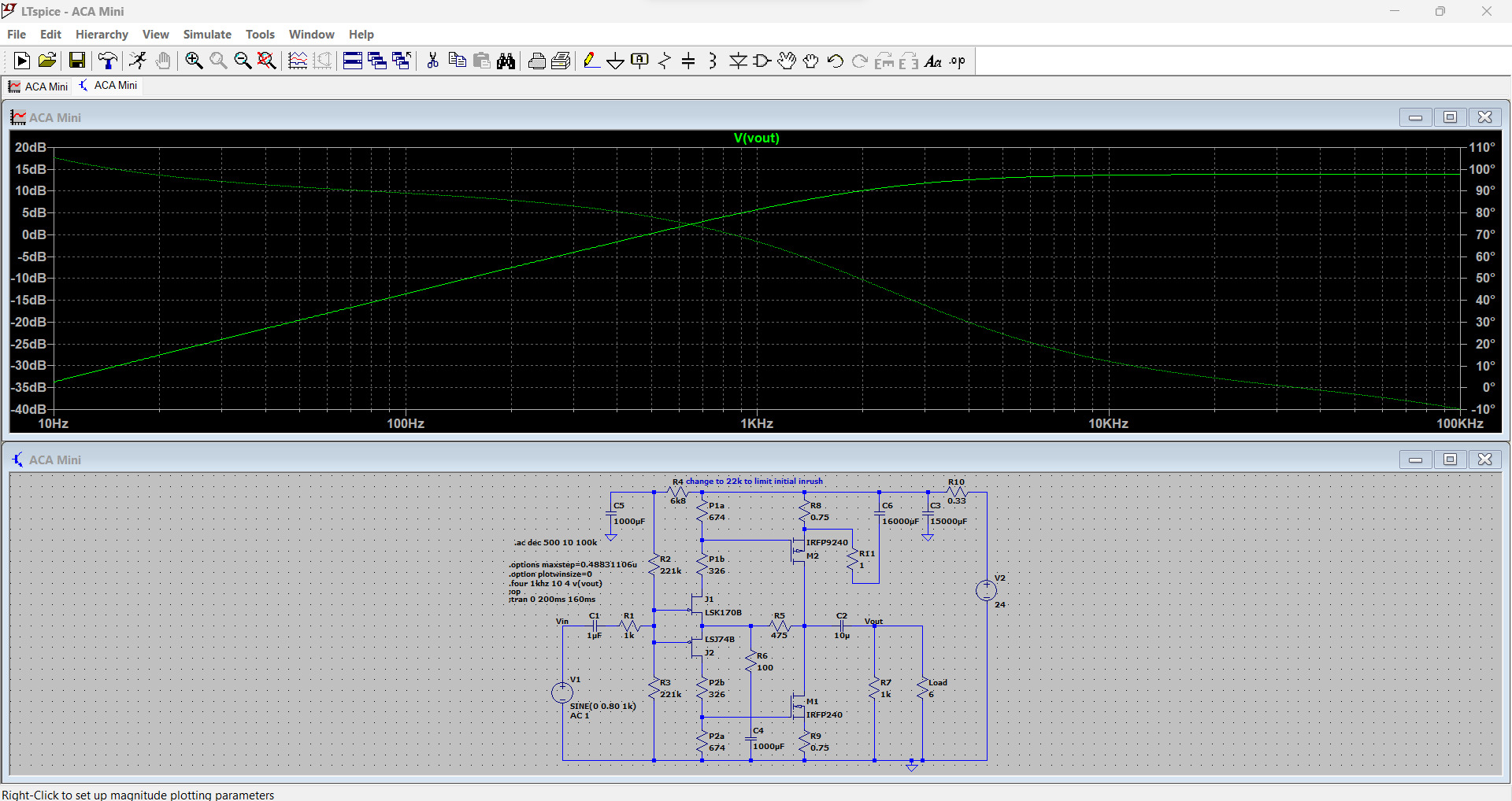

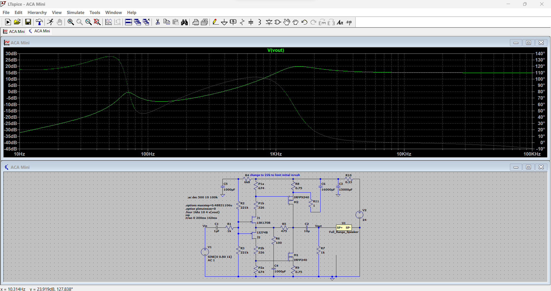

For a resistive load yes. For a reactive load anything is possible.
Here is a response into 6 ohm, 20 ohm and then a simulated full range speaker.

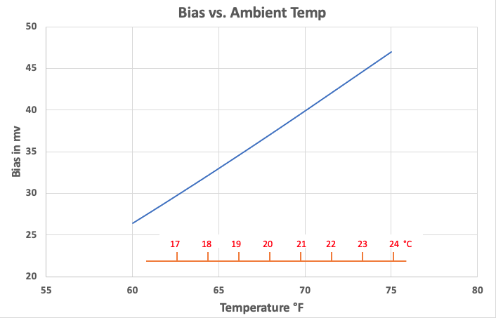

Well, if you bias at 300-340mv at 18°C, the bias will drift up to about 475-515mv at 25°C if you don't adjust it.Biasing... going OK - following this guy on UT. Now, it's winter here and I keep 18 C in my flat but when summer comes it is cooking and get easily to 25 and I have no cooling - do I dare to use the amp or will it burn? Should I have to re-bias as the seasons shift?
Yes, thats what I was afraid of.... what happens if I don't - will it take fire och break?

I'm slightly confused as well... with the graph...

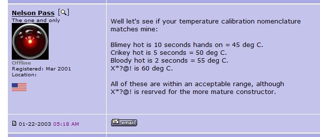

But... at my age, I'll go with what Nelson suggested: Mature Age => 60degC heatsinks 🤓
This graph won't help since we're looking to maintain a constant bias of 0.3-0.35 V (300-350 mV) for VB and 11.4-11.6 VDC. The y-axis would be the combined resistance of P1/P2
It's much easier to set the bias and check on it as the seasons change to confirm the bias hasn't drifted too much with ambient temperature. I like your effort. The temperature scale is a nice touch.
I was the author of that graph. BTW I erred in y axis - it needs to be multiplied by 10.
As I believe I stated in the original post, this graph is not a plot of how Temp changes as you vary bias, but how bias changes with ambient Temp while leaving the pots untouched. This why I included the word Ambient. t I hope that clears up the confusion.
