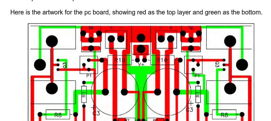

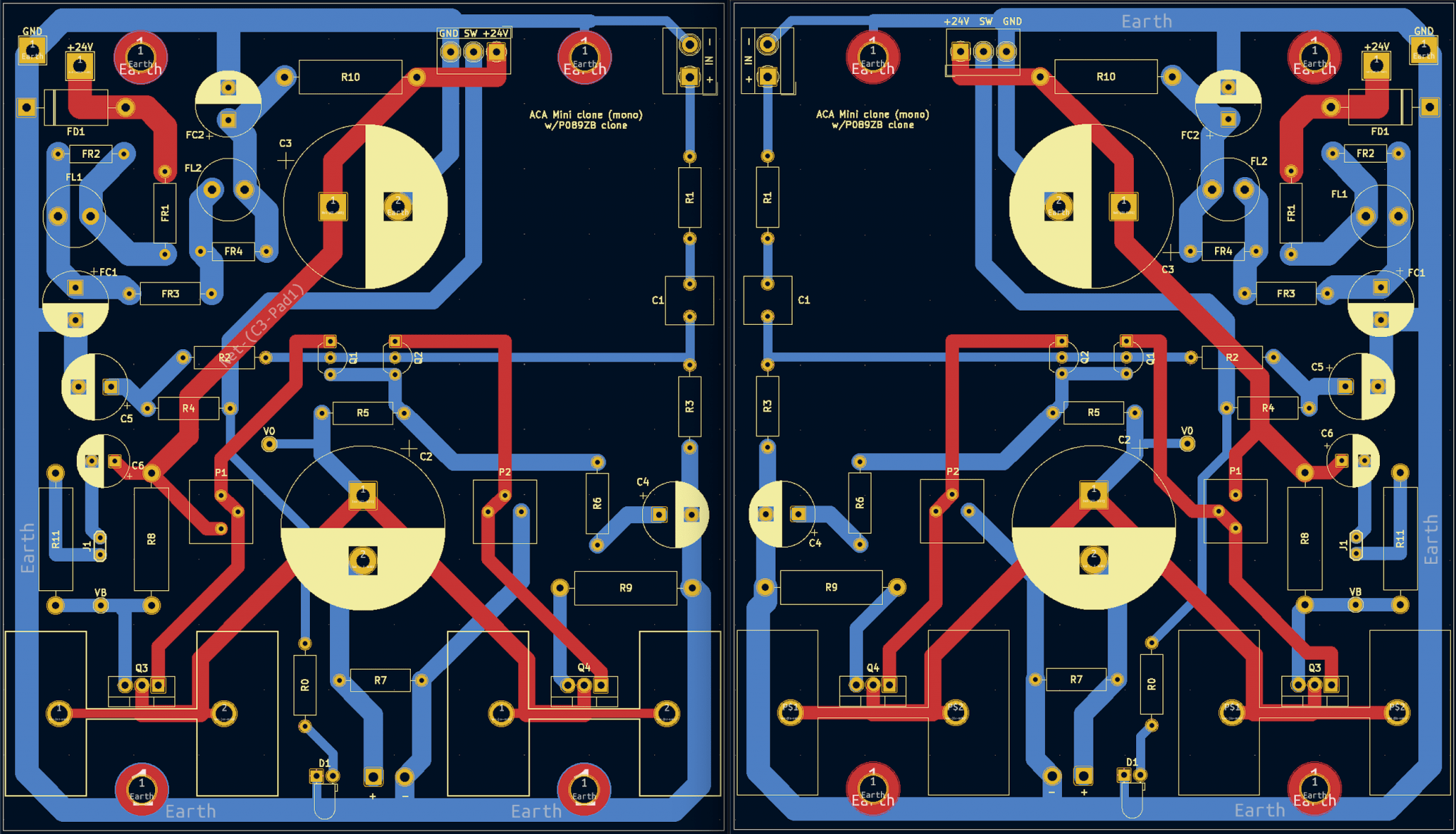

Yes please. Show us a picture.I had some mono PCBs done and because I'm a noob at this, I didn't pay attention and got 1oz copper. Should I reorder with 2oz? Or does it not matter with mini?
