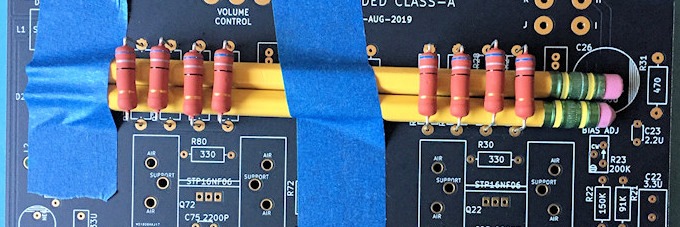

Popsicle House amplifier... Could be interesting. I always elevate three-watt resistors or ones that I think might get hot. I have a sliver of cardboard I've been using for the better part of the year for that purpose. Cheap and non explosive 👍An even lower-hanging fruit is to space the components apart from the PCB (thus the soldermask) by the thickness of a popsicle stick. Apply stick, stuff component, solder leads, remove stick. Voila an air-gap 2mm wide. Air is an excellent insulator. Or, leave the popsicle stick in place. Wood is a pretty good insulator too.
Just in case "popsicle stick" is accidentally a regional idiom instead of a universal expression, here's an illustration.
_
Thank you. Great tip, along with the tape, for a beginner like me.For 3 Watt resistors I recommend spacing them one-yellow-pencil-diameter above the board.
