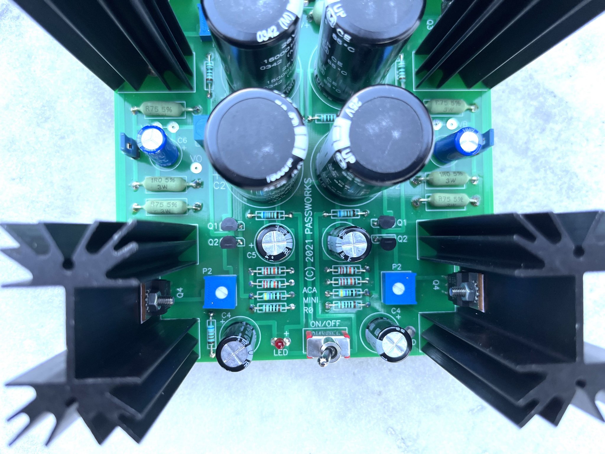

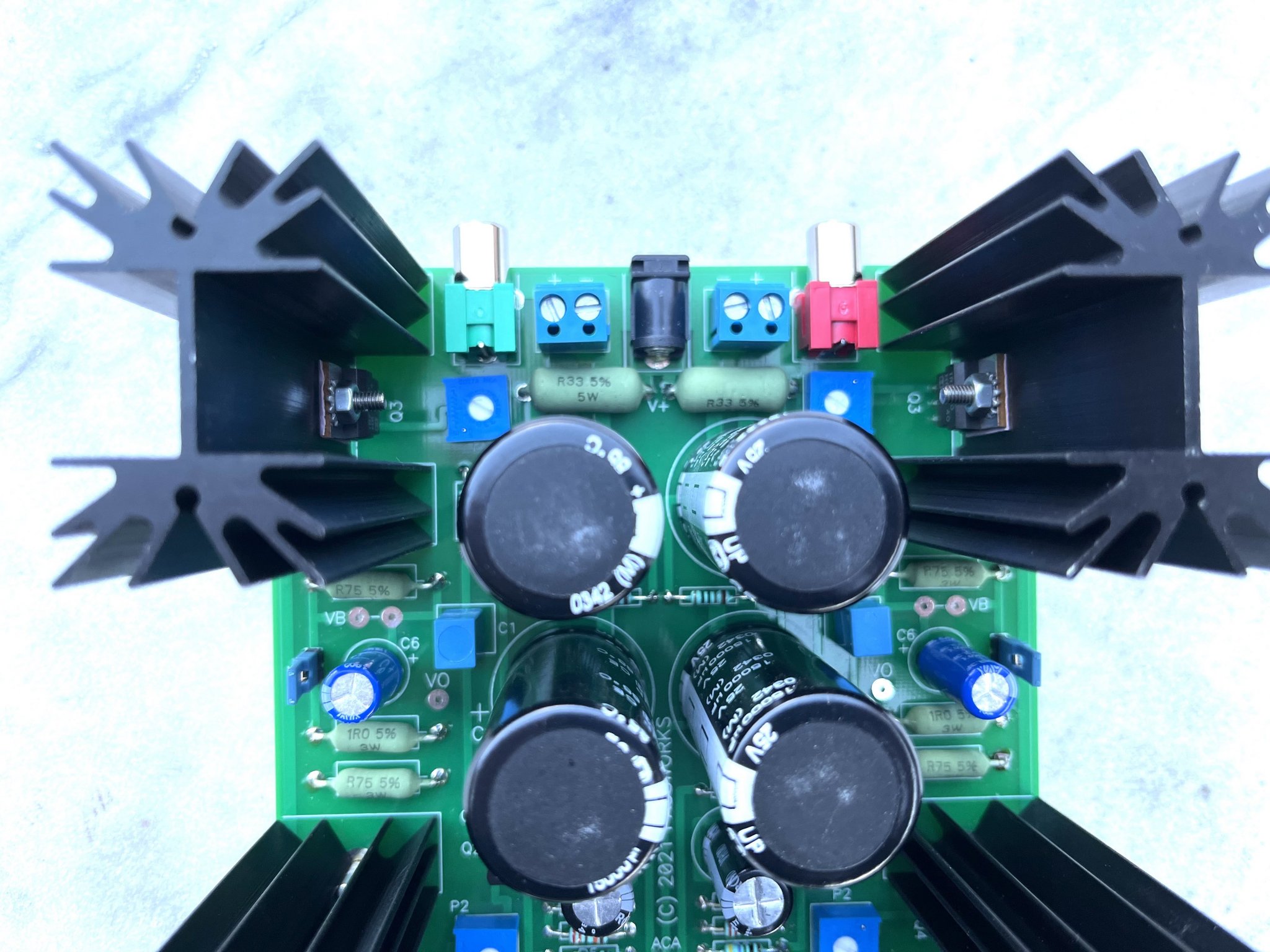

Having a problem with my new ACA Mini...
I was the lucky winner of an ACA mini at the last Burning Amp Camp and finally was able to assemble it. This is my fourth Pass DIY project and although I'm pretty much a "paint-by-number" guy, I've been successful and very happy -- but I'm having trouble with this one. The power supply puts out 24v, but when I plug it in, it begins pulsing. I've noted the early post about problems with the power supply and have turned the amp on and off while waiting -- but it continues to pulse. I was not able to adjust the bias and I did smell something hot -- turns out that is in the upper right area. C6 and R8 are much hotter than anything else on the board. I'm pretty sure everything was assembled correctly, and I did go over everything to check for improper soldering. I've included some photos -- pardon the fuzz I now see from cleaning the back of the PCB and I do see dark residue in some places from the Fire-Metall?
Any help any of you might provide would really be appreciated. Thanks very much, David

That is it!Verify the Q3 positions have 9520 mosfets and the Q4 positions have 520.
Even with your beautiful guide -- I mixed up the right side.
Thank you 6L6!
